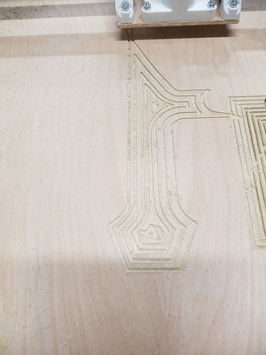

I bought a new bit and figured go head and give it a try. (1/8in flat ) Decided to cut out the Y plates. and my cut is well… lets say less than perfect.
Any idea whats causing this?

Now even on a previous project I had completed. This is what’s happening

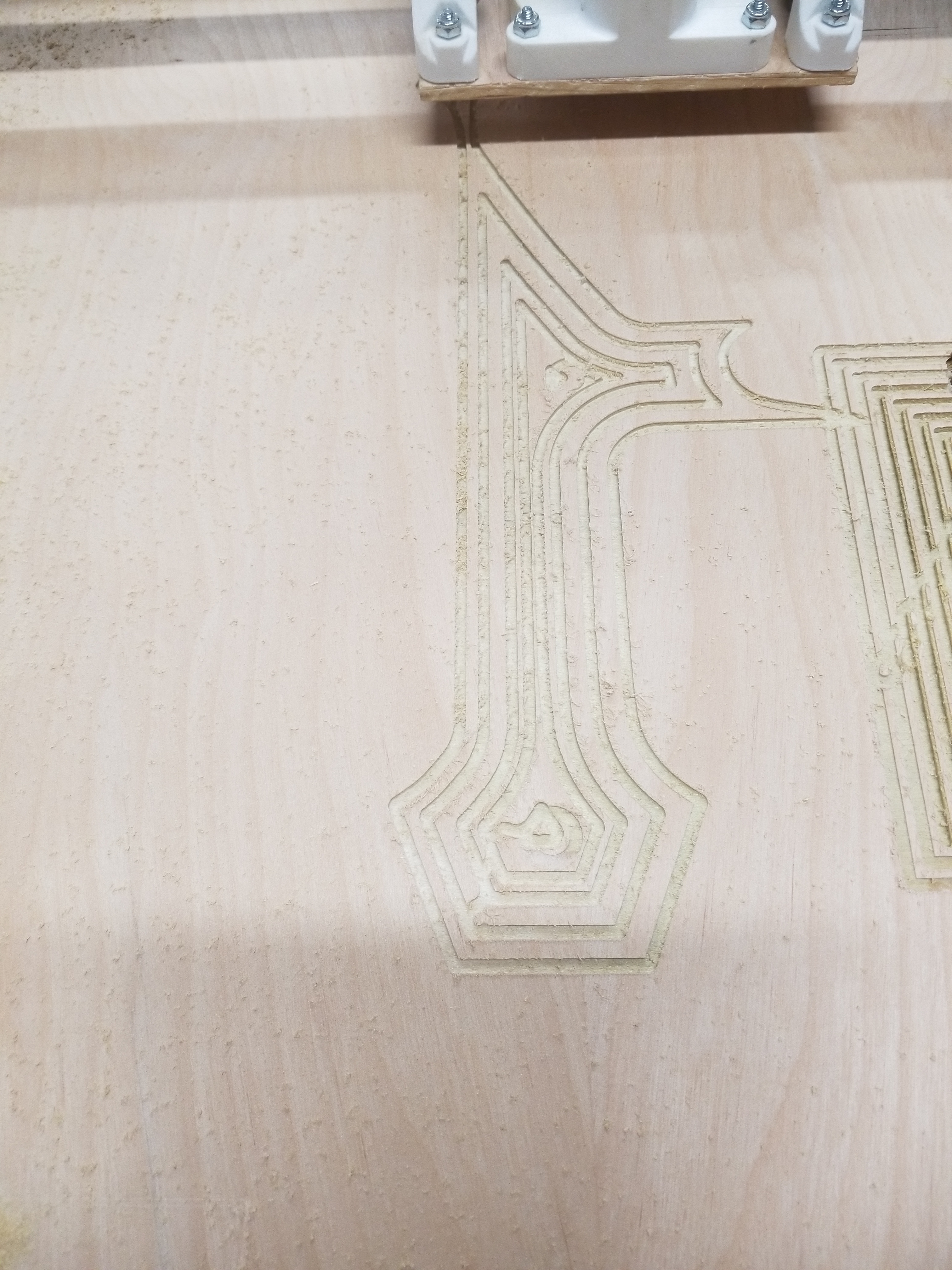

It looks like you are running the same 1/4" gcode with a 1/8" bit. You need to run it through cam again with the 1/8" diameter set on the tool.
That kinda makes sense, but that doesnt solve the problem of the part being double in size.

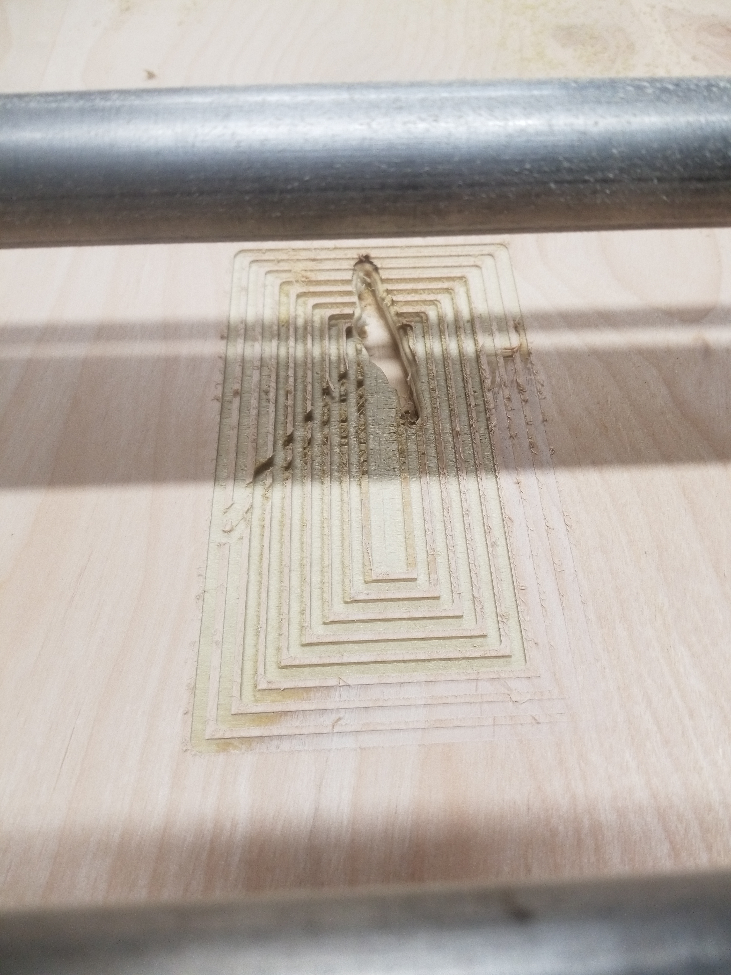

Just so I knew I wasnt crazy, I made two small 25.4mm x 25.4 mm squares. I cut this rather quickly, and as you can see, these are well over an 1". Has anyone, anyone at all experienced this ?

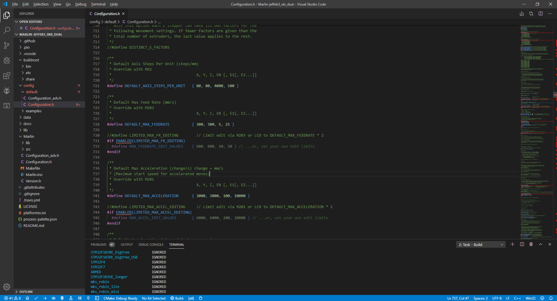

@jeffeb3 in your firmware, you have, on line 721, #define DEFAULT_AXIS_STEPS_PER_UNIT set at 80 80 4000 500. Can you confirm this is correct for the 2209’s?

Here are the settings I’ve found in the firmware. This looks odd to me.
That’s not my firmware:
BTW, the firmware I am posting here isn’t really for anyone to follow. It is just my backup of my configuration, and it hasn’t really been tested beyond some drawings.

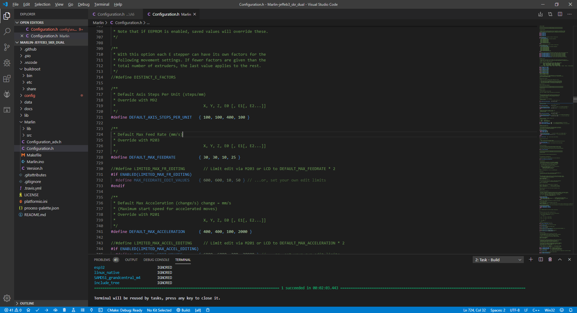

Here is what I found in the firmware. I had to dig through my notes, but I did change the default axis steps to double @jeffeb3. Which before my boards went crazy, seemed to work just fine. No worries, I switched these steps back to the normal 100 100 400 100

@jeffeb3 that is certainly your firmware from github. However, I did some digging and I was actually inside the A6 config file. I apologize I was looking in the incorrect place. The settings I am referring to is on line 721.
