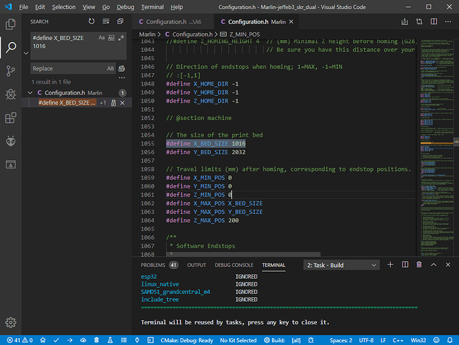

I have went into the firmware and reset my steps. Not a big deal. However, somewhere between post process and loading the file into repetier, (which I just un-installed and reinstalled) still produces double the size of my designs. I even loaded my last successful file, and it is doubled as well.
Could it be that I updated my print bed in the firmware to reflect my table dimensions?
I don’t THINK the print bed dimensions would cause this, but I’m actually not familiar with any part of the tool chain in use. Other may be more help.
My best guess, though, is that somewhere in the process the number of steps generated per unit is getting doubled. If the steppers were stepping at 1/8 microsteps instead of 1/16 that would do it too, but I think that would show up when just jogging the machine around too…
The gcode looks OK, so the problem would appear to be somewhere “downstream” of that point.
I went back through the firmware for the past 2 hours. Here’s what I came up with… … nothing. Reset the firmware to @jeffeb3 original, adjusted my endsstops, resized my bed. Flashed firmware. Problem solved. At least for now.
You can change the steps/mm without flashing the firmware. Is it possible you have 20T pulleys?
M92 X80 Y80
If that works then write that down and send M500 to save it for next boot up.
Checked the pulleys, they are 16t. My steps are fine now. I redid my test from earlier. Results were spot on.
A quick tip to debug issues like this is to use a file comparison tool to compare your firmware with a “known good” version to see what you may have changed to cause the issue. This is a great tool to have:
WinMerge
Thanks for that helpful tool, Paul. Certainly handy. After comparing, there was no difference at all.
