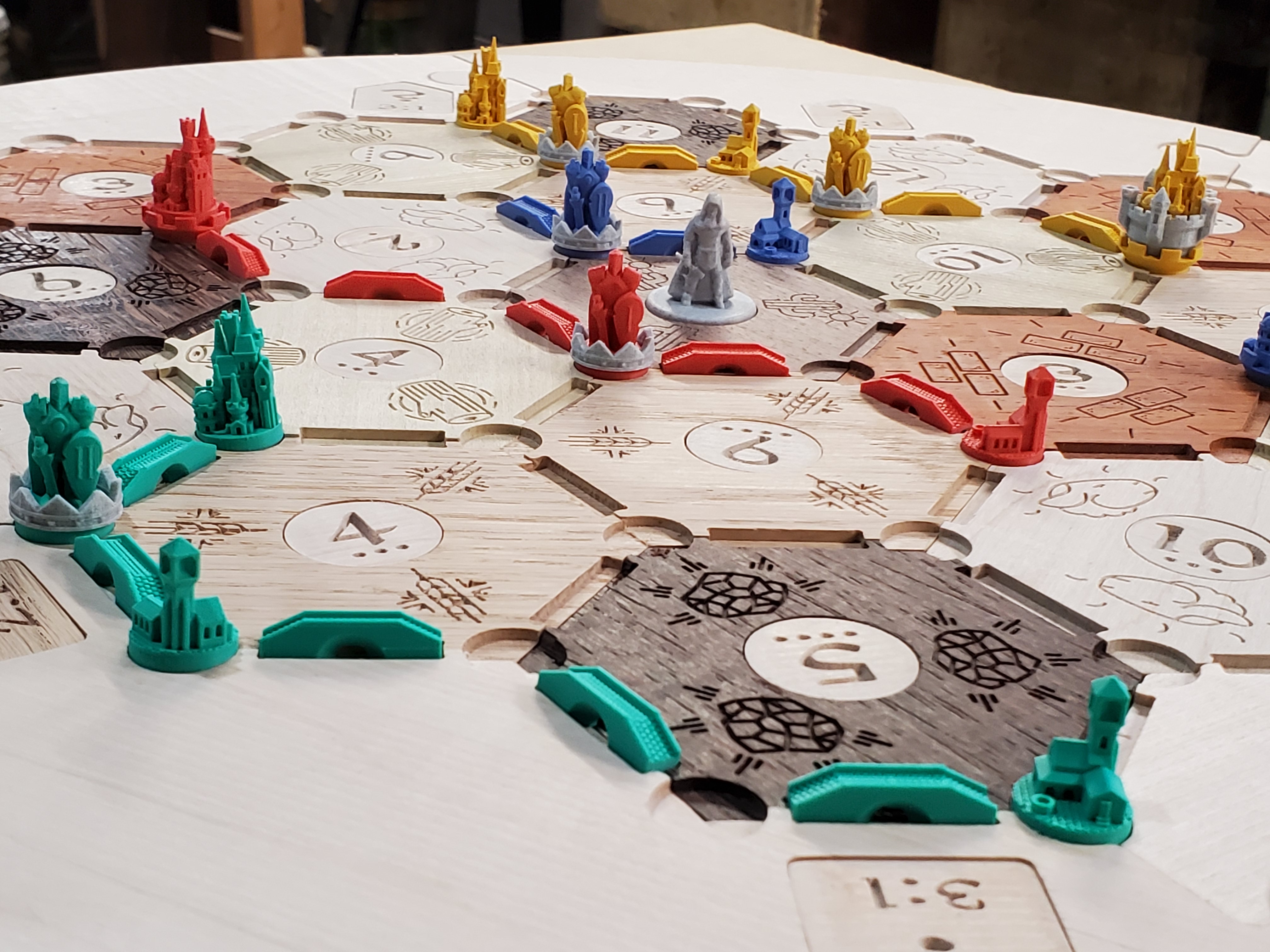

I’ve seen a lot of people post about how they wanted to build the MPCNC so that they could make a custom Catan set but I couldn’t find any actual build posts on them so I figured I’d show you mine that I just completed. I still need to clean up and seal the pieces a little but here you go. I’ll also post pics of it with the 3D pieces I printed for it later. This was quite the learning project.
For anyone wondering:
Sheep: Maple
Wood: Poplar
Wheat: Oak
Brick: Padauk
Ore: Wenge
Desert: Walnut

I forgot to mention. I found the symbols on the link below. I’m not great at the whole graphic design stuff so I needed to find symbols to base mine on. Because they are not my design, I won’t release my final files but here is the original design I used. But if people are interested I can give the blank tiles since I designed those myself.
Here it is with all the pieces on the board.

The board diameter is 55mm and the 3d printed pieces are 15mm in diameter.

Definitly interested, I would love to give one of these to my daughter who loves Settlers. Also if you would like too release your 3d printed files it would be great!
Here is a link to the DXF files I just put on thingverse. FYI, the dxf files are in mm.
Also, here are the different thinkgverse links for the 3d printed parts. You may need to scale some of them. These are all designs from other people.
There are also lots of other versions if you just search catan in thingverse.

Thanks. I printed the pieces for the cities and knights expansion because that is the only one we own. I thought about doing more tiles for seafarers but then I would need a new border so I decided against it.
