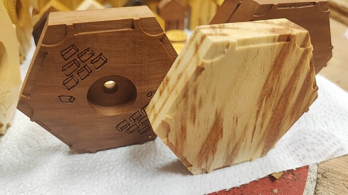

I finally got around to doing the Catan that I had moved back again and again for fear of actually doing it and having to commit to such a project.
A very warm Thank you to @ijustlikemakingthing for providing the files and links to all the great figures in his build thread, whithout them it would have been a lot more work. And it still was a whole lot of work. It took me around 20 hours and I still made a lot of small mistakes (that you may or may not spot) and learned a whole lot. For instance that if you have a very precise CNC, the outer parts will not fit (I mean, you could hammer them in, that fits perfectly, but you actually want them to bit a bit loose so you can take them apart after the game… That was an hour of sanding with a Dremel…), that you really have to take care not to lose 0 when changing the tools (because the roads really barely fit) and that you really have to take care with 0, which was different for my Wenge for whatever reason though I used a touchplate.
I also would make the numbers “go through”. I only made 8mm recesses, but then they don’t fit exactly if your 0 wasn’t spot on (see above).
