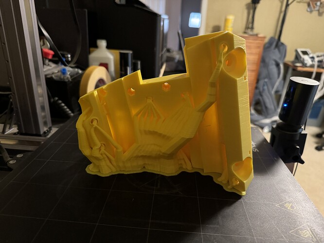

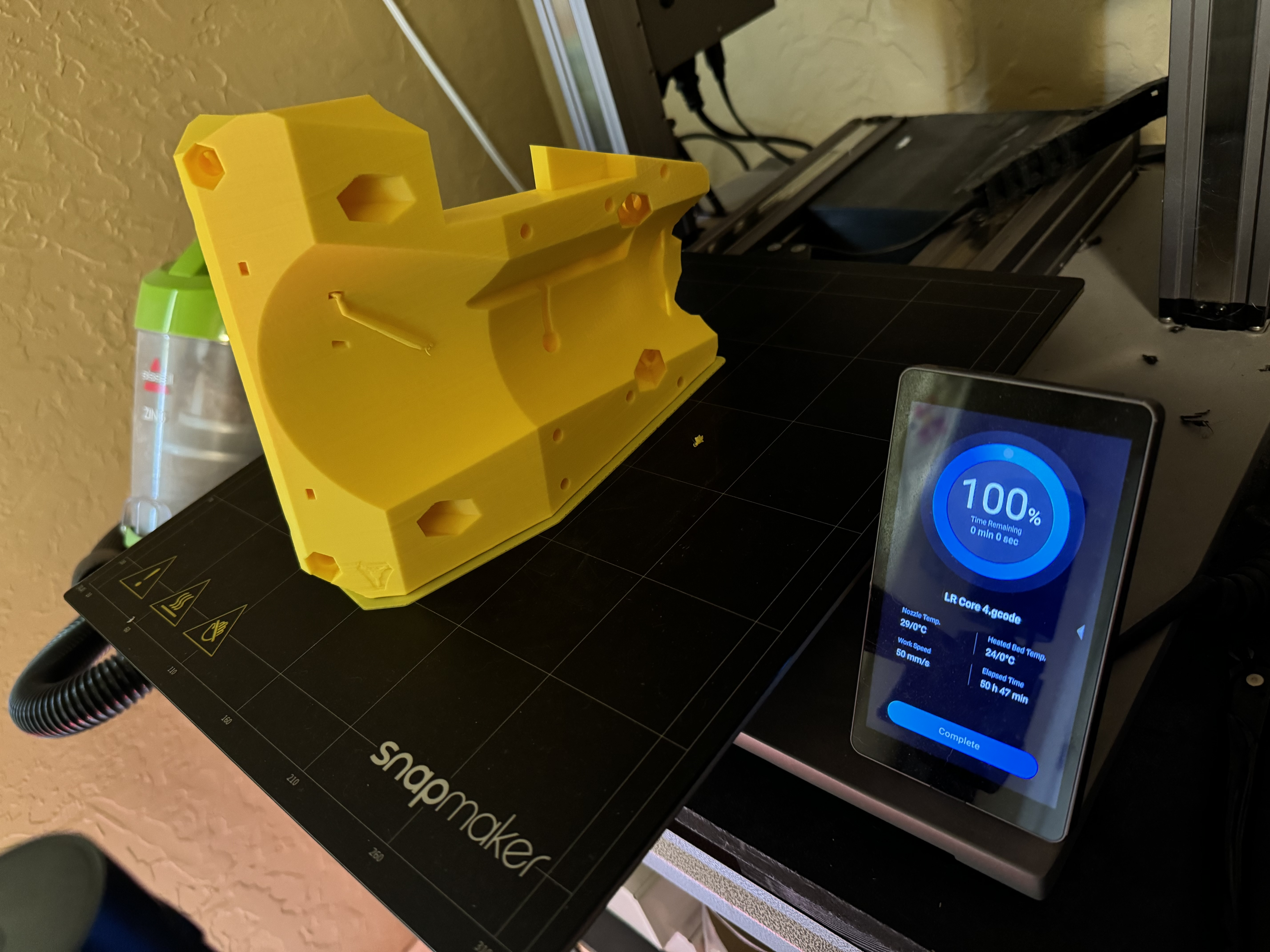

And there she is, just 51 hours later!
Just for future reference, no supports are needed on any V1 parts :slightly_smiling_face:
Let’s just say that my 3D printer runs somewhere between “mildly non-compliant” and “placidly cantankerous” on its best day, lol.

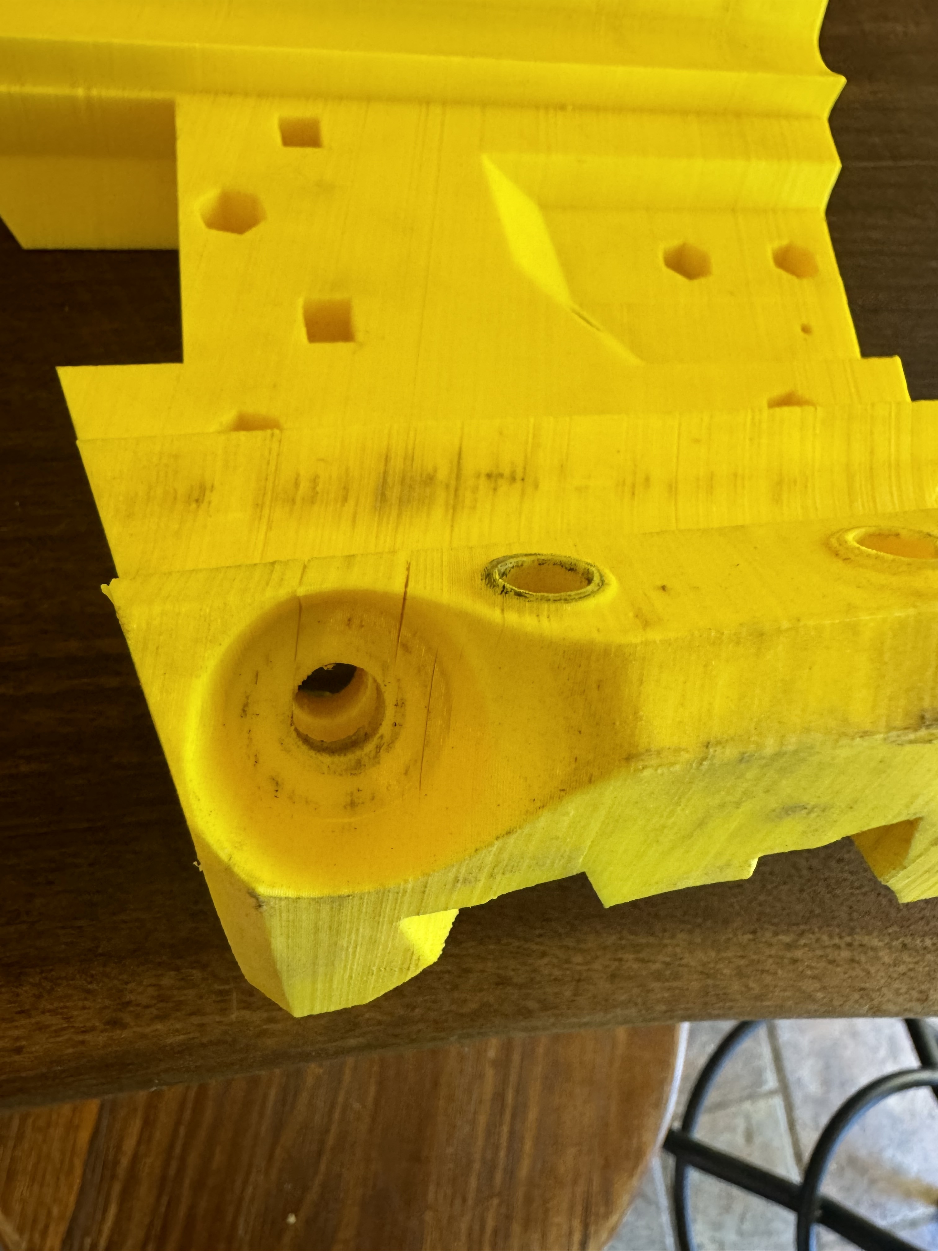

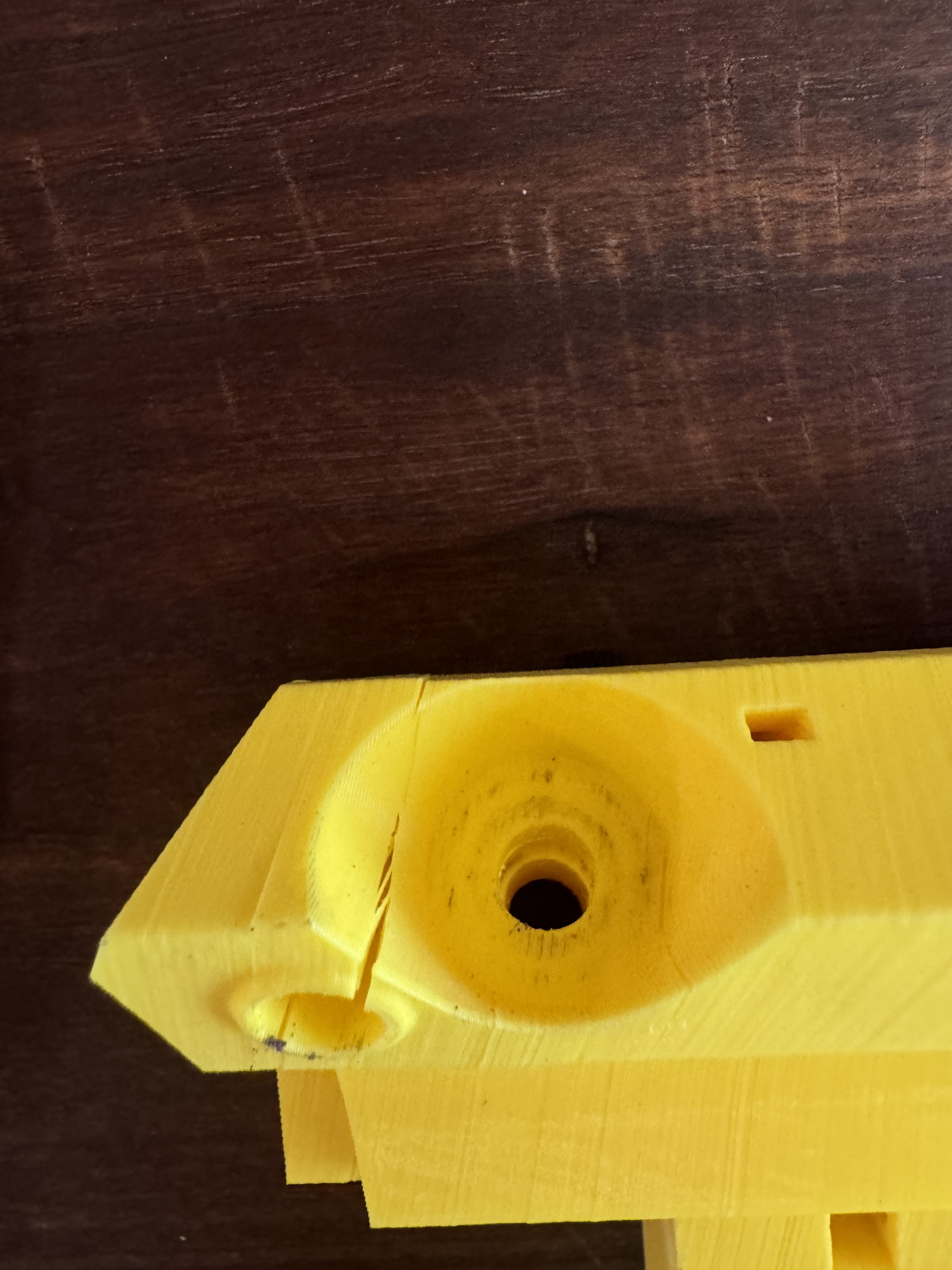

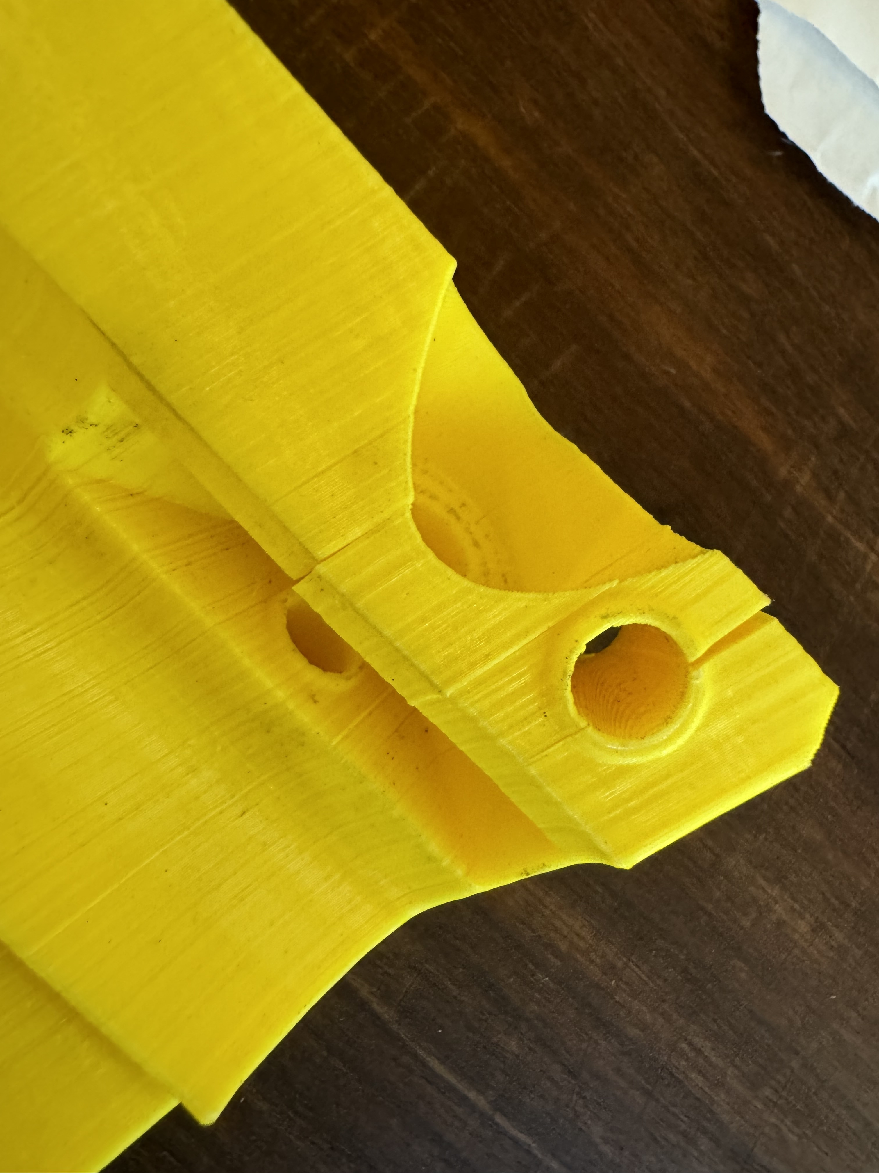

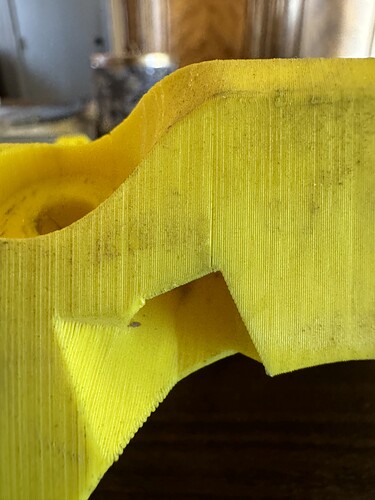

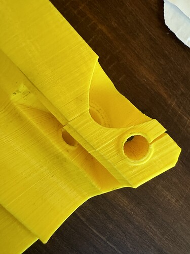

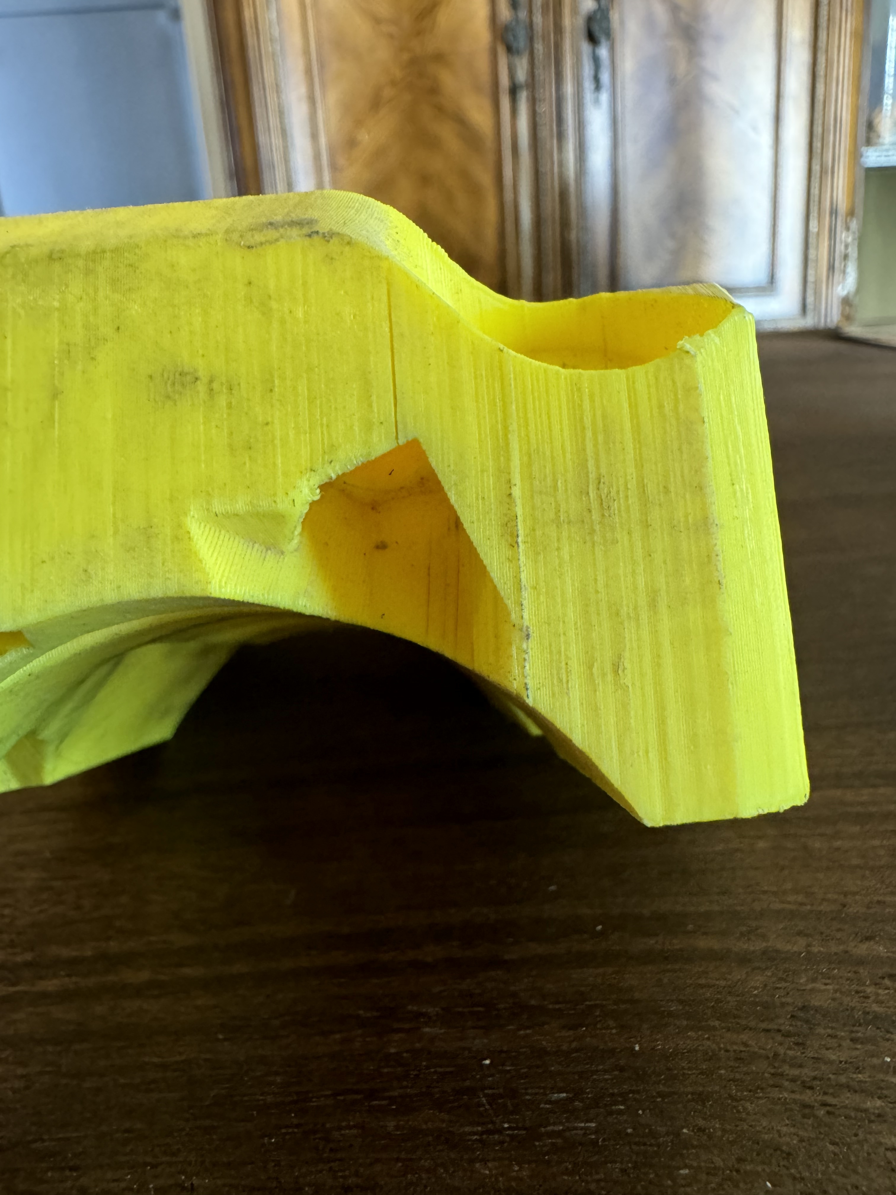

Finally got around to replacing my LR core… found sooo many cracks in my old one. I’m thinking bad print.

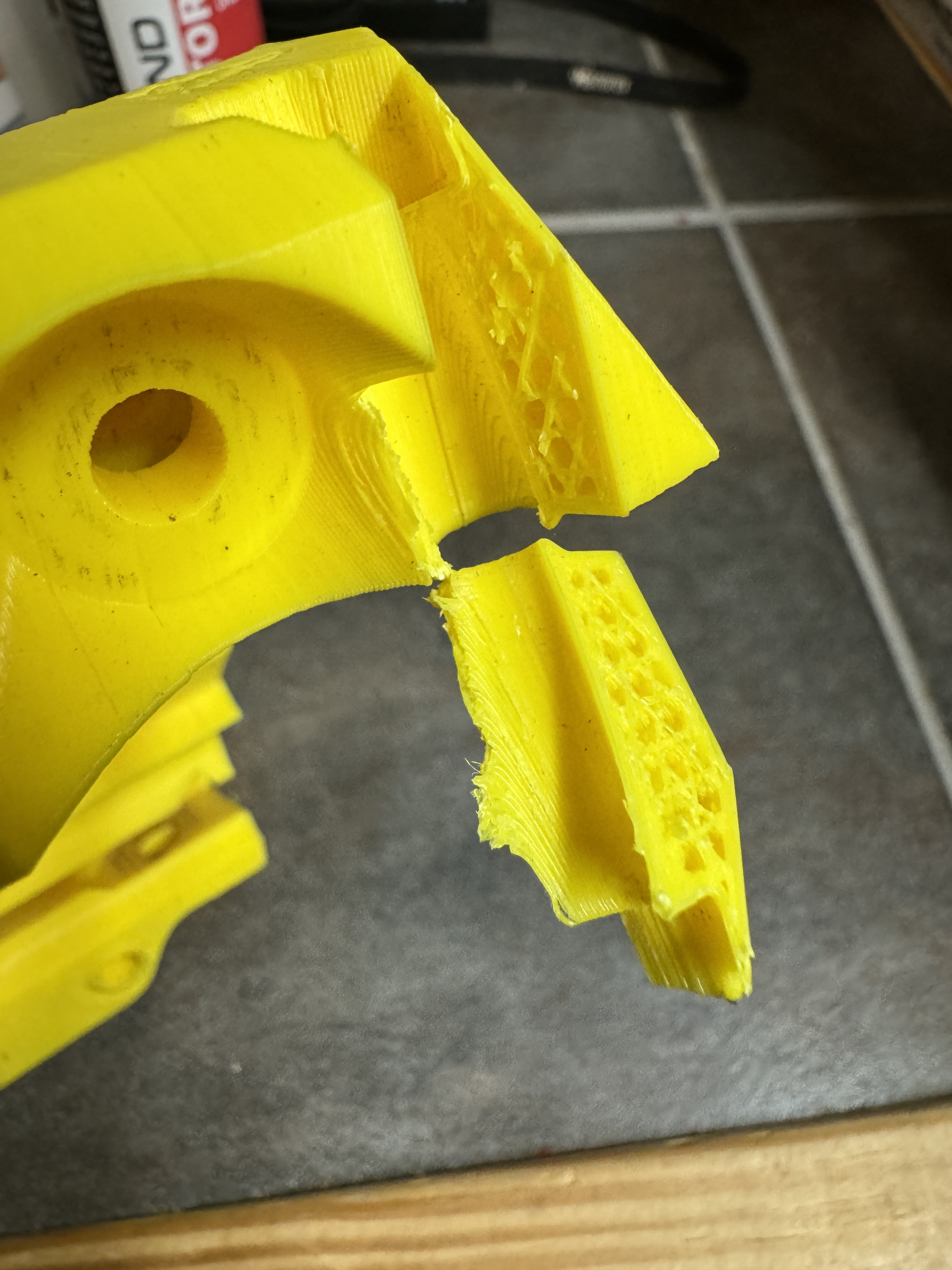

See if you can insert a pry tool at one of the cracks and cause it to fully split out.
If so, post pictures. Bad layer adhesion is a possibility as you note.

Looks like a clean break on the right with tearing on the left. So bad layer adhesion on the right?
That’s what it looks like to me.
