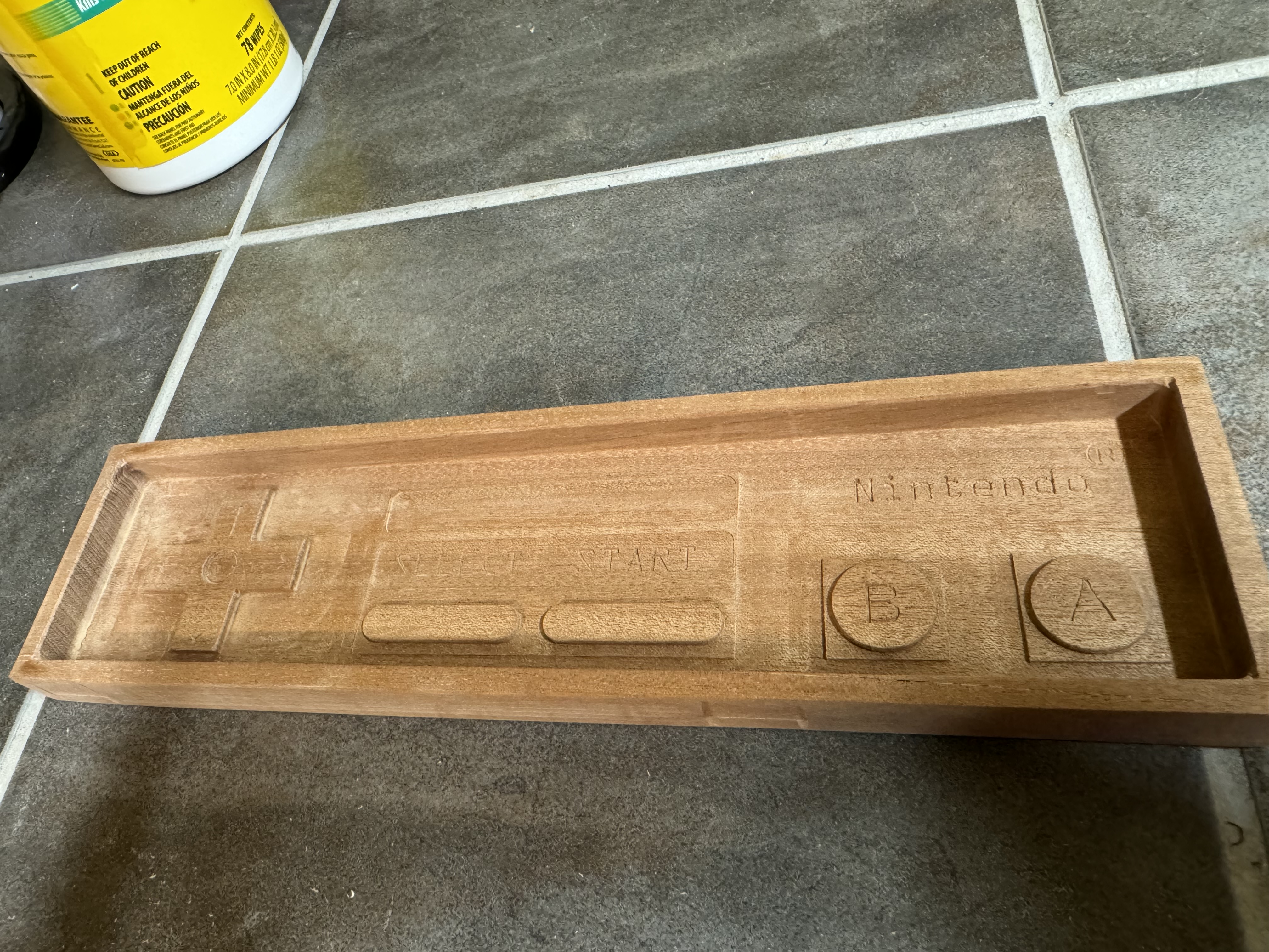

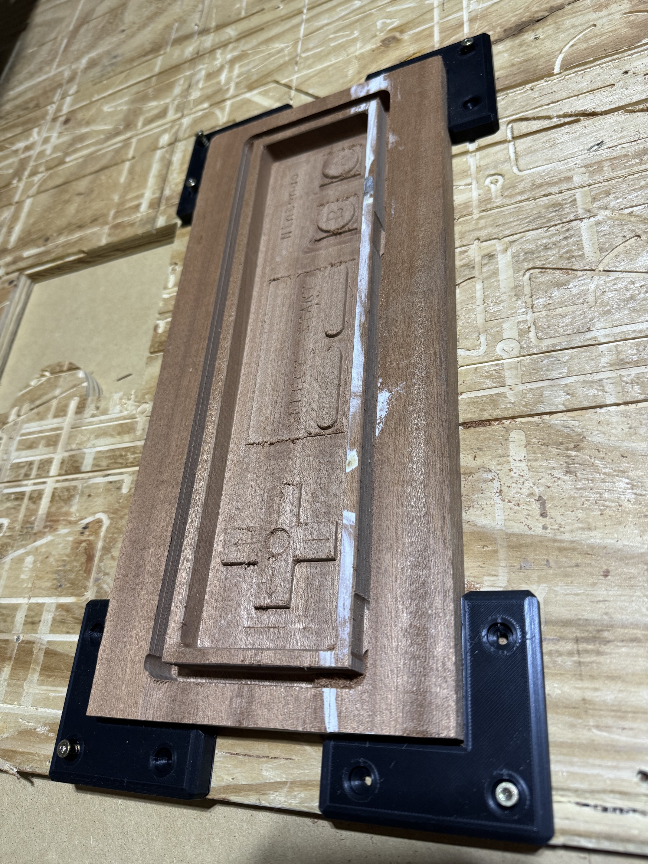

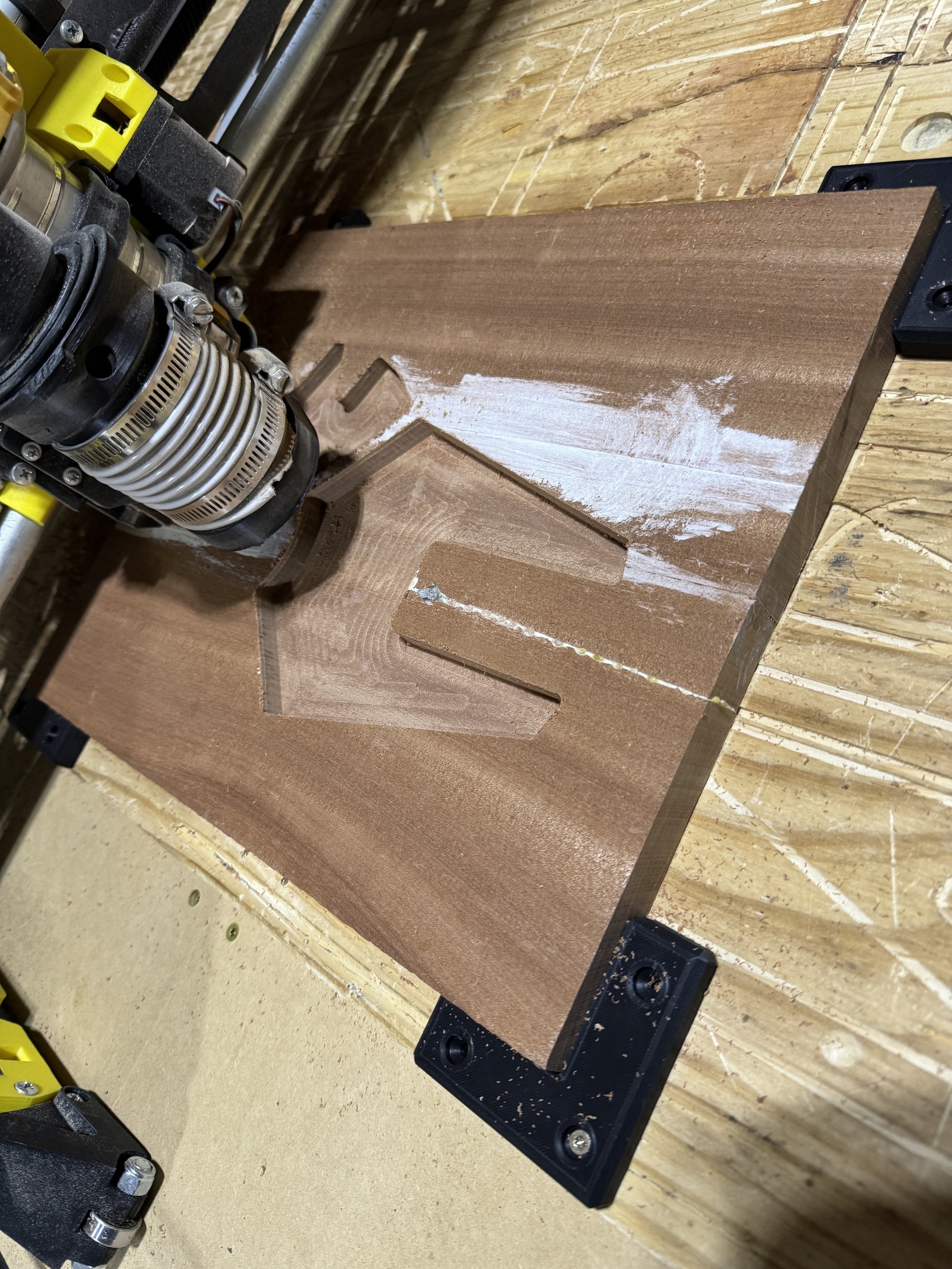

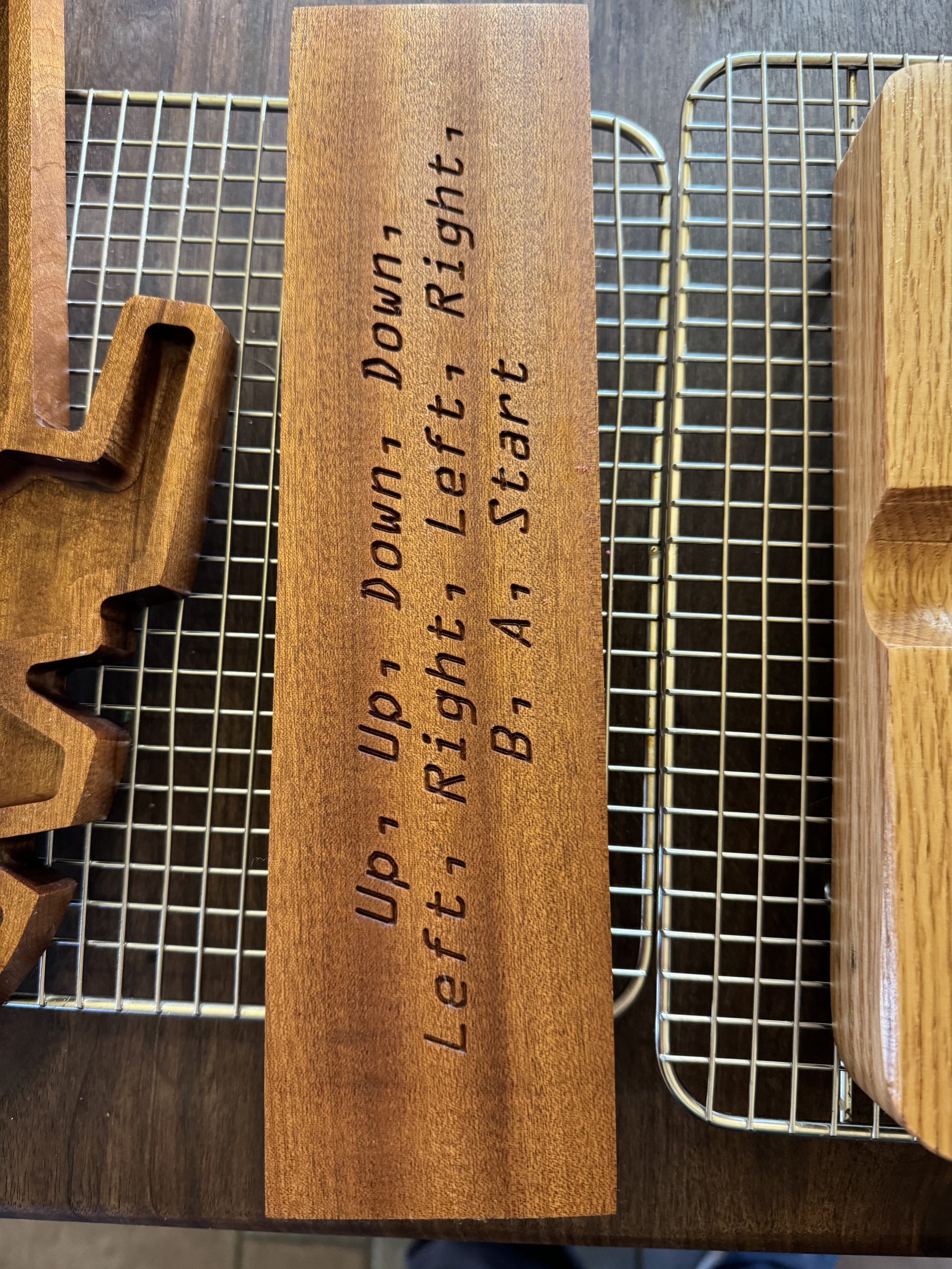

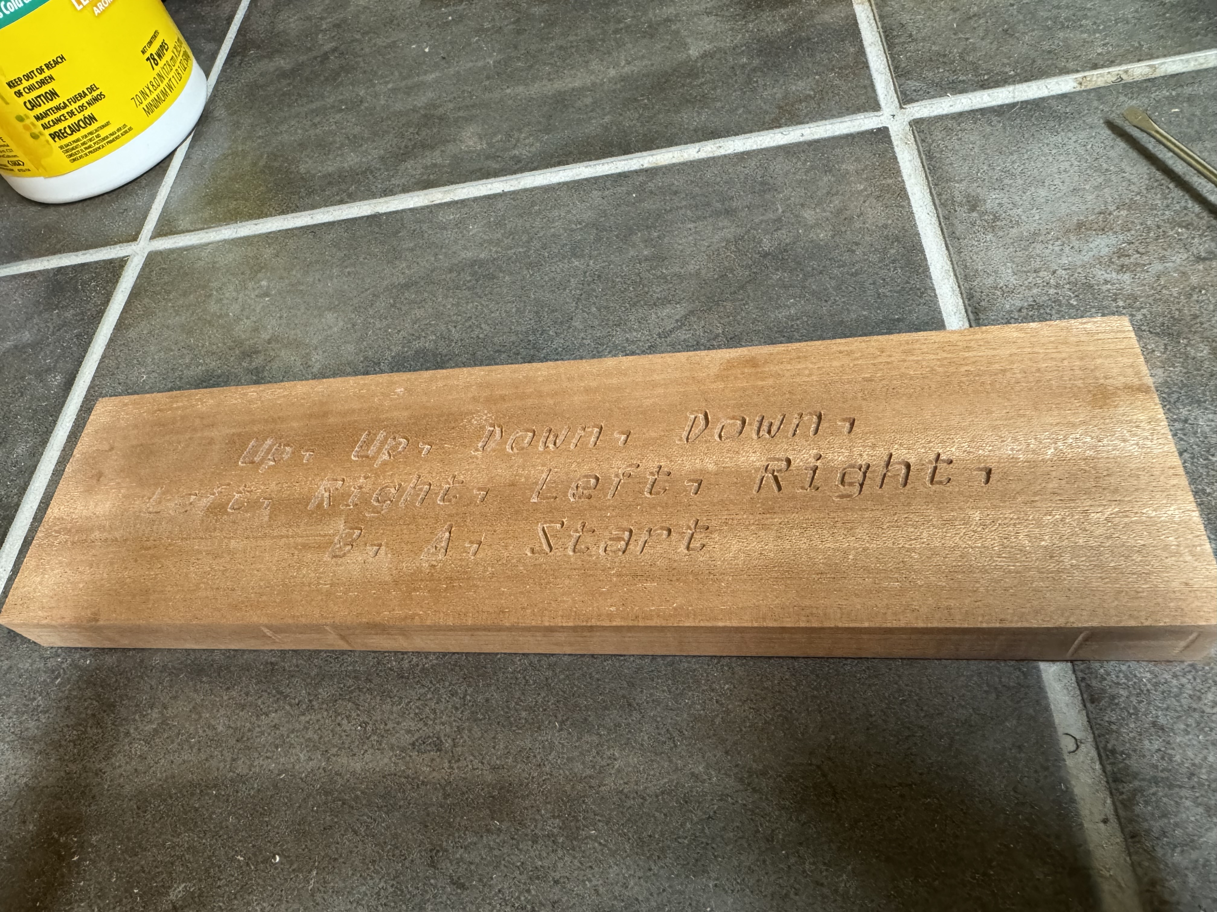

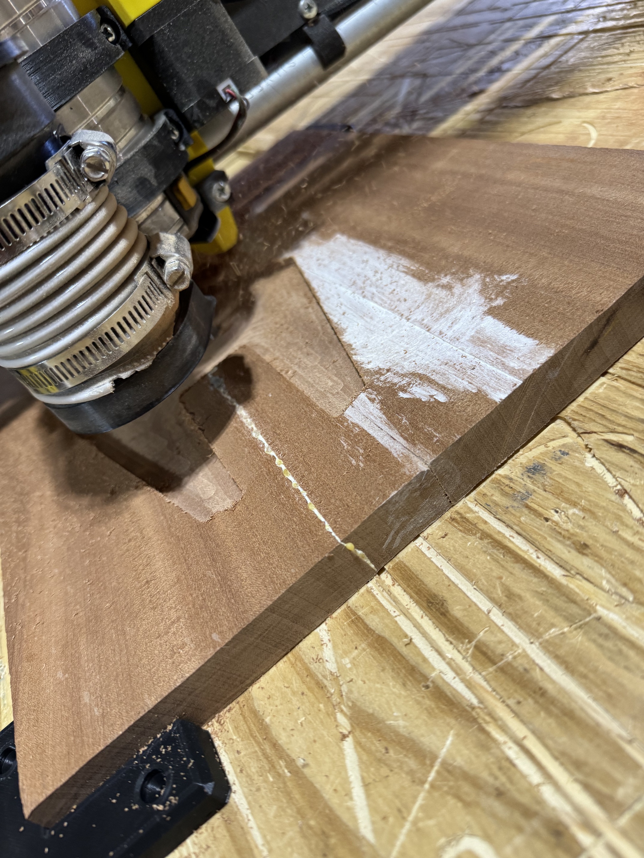

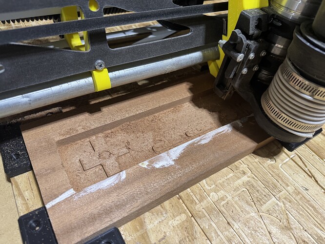

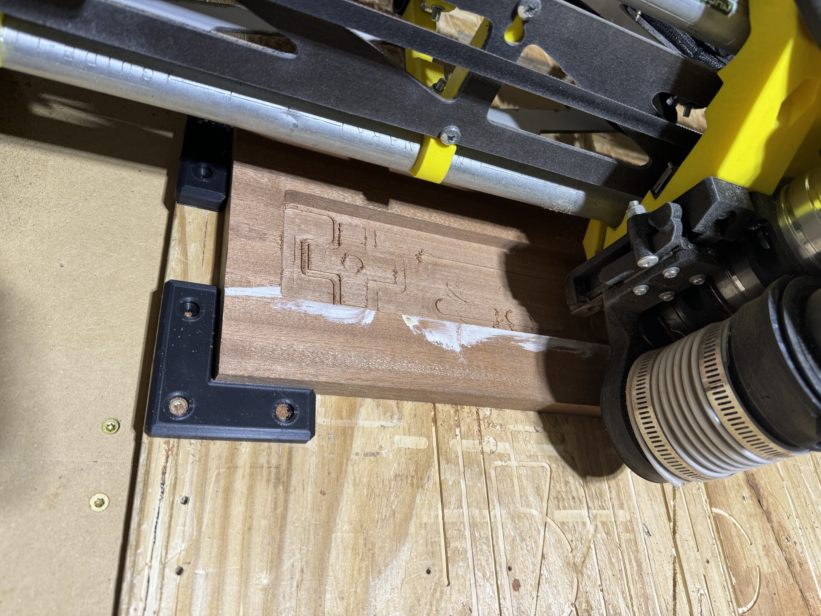

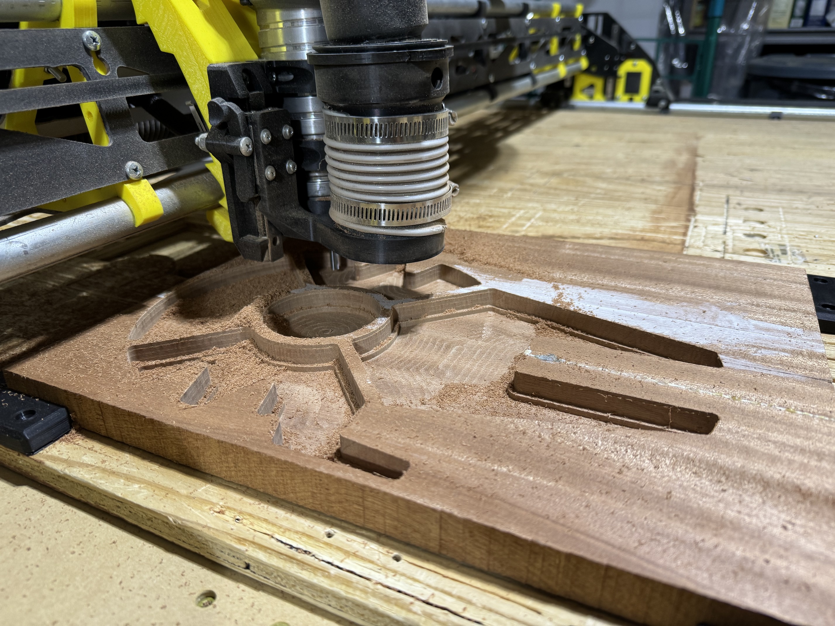

Back to the African Mahogany for some nostalgia… used a 1/4-in roughing but and a 30° V Groove bit to chamfer the corners and engrave the verbiage.

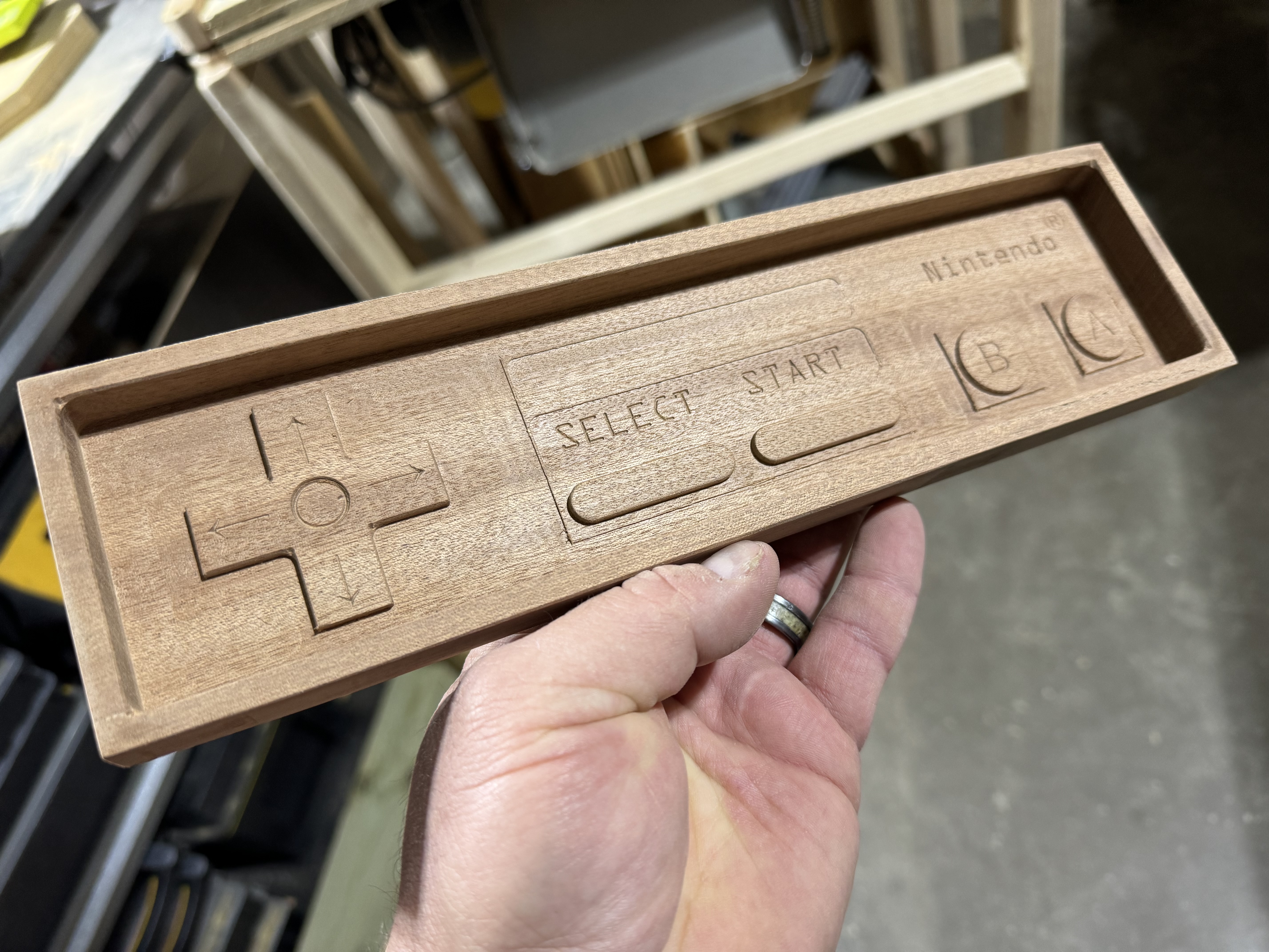

Had some friends talk me into a little more engraving, lol…

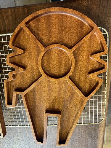

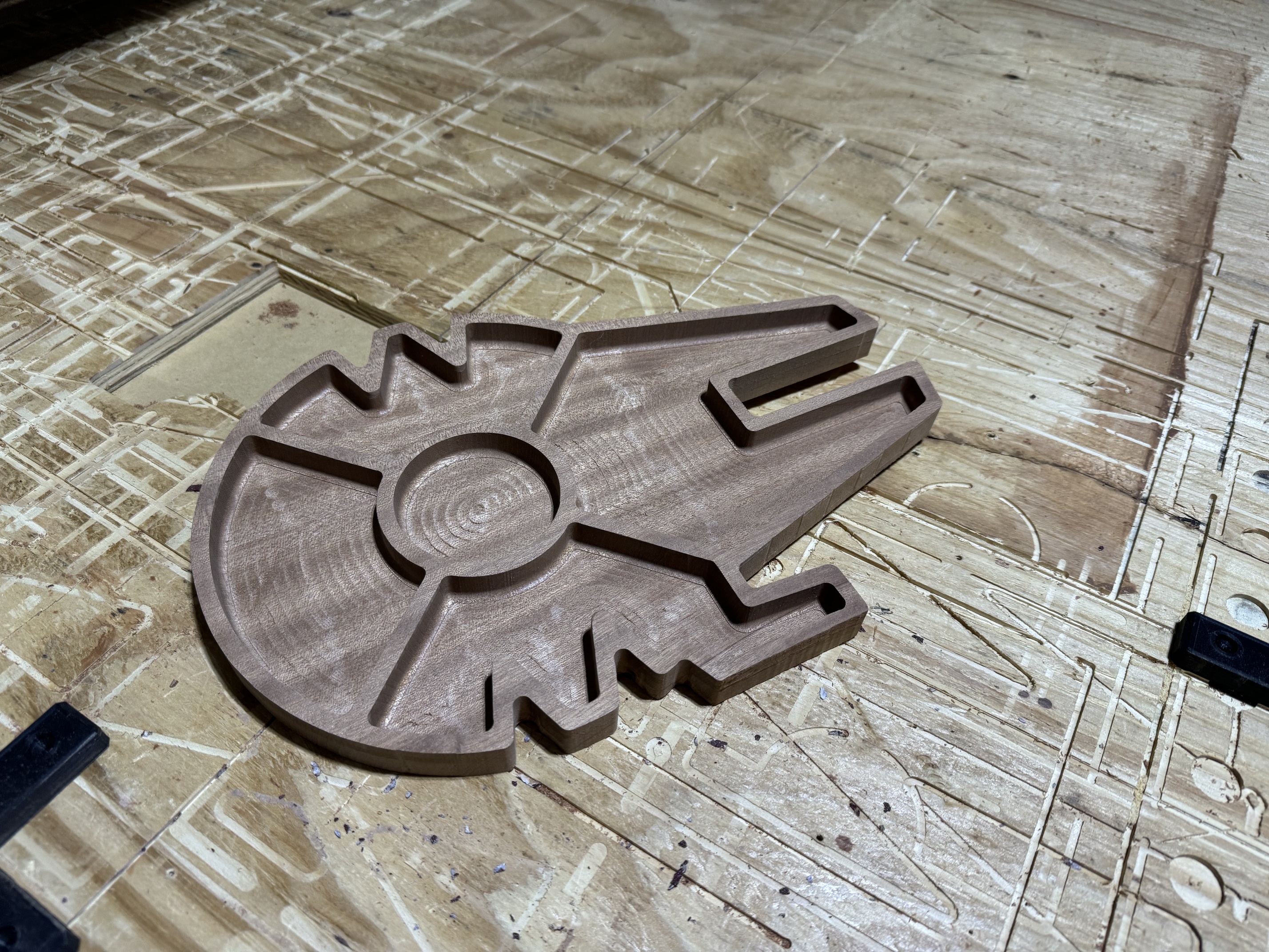

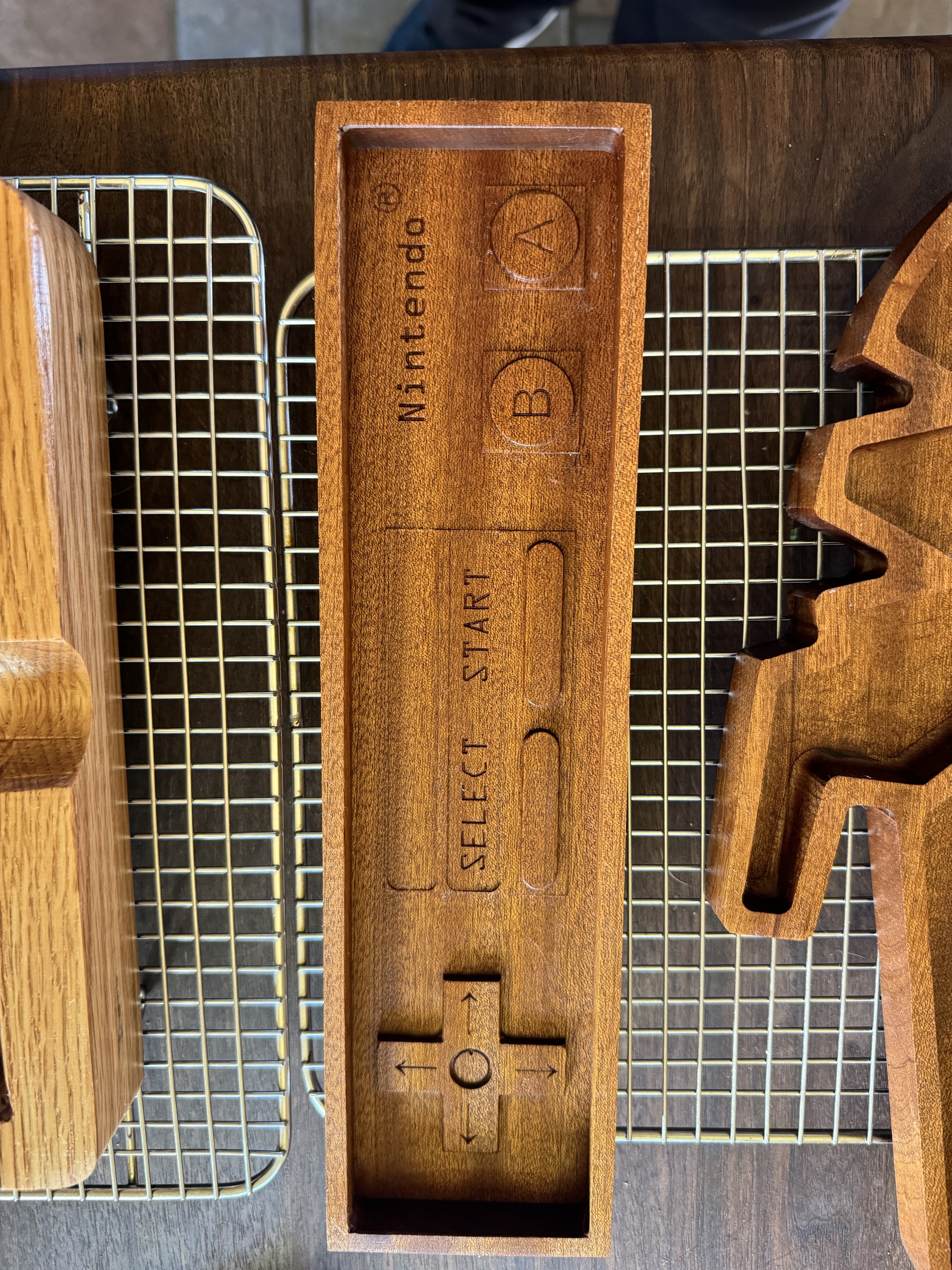

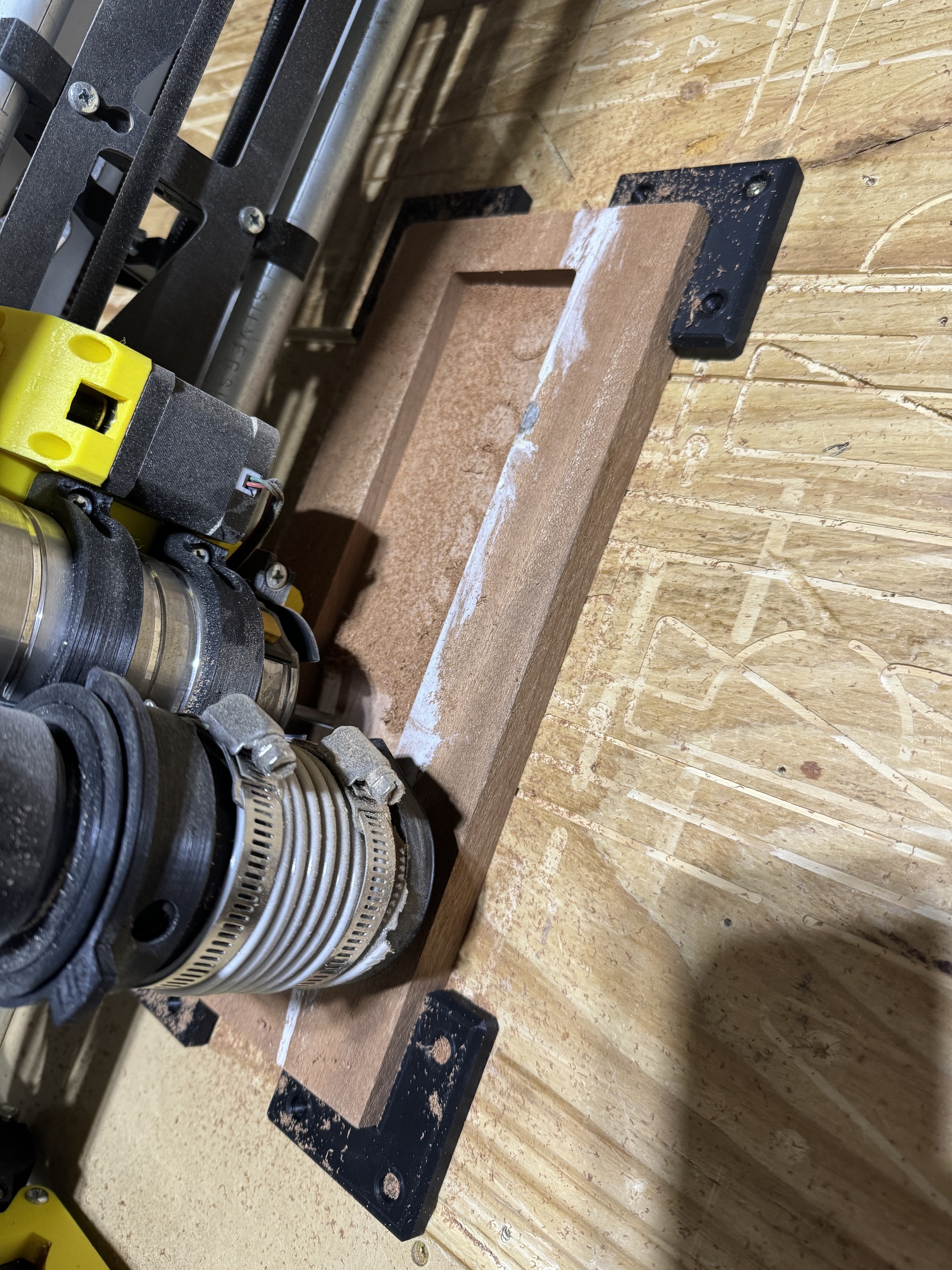

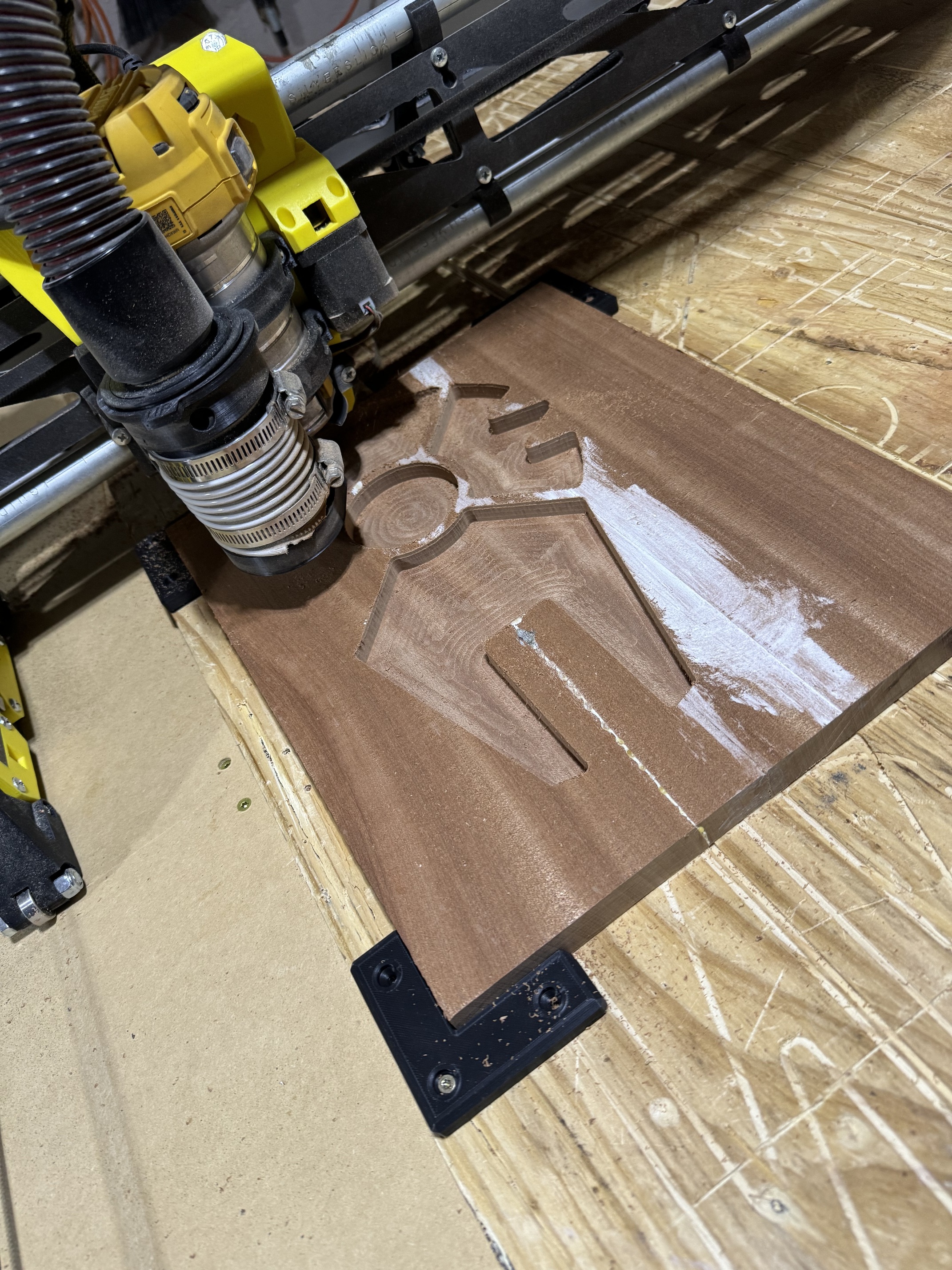

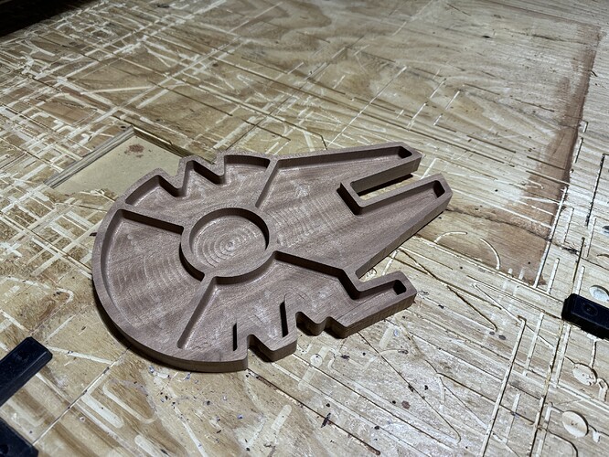

More African Mahogany nostalgia, used a 1/4-in roughing bit and a 1/4-in ball nose to round the inner corners.

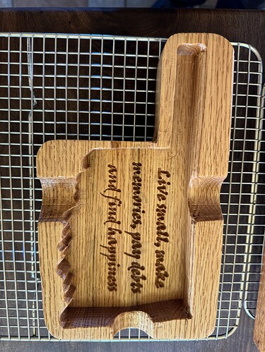

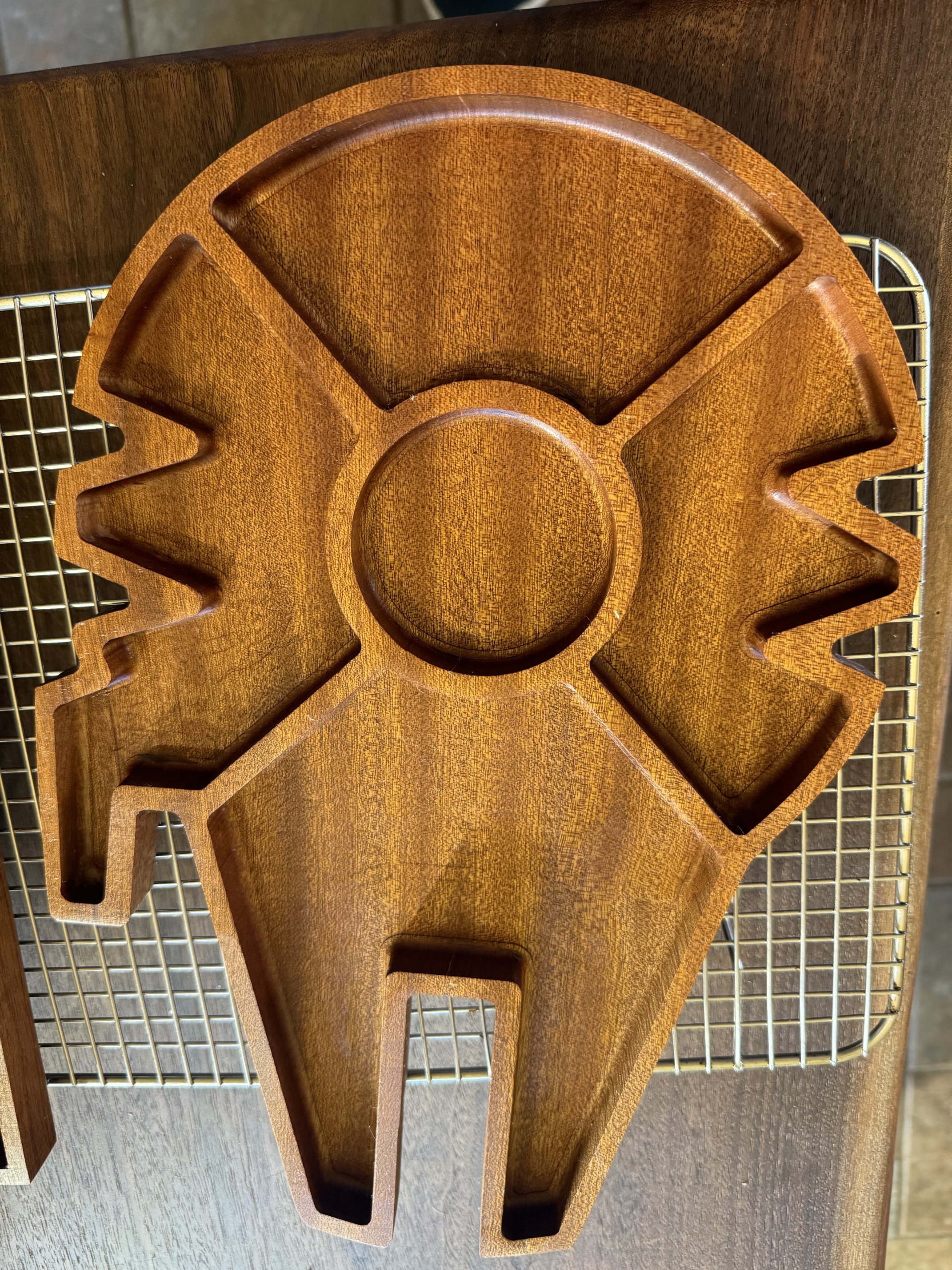

All finished up!
These are awesome.

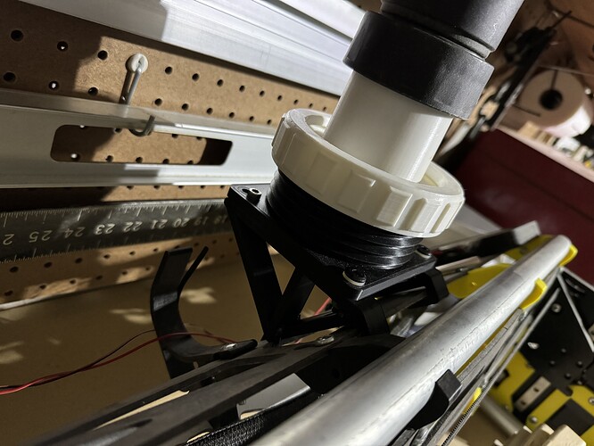

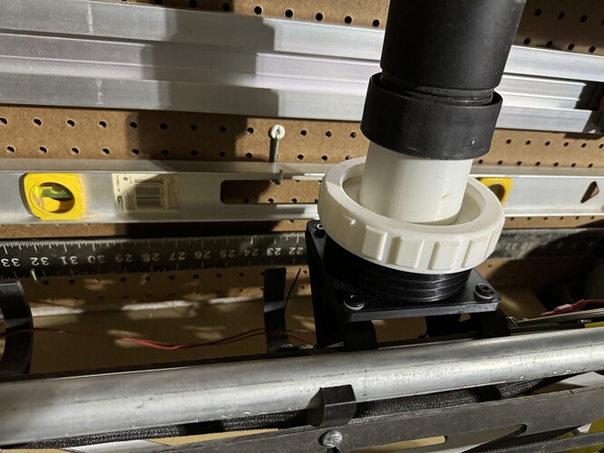

A few modifications made today:
  1. Added a single keystone jack adapter to my SKR Pro case to install an RJ-45 (cat5 network cable) adapter. While my current system for z-axis calibration works, I think I like the idea of a quick connect, usage and then removal from the table better. I think the cat5 cable would be great for this application as it’s a single point connection that’s one-hand insert- or removable. (Also, I have a ton of it laying around.) More on this when my RJ-45 adapters show up from Amazon.
  2. Added a rear gantry mount to lock down my vac hose connection so it’s not flopping around when I move it to/from storage. My vac connects using a customized 4-inch threaded coupler that I threw together in Fusion 360 awhile back, so I just took that same design and reworked it into a surface mount that I attached to the rear strut plate similar to what I used for my SKR Pro case. If anyone is interested in the 4-inch threaded couplers and spin on left-thread hose adapters, let me know and I’ll see what I can put together for pics and maybe a thingiverse or printables build.
Stop hiding those here, post them inThings you’ve made. :smile:

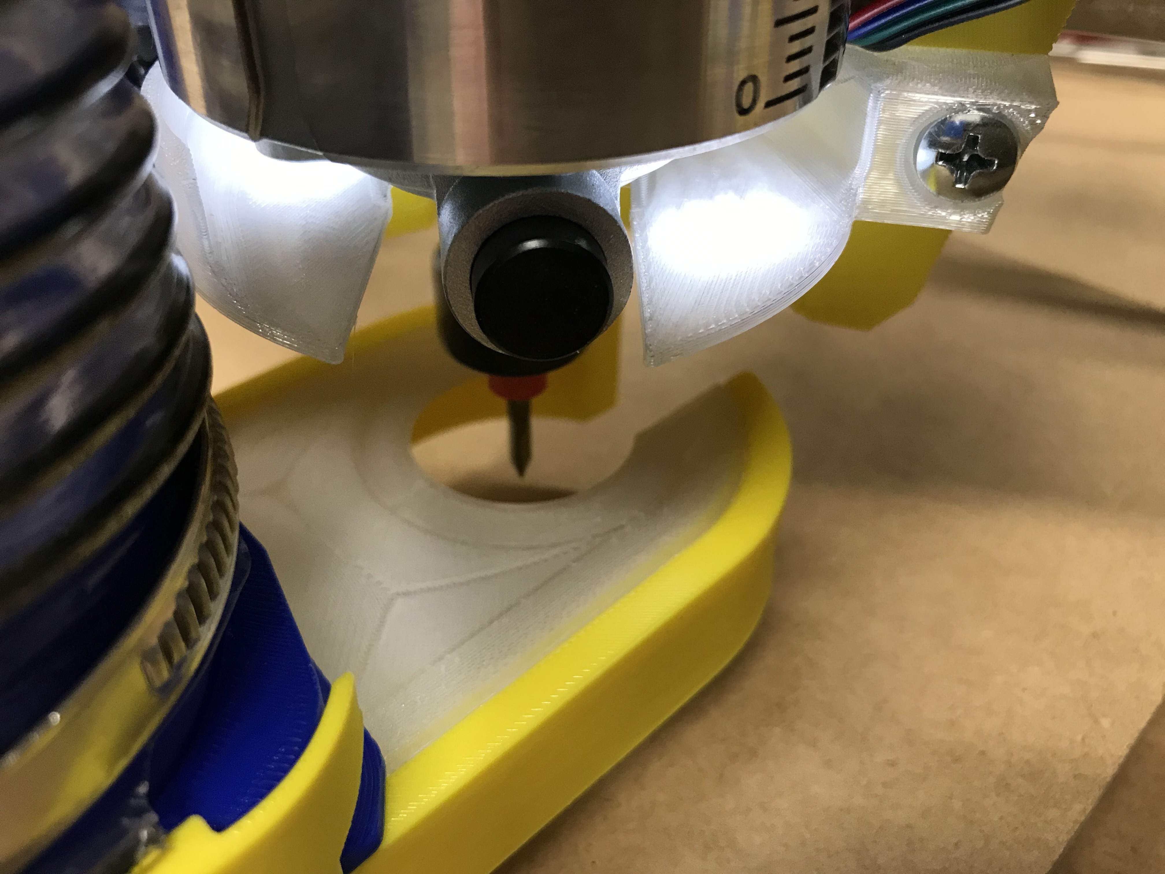

Finally received my Kobalt Trim Router from that sale way back when since I had to ship it to a friend… I don’t see any specific mounting options in the LR3 documentation for the Kobalt router.
@DougJoseph Time to try out your Kobalt free-floating dust shoe mounts!
Already found Ryan’s Kobalt mount @
Printables, includes vac hose option?
See remixes for link to Doug’s vac hose mount. Consider printing clear filament for vac plate part where router LEDs are located.
I have some clear PLA coming this week, but I’d forgotten about this mod. I think I’ll make that part happen!
Doug’s vac hose mount appears to use alternate Kobalt mounts so the floating dust shoe can attach, so I think that’s all I’ll need to get moving on it this weekend.
@azab2c beat me to it… I have printed the same files. Worked just fine
