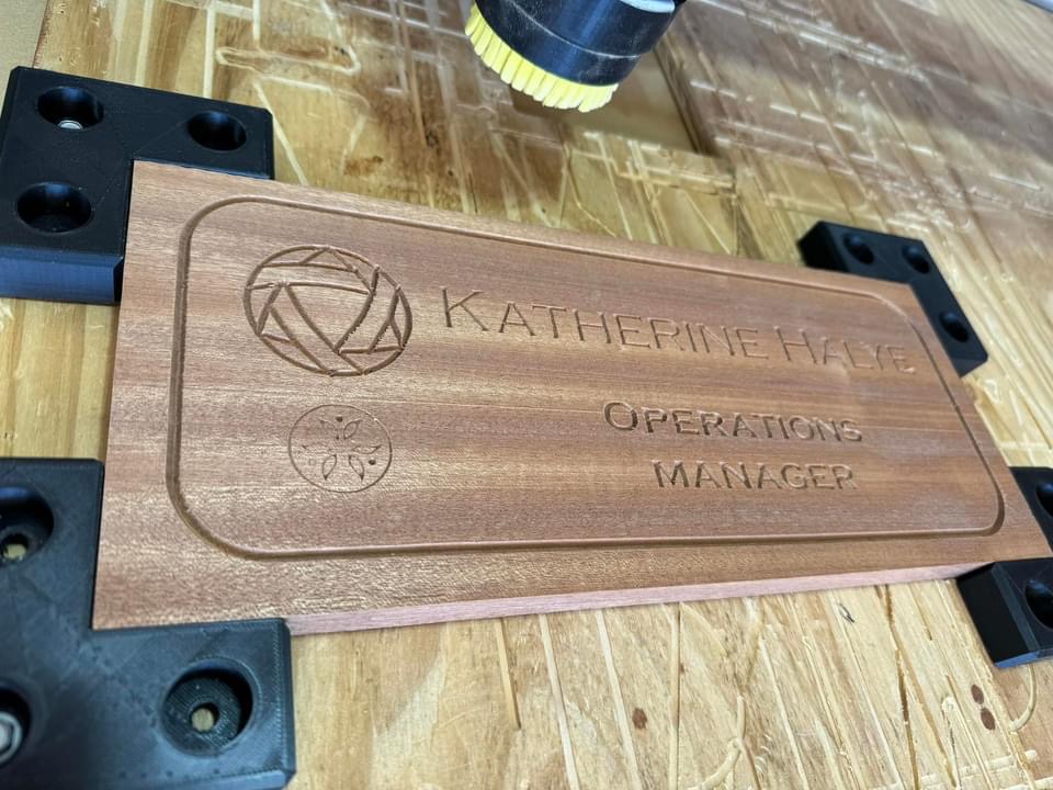

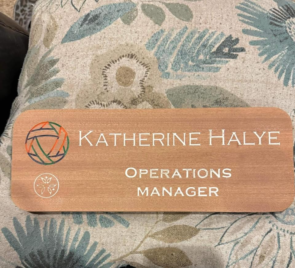

So today I created something interesting for my wife (I am not an artist/painter and the paint could use some work before a clear coat) and learned a lot of things NOT to do, lol…
So, starting off with the good stuff:
The things not to do hit the trash before I thought to take pictures. The good news was that the failures were not on African Mahogany…

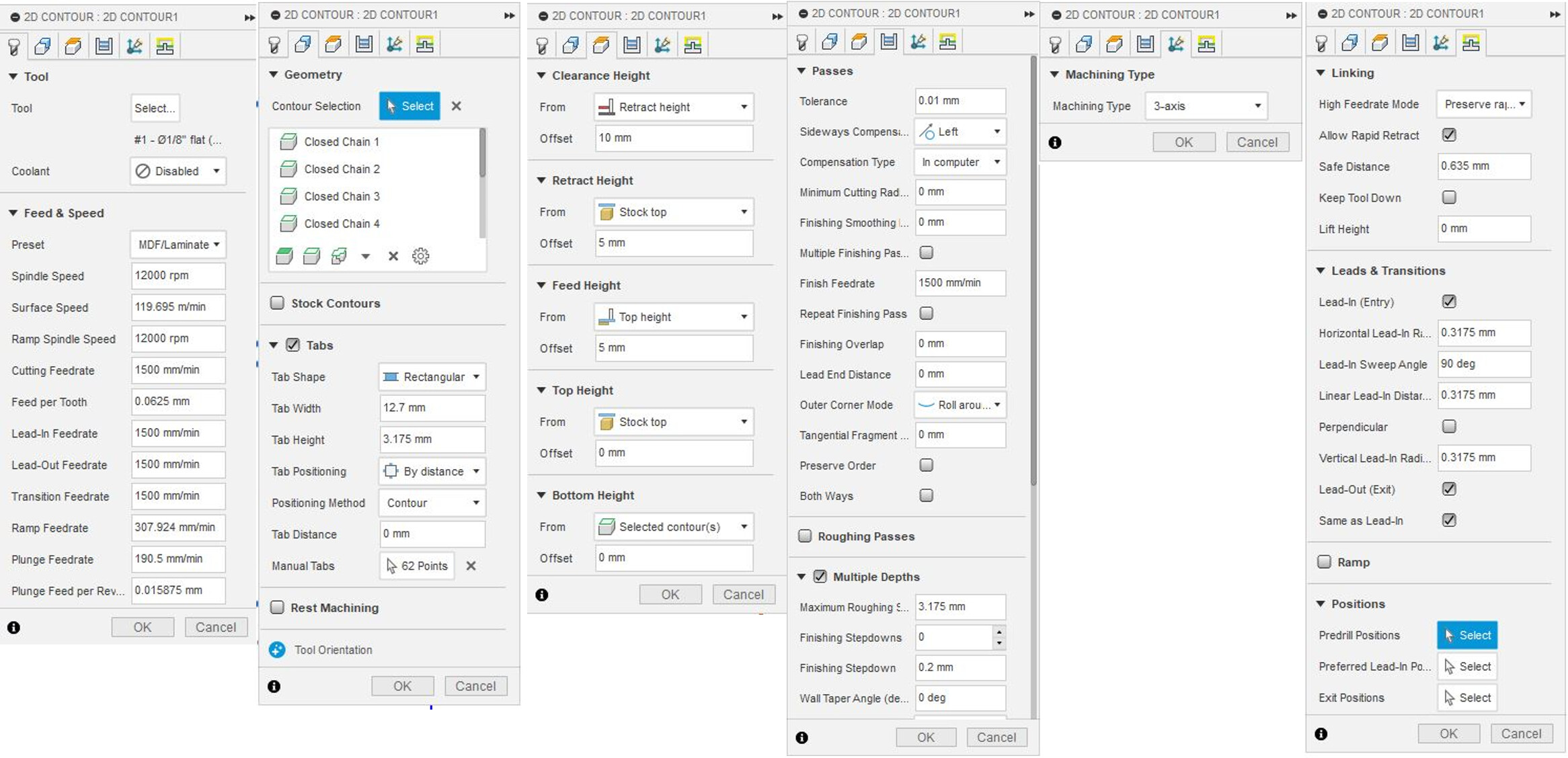

First, if you set up a 2D contour cut and forget to set the layer depth height, it will totally turn your CNC into a full depth cutting (3/4”) full speed screamer that tends to lose steps. I was surprised at how little problems I saw on this, but it still caused them nonetheless. This was my first attempt at using IDC Woodcraft’s The Beast 1/4” Roughing Bit and it worked surprisingly well when unintentionally abused.
Second, sometimes upgrades don’t work the way you thought they would. I altered my dust boot by adding the “Rubber Baby Buggy Bumper” and it caused a couple problems. The boot to struck the side of a piece and did not ramp up, which caused one failure. The bumper also prevented my router from dropping to max depth causing the gantry front wheels to rise during deep cuts and eventually ended up grounding out in a previously cut pocket. Lots of lost steps and destroyed pieces. But, I learned and that’s what is important. Also that I did this learning on MDF. @DougJoseph your original design still reigns supreme on my machine.
Third, when you buy new bits, compare them to your old ones to see if you might need to alter your tool paths. My new 1/8-bit (IDC Woodcraft’s The Badger) is 3/4” shorter than my 1/8” Compression Bit and my LR core grounded out on the surface before completing the cut and ruined the piece. It’s still a great bit, just can’t run it on that job anymore.
Lessons learned today:
1 - If you wire your Y-steppers correctly, you, too, can engrave your wife a cool new office name plate with her name facing in the correct direction.
2 - M17 does indeed engage the steppers, but tightening the collet nut on a Dewalt can still force the X and Y steppers to pop out of zero if you use big old bear paws to torque on that sucker. As with many other things, a gentle touch is better appreciated.
3 - My LR3 can successfully take 1/4” passes at 1500mm/min on plywood and MDF, making much shorter work of jobs.
4 - An efficient CNC dust collection system makes for a much happier CNC operator.
5 - Baltic Birch plywood is both fantastically built and ridiculously expensive, but damn it’s pretty.

Do you mind sharing some other details about your contour setup in fusion? If you’re doing left or right compensation and finishing passes etc. I’m still trying to hone mine in a bit, would be nice to compare to others!
Good work so far!
You sir, are not wrong, that should be 1500mm/min.
I’m not sure what you mean about compensation, but I’m allowing for cutting in both directions on pockets and I believe I’m using climb on the contours. Also just a single finishing pass at 0.2 mm if I remember correctly.
I can get you my exact cutting parameters when I’m messing around on it tomorrow. Hell, you’ll probably end up giving me pointers on stuff I’m doing wrong. I’m new at this and a lot of people prefer Estlcam or VCarve software over Fusion360 so it’s hard to compare.

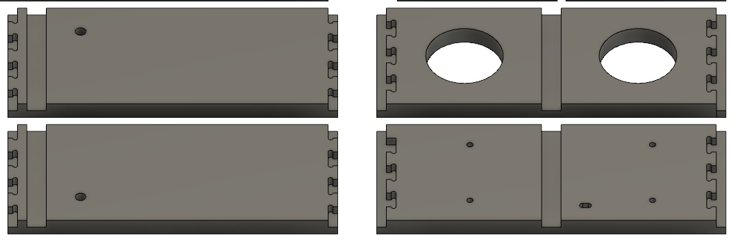

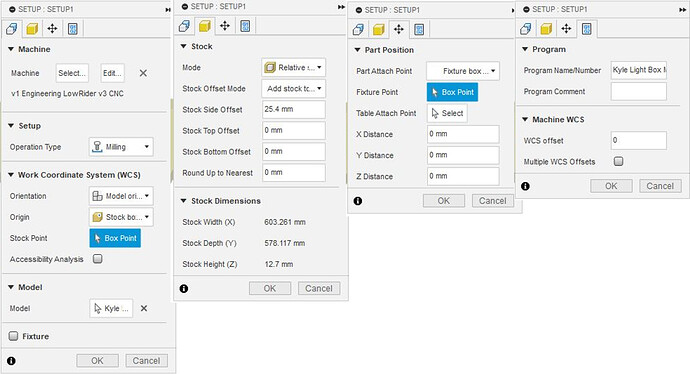

However, I’ve gotten fairly decent at designing things in Fusion 360 since i can sort of play with that at work. I really like these blind box joints I’ve been making for boxes.
Let me know if you see anything that looks crazy.

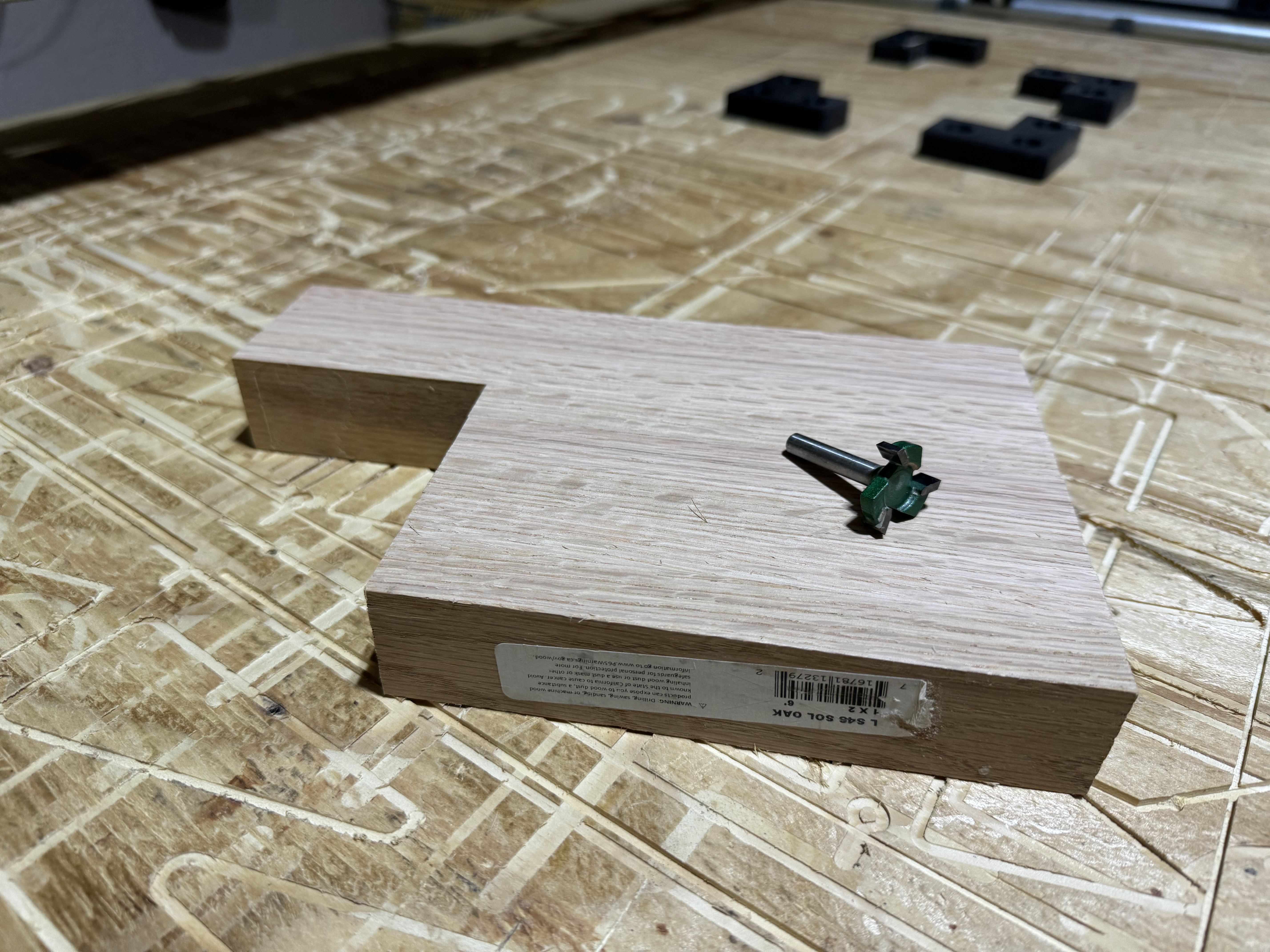

First try at Surfacing using a Kowood 1-in diameter 1/4-in depth 3 flute surfacing/slot cutter bit.
It will hopefully end up as a custom engraved Oklahoma shaped cigar ash tray.

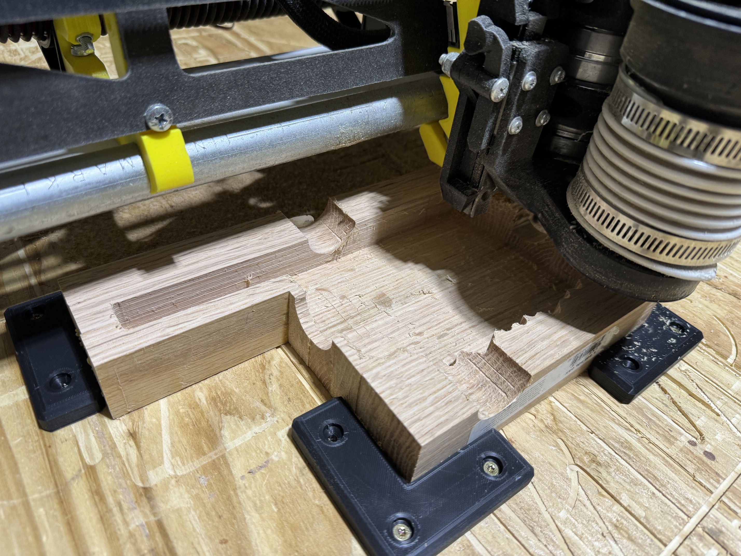

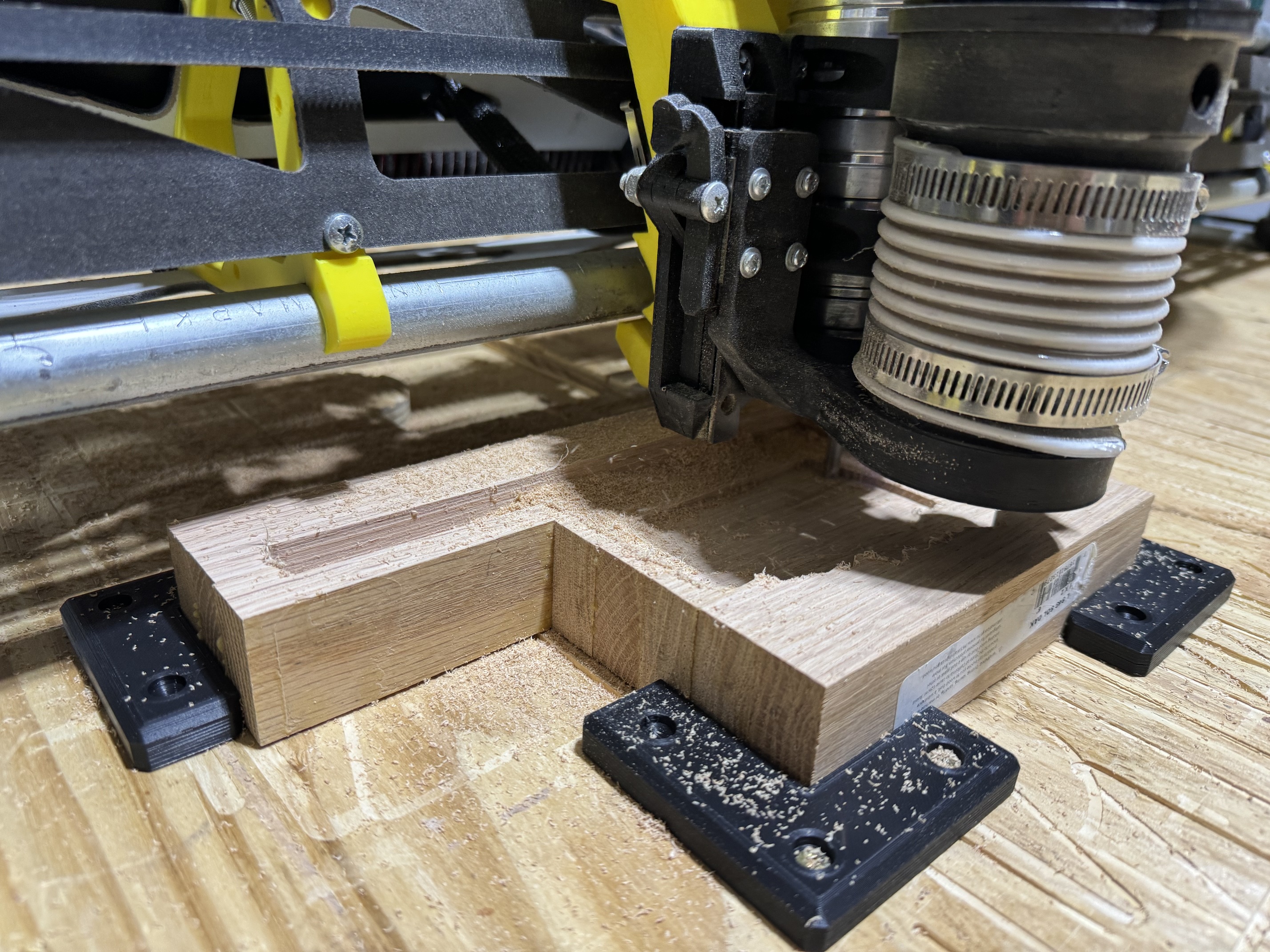

Pulled the dust shoe in case it caught an edge, so I’m on shop vac duty for this one, but the Oklahoma pocket is looking pretty good so far!
And.:. My v-bit is too short to get down to the bottom to engrave it.
Ooh!!! My Snapmaker has a spindle that sticks down pretty far… maybe there’s a solution without having to go buy more stuff, lol.
Update
Snapmaker for the win! Nice deep 60° engrave for a quote a friend wanted. Still needs a little sanding and cleanup around the outside, maybe a couple feet on the bottom and some mineral oil.
