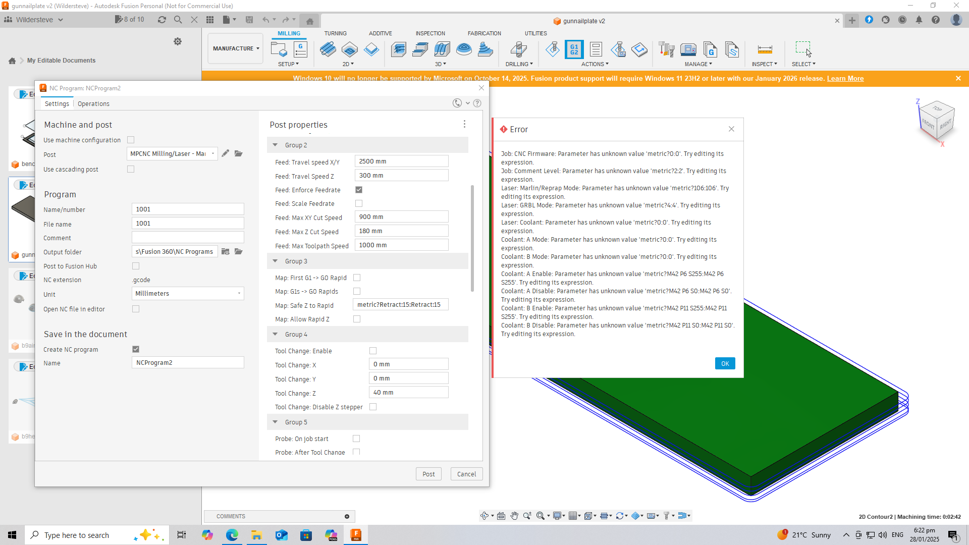

Hi
Fusion did update (28/01/2025) Now cant post cam Im using one recomend (mpcnc.cps from flyfisher604
any ideas would happy thanks
It happened to me too caused by an update of fusion.
Solution: Use the postprocessor version 3.0 (beta) - it worked fine for me (I just did a 2D-cut on my router).
Fusion 360 Post Processor MPCNC v3.0 (Beta 3) is Available
