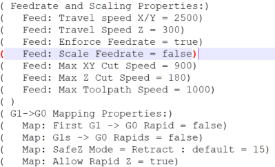

One suggestion would be to include a screenshot of recommended settings within the PP window.

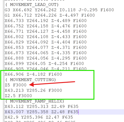

I used the PP a few times and didn’t understand that I needed to manually check some/all? of the “Map G1→G0” boxes. I still don’t fully understand which ones to use & why.
Consequently, not checking these boxes led to the characteristic bit dragging across the workpiece at the start.
.. And 50m/s Z moves? No doubt user error in CAM settings. Do I need to check Scale Feedrate to have the postprocessor save me from myself?
