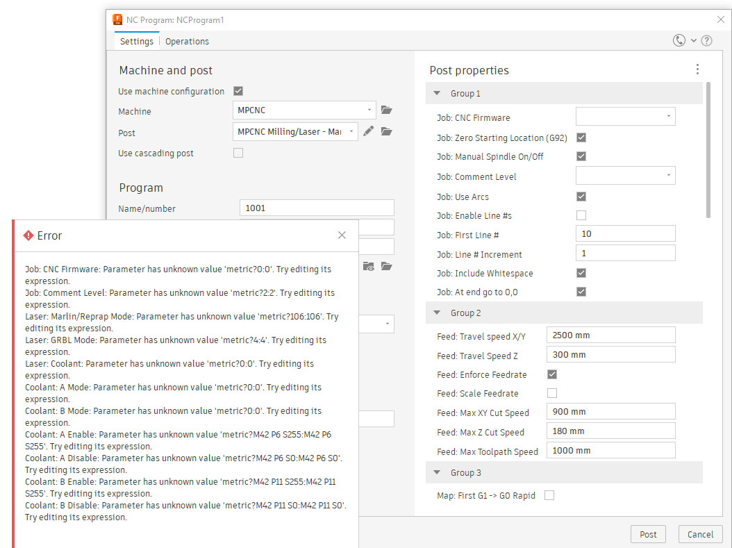

I am using Fusion 360 to generate a post using mpcnc as my machine. It says “cnc firmware: parameter has unknown value 'metric?0:0. Try editing its expression”, and 11 similar. I am simply try to machine/engrave with a tool, and not using a laser. I can "generate, and simulate, but when it comes to Post process I get the following:

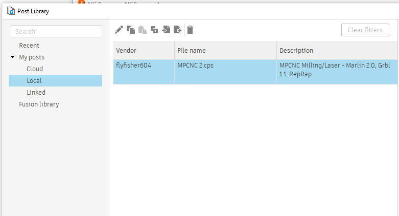

Making an assumption here, recently fusion changed a bunch of stuff and it broke a bunch of post processors due to how it handles parameters, there has been an updated one since
Thank you, that fixed it, after 3 hours of tinkering, thinking it was my mistoke.
