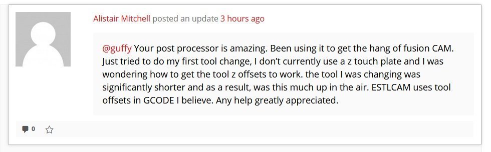

[attachment file=106164]
@amagicalwizard the PP is not designed to support fixed tool offsets, sorry. imho, it’s impractical until you change tools manually. so you have to build touch plate
(by the way, strange way to ask. tagging a person in own “Updates” message. first thing that i see is that there no way to answer)
You make a fair point, at the time contacting you that way made perfect sense.
Cool as long as there’s a legit reason for it and not just me being inept then that’s fine, thanks for the speedy reply.
