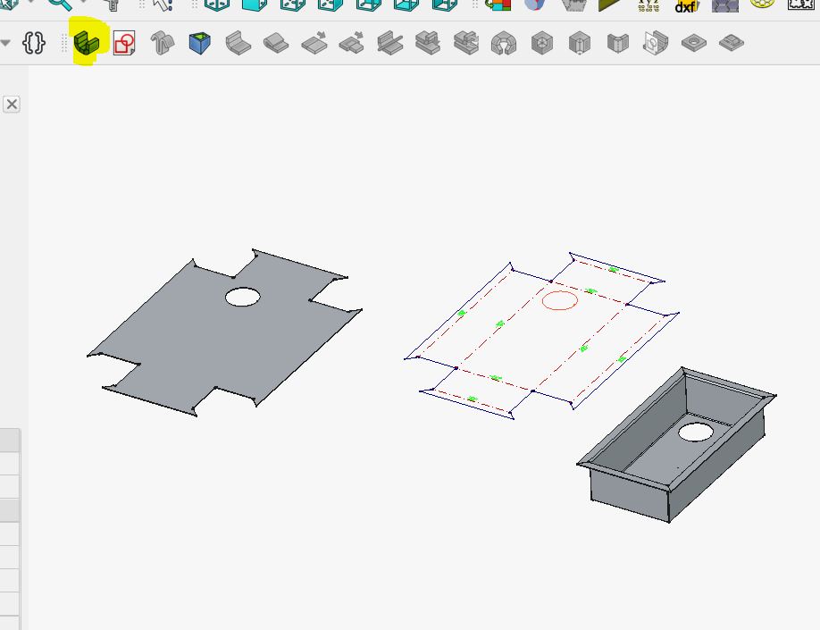

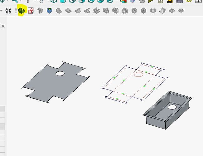

try the sheet metal work bench in free cad , ive only played with it for once so cant help to much , may be helpful to you but went from right to left in 10 min
click highlighted which creates your shape on right , drop down to choose box angle channel etc , than go to part bench add holes etc , back to sheet metal click unfold and you end up with this
