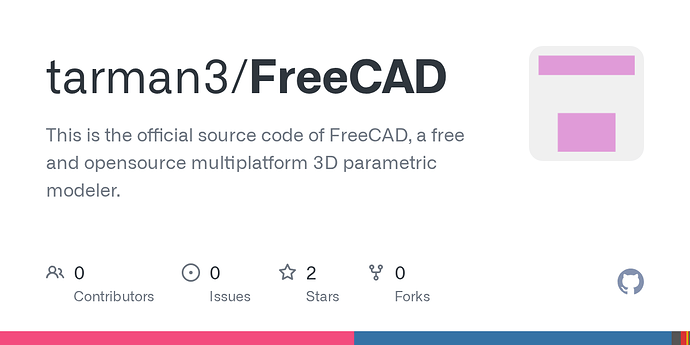

Check this out, the FreeCAD guru at the local makerspace just made me aware of a branch that has all the open CAM pull requests rolled up in it:
The Cam continues to improve steadily. There’s a bunch of development activity.
That guy Tarman3 is an active participant on the CAM “Big Board”, where cam development, in-process feature/fixes status, and completed issues are noted and discussed.
Stuff in the Done column often ends up in the next weekly “WIP Wednesday” Dev Release.

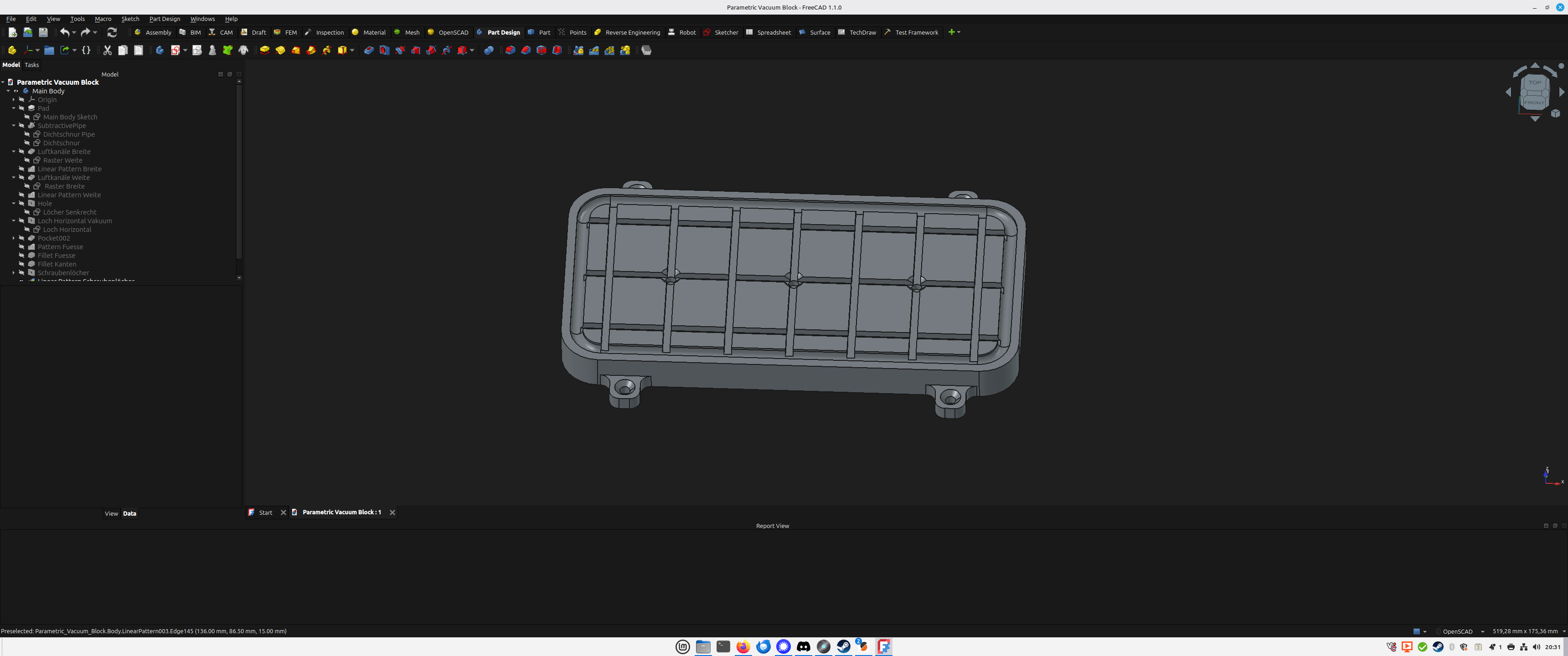

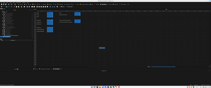

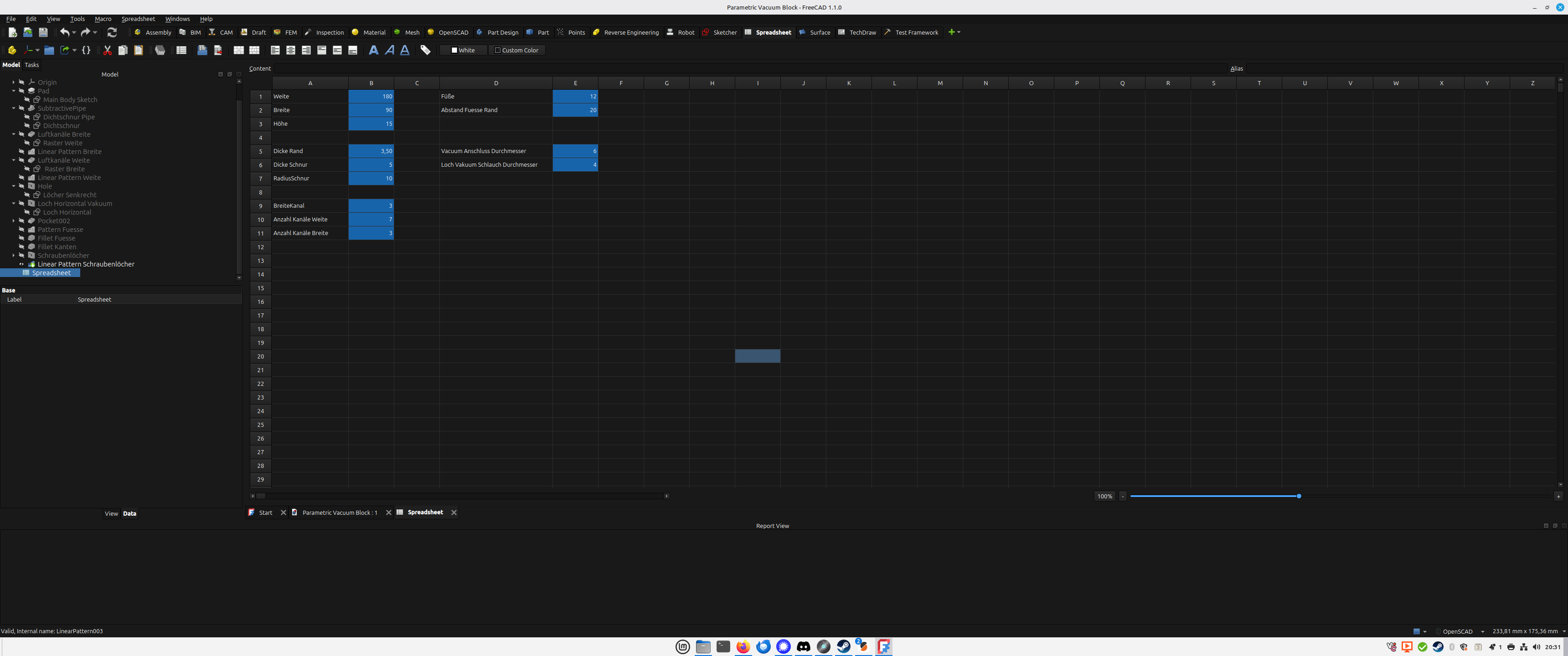

I made a parametric vacuum block today:
Took a few hours, but you can now basically configure everything you could ever want. There are a few restrictions: it can’t be smaller than 80mm, it should have an uneven number of channels in both directions (because you want the hole in the middle to be at a “cross”, though technically it should also work with an even number, just looks stupid) and it’s going to complain about not being able to fit the two outer holes when you have less than 5 channels for air, it will still render though.
Parametric Vacuum Block.FCStd.zip (593.0 KB) (new upload, found an error).
I am now printing the first two blocks, if it works I am going to post them under “Things you’ve made” and on Printables. :slight_smile:
I am also pretty sure some of the design decisions (or rather how I got there) are questionable at best, the formulas I used are (probably) needlessly overcomplicated, but I wasn’t able to solve it any other way and it seems to work. I’d be happy if you fiddled around with it a bit. :slight_smile:
I scaled it up until 800mm x 500mm, it sometimes throws errors, not sure why, but most of the time it works. If it doesn’t, close the file, reopen and slowly approach the target value… :smiley:

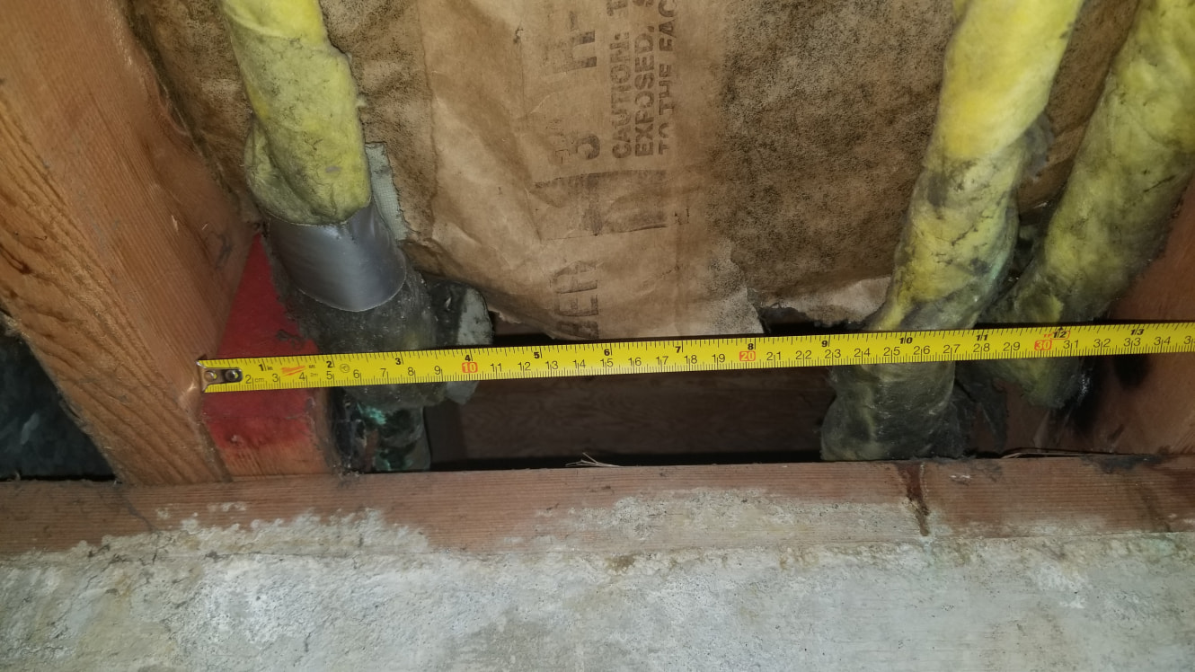

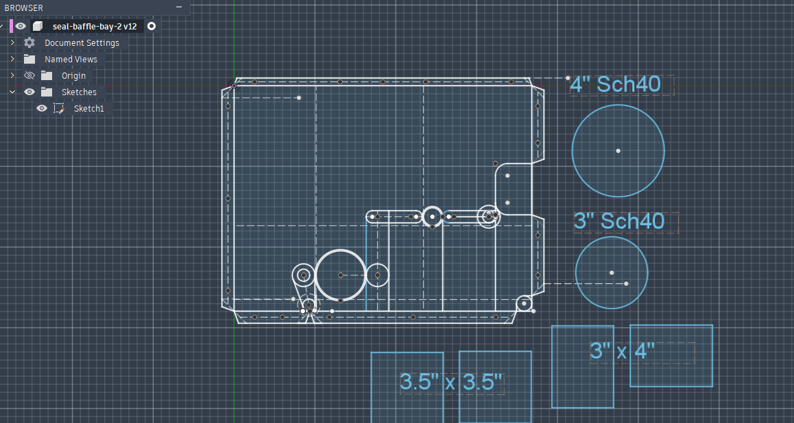

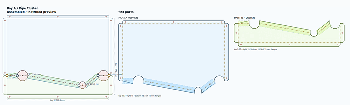

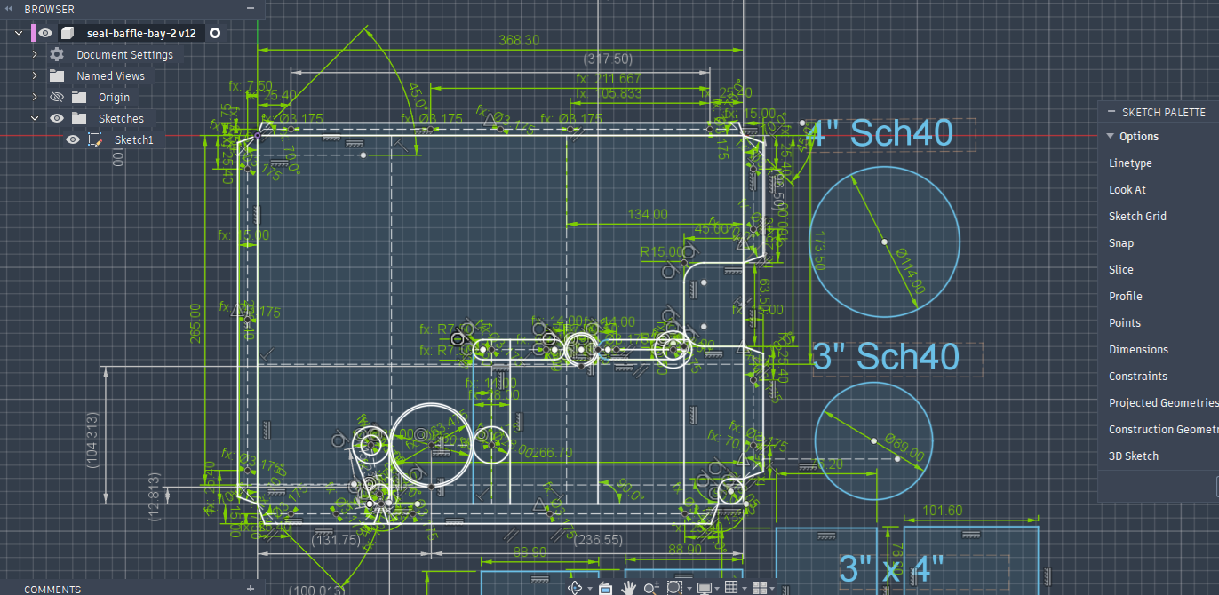

Am curious if FreeCAD as-is, or using a known (or new) plugin can help me generate templates for a bunch of joist bays I have to seal?
For example…

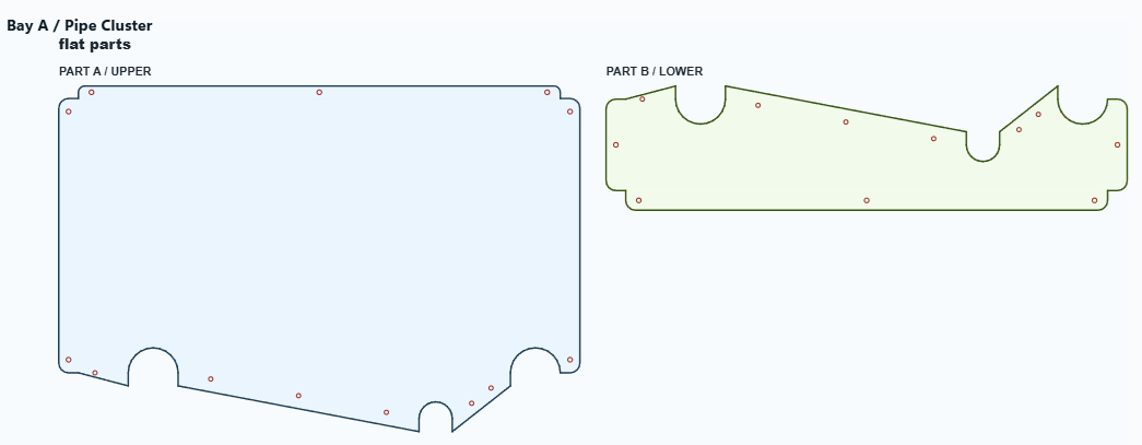

For an earlier bay, I burned couple of hours Fusion 360 designing a layout (thinking it’d take just a few minutes…)…
After that frustrating experience, I burned many more hours trying to “save time” and make something semi-automated (web tool that generates multi part baffles given arbitrary set of openings with various shapes/dimensions/locations with overlapping regions, and reasonable mount hole locations, split path that can be physically installed)…
Assembly preview…
Exported for CAM…
Now that I finally have something working, am guessing someone here knows how FreeCAD could help me do something similar in just a few minutes.
Can FreeCAD as-is, or with an existing/new macro/plugin/workbench, help generate this kind of CAM ready thing quickly?
what ive found is chamfers generally throw errors when changing size
That only happens when there’s no space for the chamfer. That’s the reason you can’t go below 80mm, the fillet of the feet error out then (or if you enlargen the distance of the feet).

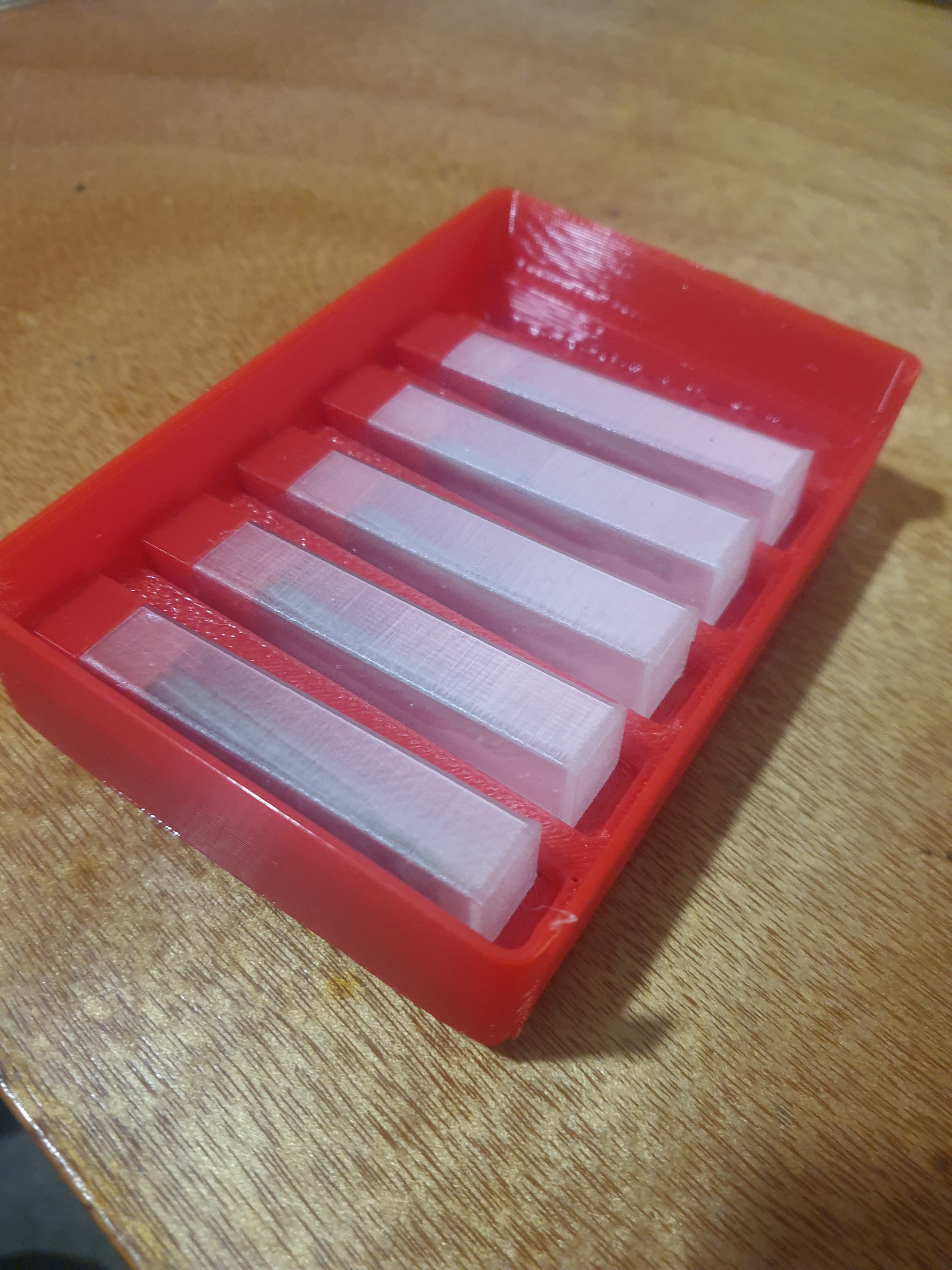

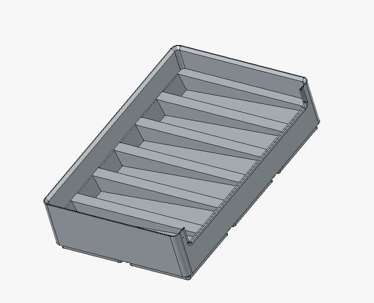

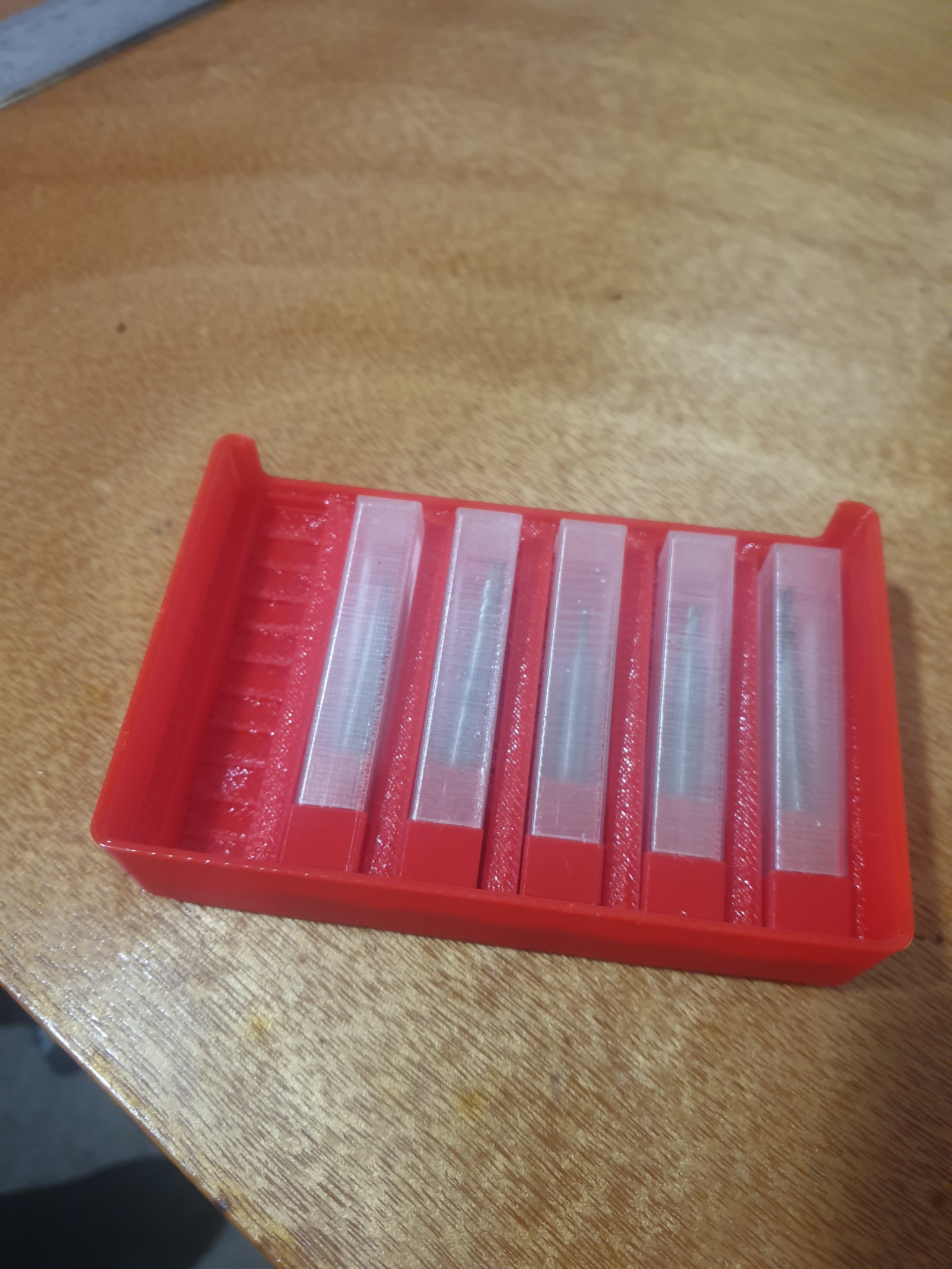

Made up theses bit holders yesterday using the grid finity workbench and part design workbench to try out some of the new features, def more stable and user friendly than free cad 1.0
done a revamp with a label tray also which should of done at start ;(
I generally leave chamfers and fillets off till I’m absolutely happy with design, ive had them do some random things when editing and i never add them to original design only to a copy, i lost 3 hrs of work once due to a chamfer error , so over causious now

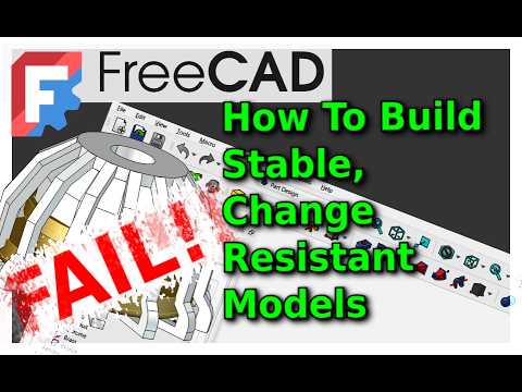

This is the exact video I needed to deal with breaking models. I knew that TNP was an issue but I didn’t really understand it. This video helped immensely. It didn’t really matter until I started getting into more complicated models.
