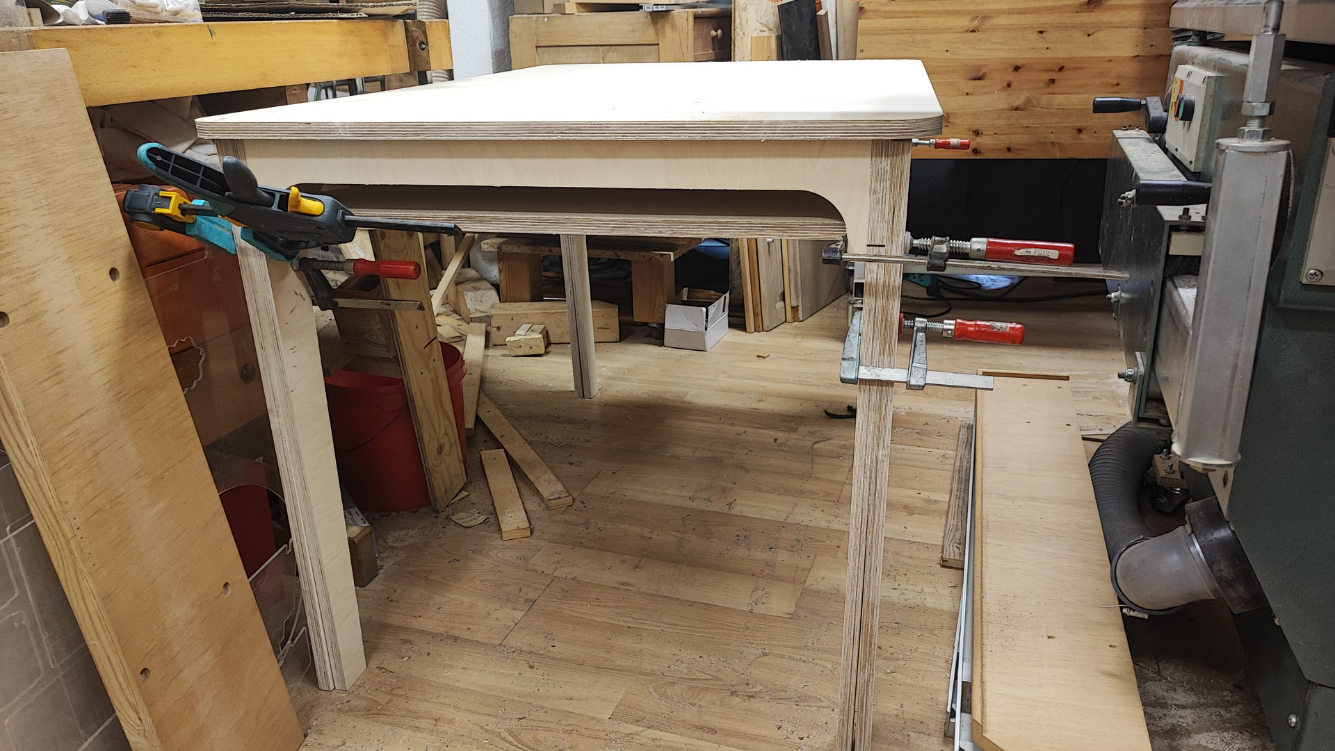

First FreeCAD project nearly done. Gaming table for my brother. :slightly_smiling_face: From one sheet of 18mm plywood.

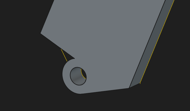

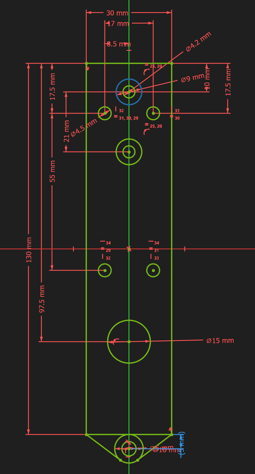

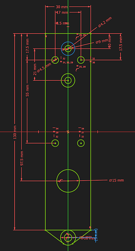

Speaking of FreeCAD oddity… Why, oh why, when I changed the big length on the left side from 110mm to 130mm did FreeCAD decide to flip the tangent constraint on the circles at the bottom from the outside edge of the rectangle to the inside edge??? I had to add the 5mm reference constraint to keep the circles on the correct side of the line :confused:
Even better. Saving my edit and it decided to remove one of the lines from the sketch that references this and remove part of the pad…
But… BUT… even with these little oddities, I think I’m a FreeCAD convert. I need to start exporting my designs from Fusion and getting them imported in. So I need to figure out a directory structure now.
Good question.
I’d be curious to see the Sketch (with the constraints, as applied) before and after the big length change. Hard to guess what it thought it was doing from the corrected Sketch.

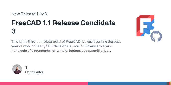

Looks like v1.1 RC3 came out a few days ago.
