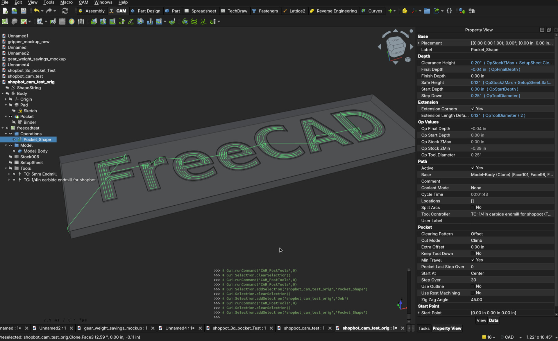

So… check out this screen shot:

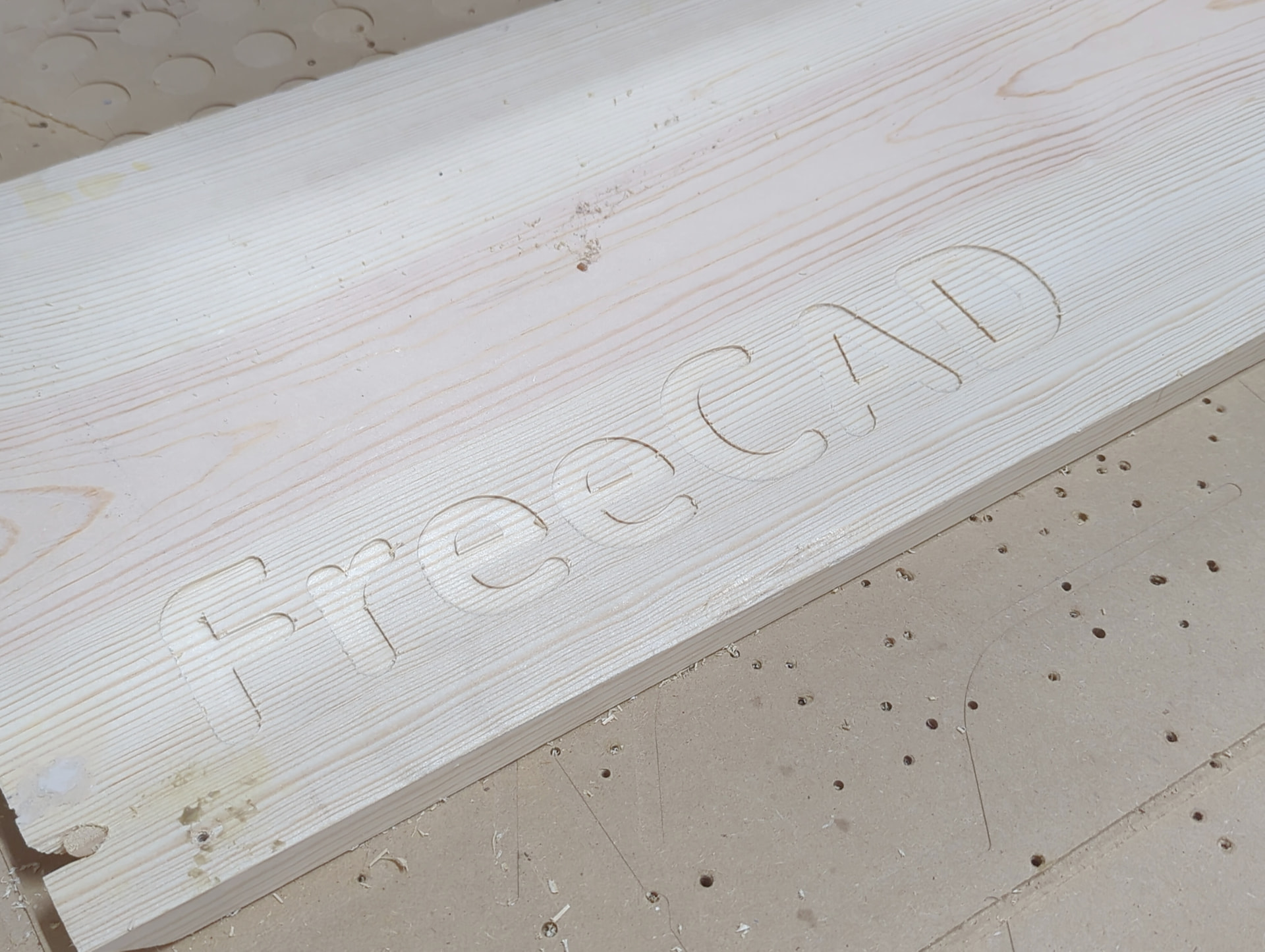

Then this:
Cut on a ShopBot running LinuxCNC at a local makerspace.
Apparently the local FreeCAD guru thinks FluidNC and LinuxCNC may be close enough that the demonstrated workflow may work for both.
