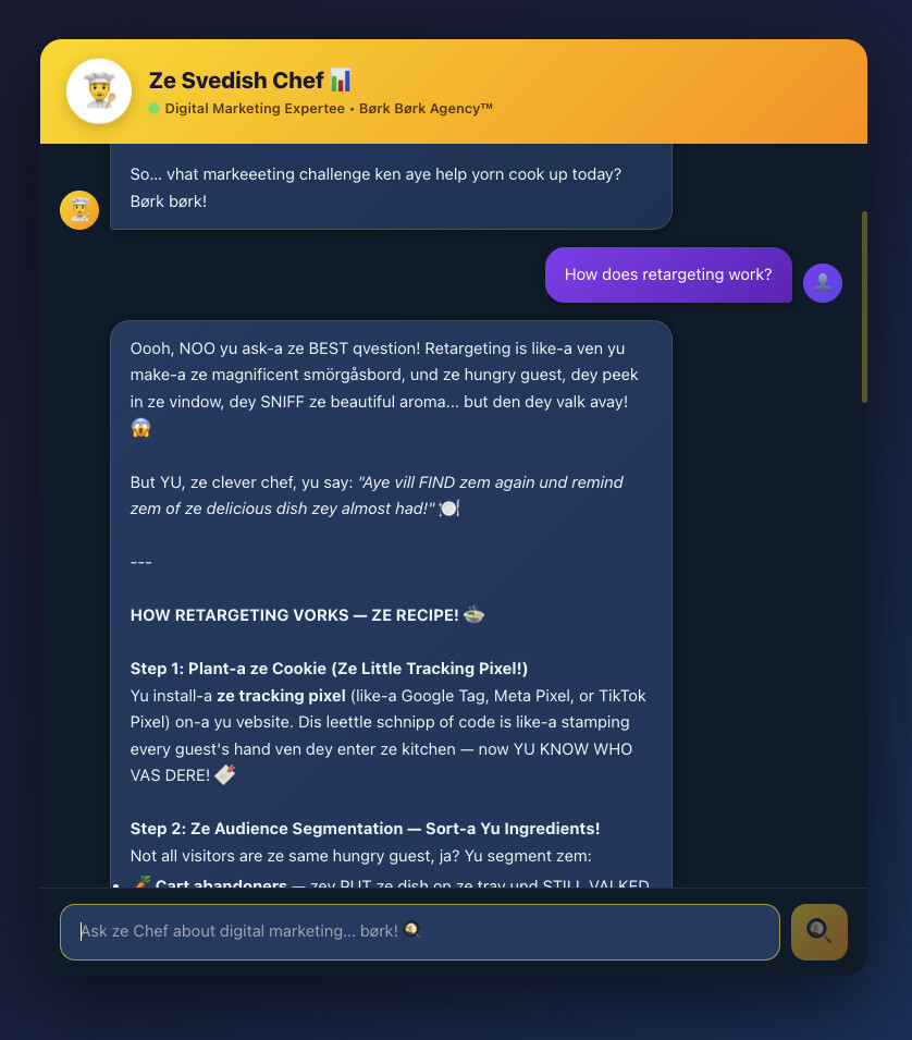

Every now and then I tell it it’s actually the Swedish chef from the muppets if I want it to sound less serious :smiley: A few months back I heard about “claude in claude” where people found you can have claude create customized chatbots. So I gave it a try with the very simple prompt “create a chatbot that talks like the swedish chef but is an expert at digital marketing and advertising”
And it built the whole thing off that one prompt as an artifact in the web interface.
it’s a full interactive chat bot customized with digital marketing knowledge…but talks like the Swedish chef and uses a cooking analogy for things.
It may not be very helpful - but it gives me a good chuckle every now and then :smiley:

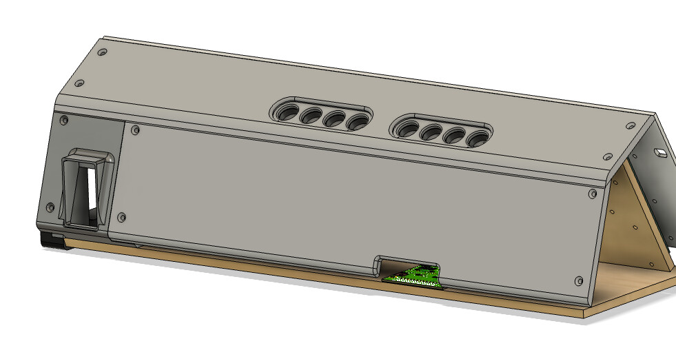

I just went ahead and tried enabling the MCP in Fusion and it was a really quick and easy process (one checkbox in fusion and there’s a pre-built connector in claude for it) I just gave it the half finished case for my MidiBox Sequencer I started about 4 years ago and never finished…will be interesting to see how it does at finishing it.

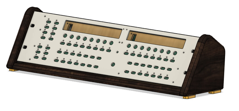

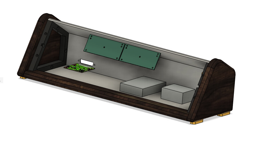

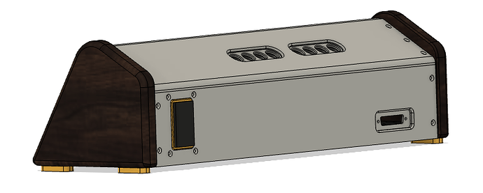

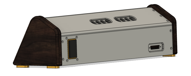

Well, it took claude a few tries but it did something fairly close to what I was hoping for:
The first try was “functional” but ugly as heck as it just popped some slabs on there…the screw holes and connector openings were in the right spots but that was about it.
The biggest issue was that 3d Printed piece that holds the power inlet - Claude went with 6mm ply for the top and back panels but my original design for the power connector was assuming 1/8" PVC sheet. I did want to do wood but at the time I wasn’t able to use my MPCNC so I didn’t want to do anything too fancy. Still not entirely happy wiht how it joined the top and back. But sure looks like if I put some actual effort into describing what I want that it would do it.
I’m going to ask it to do a case itself next just to see waht it comes up with.
It offered me 3 design options - I let it go on it’s first one and it did something very similar to what I was envisioning originally just a little cleaner:
Definitely impressive. I’m curious to see it’s other design ideas next.

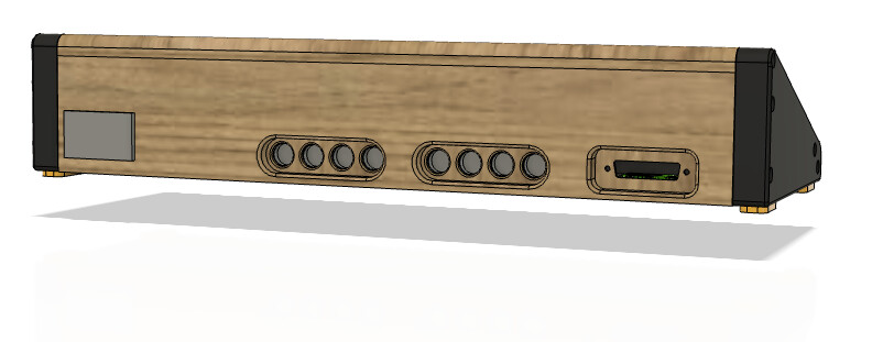

Ok, I definitely love the Fusion MCP.
It did all 3 design ideas it suggested really quickly like 3-5 minutes each. And it cleaned up my own design file and organized things into components for me.

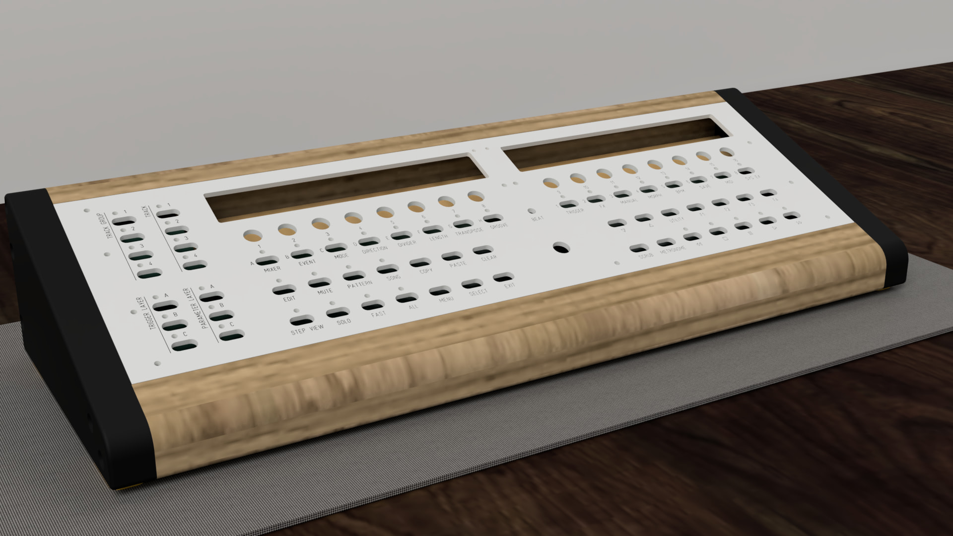

Then I had it do some fine tuning to one of it’s options and really kind of like what it came up with:
It even added the engraving on the panel.
Back came out nice too…in that rendered view it even created a tabletop environment for the rendering.
Really like how well it does at the things I don’t do well myself…and it’s still all Fusion so I can still do things manually when it doesn’t do quite what I want. But most of what I asked it to do it did WAY faster than I could do manually - even things I know how to do it did them faster than I could trigger the tools doing it manually.
