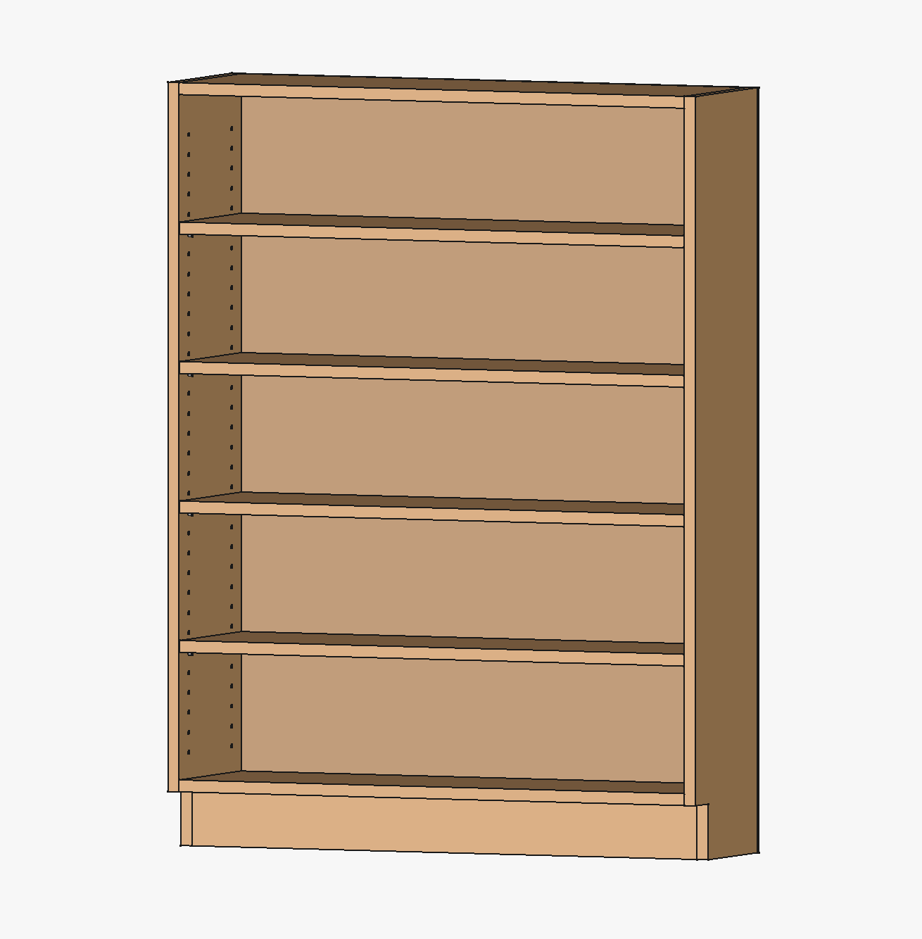

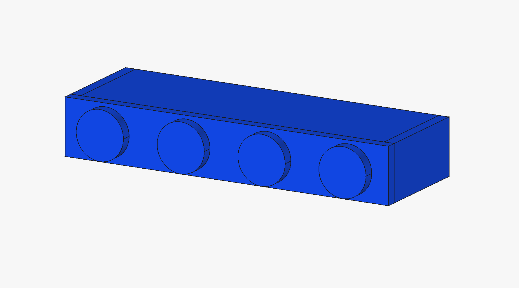

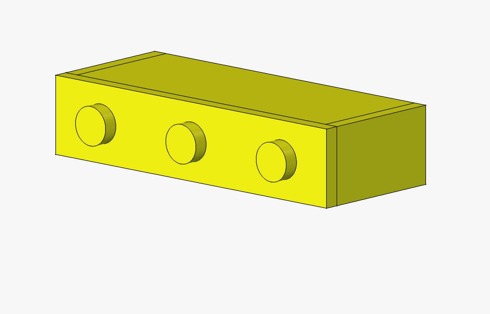

I now have Claude, Gemini and ChatGPT working with FreeCAD mcp. I have used them to design and layout parts to cut 2 different sized floating shelfs and a bookshelf. What a crazy time with AI today.
The shelves are for my son in laws pediatric exam room. He is going to put some of the grandkids’ lego builds on them.

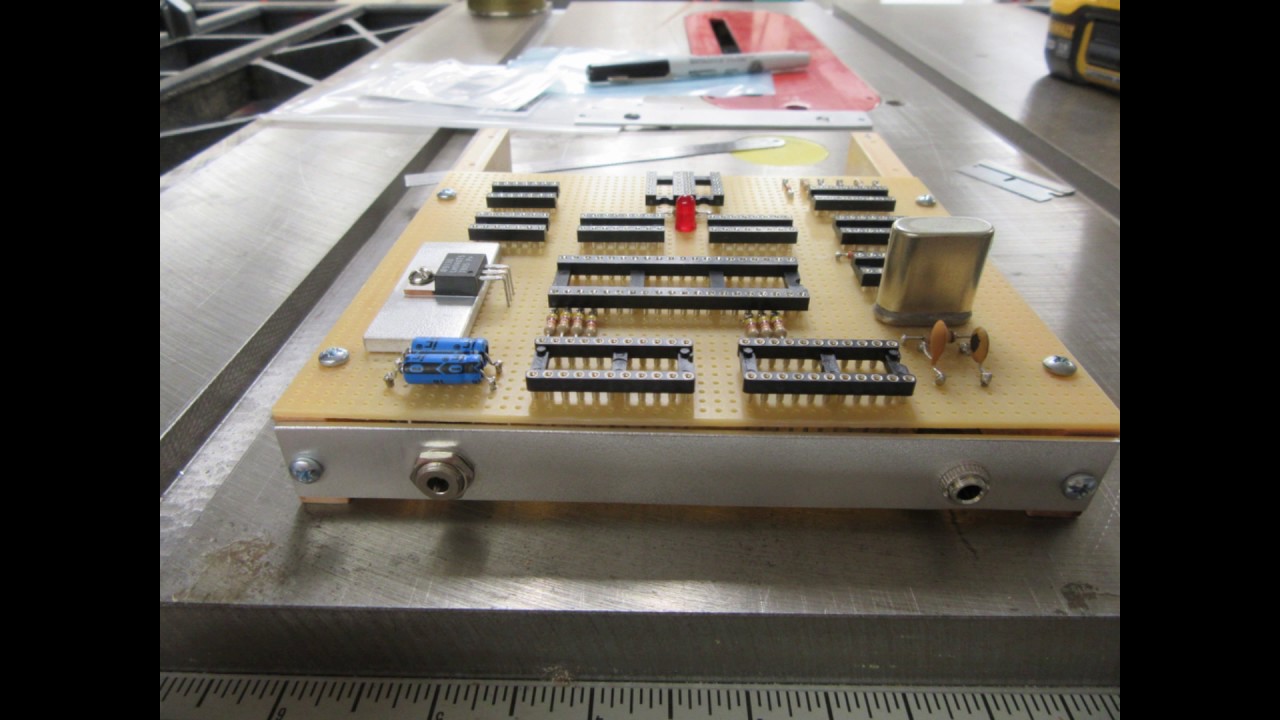

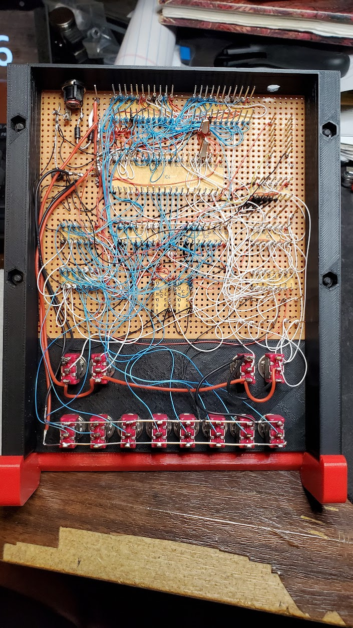

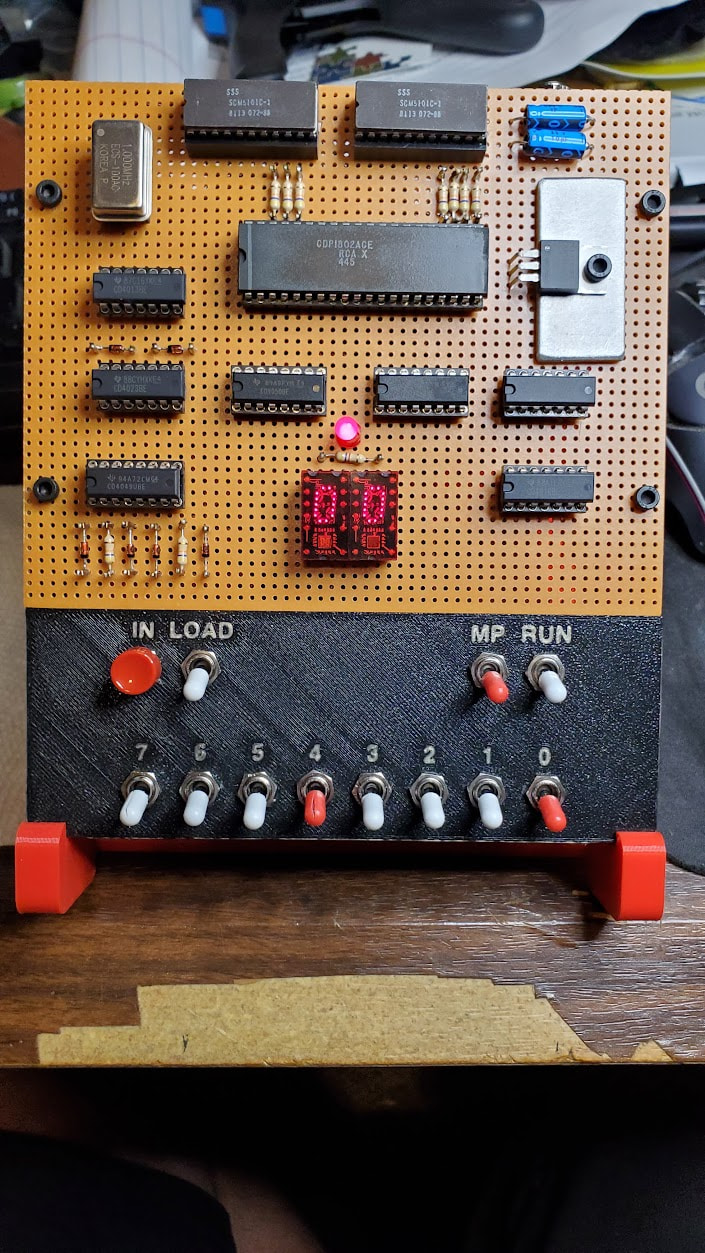

Though with just 2 hex dispalys and a single LED for output and 8 toggle switches for input the ELF isn’t quite what most people expect when they hear computer :smiley: I keep it on my desk at work where it counts from 00 up to FF and back - the switches set the counting speed.

Thanks - it was a fun project. Though to be fair most of the credit goes to the great COSMAC ELF group and Paul Schmidt in particular who’s video and documentation made it far easier than I expected:
I followed his lead very closely. Though I did design and 3D print a case and stand for mine instead of using the traditional wood/metal :smiley: I also opted for a modern oscilator instead of a period correct crystal (on his he used an oscilator but hid it and added a dummy crystal to make it look more like the original plans.)

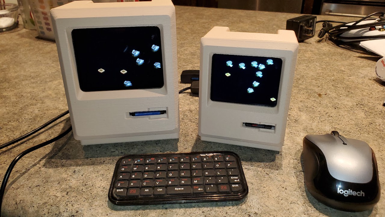

It’s amazing what modern tech can do! I built these two a few years back but the big one is using a raspberry Pi 5 and the small one is using a rPi zero:
They cost more than the ESP32 but don’t do anything it can’t :smiley:
Though I’ve since repurposed them with the bigger one now being a MAME “cabinet” and the small one being brainless since I didn’t have a use for the small screen and moved the pi to another project.

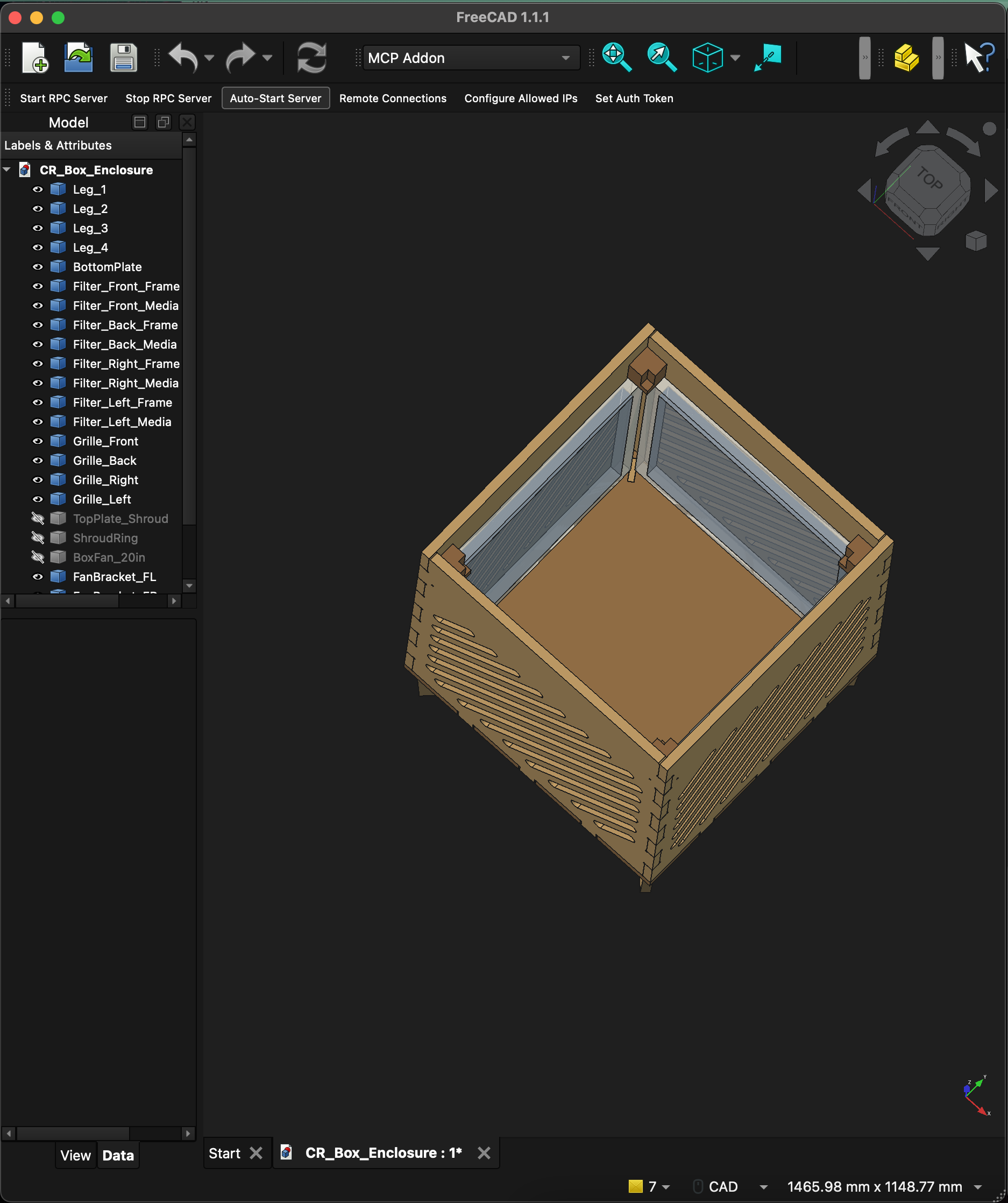

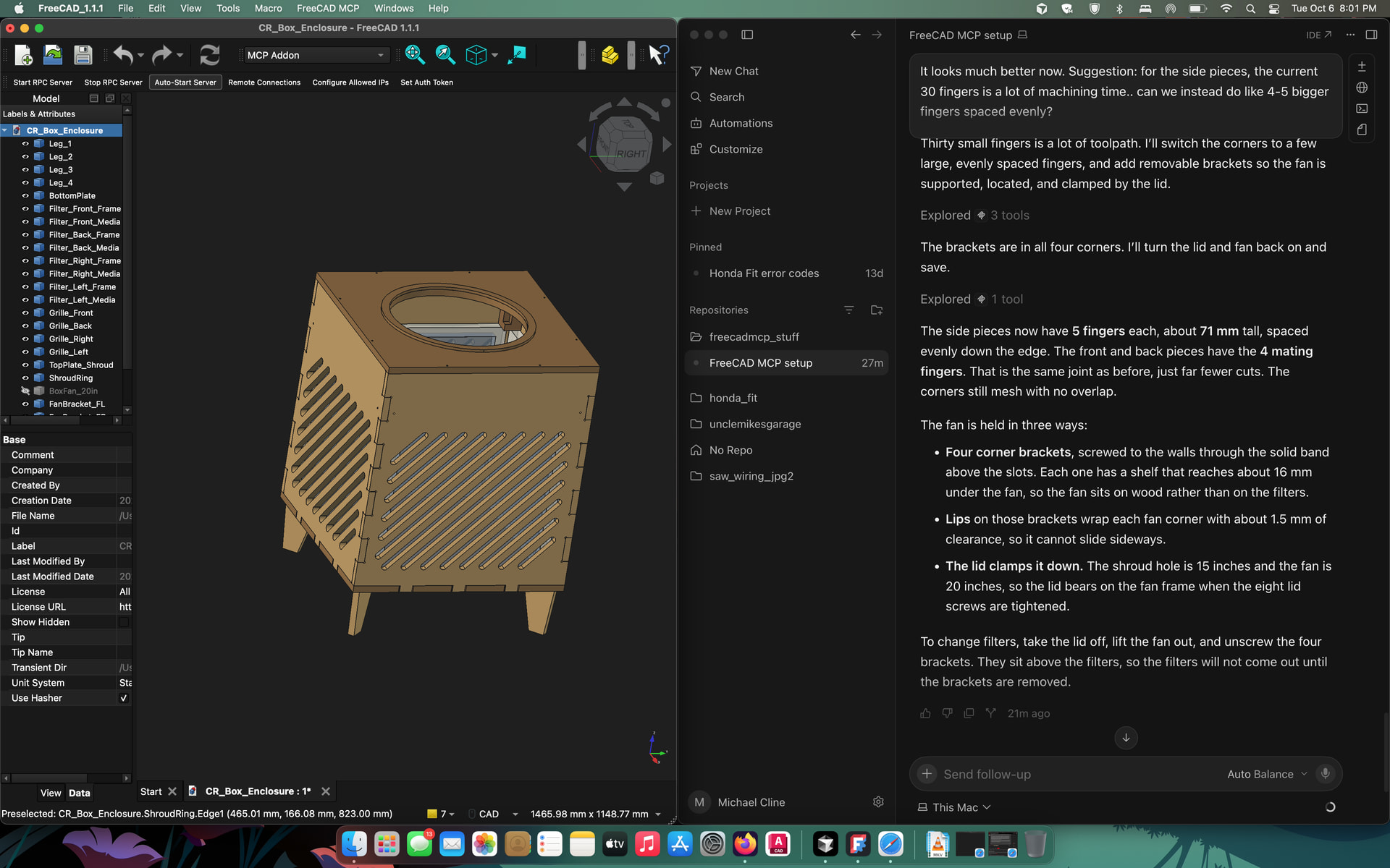

Been having some fun with FreeCAD MCP and using Cursor to control it! I asked it to make me a fancy wooden housing for my Corsi-Rosenthal air filter. At first I had Cursor set to use “Auto - Cost” where it routes your prompt to the cheapest model it thinks would work best. It did OK, it made a colored 3D model but some things didn’t line up and there was no joinery. Unfortunately it doesn’t tell you which model it used in this mode so I’m not sure “who” I was working with lol.
I switched to “Auto - Balanced” and it routed my next requests to Grok 4.7 which was able to make the whole thing nice and tight! Check it out:
Box fan and air filters are top loaded under the lid:
It needs some more work, like some interior hold down for the filters (though I’ll probably just use tape), and a hole to run the fan’s power cable. I’ll also end up re-sizing the grille slots so you can’t see the filters paper edges. But yeah… what the LLMs did in this project would have taken me weeks of free time to figure out and even then, it wouldn’t be nicely named and organized like this thing is!

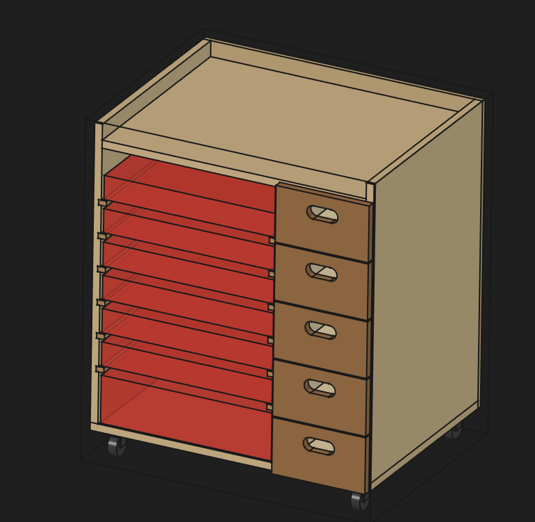

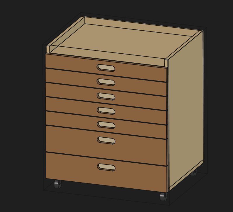

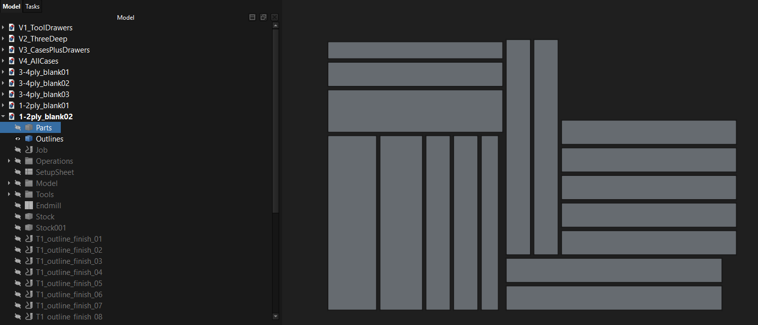

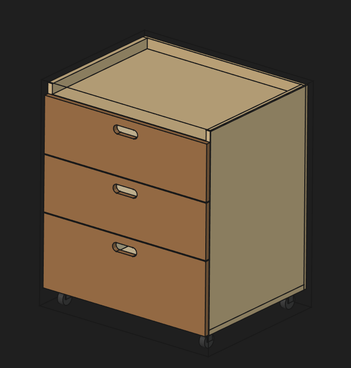

I just had it design some rolling cabinets with drawers, or for Harbor Freight organizer boxes.
Still needs some updates for sure.
But then I got it to break it down into third sheets of plywood and do nesting for each sheet. And then I had it do the CAM with roughing and finishing passes. So, it output DXFs and gcode files. Obviously, some tweaking and a bunch of validation before I’d think about using that, but it did ask me some appropriate questions.

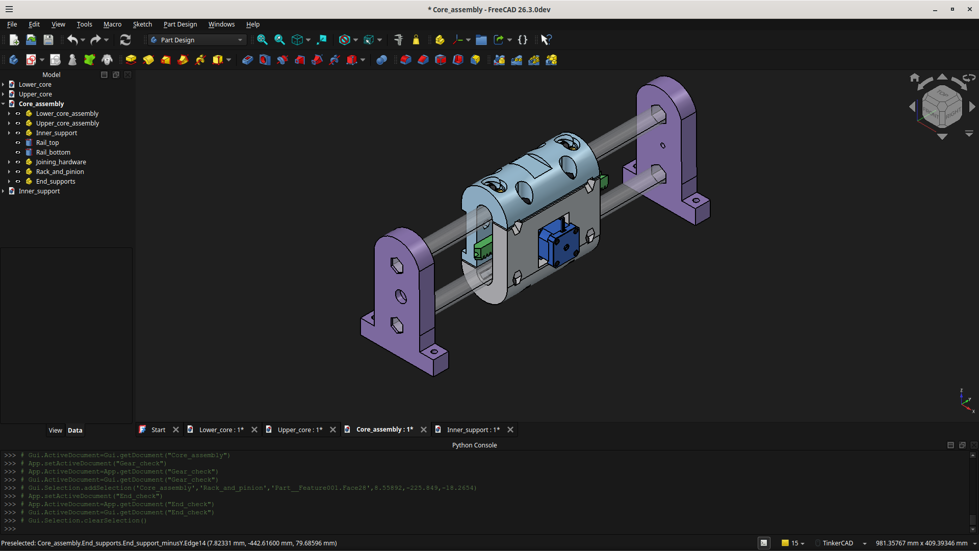

After setting this Claude and FreeCAD-MCP up just yesterday, here’s what really changed my mind…
Inspired by what @Terry_O_Sullivan had started because he doesn’t have access to 3/4" EMT, I cranked up my own design (more of a revision to the original MPR&P) in OnShape and I’ve now imported an entire linear stage into FreeCAD… and I did absolutely no CAD work in FreeCAD myself. I now just tell Claude what I want to do. I supplied only STEP files from Onshape and had Caude import the parts, make a few adjustments (he checks alignment, fits, and clearances as he works) to the parts, go find hardware (stepper motor, hex bolts, Nyloc nuts, 608 skate bearings, 3/4" EMT, etc.) online and install it onto the parts where it goes, create an assembly of everything, create and save STEP files for all parts and the “final” assembly, and save all the FreeCAD documents into its own directory on my laptop. It even created a bill of materials (BOM) of all the hardware and parts in the assembly. I didn’t draw a single line or shape or click any buttons (except the View cube to see what Claude was doing) in FreeCAD… Claude did it all and it didn’t even have to take breaks when I did.
I started with just one STEP file of a part and had Claude import it into FreeCAD. It told me what it saw… recesses, their sizes and shapes, slots, etc. and I then said that a NEMA17 stepper motor goes in the recess with 5 slots, four small and one big. Go find a NEMA17 stepper model online and then place it into the recess on my part. Shock of shocks… it did it perfectly. Then I “pointed” it to the four angled rectangular slots in the curved section of the part and told Claude that common 608ZZ skate bearing go in those slots. Go find a model of the bearing online and then place a bearing in each slot. Again… perfect! And then Claude told me IIRC I had hit my 5-hour chat limit on the free account. But I had seen enough by that point that $20/month didn’t seem like a bad deal at all. So, I subscribed for the Pro plan right there and then. So I continued and had Claude find and mount models of all the 5/16" hex bolts… but I didn’t specify bolt lengths, just “as appropriate”. Same story for the Nyloc nuts. Finally, all the hardware was mounted on that first part.
Then I imported a second part… same result. A third… then a fourth… and finally a fifth. Along the way I asked it to start assembling parts and Claude was checking alignment, fit, clearances, etc. as we went. Made a couple of modification to a couple of parts to bring things into alignment and make sure nothing protruded beyond the outer surface of a part or the assembly. When we finally got to the part where I said the design looks like it “workable”, Claude agreed… and then Claude put out STEP files for all the parts, saved the FreeCAD documents, and even created a BOM with all parts and hardware listed.
Obviously, I’m blown away with this. I’d tried modeling a few small parts in FreeCAD but always just gave up, thinking it too complex and cryptic… and too great a learning curve. But I found this experience thoroughly refreshing; i.e. more like I’m no longer the CAD “flunky” pushing the buttons… but now his supervisor, looking over his shoulder and having him change things I felt needed changing. It was a genuinely eye-opening experience.
I’ve been spending hours and hours in CAD over the past year with my MPR&P work. I’ve gotten reasonable proficient with Onshape… but still had “accidents”, where I did something to blow up my model. Then hours were spent trying to find out what I did by going through my entire design database, a tangle of messy and terribly organized design documents… chasing circular references, multi-defined objects, etc.
So, IMHO this Claude and FreeCAD-MCP stuff is fantastic! Thanks, Jason, for starting this thread. Most of what’s been discussed here is way over my head but when David (@niget2002) suggested letting Claude/ChatGTP install and test the MCP for me… WOW! As long as this keeps up… I’ll never look back.

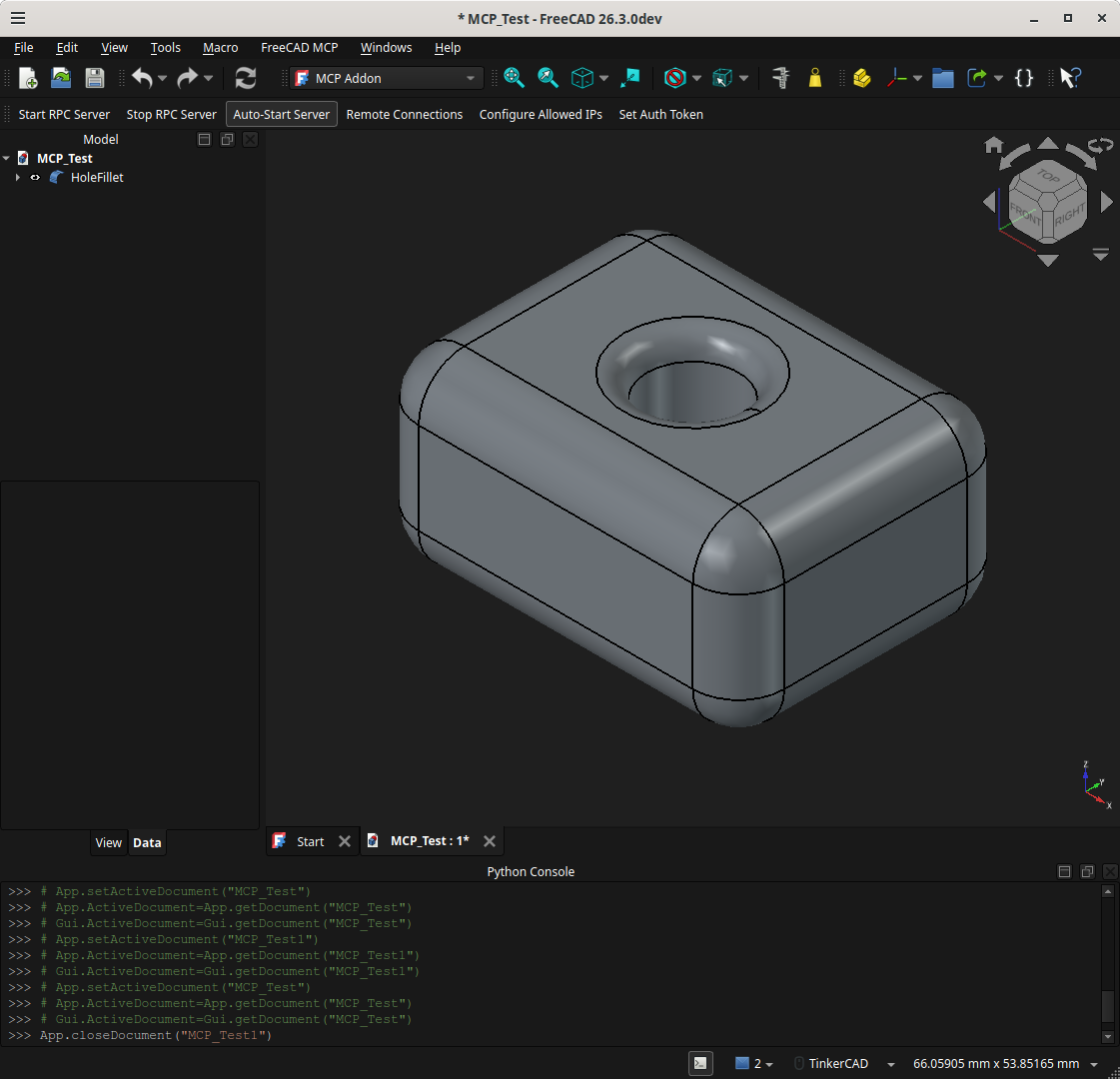

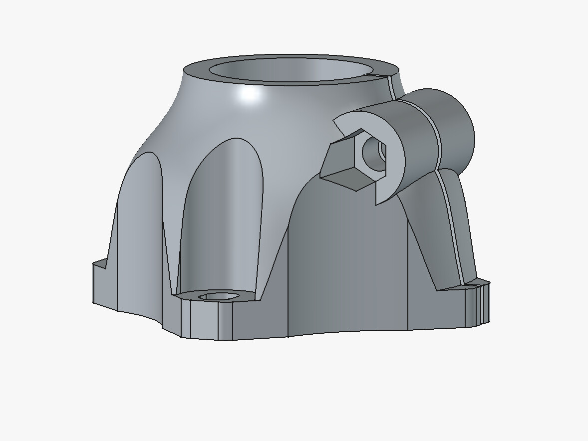

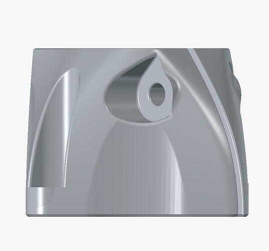

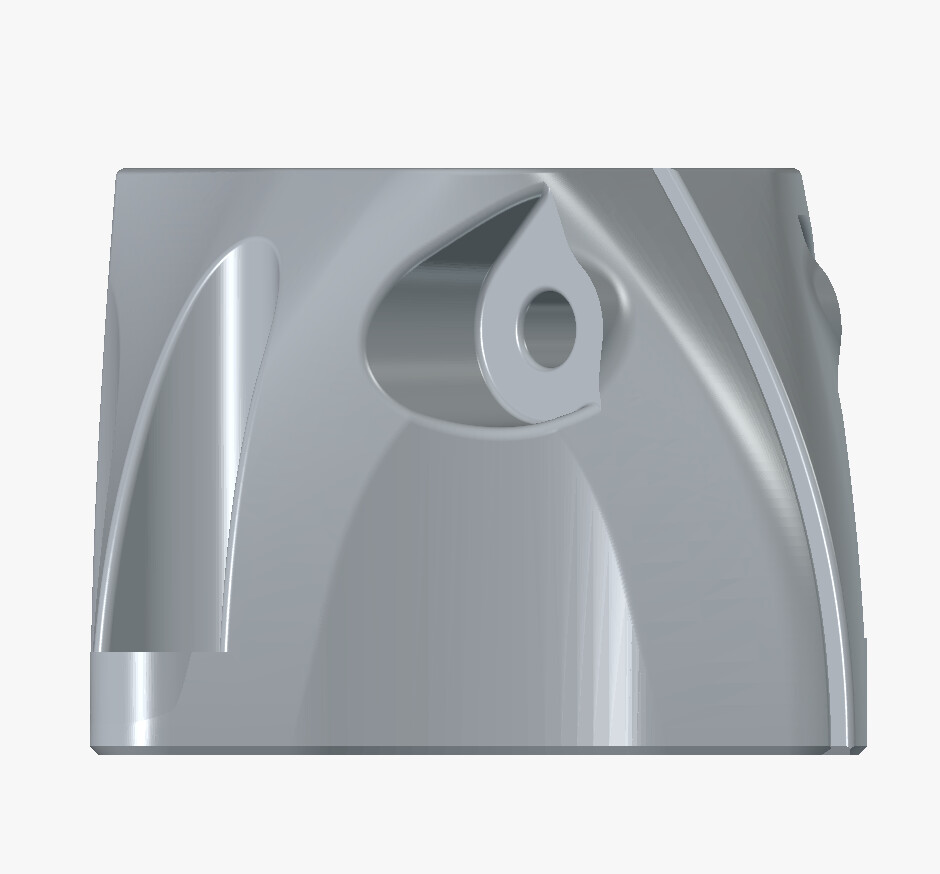

I have tried to add a nut trap to the MPCNC Primo foot for a long time. I asked Ryan if he could do it last year, but he did it in SolidWorks and doesn’t have the files anymore. I messed around in OnShape and FreeCAD trying to do it, but wasn’t successful. This morning I asked Claude and ChatGPT to add the nut trap to the stl mesh file. They didn’t like that and wanted a step file. I spent over an hour trying to get one of them to succeed. No luck. Rather disappointed.
This evening I decided to try a different approach and start from scratch. I took screen shots of all the sides of the foot and asked Claude to create the foot using them. It went WAY faster. I then asked for the nut trap to be added and make sure it fits a 25.4mm tube. Claude finished with time to spare so I asked to export the STL for printing and what settings it recommends for printing on my FlashForge. I’m very happy with the results. It’s not exactly like @vicious1 's design, but it will work. I’m looking forward to printing one out tomorrow.
