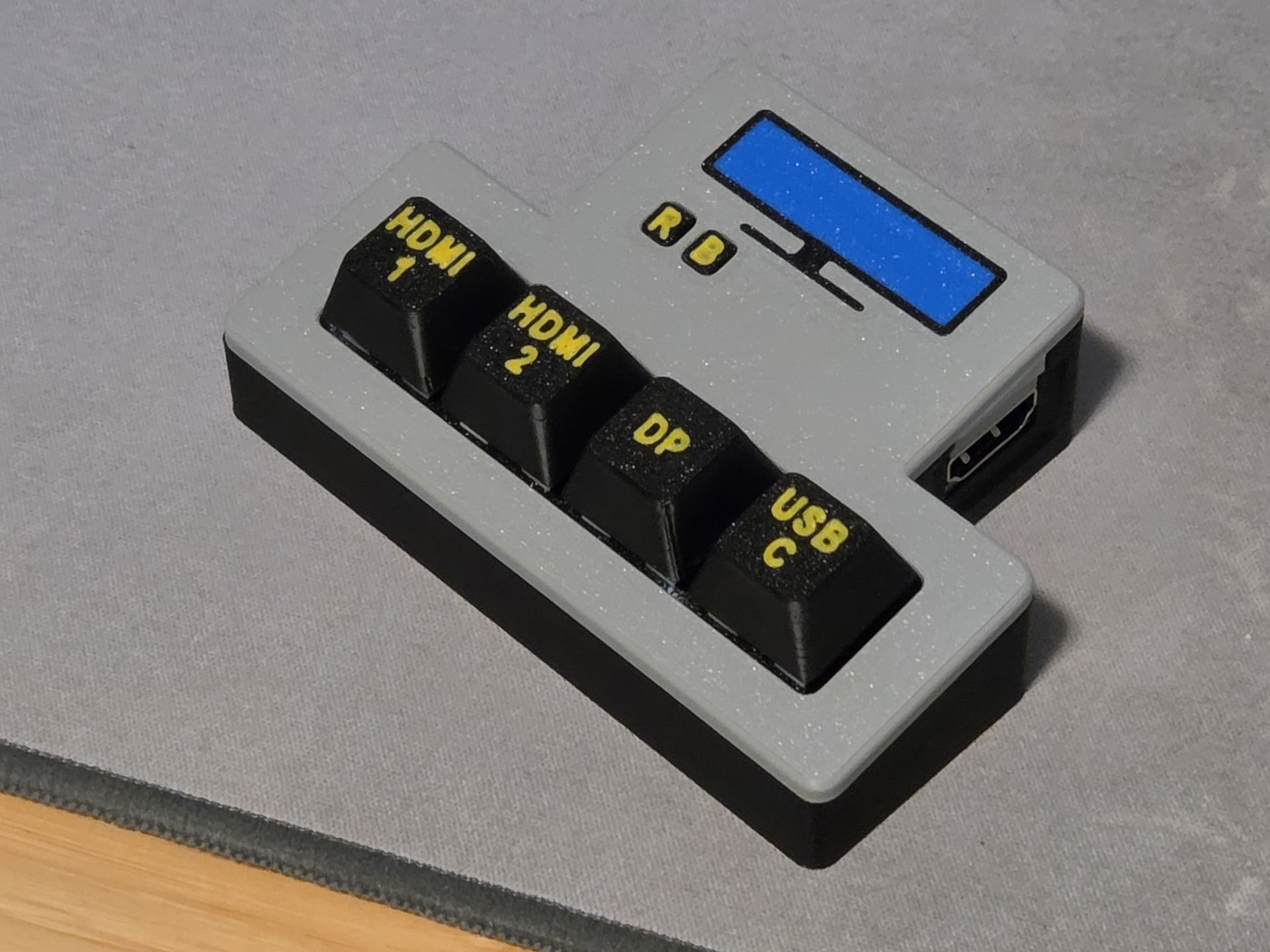

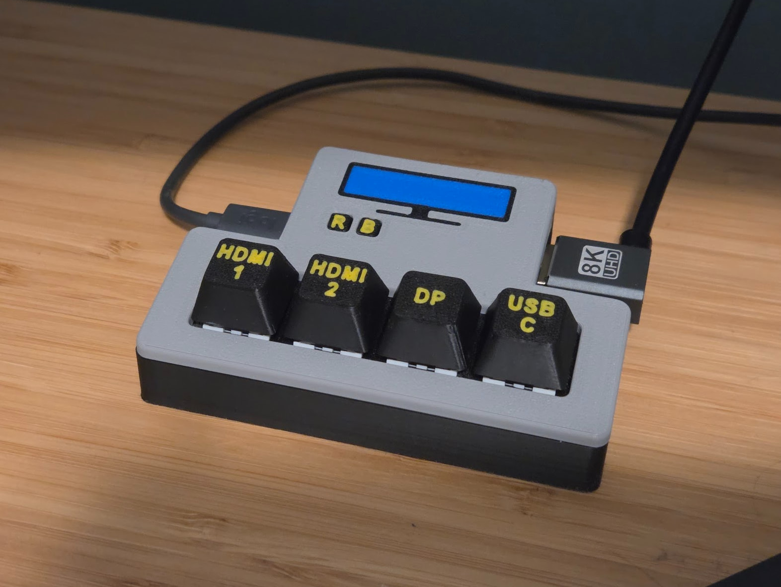

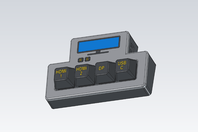

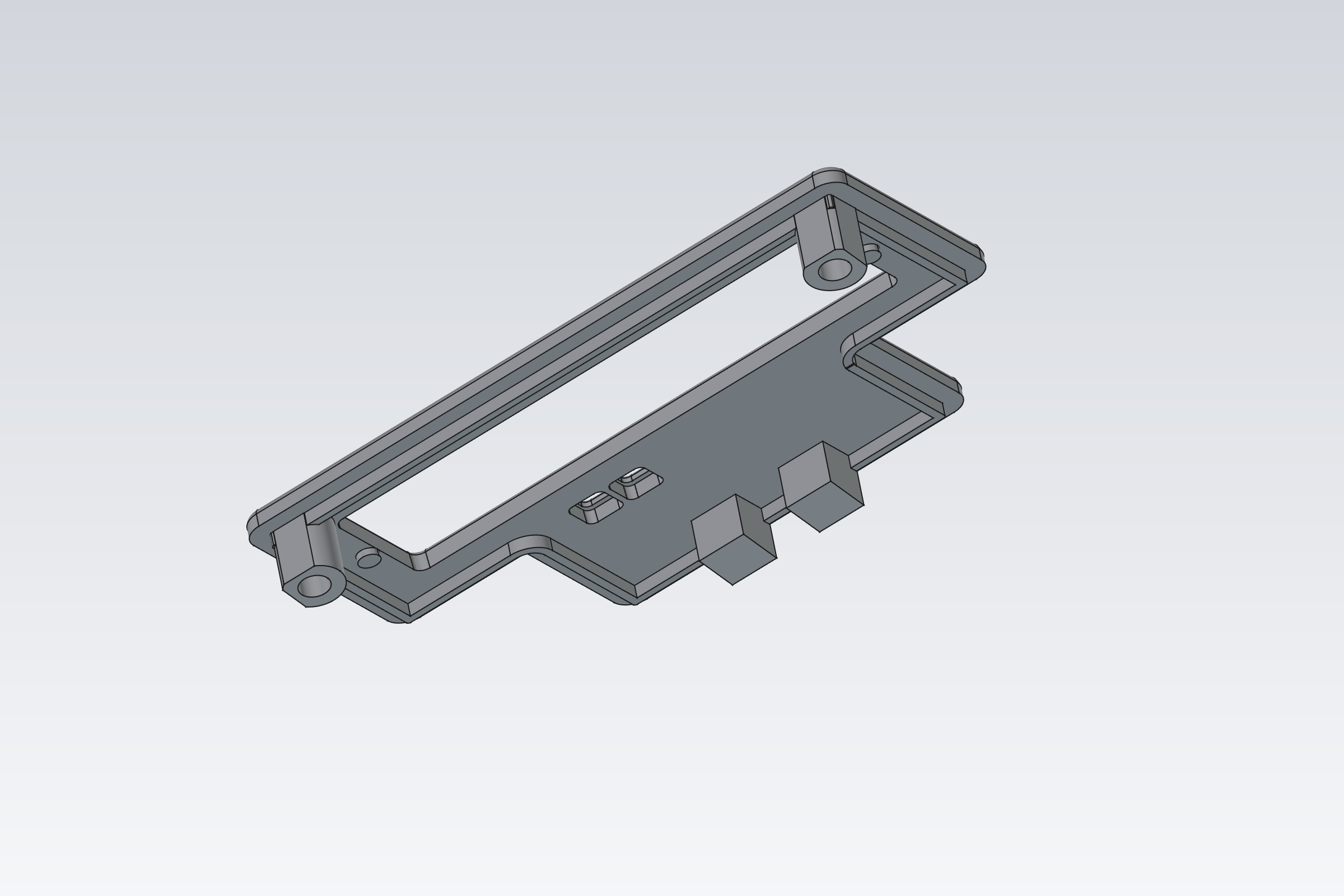

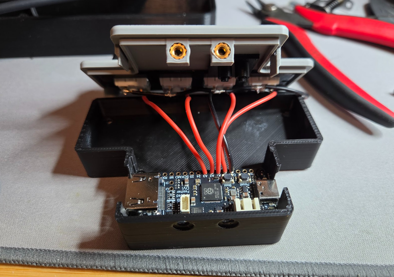

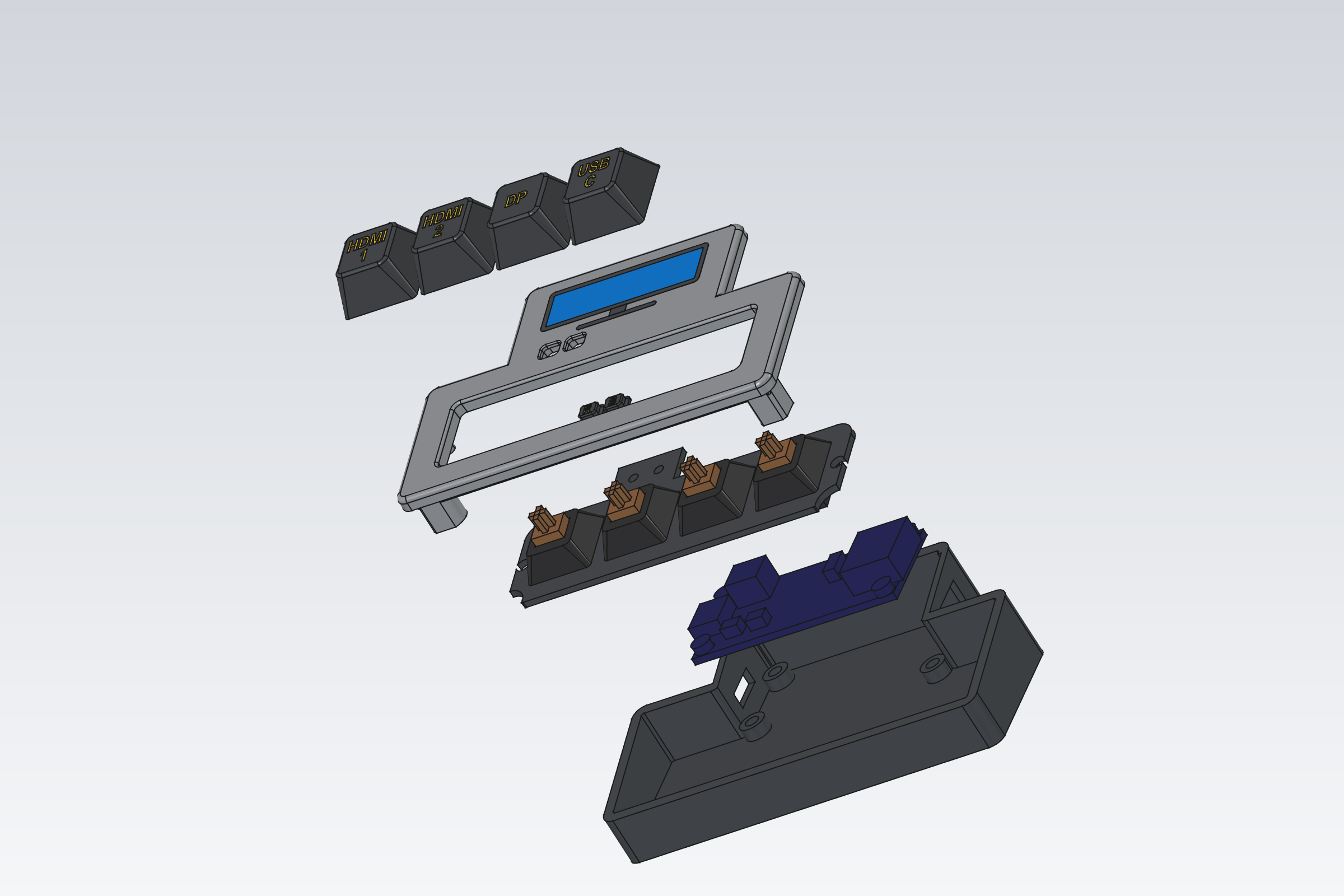

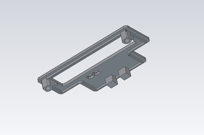

I’m building an external monitor input switcher and designed this with it. It went and found the 3D model for the Adafruit board I’m using and handled sizing and spacing. It also designed some small pieces I printed to test tolerances. With some instruction, it even made sure it printed without supports. That includes a 1 layer bridge on countersunk holes and teardrops on vertical holes. It also has it setup with the separate color inlays.

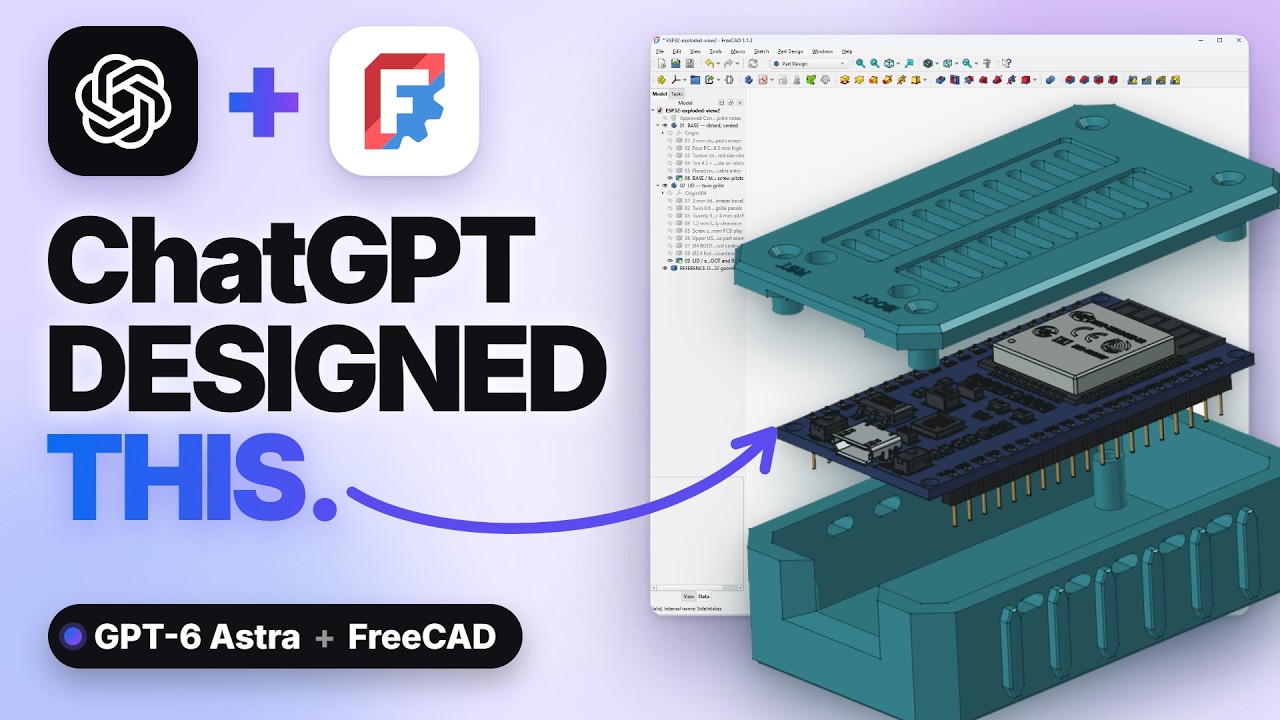

Just configured ChatGPT (the linux desktop app) to work with the MCP server on FreeCAD. WIll play a little bit with it.
That youtube is insane!
Did a bit of tweaking with Claude and still have to wire the keys to the board but it came out great.

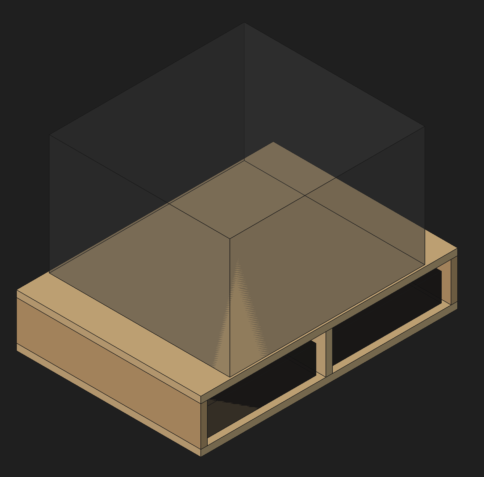

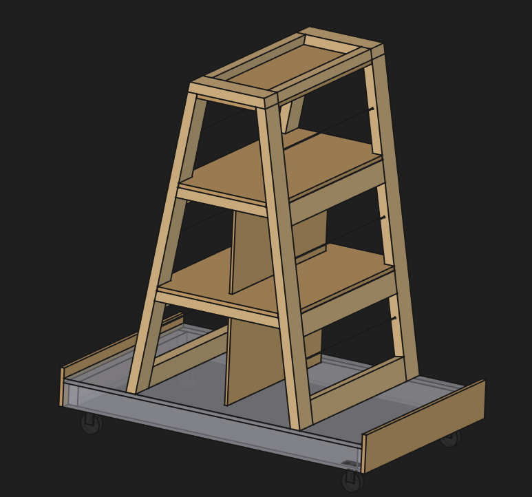

Also, working on a lumber cart. I already built the base but trying to figure out what to put on top. This is still a work in progress but still done by Claude. It also provides a complete cut list.

I finished my little monitor input switch. So, in the end I have a real working thing and I did zero coding and zero CAD. I could have made it myself but it would have taken longer and been less fancy.
