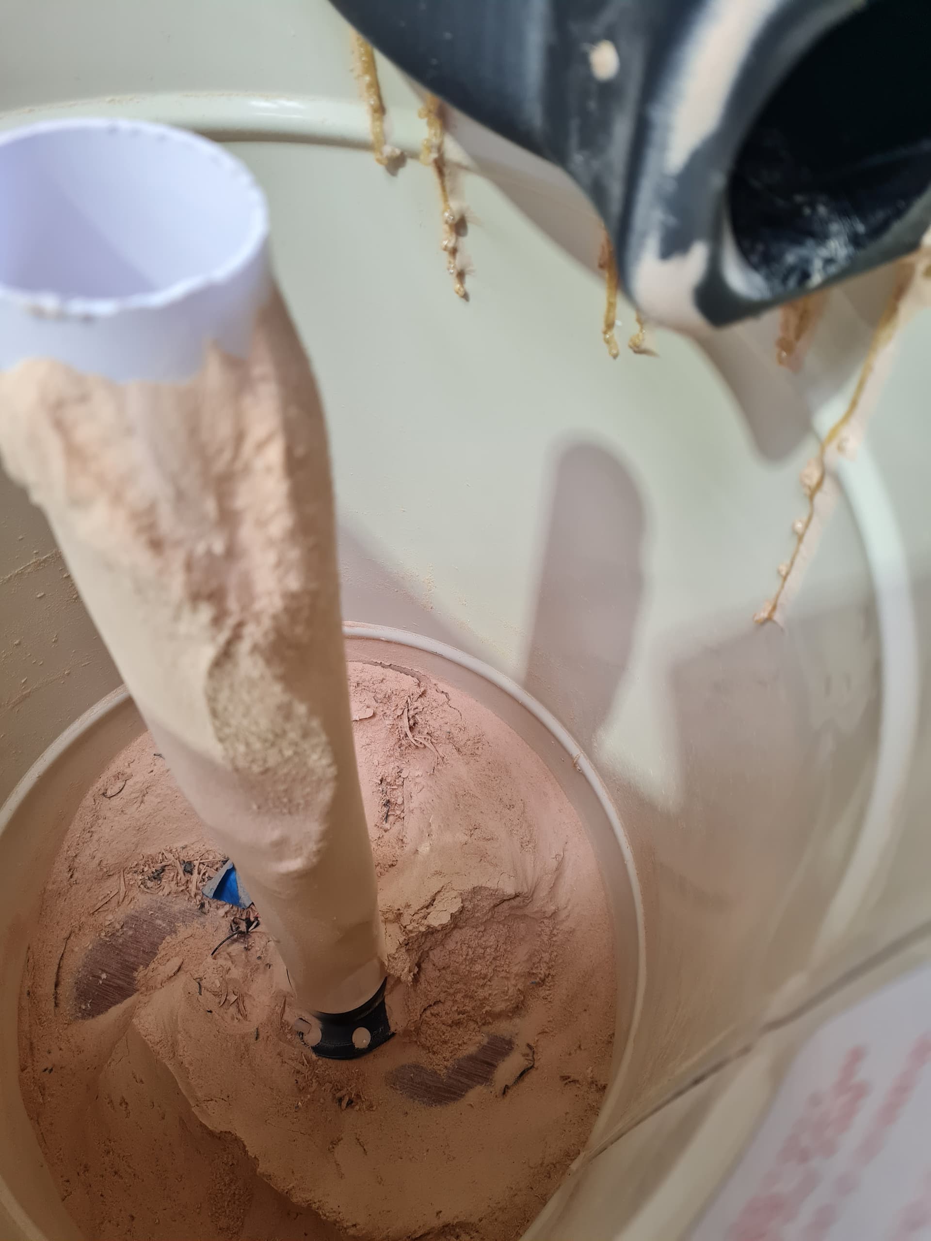

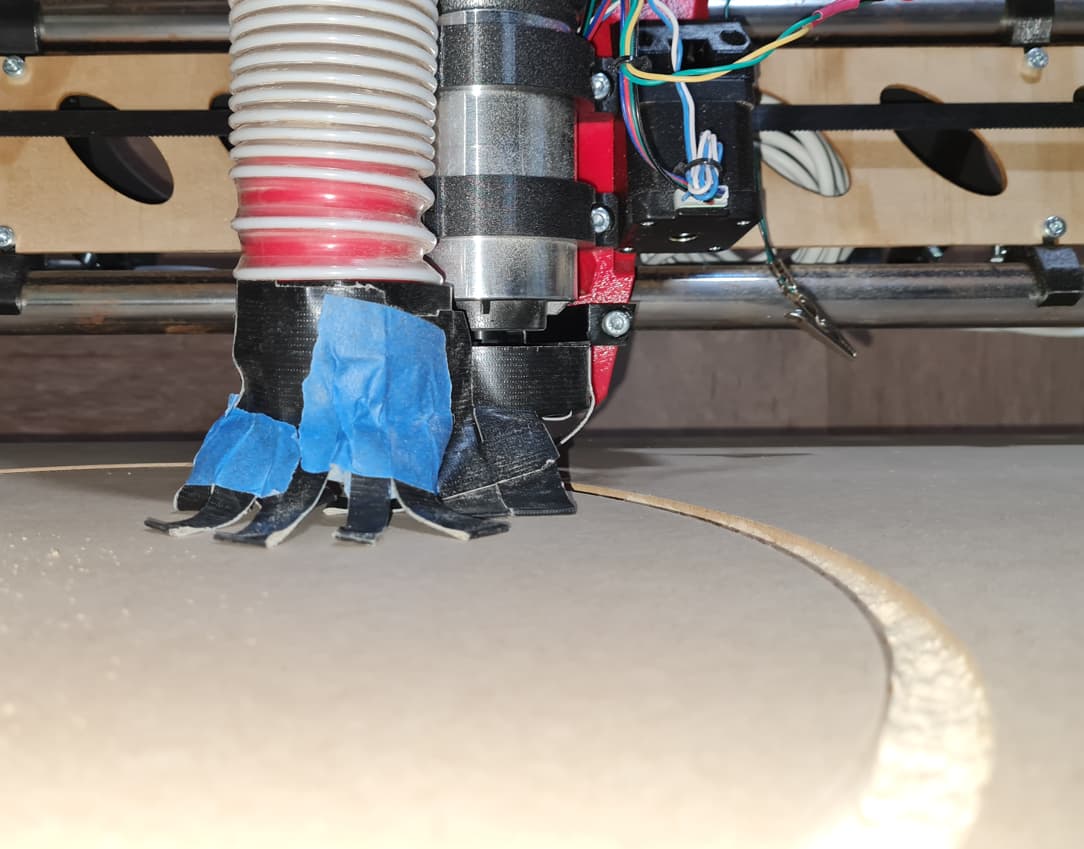

As for the performance of FrankenVAC, i found a few design issues early on, hence the changes and the new sealing rings, but ignoring those and some more mods to the dust skirt last night, i didn’t see any dust in the air, i could not “smell” the MDF and the surface is pretty clean of the dust, I could see the “high pressure” spurt of dust coming off the cutting bit being pulled back into the dust shoe. So that is really good. I found the issue with the first run of FrankenVAC, there was a leak in the collection chamber and that was just pumping all the dust into the motor/s. since then its working better, but still needs these mods.
As for the cut, it is completely chockers with the dust of the cut after the bit though, i was cutting 16mm MDF and after about halfway through, the cut was still full after the dust shoe moved along the cut.
Not the best photo in the world, but you can see the cut full of dust.
the rebate that was cut was 100% cleaned buy the shoe (this is where you could watch the "high pressure dust being ejected of the bit and then being pulled back into the dust shoe), so its defiantly got something to do with the dust shoe, maybe the bit as it is a down cut bit or cut settings.
In terms of the dust shoe, i am 100% hearing the vac “loading up” and “unloading” when i fit the hose into and out of the shoe. I have used a step drill and drilled three BIG holes in the space under where the vac hose is plugged in. I am not sure this has made a difference, but i guess that is a whole other discussion.

The dust shoe(s) on my ongoing effort for the floating-Z, should fit the previous shoe mount. As you know there are three to choose from, 1/4 open, 1/2 open, and full open.
If more air flow is needed, the drawing that is used to cut the foam bristles could be modified for a wider slice gap between each bristle.

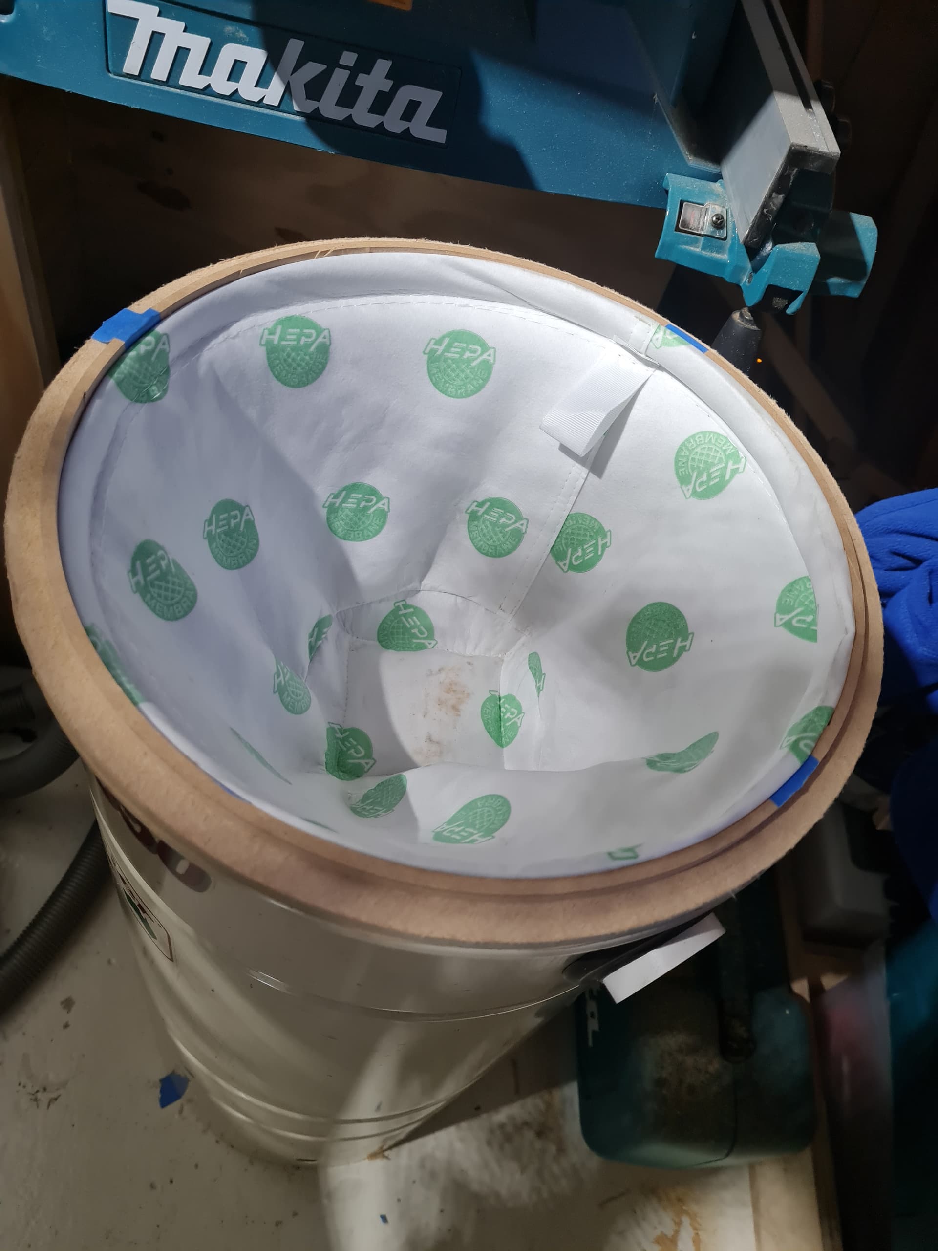

I also mounted the HEPA filter for FrankenVAC in its new ring,
I have one more set of pre-filters that can be added to the motor unit, but they can wait. Mainly as we dont have any in stock at the moment, lol

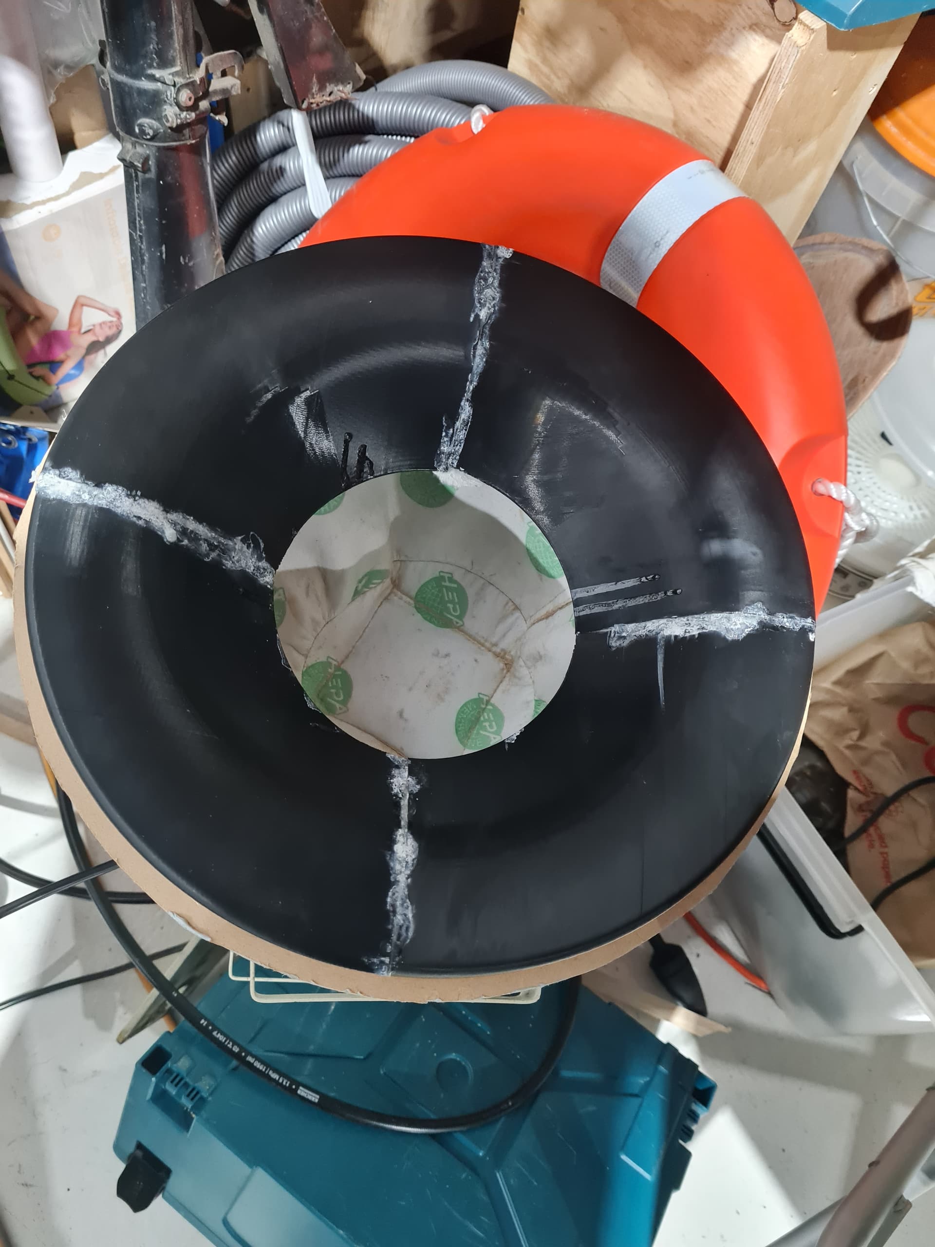

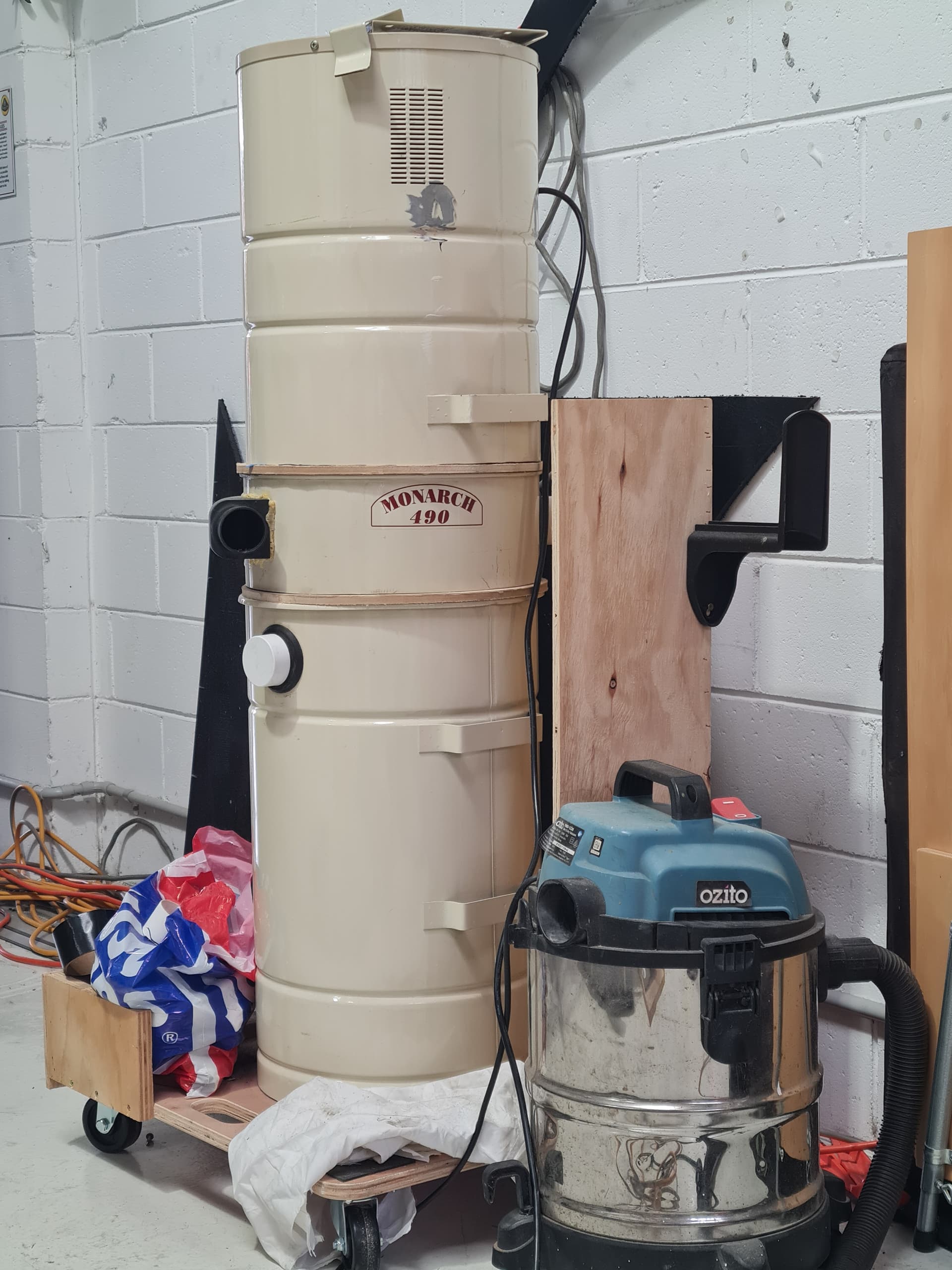

With a lighting storm last night, i went to lab and got out the hacksaw, some glue and opened up my creation to fix the errors in my design, but it was working, it leaked like a bucket with a hole in it, but it did capture some dust…
So i got out the hacksaw and the angle grinder to do some open heart surgery, the a nice coating of some goo on all the joints, then throwing it up on the roof to get struck by ligting to get its heart started…
(Top barrel is the motor barrel, middle barrel is the vortex generator, and the bottom barrel is just a dust colector)
It looks like the vortex generator works, so that got cut down to be the middle ring, the motor barrel got cut down enough for a for a foam filter for the motors and this hepa filter when its pulled up
So with all the goo smeraed onto the joins to keep the insides in and the outsides out once rhat dires i will be able to give it a test.

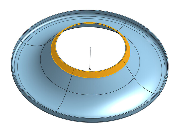

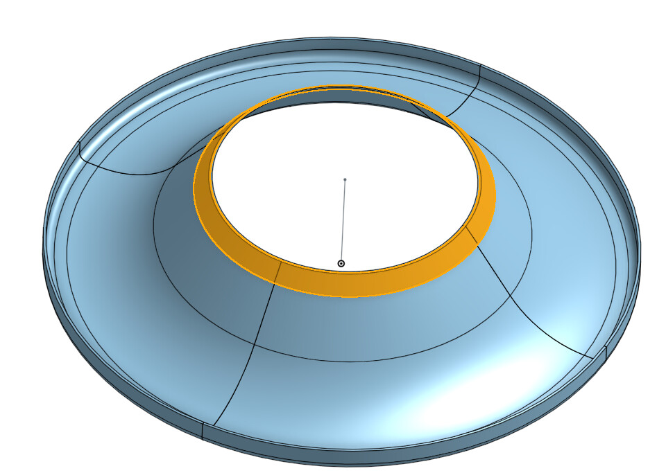

But i did manage to get the FrankenVAC assembled before that, which allowed me to steal some time on the brother printer to print the Shield that shits between the dust in (vortex generator) and the filter above
Hopefully, I will have some time to glue the shield together and onto the wood ring pictured above.
Basically I am hopping to force the vortex down and around to get under this lip. I noticed some dust built up on the filter directly above the dust inlet (vortex generator) and i am hoping to limit that by forcing the dust to swirl around a couple times to get under this ?deflector?..

I got the shield printed, twice and it seems i can use a bloody measuring device. SIGH.
as its still wrong.
First of all it was the wrong dia, not by much, but the wrong dia. So fixed that, and then once i could actually fit it I realised that it wont work anyways and needs a complete redesign due to the sealing lips on the wood cut-outs.

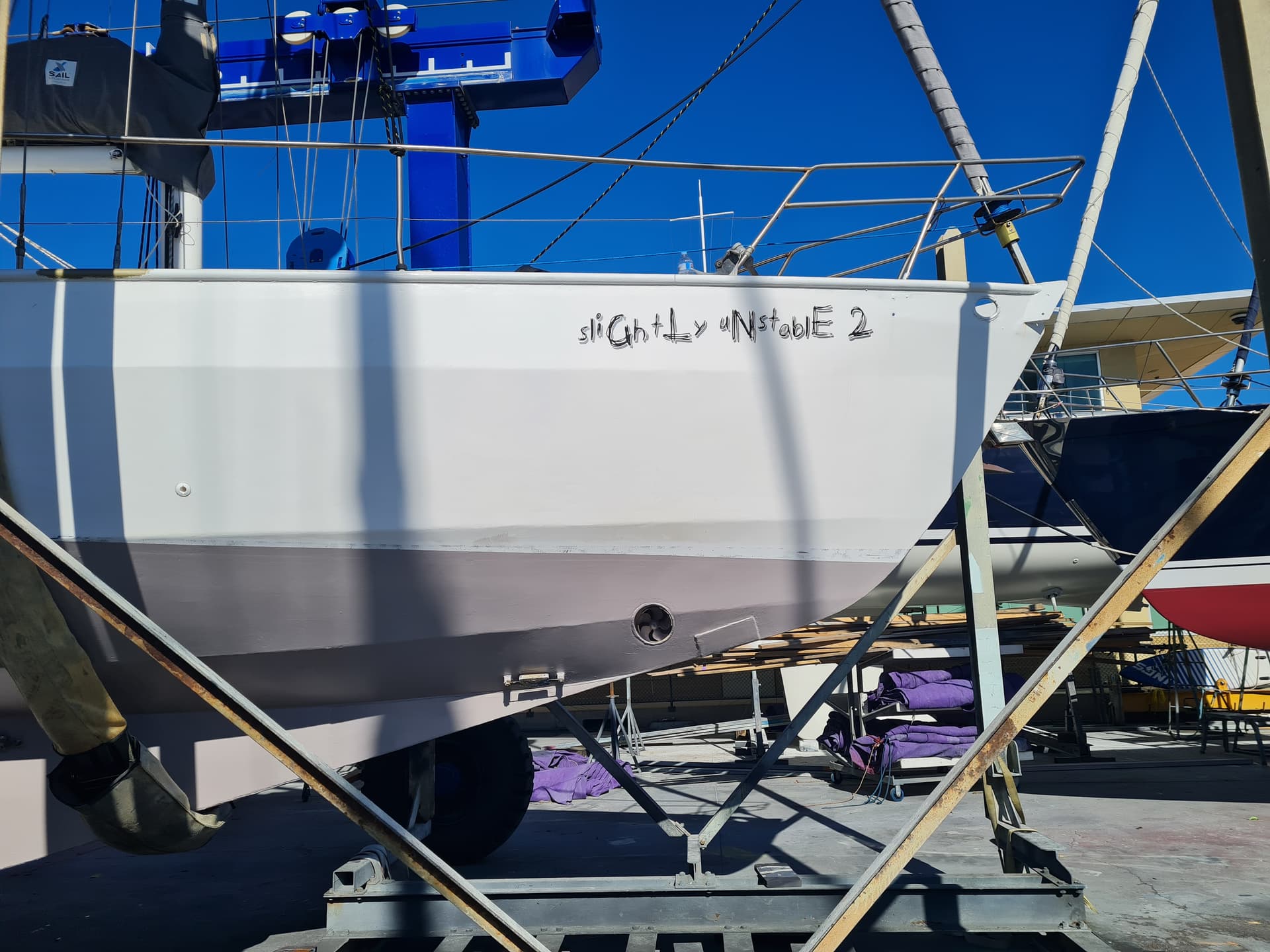

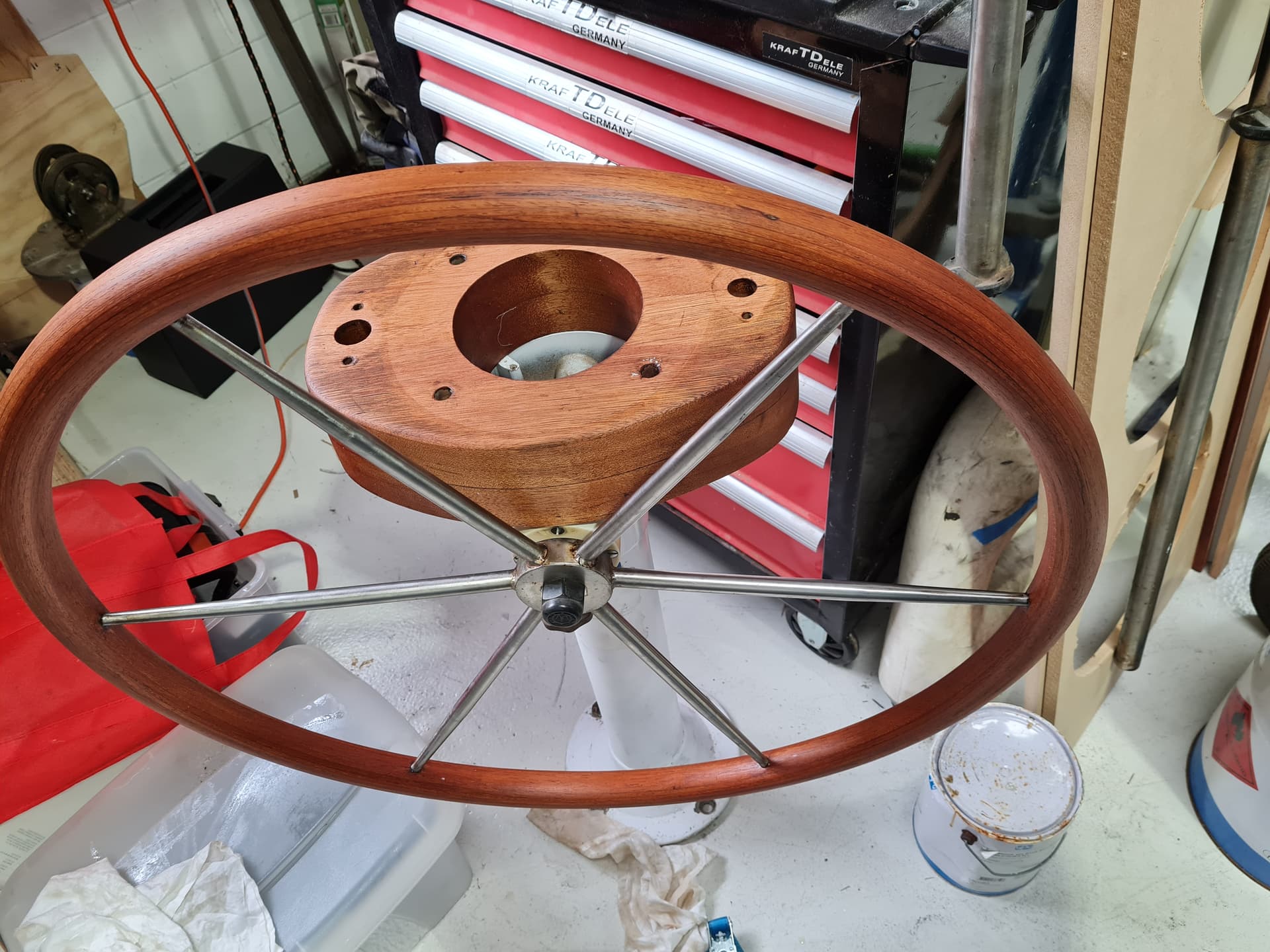

Ok and a bit off topic, but have a look at how the new wheel for my boat came out.
Its had another 6 coats of spar varnish since that shot, rubbed down between each coat. it looks pretty good.
Ans seeing we are off topic here is a couple pics of the thruster I was putting in the boat .
Not exactly for this forum, but we are off topic.
