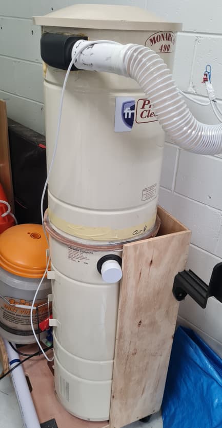

FrankenVAC v2
ITS ALIVE, ITS ALIVE!
ok, it needs some love, lol.

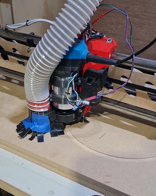

but it sucks really well, i will need to remix the dust shoe to accept some bristles that i can get here.
As the GETTO version using the gaffers tape or race tape was just not stiff enough and the vac sucked the “fingers” up into the holes. But even so its was moving a lot of air, and there is a lot of vac pressure there.

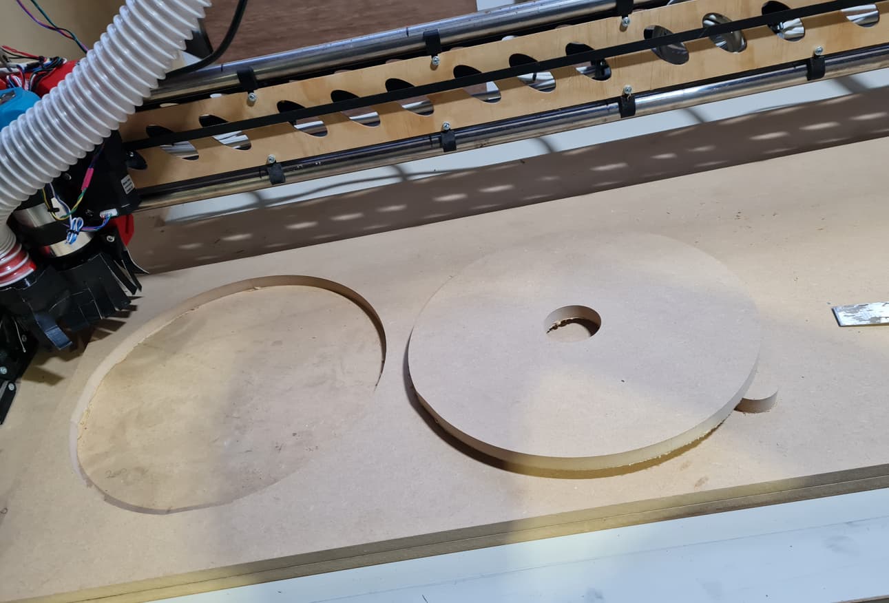

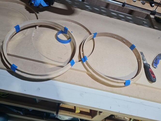

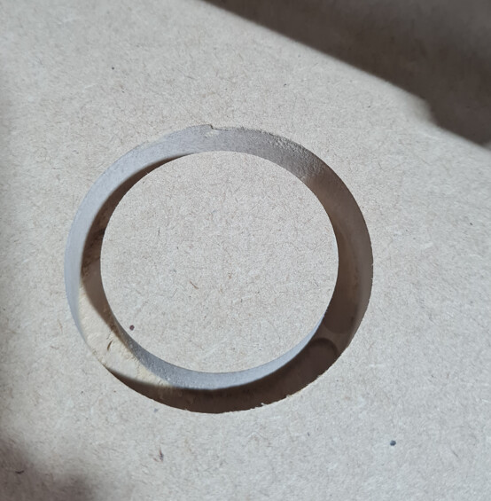

I cut two “rings” out of 16mm MDF, one was just a donut and the other was a donut with rebate sit on the top of the dust canister, i am going to fill that with some foam tape. the two got glued together and i will see how they fit tonight.

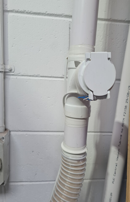

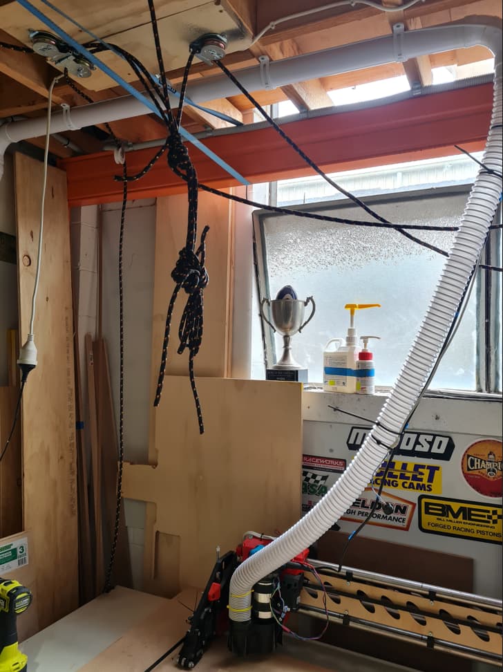

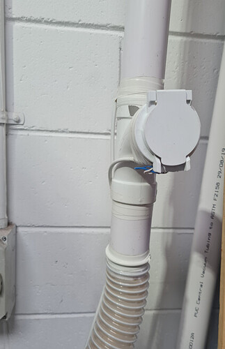

I ended up buyin some 51mm (2") flexi pipe someone from here linked to at a local supplier (carbatech) and went with some rigid pipe and ducted vac fittings.
Dust collection wise, it did pretty good. Almost all the dust was collected, except for the deep parts of the cut. I am hoping with a bit of a mod to the dust shoe it will be better.
FrankenVAC leaks like siv, lol. these parts should go a long way to fixing that.
The “upside down” cyclone is not working, without using a clear lid i cant really see what is going on, but i suspect that the pipe to bring the vac pressure down to the motors (the bottom barrel) is not really allowing the dust to swirl properly. So looks like Franken VAC is getting a bit of nip and tuck.

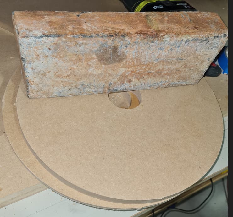

FrankenVAC has its issues that i am going to have to address. I cut the bits of MDF to start to address them, glued them up on Saturday before driving up and back to Country Vic (3hrs one way) on Sunday. I get back to the workshop Monday night after work to find i made a ROOOOOOKKKKKKKKKIIIIIIIEEEEEE mistake.
After I smeered the glue around I lined it all up and put that block of led on top. As we all know, MDF is a bit slippery and slides around. I thought the weight would have held them in one spot. SIGH.
I even had some clamps right under the table below it. honestly i thought the , like 20KG block of lead would have held it in place.
BACK TO THE DRAWING BOARD.
SIGH
yeah, nah as you have discovered, you have made a perfect hovercraft … just needs a pin or two before clamping.
Yeppers!

I was not happy with the performance of FrankenVAC, so its going to get changed after i cut some more rings tonight.
I am going to cut down the motor barrel so its quite short, just high enough to fit a HEPA filter i found we sell. Then i will use the existing vortex generator and cut its barrel down to be only like 200 or 300 mm high and then last will be another barrel with its motor section cut off, and turned into a bin.
The vac pressure will be from the top like all others, and the dust will fall down into the bin. Pro ones have a big plastic bag. I dont expect i will be making that much dust… (famous last words) but even so it should not be a gig thing to empty it.
The motor unit and vortex generator will be clamped together and supported with the original wall mounts for these units (relocating the mounts probably)
the dust barrel will have to sit on a platform that will raise up somehow.
