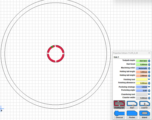

But todays questions is actually about ESTLCam, basically I am trying to create the grey bit in this render.
I have created the DXF and imported it into ESTLcam and created the “hole” in the center.
But for the life of me i can not figure out how to create the ???rebate?? around the outside.
I though it would be a “Pocket” but all elstcam does is fill in the centre all the way to the centre hole, when i want the rebate cut. I thought that i would
Anyone let me know what I am doing wrong?
Island is what you are looking for. I am petty sure my write-up about it is on the milling basics page.
So you did, thanks!
