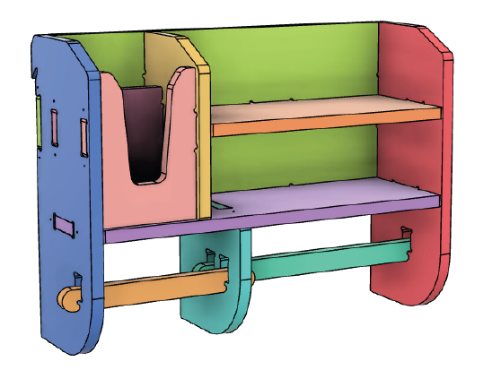

French cleat gloves and towle holder (i will probably get some different ones of these, to fill out the back of a small cabinet i have. The right of that picture above)

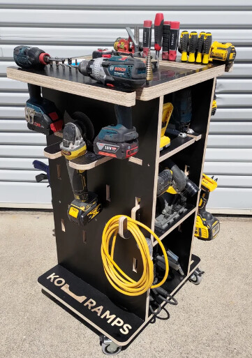

And a tool cart i like the look of
The time it would take for me to design these and CAD them, is worth the AU$35 all up for the plans.

That cart is simple/awesome!
Needs an arduino and steppers and whoopie light and remote control :wink:

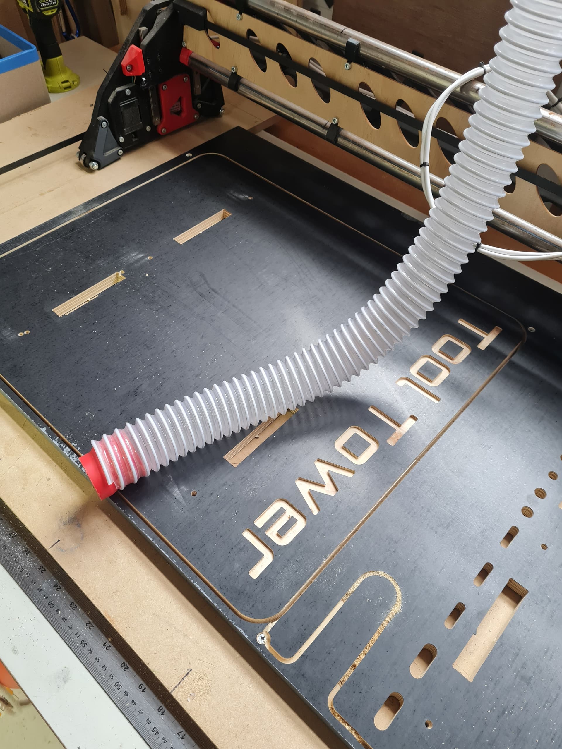

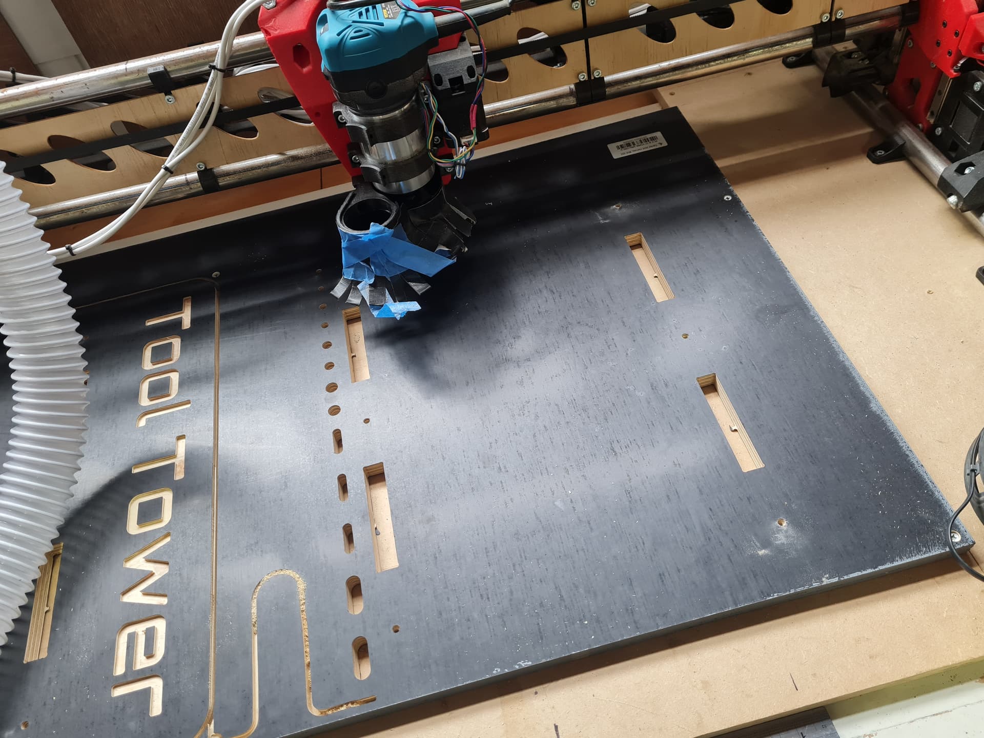

I started cutting the kart.
And lernt a valuable lesson, a little expensive, but not too bad
Check the zero start point
But well, you live and learn.
Honestly though, I was super happy with the performance of the LR3, the “tool tower” words came out really well, quite happy with the speed and depth of cut.
@RockinRiley was asking about the VEVOR router, and that was pretty good too. The only negative that i would say is that i cant really tell the difference between 1700 RPM and 2400 rpm or 1500 RPM to get the most out of my bits and speed.
I know there are speed controls out there for routers, but not really sure what works with LR3 hardware , but at the same time I am not sure that it matters that much with the amount i am cutting. Which is stuff all.

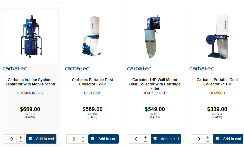

My thoughts on using Whole home vac systems as HIGH PRESSURE dust removal, yep it works and works well.
You can use just the bags, but that will get expensive pretty quick. So using the swirl separators and a HEPA filter like i have will defiantly give you a great result .
Is it cheaper, probably not (although any whole home vac supplier does have these old barrels that they will give you for free. but the motors are more expensive)
Technically I have a 3hp unit, but I doubt it is actually that, so lets say 2hp and, and even in the EXPENSIVE land down under a high volume unit is now in the affordable bracket @$569
Did I pay that for what I have done, no. But that’s because I get it so cheap and even for free in some cases. “Hooked on wood” is pushing this type of HIGH PRESSURE type of vac vs. the HIGH VOLUME of the “normal” units, honestly not sure which is better, but it was a super interesting exercise.
If I had more money I might of just gone and brought the unit, stuck it int eh corner and started cutting but i dont. lol. and where is the fun in that anyways.
