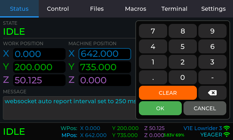

Yes, I’m using a graphics library called LVGL. It has a keyboard component. It does feel a little off but what specifically? There are some customization options. I’m unlikely to create a whole new keyboard due to the level of effort involved. I did create a custom number keyboard for the Status tab because the standard keyboard wasn’t good enough.

Yea, I did implement my own number pad without the keyboard control, but a regular keyboard is much more complicated.
