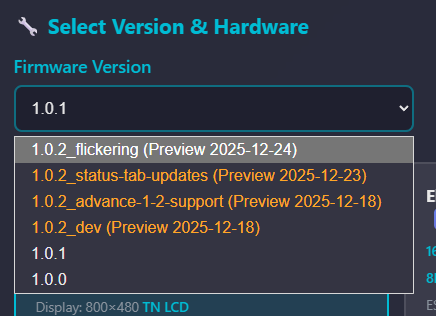

I pushed out some updates this morning to hopefully fix some of the flickering issues. What I tend to see is especially when on the status tab while a running a job, the screen will sometimes shift a few pixels. I’m not sure I’m ever going to completely get rid of it, but it seems to be much improved.
If you could try it and let me know, I’d appreciate it!
It’s the 1.0.2_flickering version.

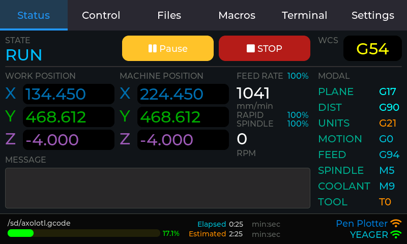

Also, if you’re curious, that 1.0.2_status-tab-updates build has these changes to the status tab (but not the flickering fixes):

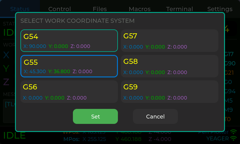

  • Edit position (goto) with Cancel Jog button
  • Pause/Resume and Stop button - I’m questioning including the stop button. It results in a DOOR status which you can resume from, so it effectively feels like pause and stop do the same thing. Thoughts?
  • Change the working coordinate system.
  • To make room, the progress bar was moved to the status bar at the bottom.
I’ll probably put out an RC1 build this weekend with all the changes.

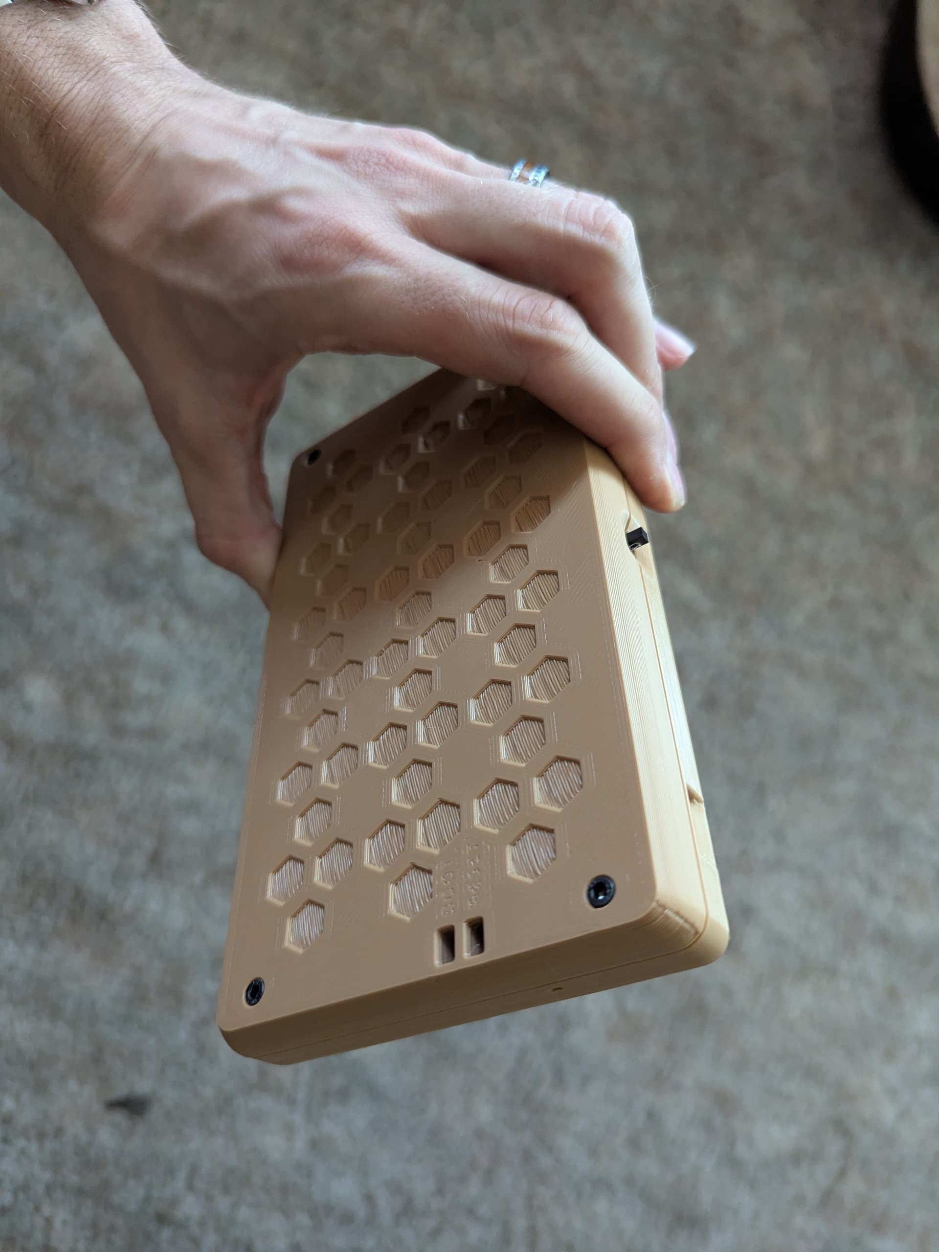

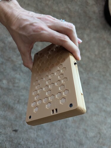

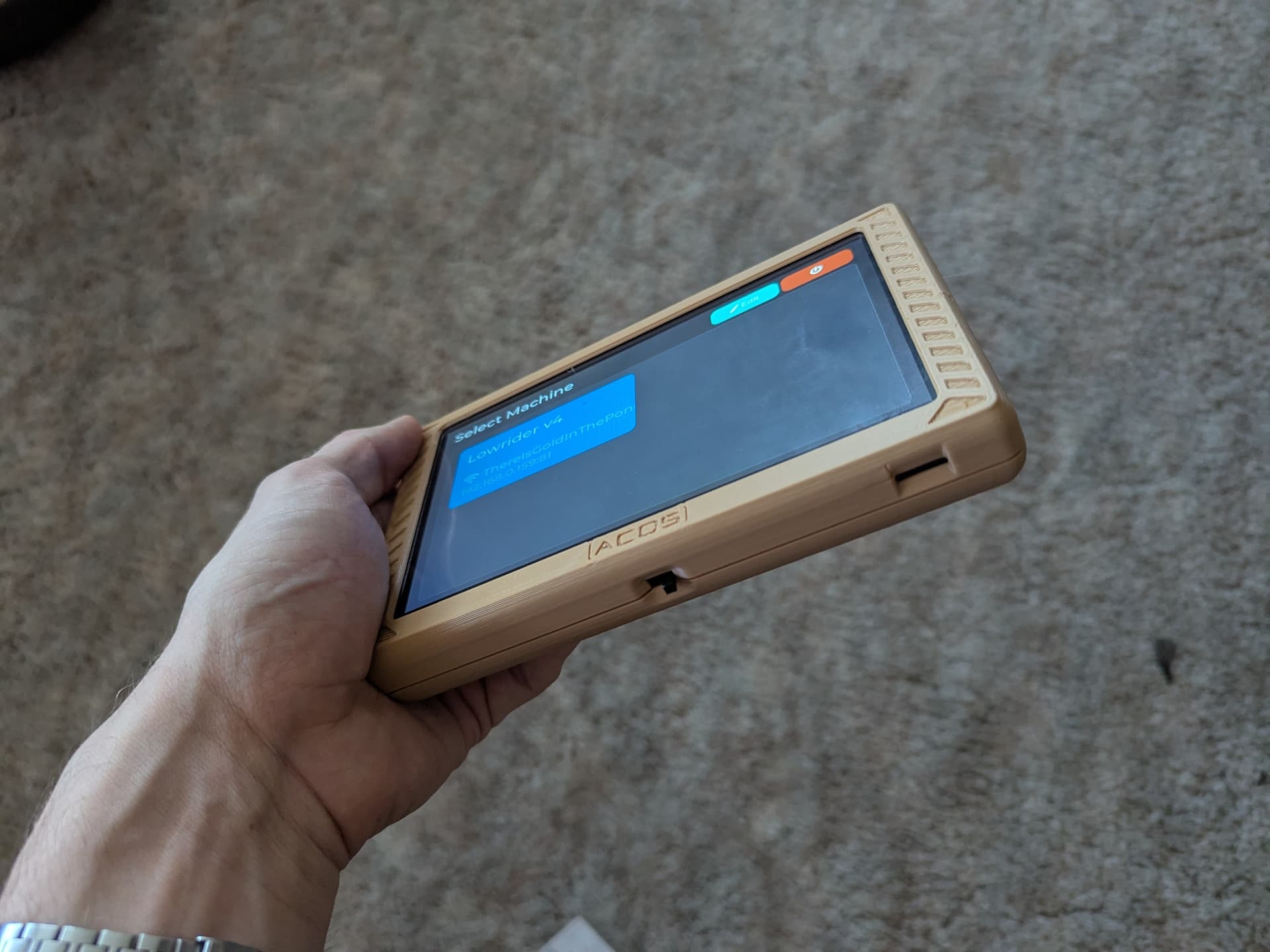

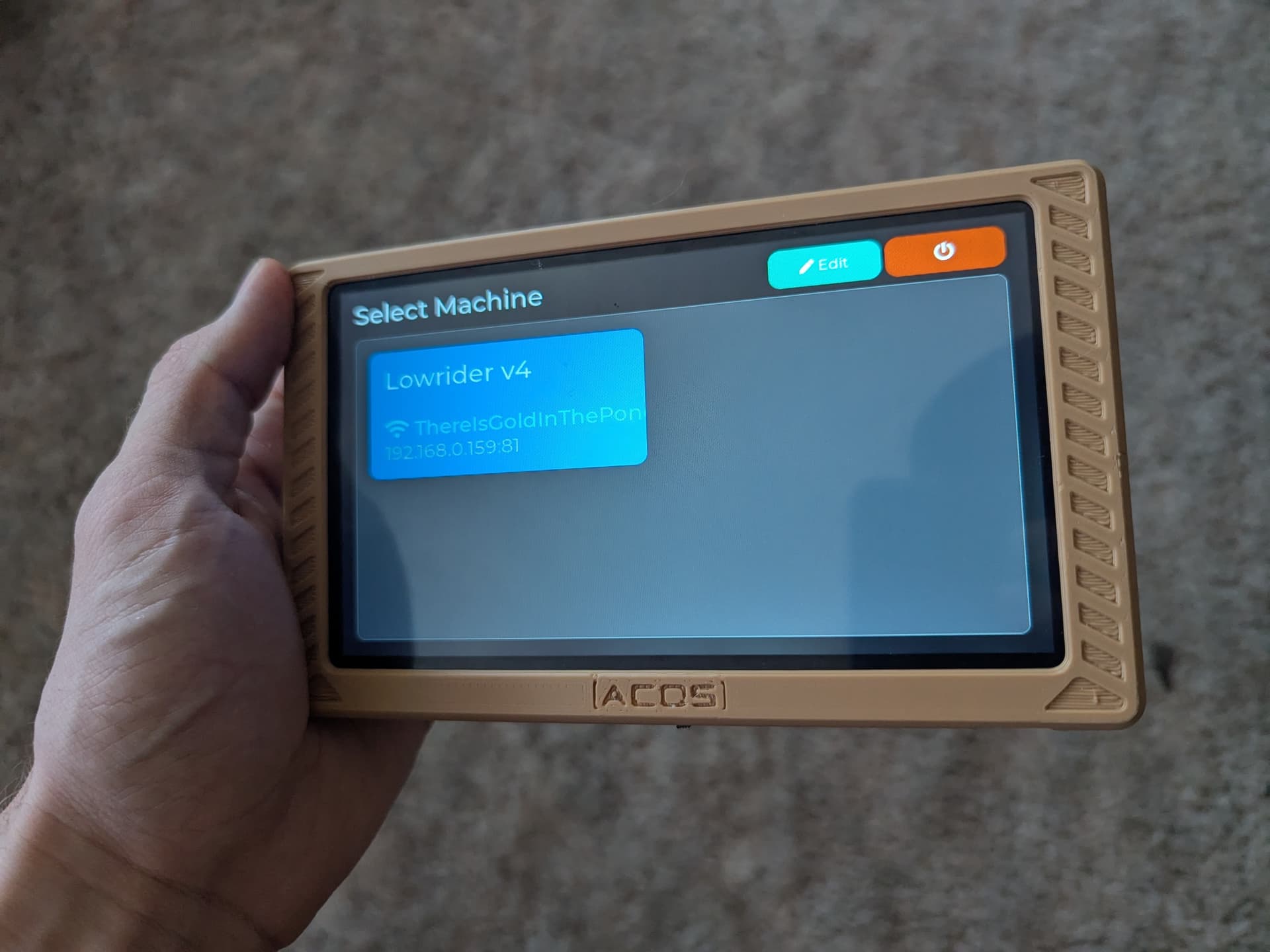

Found that case design the other day and modified it a little since i didn’t have the antenna etc
Had a few fitment issues. Not sure if it’s because i printed with 6mm nozzle, but had to adjust a few spots with soldering iron. And there is a little bit more of a gap than I’d like, but i’d say good enough…
Big improvement on the acrylic case!

Are you referring to the working coordinate system change? So, goto would go to 0,0 (probably not change Z) in that new WCS? That makes sense in my head.
Looks cool! Able to share link?
Curious what larger battery(s) people are squeezing into custom printed case?

Just replicating the tablet tab of FluidNC you can either enter a number and jog directly to it or enter a number and use ‘Set’ to update the current coordinate.
Although now I say it I can’t think of a value other than zero you’d want to set so maybe it isn’t needed after all :grin:
This is the original file:
Here’s my modified design file (no antenna, also got rid of the threaded inserts, which seemed to work fine) - the stl in there has the final modifications that I think should make it fit well without modifications
I contacted the creator of the original design and he is going to release a version without the antenna slot very soon.
I think it’s a she going by the profile picture and the nice nails in their video.
