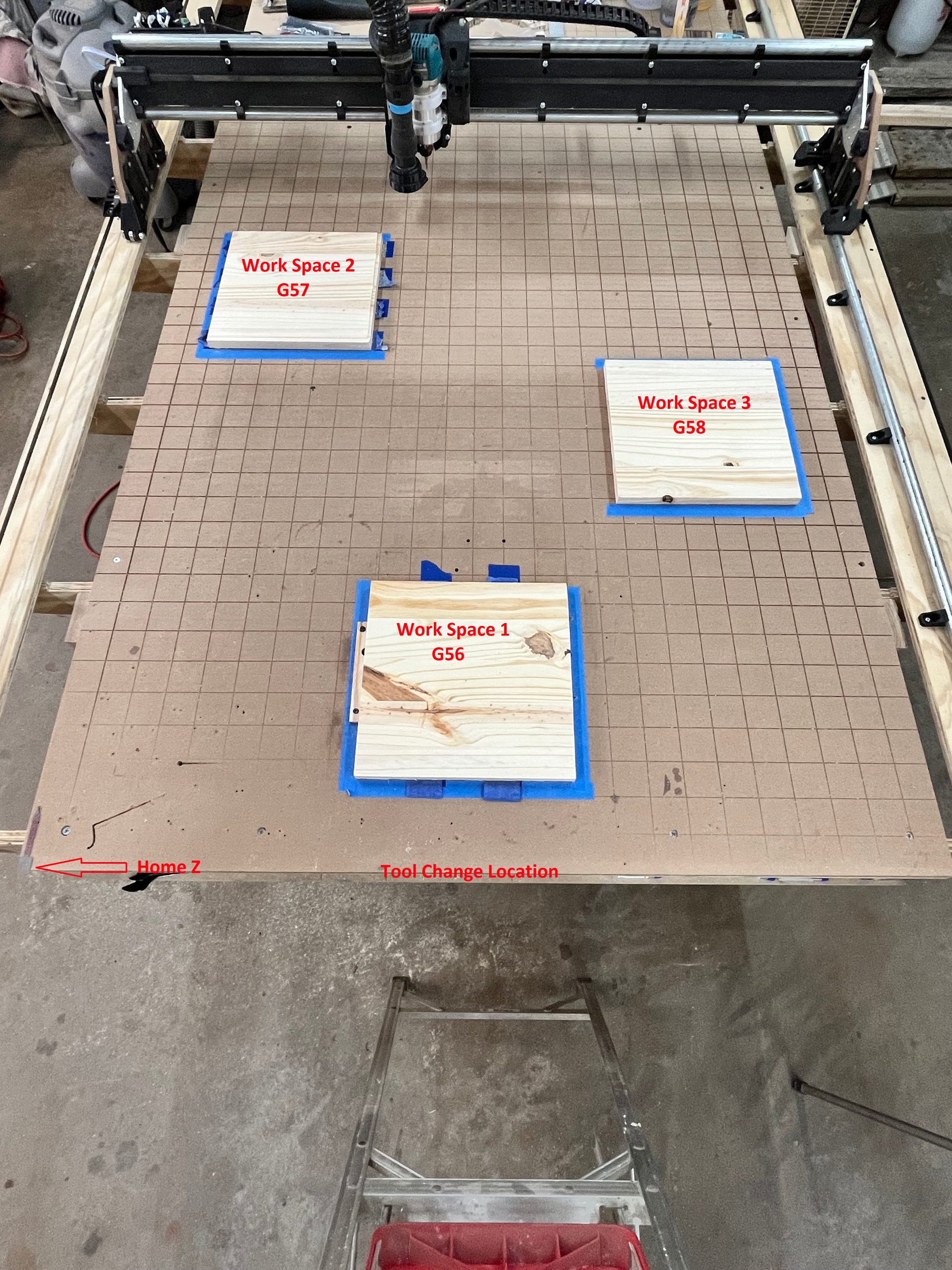

With a little effort and thinking, it is easy to setup a single gcode to make as many of the same part as long as you have the space available on your CNC table.
First you need to locate where you want each part to be.
Second you need to decide if your going to setup your work from a top corner, top center, bottom corner, or bottom center.
With this one, I am using Bottom Center as my Zero Z is at the corner of my CNC Table.

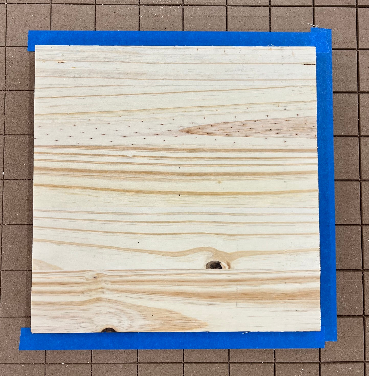

Third I would recommend putting painters tape on at least 3 sides of your work so you can flip the part over if needed, or replace the part if something goes wrong and you need to start over.
Also very helpful if you want to create even more of the same part.
Forth is to setup your G54-G59 locations.
Home your table, move the router/spindle to the first location (be accurate).
I always use locations that do not include .000

For my current setup I have 5 locations and I write them down for quick reference.
You will only see things like G54:7.000,20.000,-15.000
My Reference:
P1 Zero Probe G54:7.000,20.000,-15.000]
P2 Tool Change [G55:507.000,3.000,3.000]
P3 Work 1 [G56:600.000,283.000,3.000]
P4 Work 2 [G57:253.000,1100.000,3.000]
P5 Work 3[G58:1003.000,753.000,-15.000]

I always start my projects by Homing then issuing a G55 ENTER and a G0 X0 Y0 Z0 Enter to put my router/spindle in the Tool Change location.
When this WCSTestCode.gcode is run it does the following.
Sets the Absolute distance mode, Set to MM (G20 for Inches), Default units per minute mode, and Pauses.
On Resume, it moves to G54 (probe location) and probes.
Next it moves to the First Work Location and starts the Job.
(Everything between "Simulate work one, or two, or three, to Move to XX Work Location can be replaced with the actual work gcode)
Once the last (third) job is done, it moves the tool back to G55 (tool change) location and Pauses.
One Resume is clicked, the program ends.
The included video is a quick sample of what the WCS code can do. The up/down motion is a representation of That job starting and ending.
