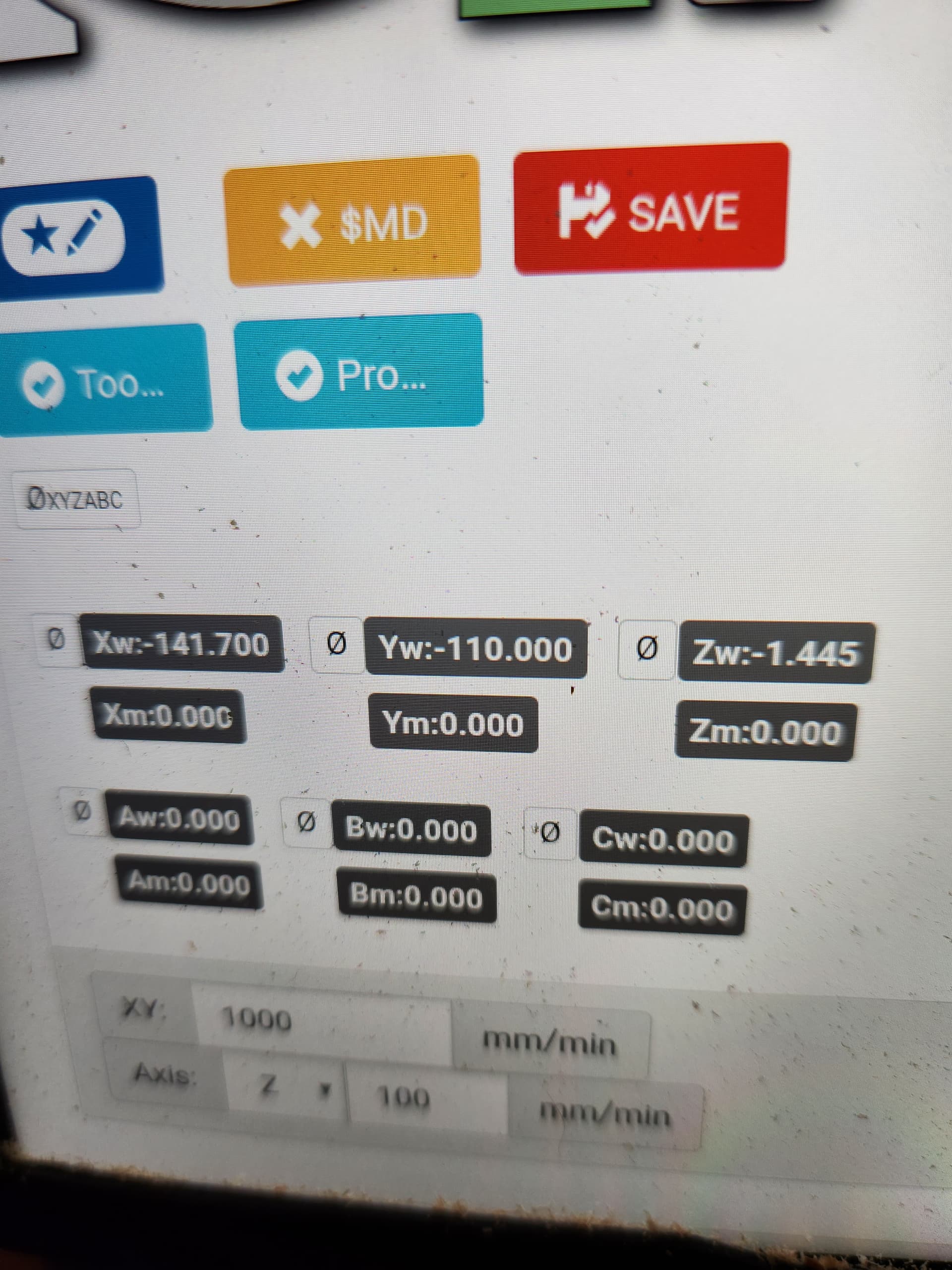

using the very lil zero x y z at the lower left corner
What’s that now?
I will get a pic in a few.
You can see it under too in his pic. Set zero x, y, z
After that was pressed i could not go -x or -y
Well crud i went to edit and hit delete!!
I do not see an undelete. I wanted to say i have a mpcnc without endstops.
(Found undelete :wink: )
How are you setting them to zero?
Press that button. I move to corner of workpiece set my z and press zero xyz. (it is interesting theirs says (xyzabc)
I have no idea what that button does, you will have to look at the terminal.
G92 X0 Y0 Z0 should allow you to go negative. If it does, it is easy to make a macro button.
I zero with my CAM starting gcode, not buttons.
@Riley your issue is that you have the soft limits activated for your machine. So when you make all your axis 0 you cant move to negative values without hitting the homing button for that particular axis or you will be blocked. Its on the fluidnc wiki.

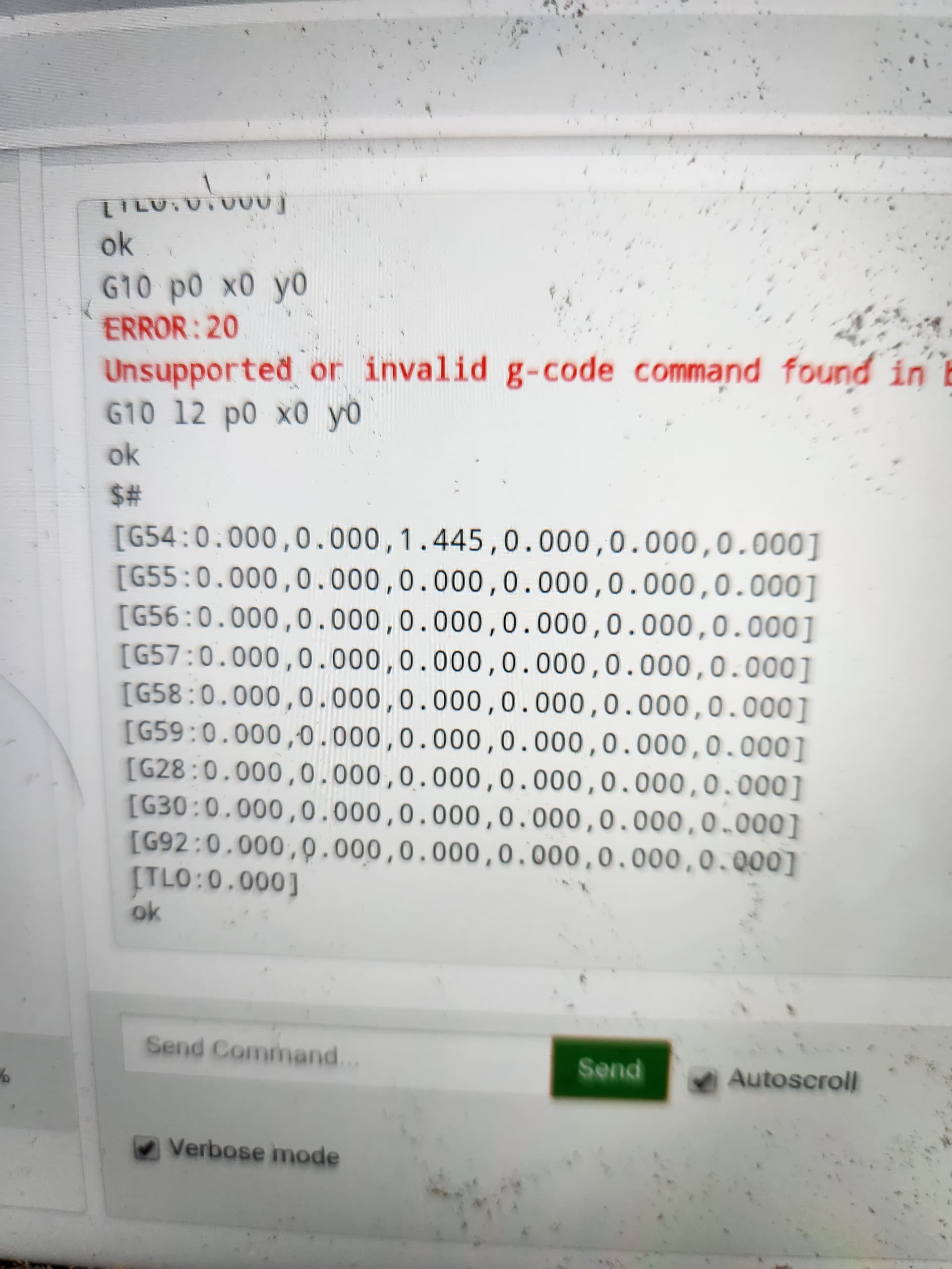

These kind of issues bug me, so I have been doing some reading on work coordinates and I think I can explain this.

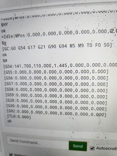

There is always a current work coordinate set and it is usually G54. You can check this by entering command $G This shows all of the modes that are set. You can check what the workspace coordinates are by entering command $#. You can change a work coordinate using G10. In this case I used G10 L2 P0 X0 Y0. P0 is the current work coordinates, P1-P6 is G54-G59.
In this screenshot you can see the current modes and current work coordinates:
In this one you can see the G10 command and the updated work coordinates:

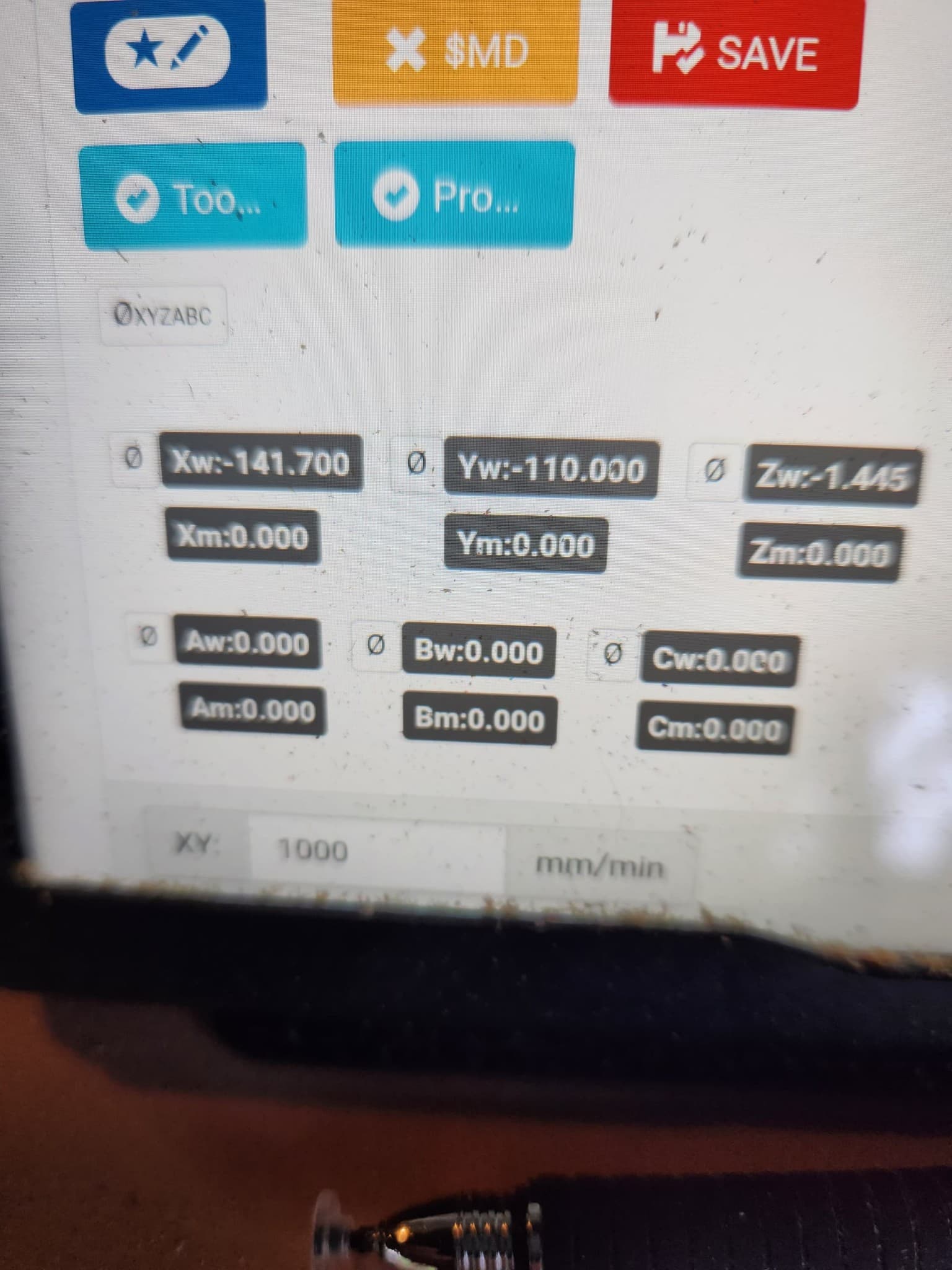

What is a little interesting, but I do not care is the graphic did not update:
@vicious1, I am guessing you had G54 set to 0,0, so you are seeing normal behavior. It is now working correctly for me.

So you are absolutely correct soft limits false allows negative travel. My thumb just hit y 50 and guess what that was too far. I am not sure soft limit false is what I want. i will need to consider, thanks again!
I just found that the Zero commands set G10 and still use another coordinate as well.
