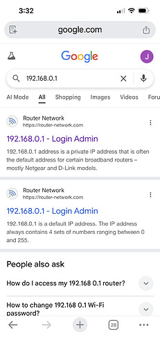

Joe did you see something that let you click “use network as is” or “Stay connected anyway”?
You have to give us more details, your windows 11 computer is not acting like any other we have seen. What browser? If you could get larger pictures that would help, you are cutting off all info that would let me figure out for myself what browser.

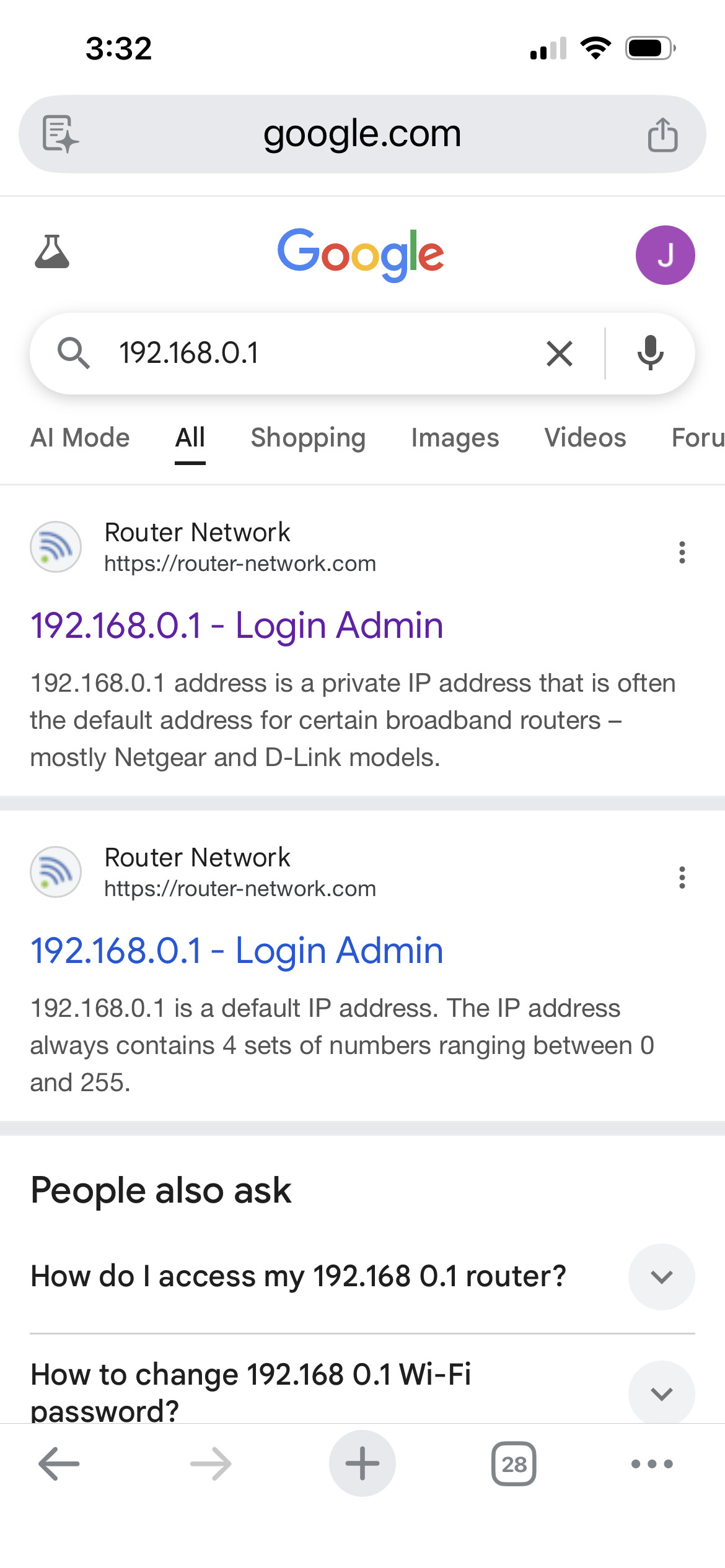

To recap- as i understand it , i need to power up the board - and then open a browser and type in 192.168.0.1 and that should open the WEBUI ? to enable jogging etc . i have tried using a laptop w/chrome ,an ipad w/chrome and iphone . it will not connect . if i use google search engine it gives me this login page , but it gives me the same unable to connect message . Maker Jim has asks to open command prompt- really not sure how to. - frustrated - but if you have other ideas to fix whatever i did spell em out and will try - OR OR - sell me another board set up for mpcnc with click by click steps to initiate set up. Thanks again Joe

Then the second step is to connect your device to the jackpot.
Then the third step is to tell your device not to disconnect if it doesn’t see internet. It won’t see the internet in a Jackpot in AP mode. This setting should only need to be made one time or again if your device gets an OS update.
That screenshot says you are not connected to the jackpot, and your device is instead doing a Google search on 192.168.0.1, not connecting to it.
