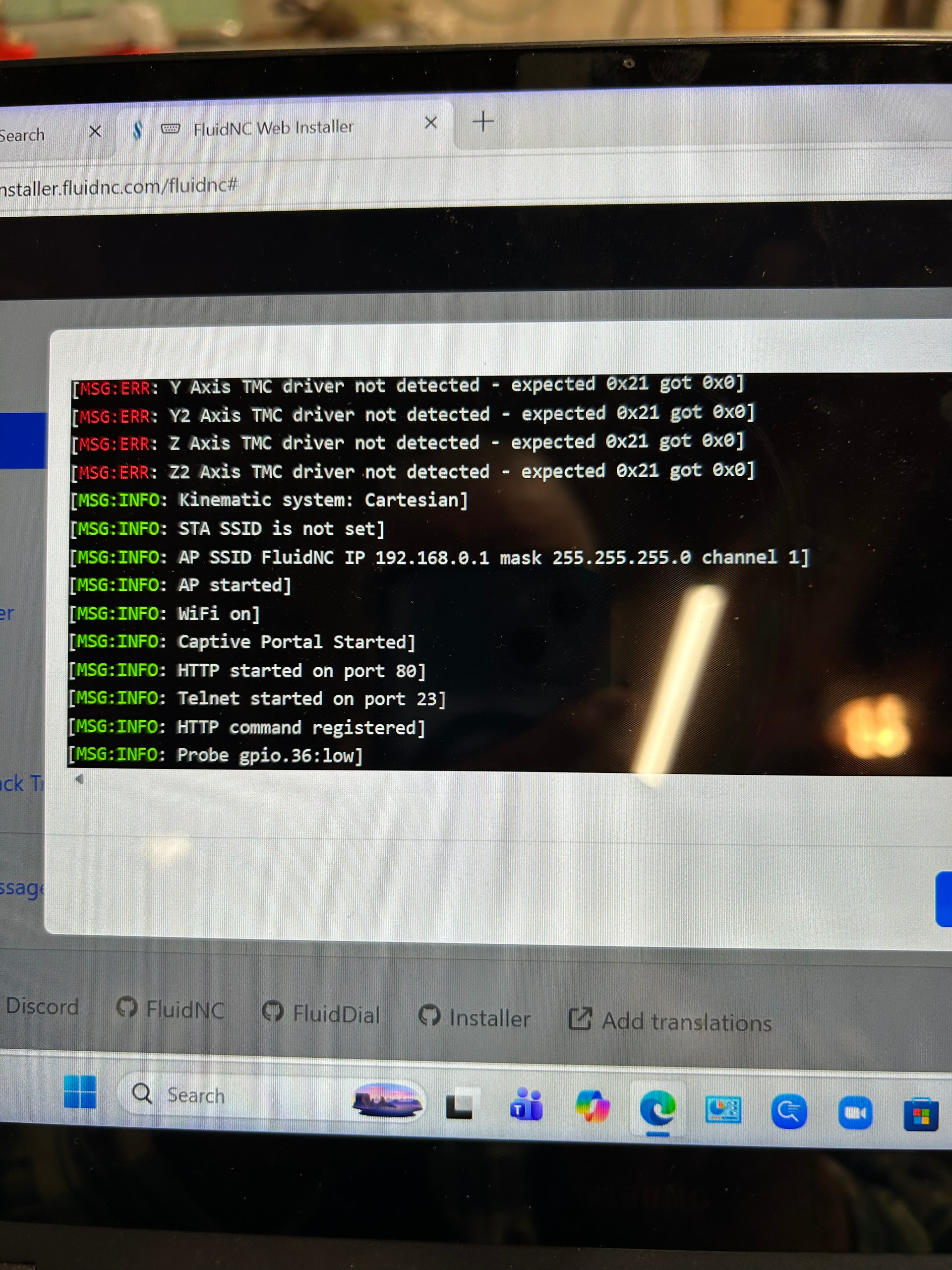

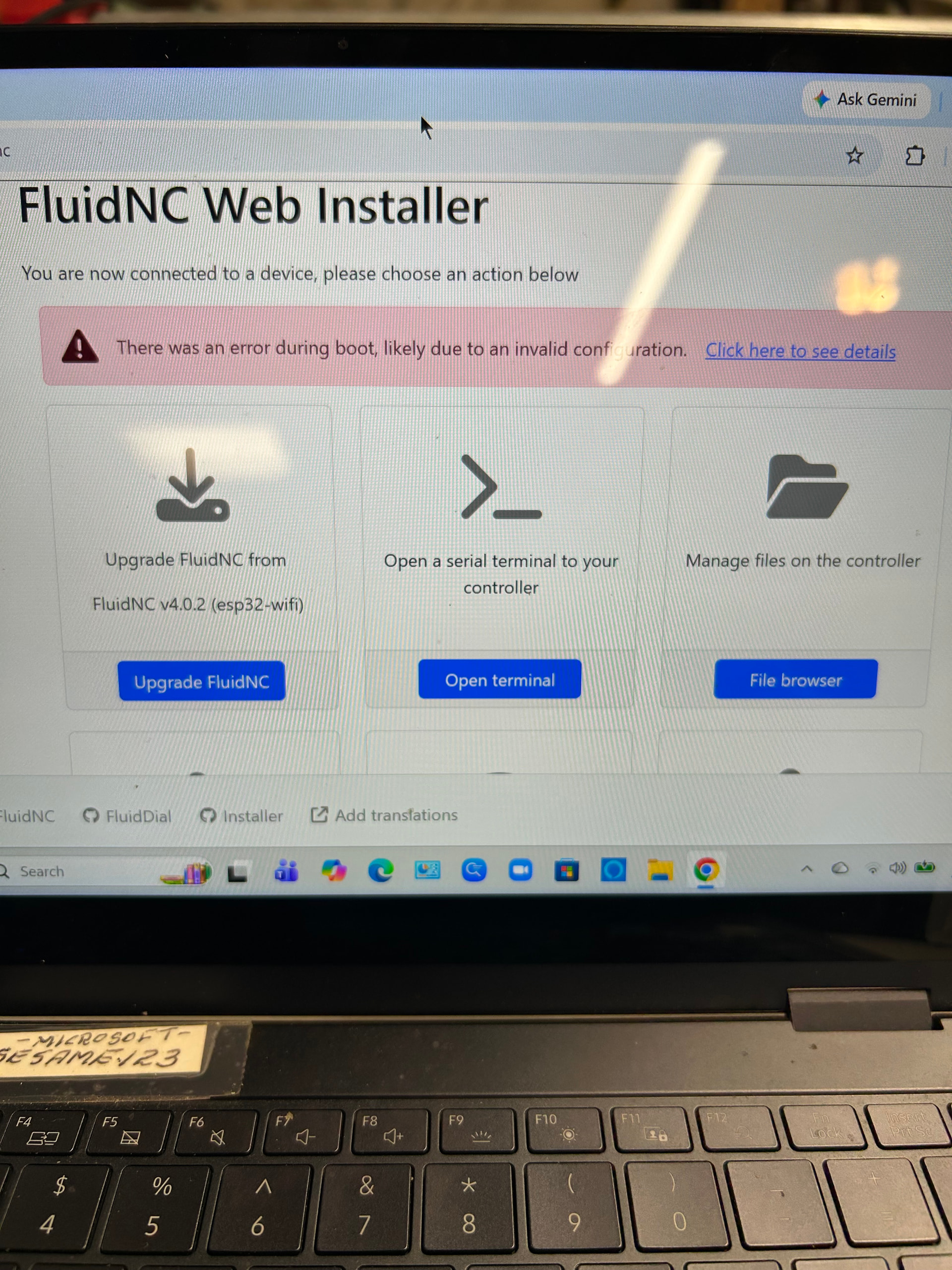

Joe again- I have a new jackpor 3 board that is flashed for the lowrider - tried to reflash for mpcn and this is 1st sceen I see. can youy tell whatis wrong ??
Nothing is wrong. You just need to download the MPCNC config here and upload it to the Flash on the JP3. Then unplug the USB and powercycle the JP3.
agreed just upload the new config.yaml to the same folder in the files section of the web interface and then power down for a few minutes. after that it is an mpcnc controller.
or you can plug it in via usb in the webinstaller and upload the file.

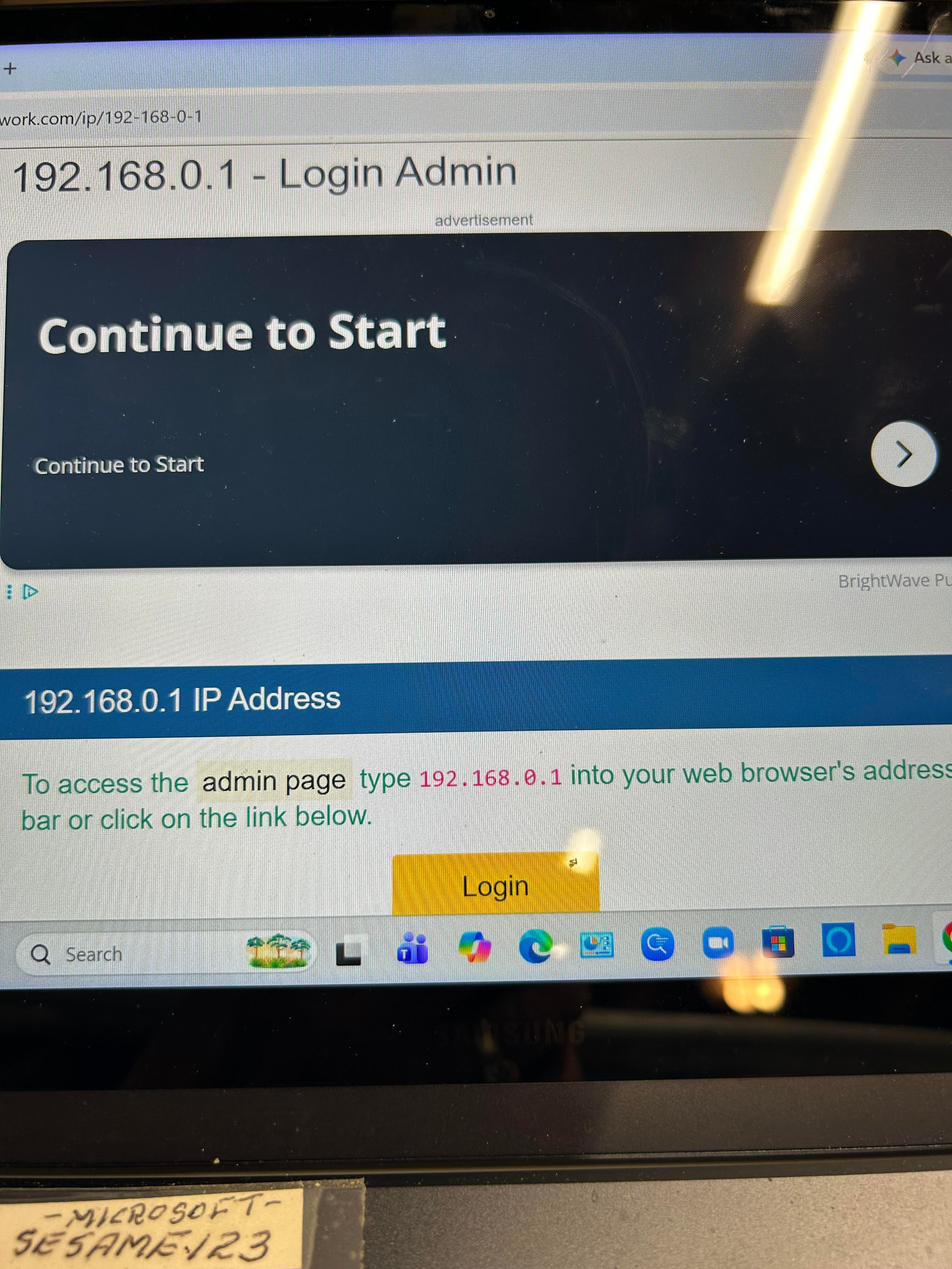

when I try to access my mpcnc jackpot 3 via chrome - [ I believe that is the WEBUI ] It says “this site cannot be reached” ??
Screenshot?
Is the URL you are using fluidnc.local or 192.168.0.1 ?
198.168.0.1

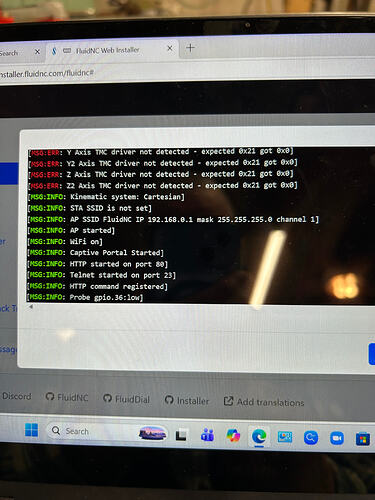

I am wondering if you actually flashed it. That screenshot shows and error and it should not have had lowrider firmware on it after a flash.

I did have trouble flashing but now when i check settings it says mpcnc.– when i open fluidnc it does not ask for a password it just opens with this page. – the instuctions i have say to open command prompt go thru go thru the WEBUI ???

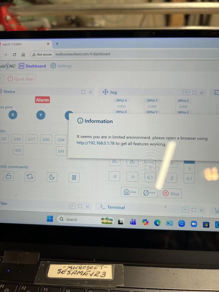

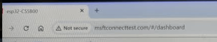

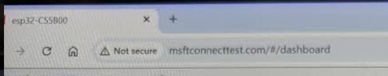

The browser window you have open is at
msftconnecttest.com/#/dashboard.
That means you’ve opened the browser window using Microsoft’s built in, limited web capability captcha browser. That limited browser cannot correctly operate the WebUI. That’s what it’s telling you.
To be able to use the WebUI, you cannot do that. You MUST open a real browser (Chrome, FireFox, even Edge) and from there connect to 192.168.0.1. If you don’t do that, it cannot work.
This is why we ask for screenshots not typed descriptions.

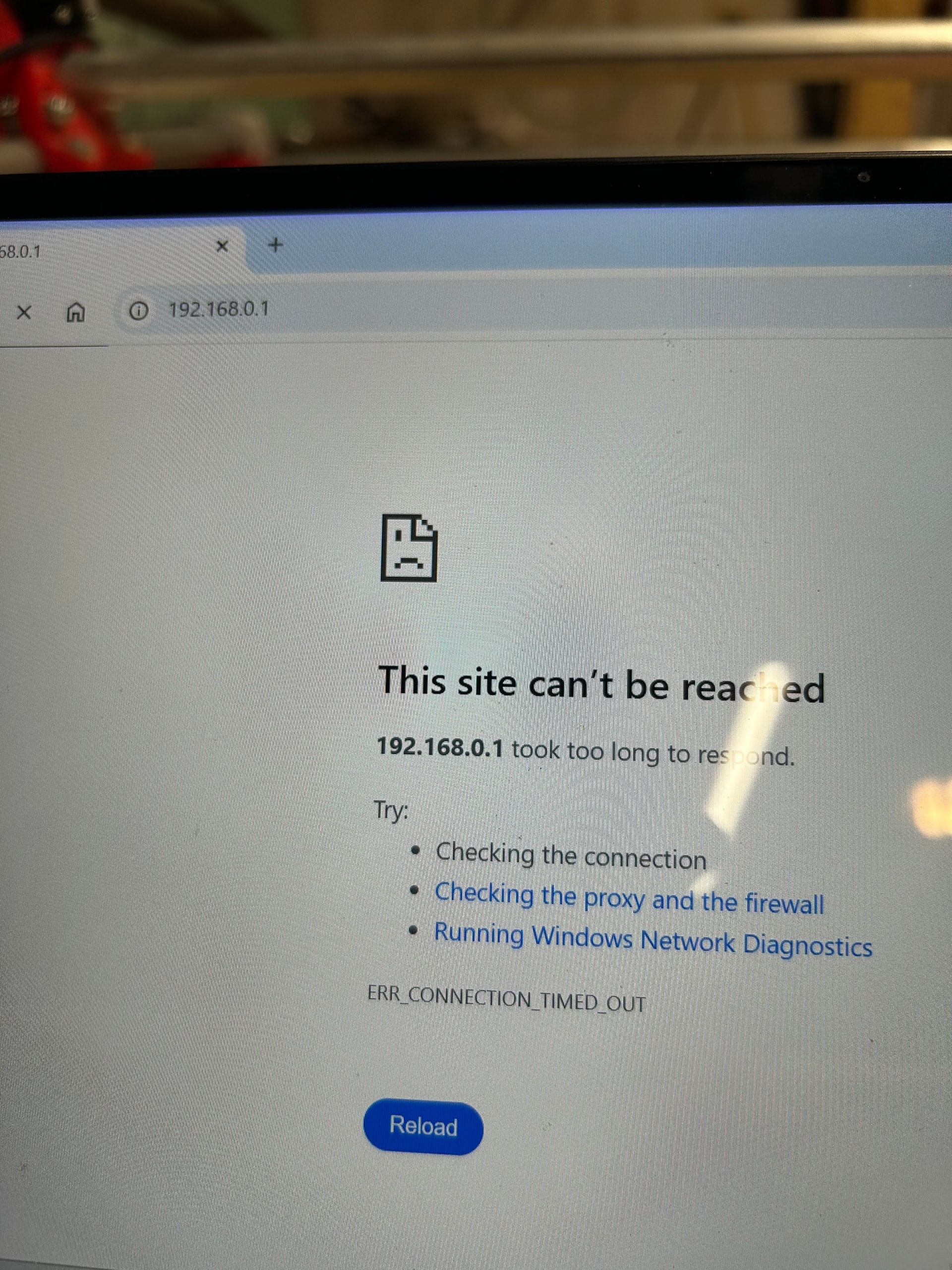

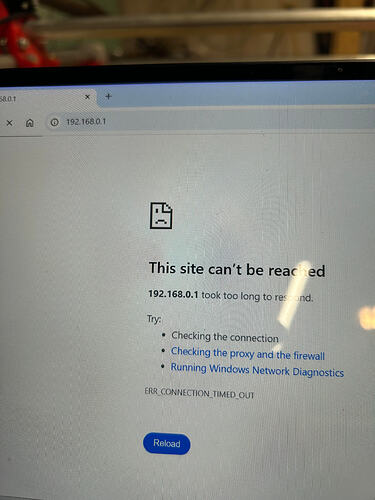

This is why i opened this thread [ sans photos] when I open in Chrome the bottom photo is what i get – then the top photo
The bottom photo happens when you are not actually connected to the jackpot (that is your local network’s router address).
What browser are you using to try and connect? I can’t tell from the limited screenshot.

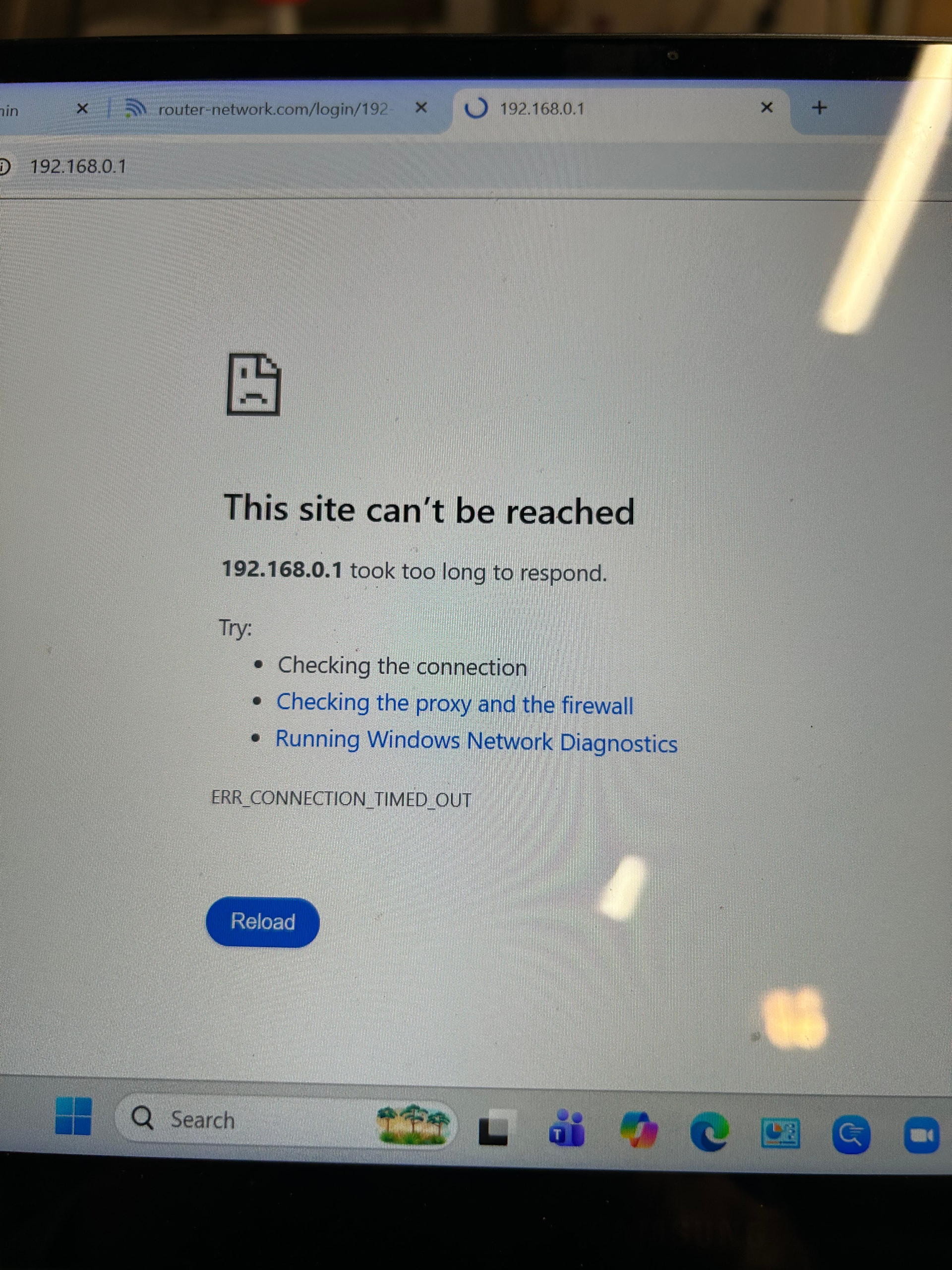

This is 90% there,
From this screen, in the upper right corner of the browser window you should have a three doot or bar menu, if you expand that you need to select “use this network as is”. Or you will actually get a pop up from your OS about not having a internet connection. You need to say that it is okay and stay connected.
Show any pictures of any pop ups or any notifications you are getting.
From that point on you need to open a new browser window and go to 192.168.0.1
You are so close I just can’t tell why your specific computer is kicking you off the network, most don’t. Your computer is acting like a cell phone.

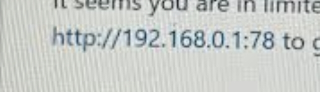

It’s odd that it’s showing port 78.
Likely windows is configured to drop network connections without internet connectivity. Need to durn that offs
We can tell more if you open a command prompt and show what the command ipconfig shows you when it is in the error state shown in your last screenshot.
