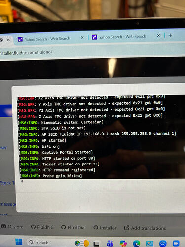

Should be a quick fix. Use a chrome or edge browser I think safari works as well. Go to https://installer.fluidnc.com/fluidnc, plug in your board with a USB cable (make sure it is not Charge only), do a firmware update, use 3.9.9. It should work after that.
Sorry, I still really do not understand why it doesn’t work over wifi even though I did flash the wifi stuff, but that day I was testing over USB and did things slightly differntly.
You should not need to do a full wipe or anything just update the firmware to wifi 3.9.9.
need clarification - it asks if i want to install ‘WebUI-2” — “WebUI-3” ???
3, but then you can replace it with our custom webu ui v3 by uploading a single file.
Ok Thanks

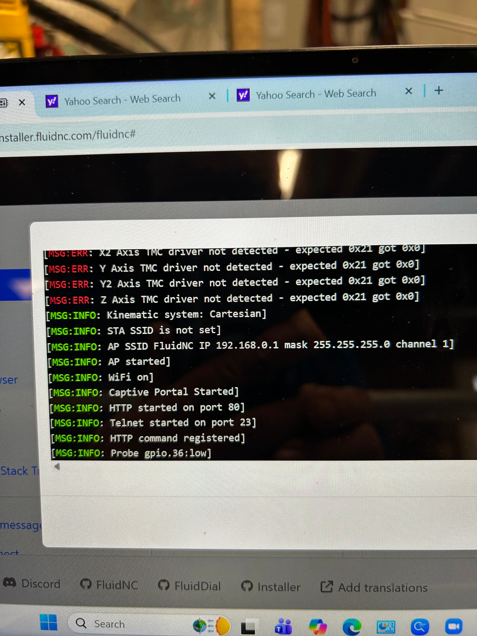

Power down and then unplug the USB. Then power back up and you shouldn’t see those errors. The drivers won’t load if the USB is plugged in before you power up the Jackpot.

This looks correct, The only issue is you are booting from the USB cable. If you powered from the power port this should work.

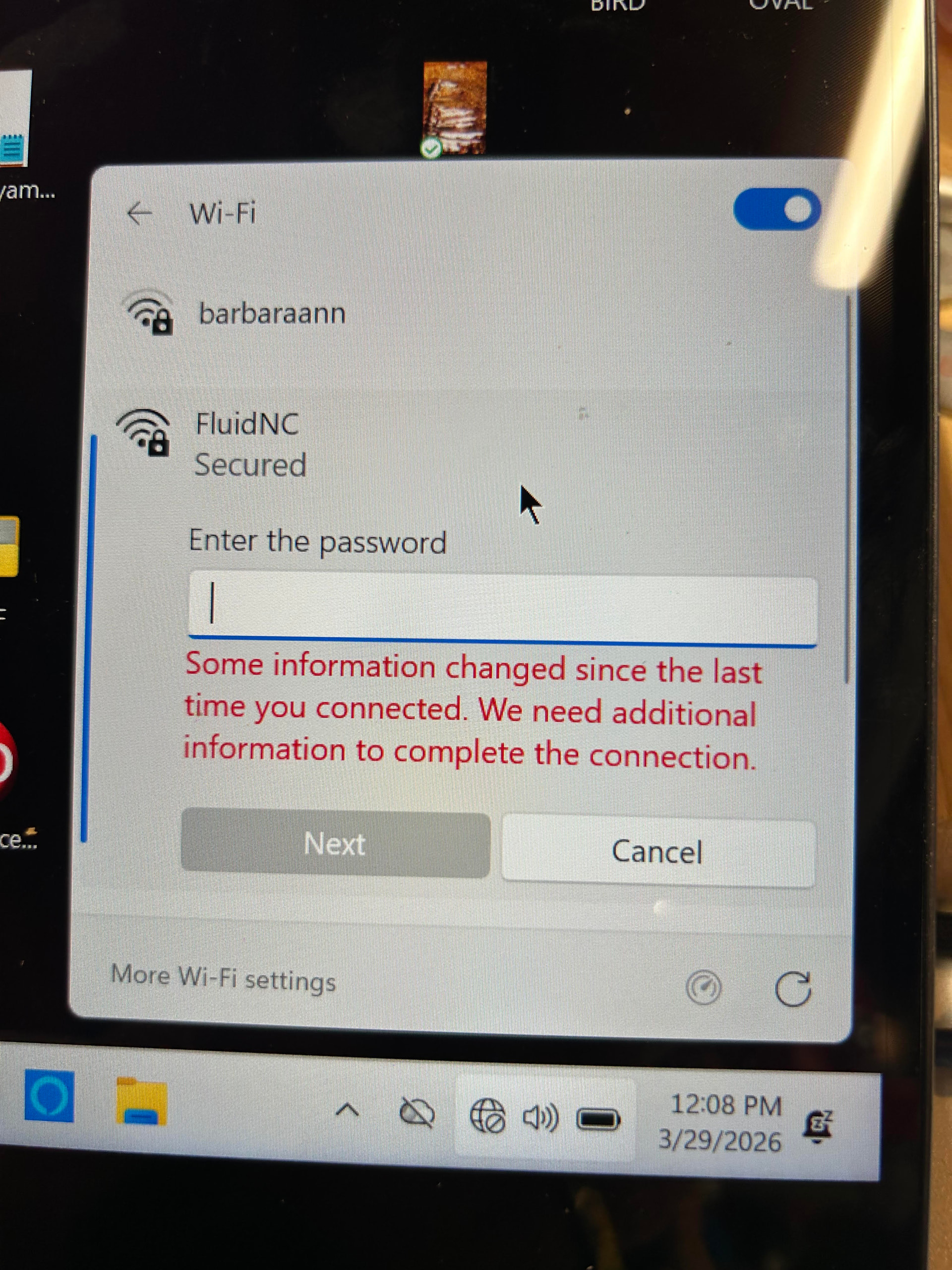

Original accident was z axis connectors ripped apart in flex chain.Mini rambo dove into board , then stopped functioning. Bought new Jackpot 3 - Ryan instructed that I do a 3.9.9 update - not sure if that was properly down . Using either computer, iphone or ipad get this screen I get this screen ???
The password is listed here, Jackpot3 CNC Controller - V1 Engineering Documentation
it is 12345678. Make sure to follow the rest of the instructions when connecting from a phone.
I never get past the password . it either says “unable to connect “ or sometimes “wrong password “
4-5 went out with a funky flash. reflash it real quick and it will work.
