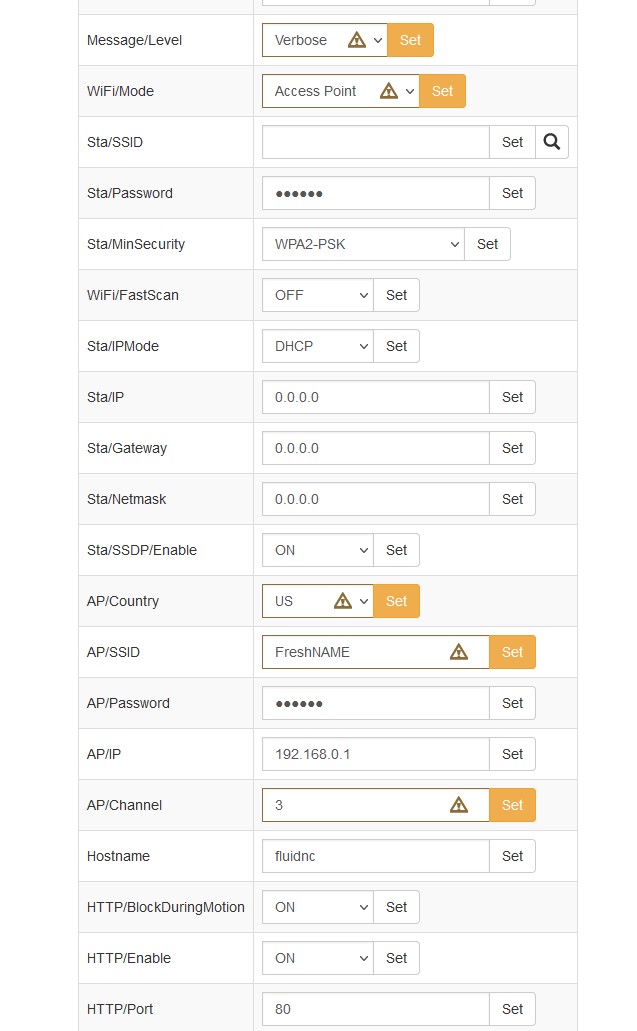

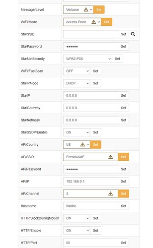

If not I would try these settings, save, and power cycle.

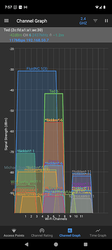

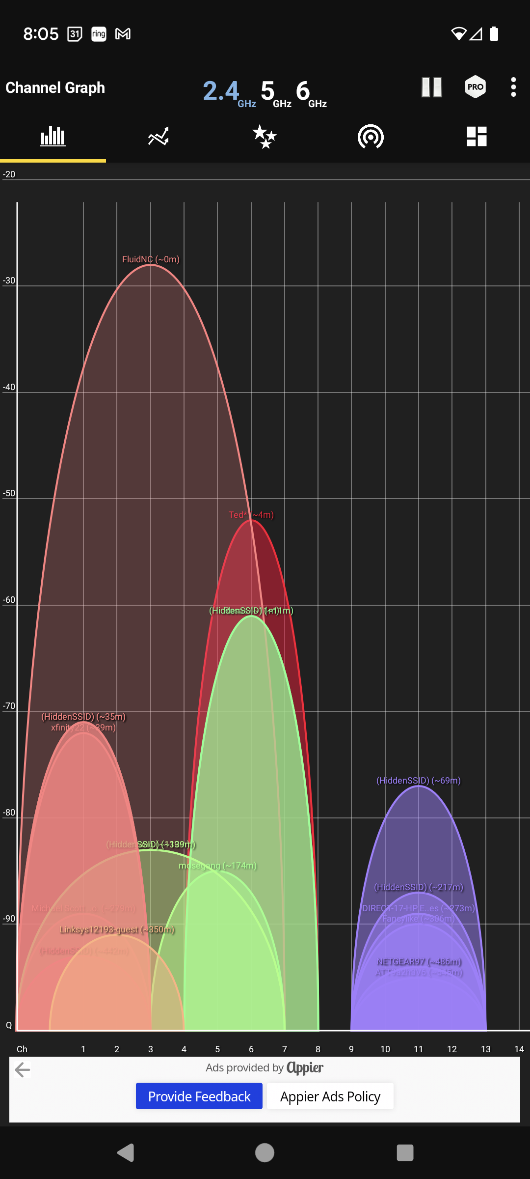

Dang I did not piece together the similarities. This is making me think there is one device interfering, and it has to be close. A wifi visualizer should help here right?
Okay and I just noticed something giving that a try. Fluid is using 40mhz width instead of 20mhz. That picks up more interference correct?
In these shots I think I might be slightly better off on Channel 11 as well.

RF is mostly a mystery to me. The more I learn, the more I need to know… But I think these are spread spectrum. So the wider range means they can bounce around to more places to find an open spot.
There are layers to wifi. The RF and frequencies are the very bottom. There are a lot of layers on top that could still be having an impact. Like maybe some AP is named “EspNoBoot” and it refuses to leave the bootloader until the serial port connects, and resets the connection (kicking free of the bootloader). I don’t expect this to be the case, just trying to find one possible explaination.
That is really interesting. I wonder if just using a regular serial program will do the same. I use miniterm.py, but connecting the arduino serial monitor or another basic serial program might connect, let you inspect the state, but not do something fluid is doing to unstick it.
Nope. The channel width is just that- how wide a swath of spectrum the channel is using. The tricks like MIMO where you use multiple antennas and the resulting multipath routing between nodes is a whole different beast. Spread spectrum is yet another entirely different thing.
In general, using wider bandwidth means you can sustain higher data rates- but you chew up more of the available spectrum and are more likely to see interference. In the US, there’s only three non-overlapping channels at 2.4 Ghz (1, 6, 11) .
When designing your Jackpot setup, use a WiFi analyzer to see your RF environment. If there’s a hole or at least less interference at channels 1,6, or 11 then use that. In my own home environment, I have an IOT network using channel 1, a guest wifi using channel 6, and my home office wifi on channel 11.
I don’t know if there’s some reason an ESP32 needs to use 40Mhz of bandwidth, but I think that’s a bad idea.
Edit to add: 40Mhz 2.4Ghz channels were added to the N specification, and lots of older equipment and even some newer equipment has problems dealing with this. Another reason I think using 40Mhz on the ESP32 is a bad idea.

A cell phone or wifi enabled computer can run free wifi analyzer apps, like I showed above that would really help here. I don’t think this is a MAC thing anymore I am leaning routers now.
I am kinda hoping changing to channel 11 on the esp will help this. If those mesh routers are slamming channel 1 the esp has no chance of shouting louder than them in AP mode. (That would also mean somehow the USB is boosting the signal or something)
