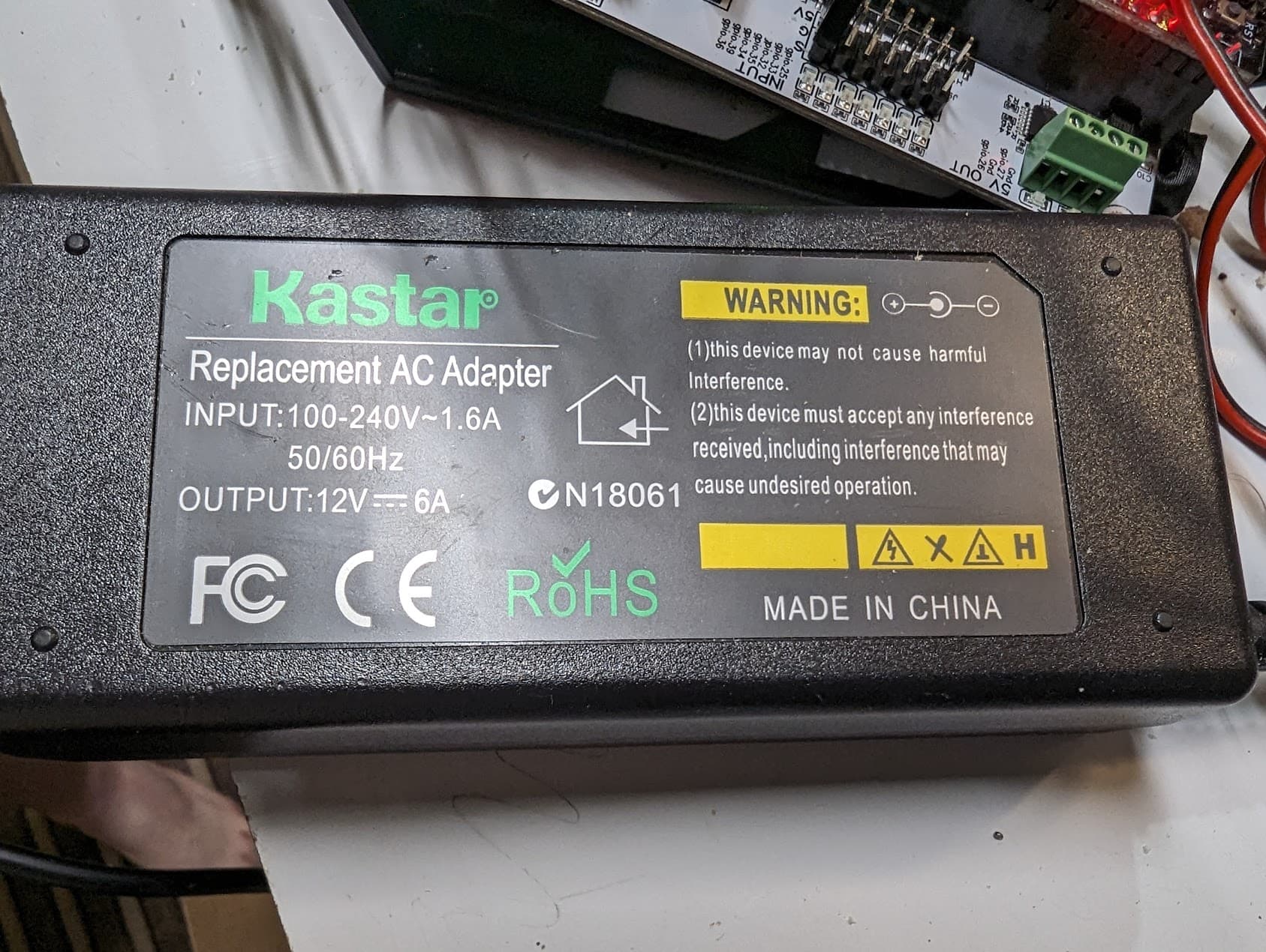

I have also been doing something dumb, which is searching randomly on Google. I have run across a few posts where the talk about “rise time” or other characteristics on the 3.3V rail. I’m not an electrical engineer, but I’ve started to think than my Meanwell power supply may take too long to get the 3.3V rail to full power, thus creating a boot issue. (But then again, I’ve got no personal knowledge on which to base this.)
Ok, so I’m not an electrical engineer either (although I did play one in college once), but maybe power is another variable to consider.
I have not had any issues, but I’m using the 24V power supply from Ryan to power my board. Perhaps something to check on for the people having issues vs the ones who are not is how the power is supplied.
I wonder if at that point it is actually rebooting again, so we just aren’t seeing a problem log. Or that it just didn’t fully boot up anyway until you plugged in if it’s a power issue
What model number?
We need to remember to ask about the other components. I assumed my power supply was being used.
I’m using the 12V laptop PSU that I bought from V1 with my 525 kit some years ago. Sticker says it makes 6A.
Is it possible to have the steppers not power on until the ESP’s done booting? Would it be meaningful to just connect a big 12V battery in place of the normal power supply?
LRS-350-24
I’m not sure about the battery, if maybe that would be more stable, but maybe a good test would be to try with a 24V power supply if you have one handy to see if that makes it better without changing anything else

Tried 2 power supplies. One is the 12V supplied with my MPCNC kit in 2022. I also had a 24V 2A power supply for my laser. Neither of those resulted in broadcast of the SSID. While on the 24V, I did use Fluidterm to get the SSID, then power down and power back up but still no SSID detectable until after Fluidterm.
I did hear the motors energize with the 24V, and it’s a pretty wimpy supply. Tomorrow I can take it apart further and try again.
I am far more convinced it is some sort of interference, change the channel in the config maybe? New SSID even?
