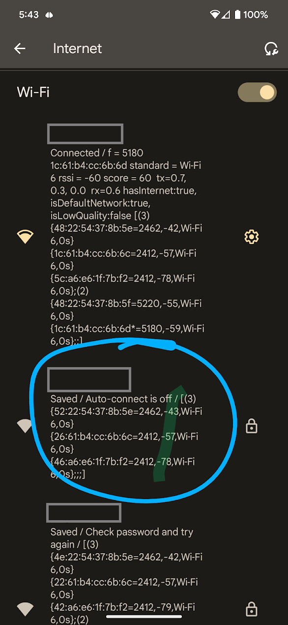

I just checked the signal out there and it hovers between RSSIs of 40 and 50, which is what you’d expect given that it’s about 20 feet from two different wireless access points:
Since almost no ESP32s support 5GHz wi-fi, I put it on a dedicated 2.4GHz-only SSID that I run for IoT devices, so the stations circled in blue are all visible to it. That said, STA->AP mode should have it fall back to running as an access point and that just never happens.

I checked it with my phone first, but when I run $wifi/listaps, it shows the signals as being at 64, 50, and 32. As a very simple test, I created a test SSID just now called WNC-STA and connected the ESP to that, then had my most distant WAP (the one that reads as 64 signal strength in the list) drop the WNC-STA SSID and the ESP reported over serial that it was just disconnected from wifi. More tests would be necessary to confirm, but I think it may connect to the first AP that it finds with a matching SSID rather than the one with the best signal.
I did this a couple of times and did get it to failover to AP mode from STA mode once, but only once it was down to a single SSID. Pure guesswork on my part, I think there may be a bug in the wifi logic where it ends up flagging a single WAP as bad, but if there are other WAPs on that SSID, it ends up in an odd state.
