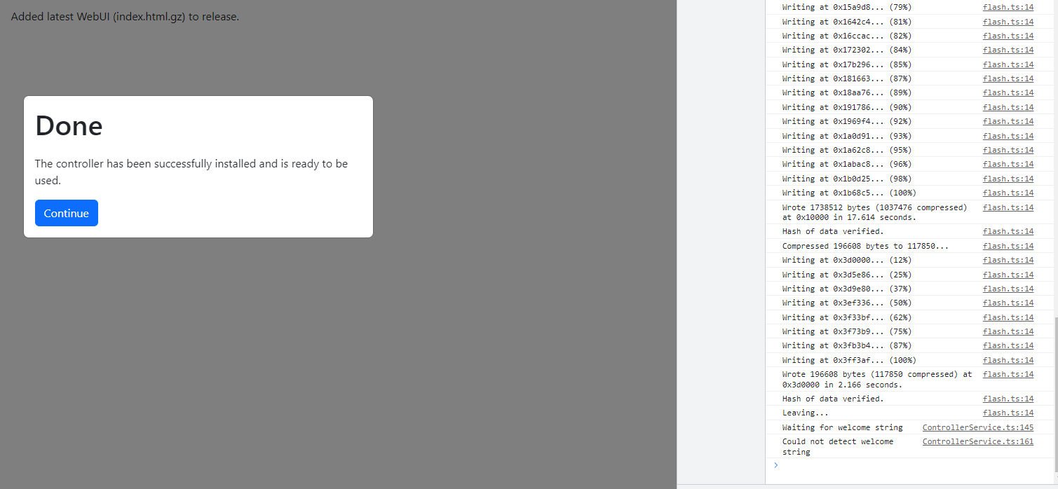

So here’s the last little bit of the installer once it completed.

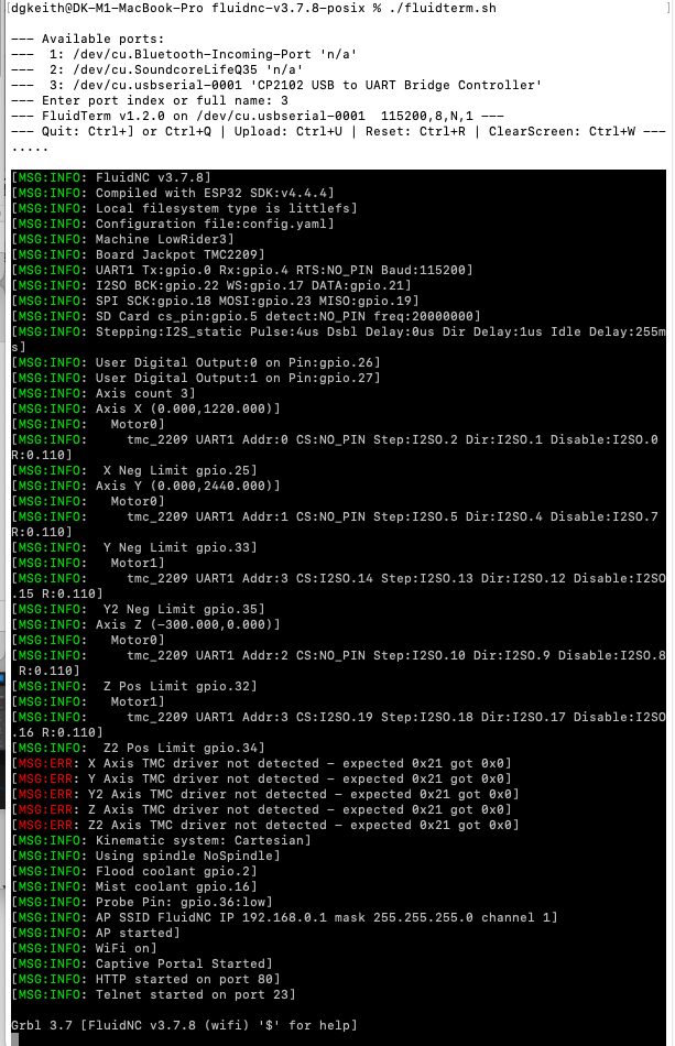

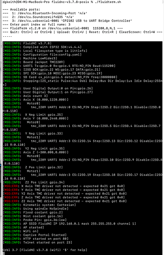

Here’s FluidTerm after completion, but before uploading the files.

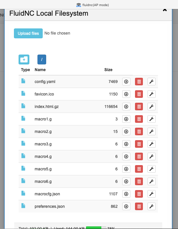

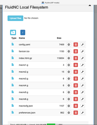

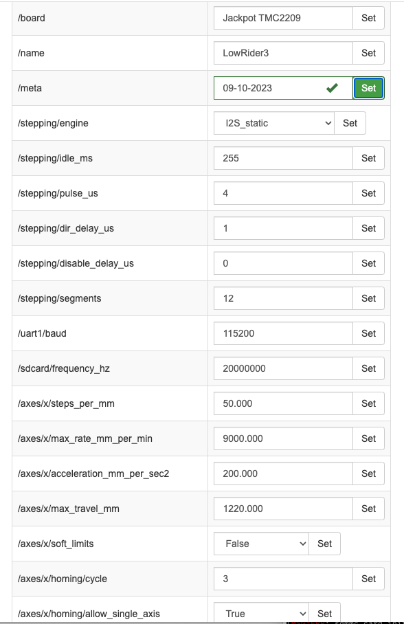

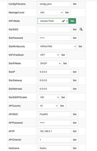

Here are shots from Chrome after the upload of the files.
I quit FluidTerm with Ctrl-] and it’s currently still broadcasting FluidNC SSID. So I can connect at will.

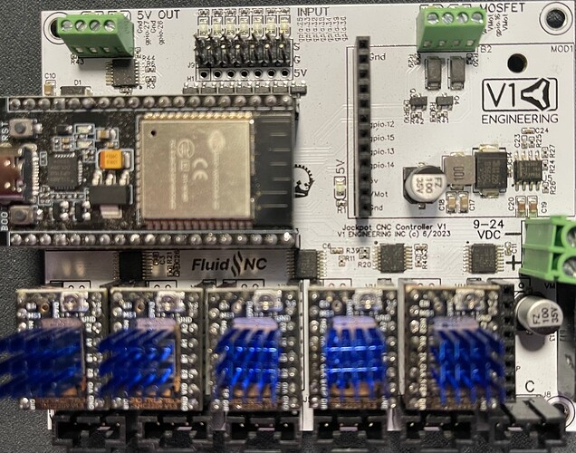

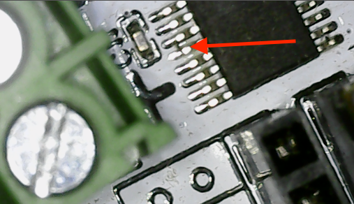

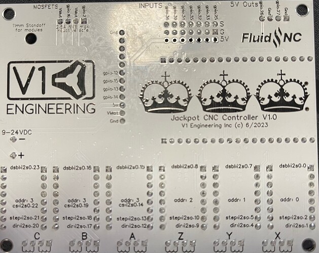

Before I do that can you take a close look at the bottom to see if there are any solder bridges. I had some on the very first batch and have not seen a single one since. Or take a really clear close picture of the top and bottom and I can look on my end. A solder bridge would be a quick and easy fix.
I tried looking, but I don’t see anything. The only thing that caught my eye was:
Screenshot 2023-09-25 at 7.00.21 PM
The visible screw terminal is the primary power terminal.
Here’s the front and back of the board, but I know this isn’t exactly “High Resolution.”

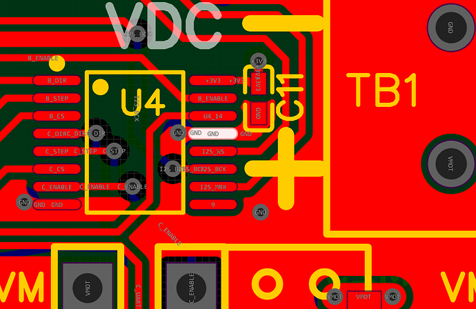

Well that could do it. That is a ground and a signal pin.
Okay I am just about done for the night. If you are confident with a soldering iron you can give it a shot to wipe it out, if anything goes wrong I will swap you still. If you are not a solder ninja, I can send a swap tomorrow.
Let me know what you choose.
Not a solder ninja. Swap is probably better. Thanks!

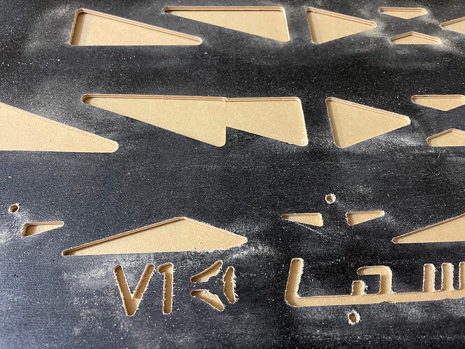

At this point I can live with it. I love FluidNC, and I had it cutting for about 5 hours on Friday, 6 hours on Saturday, and another 8 on Sunday (cutting struts, parts for a table, various learning and experimentation.) The board performed very well. The only hiccup on cutting the struts occurred when it appeared to cut one hole, then move about 40mm Y+ and cut it again (both all the way through.)** All cuts after that point were +Y40. I had to kill the job and re-run it. I added DOC to 4mm and was knocking stuff out!. Otherwise, the board was awesome.
** Image of the “glitch” - double cut and 40 mm offset
