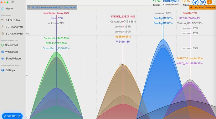

I powered on, and the esp32 lights illuminated.
I waited 60s to see if I could see the SSID.
The bluish peaks at channel 9 are my wifi mesh. No USB is connected.

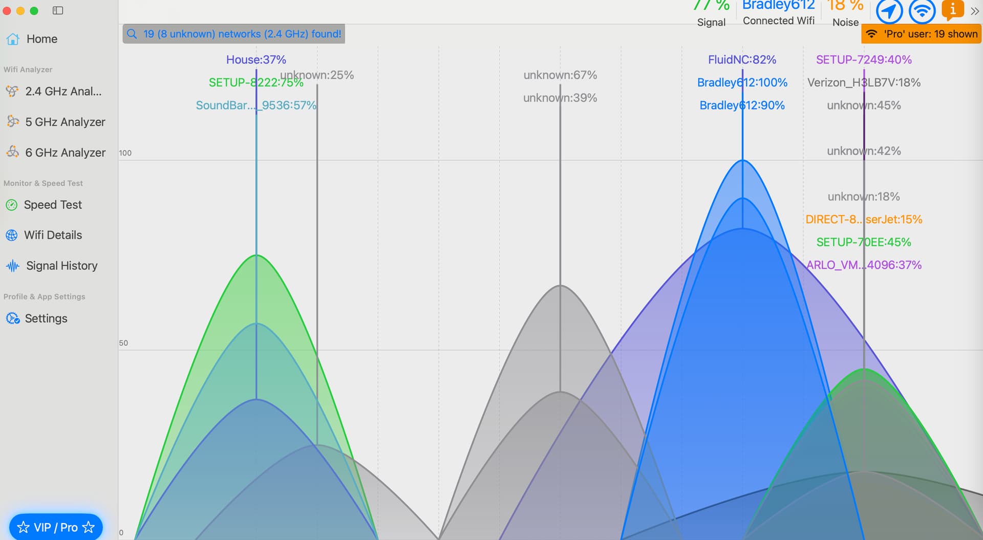

I connected the USB, and waited to see if it would appear just based on the USB connection. I could not see the SSID.

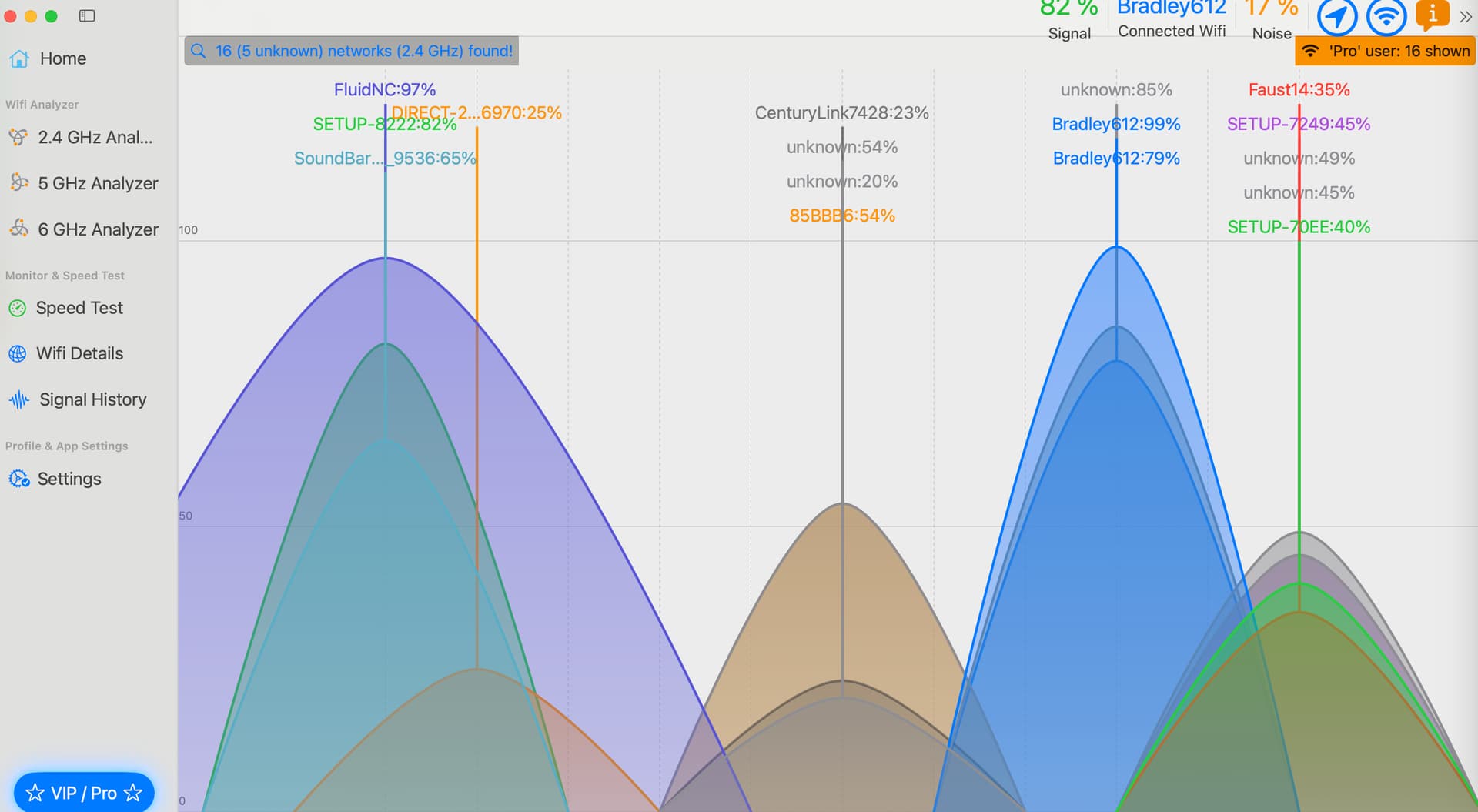

Then I ran fluidterm.sh:
I did switch the esp32 to channel 9 since I know the interference at that channel is my network, and eventually I’d like to connect it in STA mode.

  • I plugged in my Macbook pro. Did NOT run fluidterm.sh. Pressed RST. Within 20s, the SSID is visible and stable.
It does work with USB connect, but does not work without.
