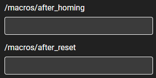

Is there any way in FluidNC to tell if the machine has been homed yet? Showing the X position on the LEDs doesn’t really make sense until the machine is homed.
I thought about maybe using these macros to initialize and set a variable but I’d rather not. I assume that after_homing gets called after any axis is home and I only care about X.
Maybe I just assume you’re going to home the machine. During homing, it could show a wave in the X homing position. I would have to determine which direction is currently homing. I think I can only figure that out by change in X position.

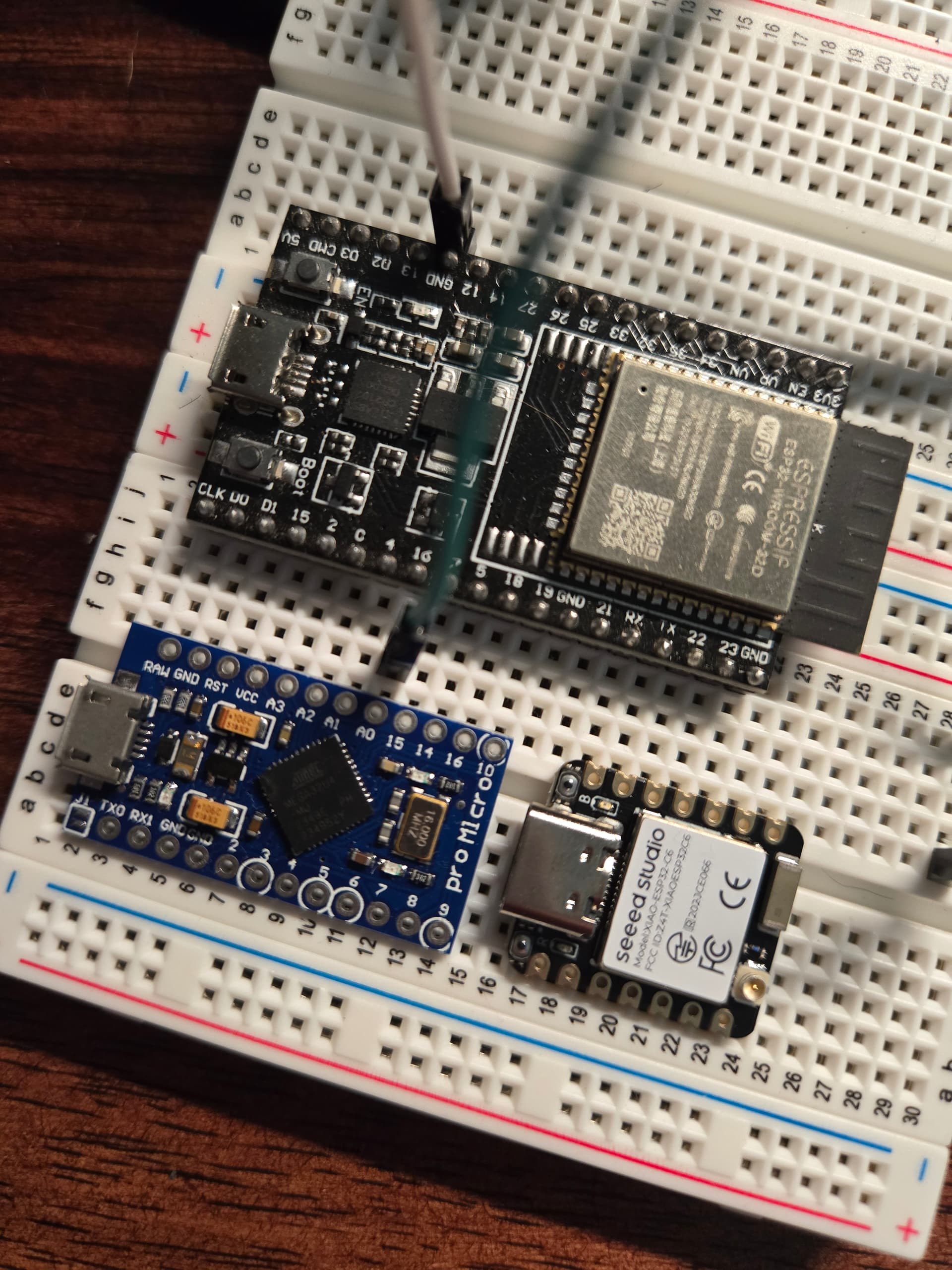

Also, I got one of these Seeed Studio XIAO ESP32s to try out since I only need 1 pin for this project. I knew these were small but geez. This version (ESP32-C6) has a built-in wifi antenna too.

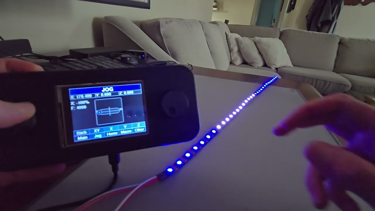

Here’s the current status.
Looks cool. You went above and beyond.
Love it.
That looks awesome. All wireless - no wires between the ESP32s?
Super cool.
Yep. Connects to FluidNC via telnet so it doesn’t interfere with the WebUI.
