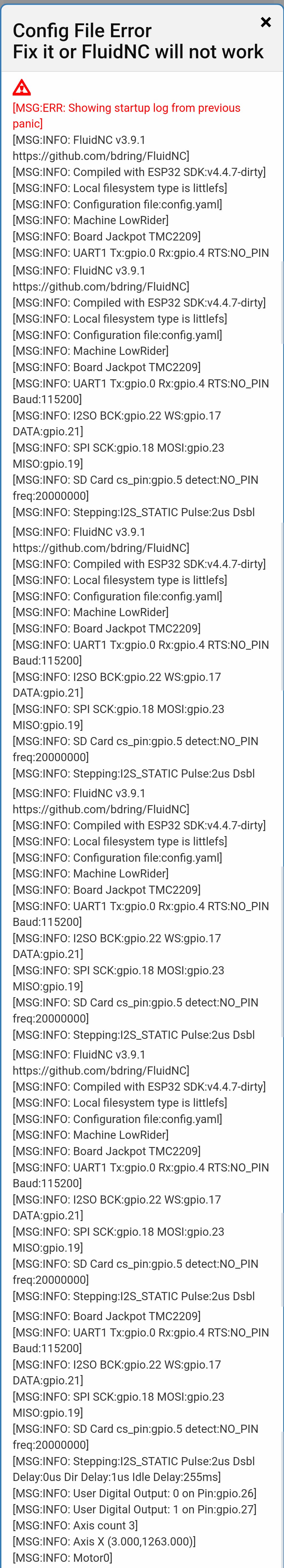

Hi there, I just finished my build. Was homing my axis and making sure everything worked great. When I got the attached error. Now I can’t get anything to work. Anyone able to give me any direction?
Unfortunately, that long screenshot doesn’t show all of the log, so it’s not of any help.
If you haven’t rebooted, go into the terminal and type $SS, then cut/paste that here using the </> formatting tag from the ribbon in the edior.
If you have rebooted, that’s OK, but we will still need to get that error log in text rather than graphical form.
Everything from a $ss
ss

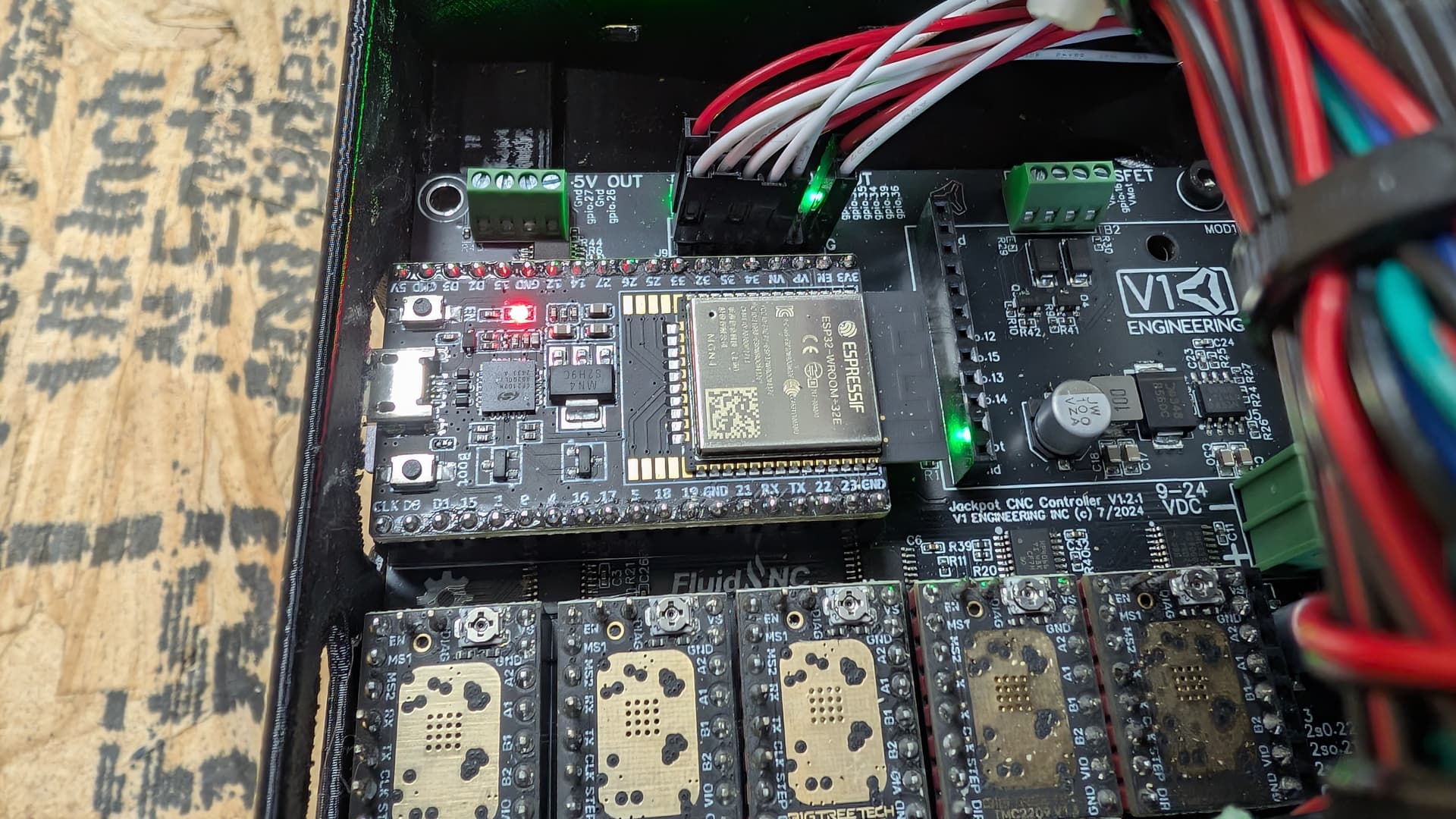

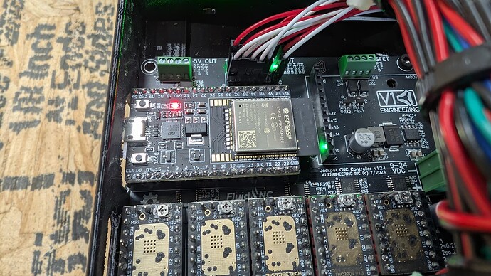

Can we see a picture of your board wired up pleae.

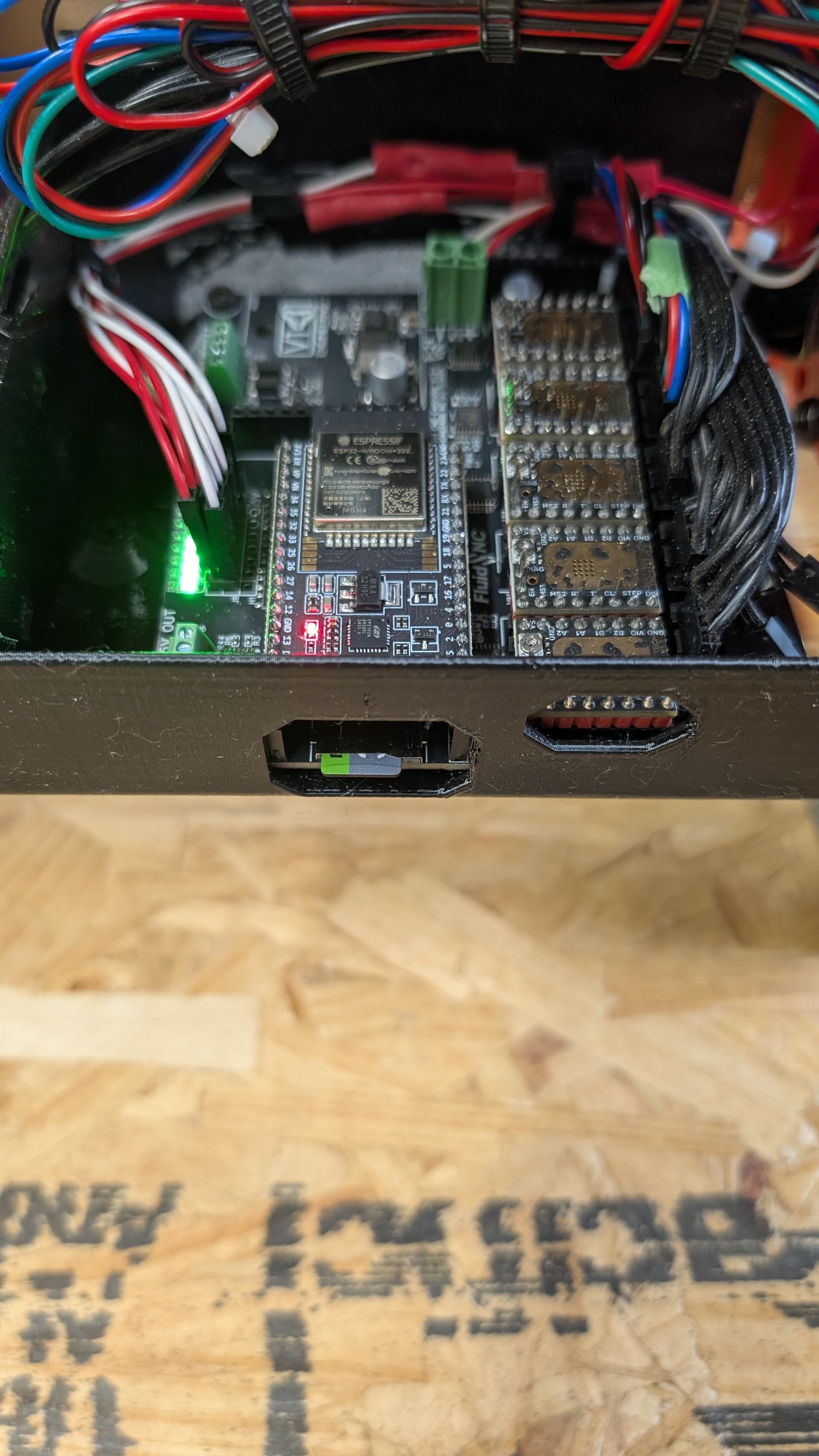

Also attaching the photos requested
because I’m new apparently I can only put 1 picture per post.
I would start with uploading a new config file. Maybe you changed a setting without realizing.

I apologize for taking up your time. When I went to plug in so I could flash, I noticed I had put a micro sd card it for files. on a whim I popped it out, and the error immediately cleared up. Apparently I need to reformat this card or get a new one. Thanks for all of your help.
