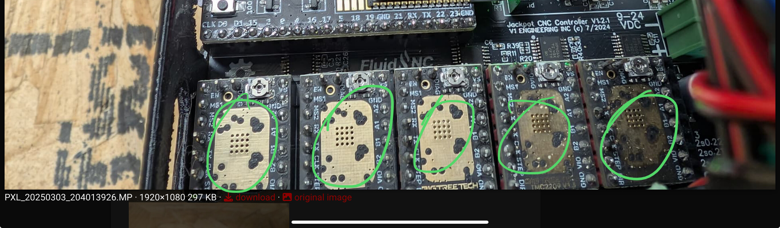

Just because they’re not in the picture you uploaded - the stepper drivers need to have heat sinks placed on them or they will overheat in use.

Thank you for this comment. I had indeed overlooked this need. I’ve looked through everything and don;t seem to have heatsinks. Guess it’s another 2 days while I wait on amazon.
