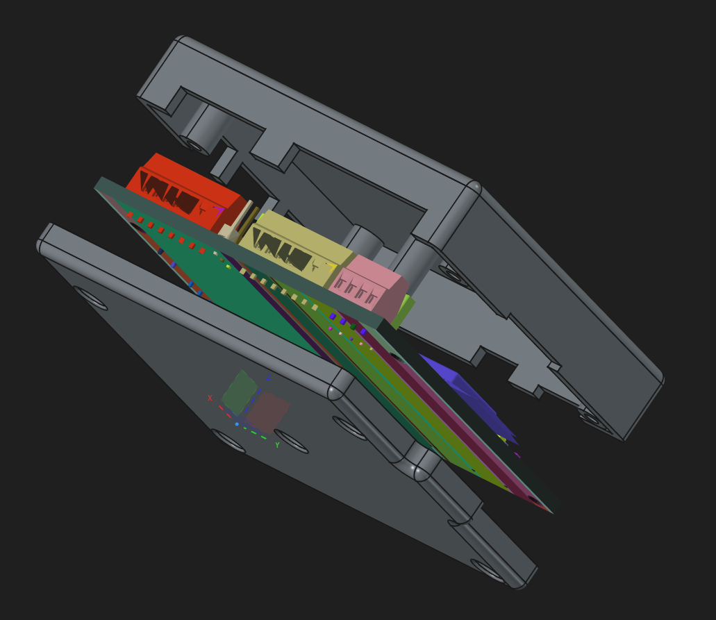

Well, tonight I got caught up in making a standalone case for the pen/laser board after cementing a new mailbox post in the ground after the neighbor’s delivery truck took it out. Still working on it but I’ve been having a lot of fun in FreeCAD lately.

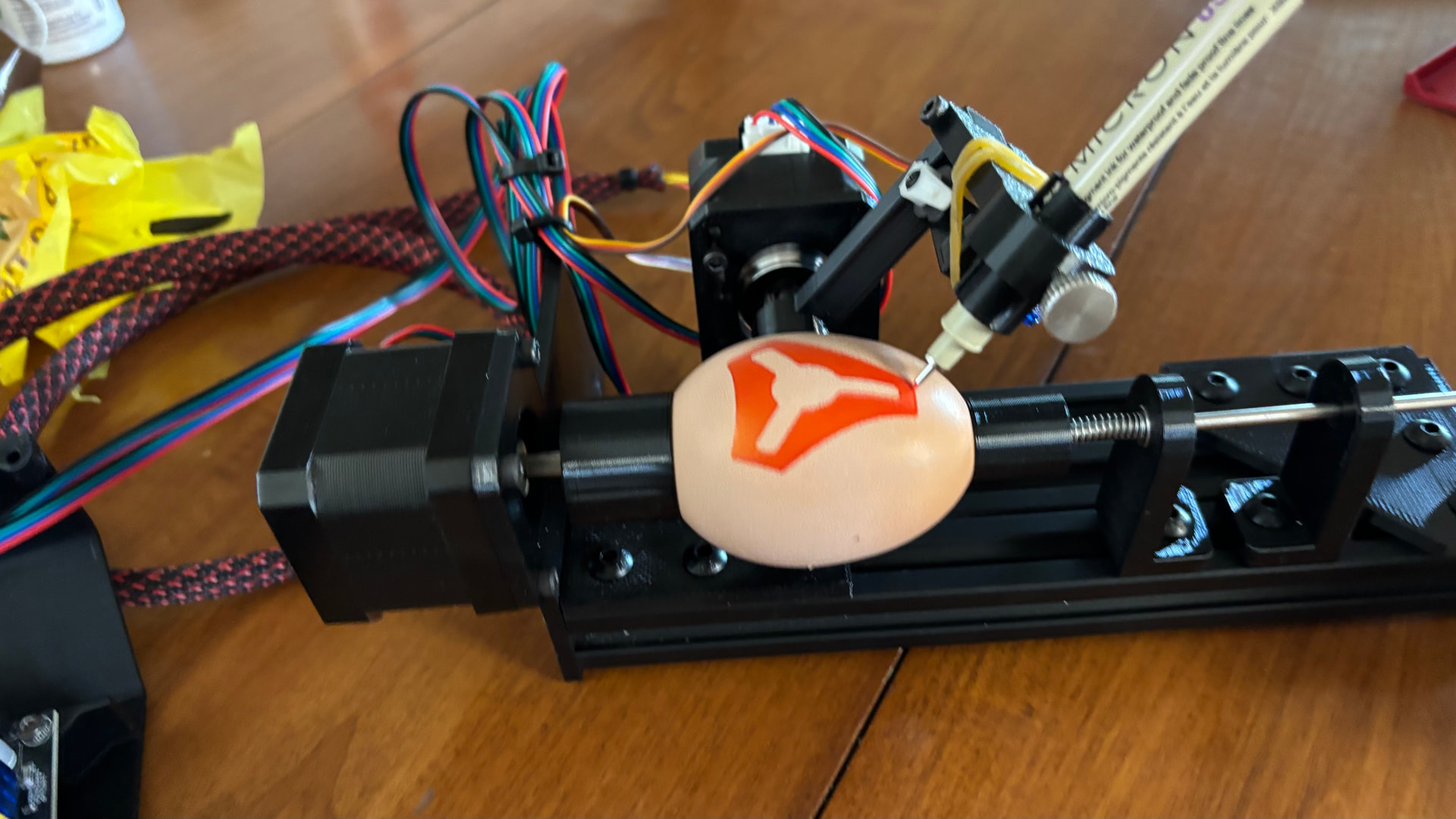

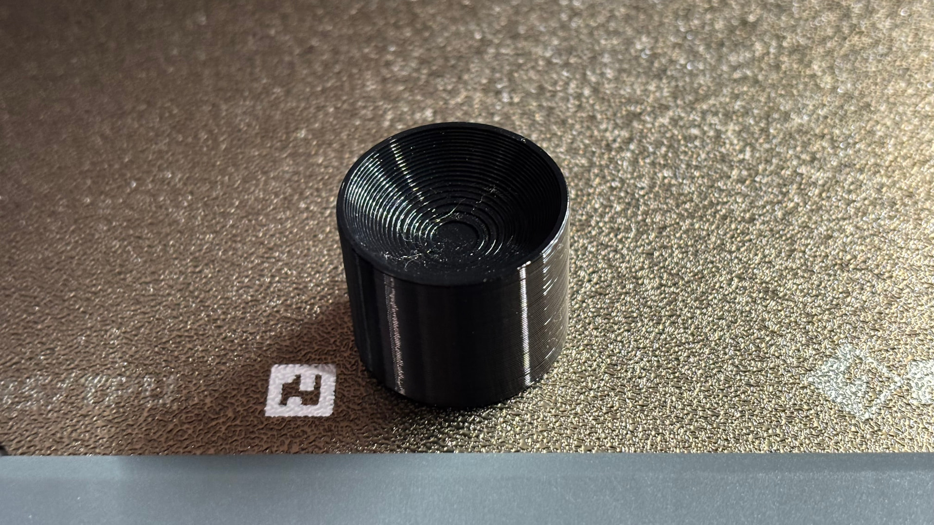

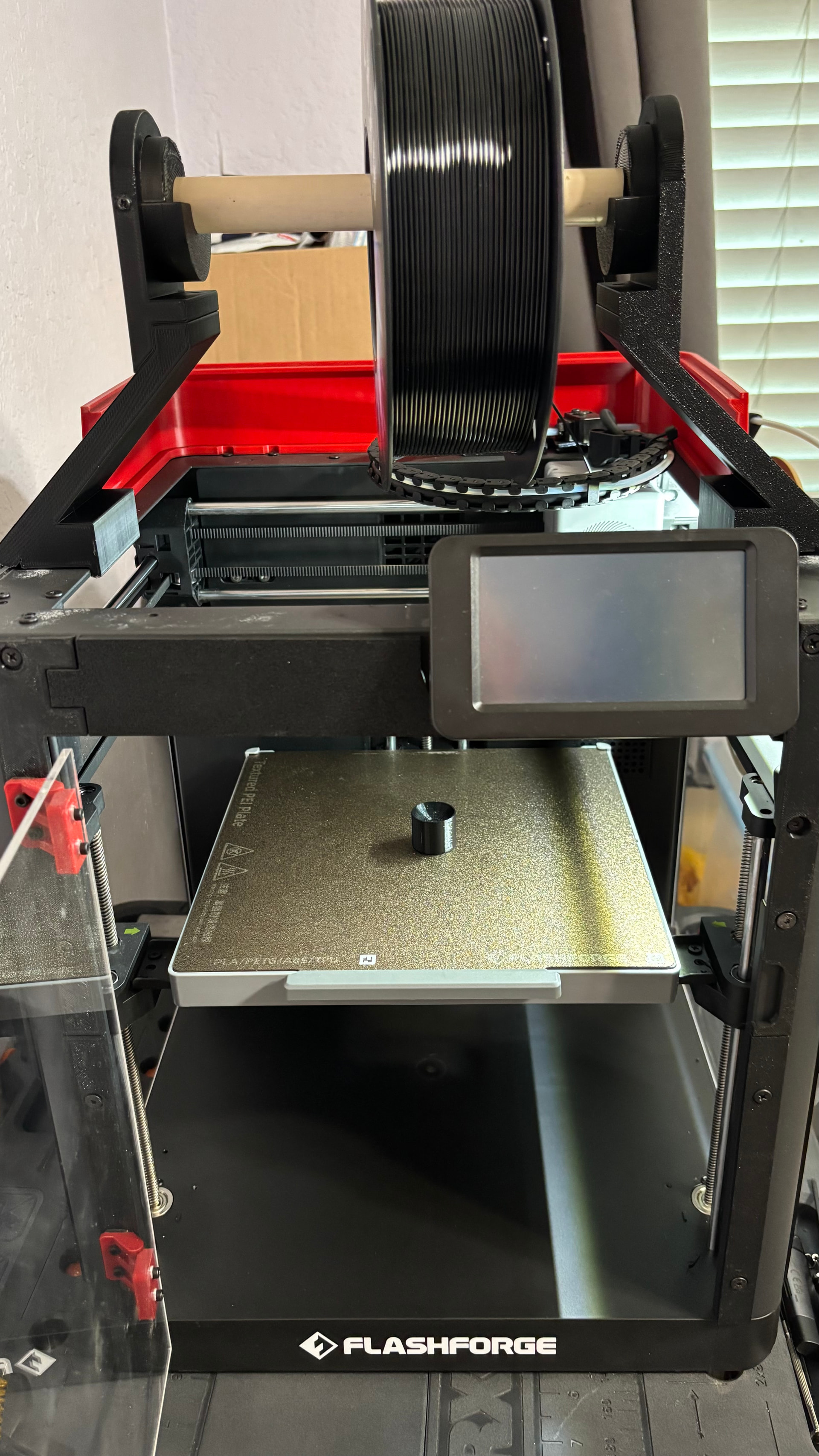

I did my first TPU print today. I had to print out a spool support first, which took some modifications to get it to go on my FlashForge AD5M. It turned out well though.
The TPU eggholder turned out really well. I used the modifier to increase the infill to 55% at the bottom where it slides onto the stepper motor shaft. I set the cupped part to 15%. I also printed out the smaller righthand eggholder in TPU.
I installed the TPU eggholders and tried them out. They grip the egg much better than the PLA does. First print came out really well.
Thank you again @jeyeager! You inspired me to build an eggbot and to try printing with TPU.
Sure did! Great result.

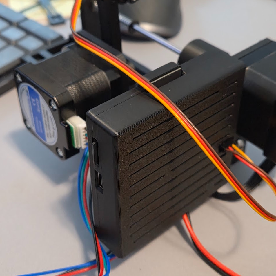

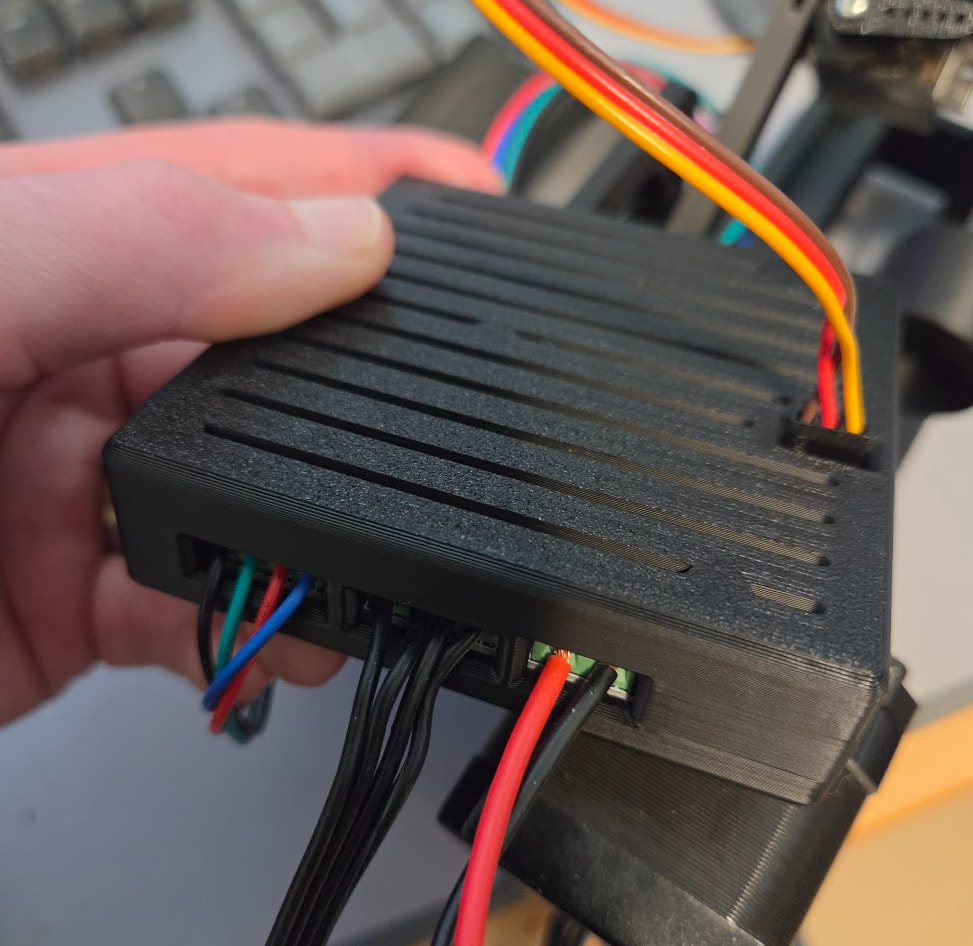

I finished this case. I’m really happy with how it came out.
I’ll probably upload this to Makerworld and maybe Printables. I haven’t done that before.
PenLaserBoardCase.zip (3.5 MB)
There’s a top and bottom piece. You screw it together with M3 screws (preferably button head, socket head will stick out a bit). I used 10mm but probably from about 8 to 16 would work. I drilled out an existing hole in the eggbot end plate to 3.5mm and attached it with a single 16mm screw there. Note that you’ll want to poke out the holes in the bottom plate before putting the screw in. I put a single layer so it would print properly without supports.

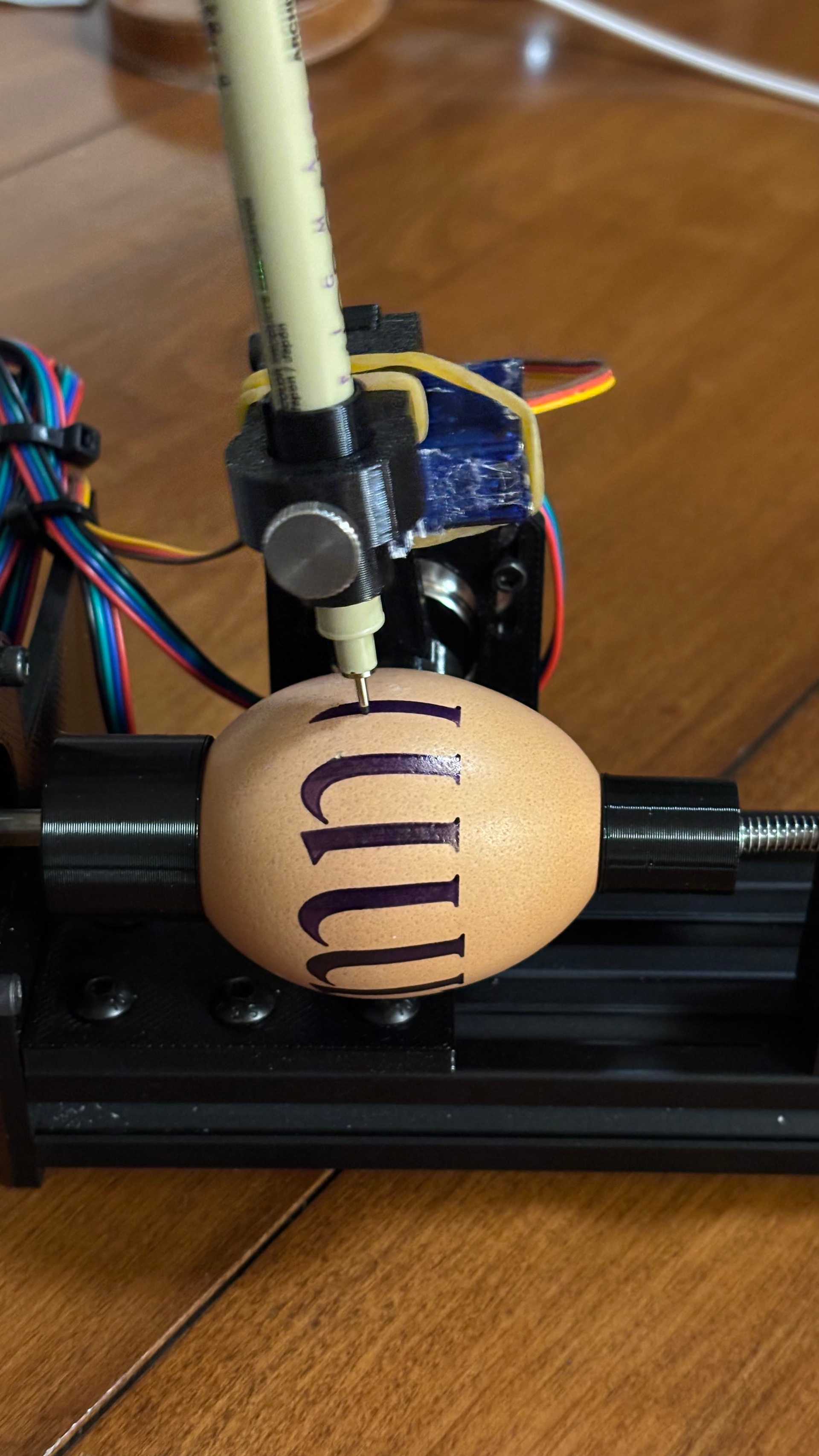

I haven’t tried the crown yet, but I did the V1 Logo today.

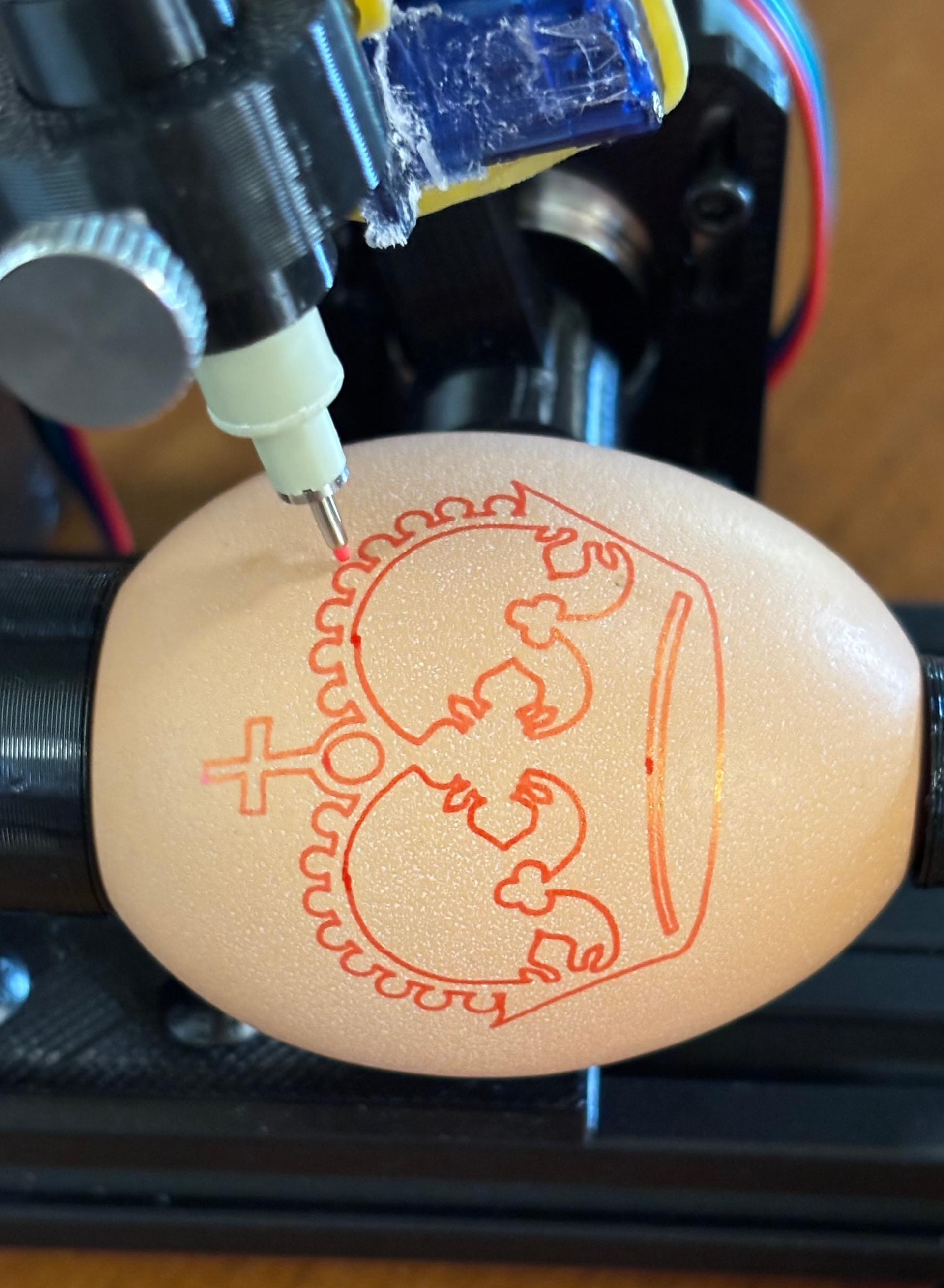

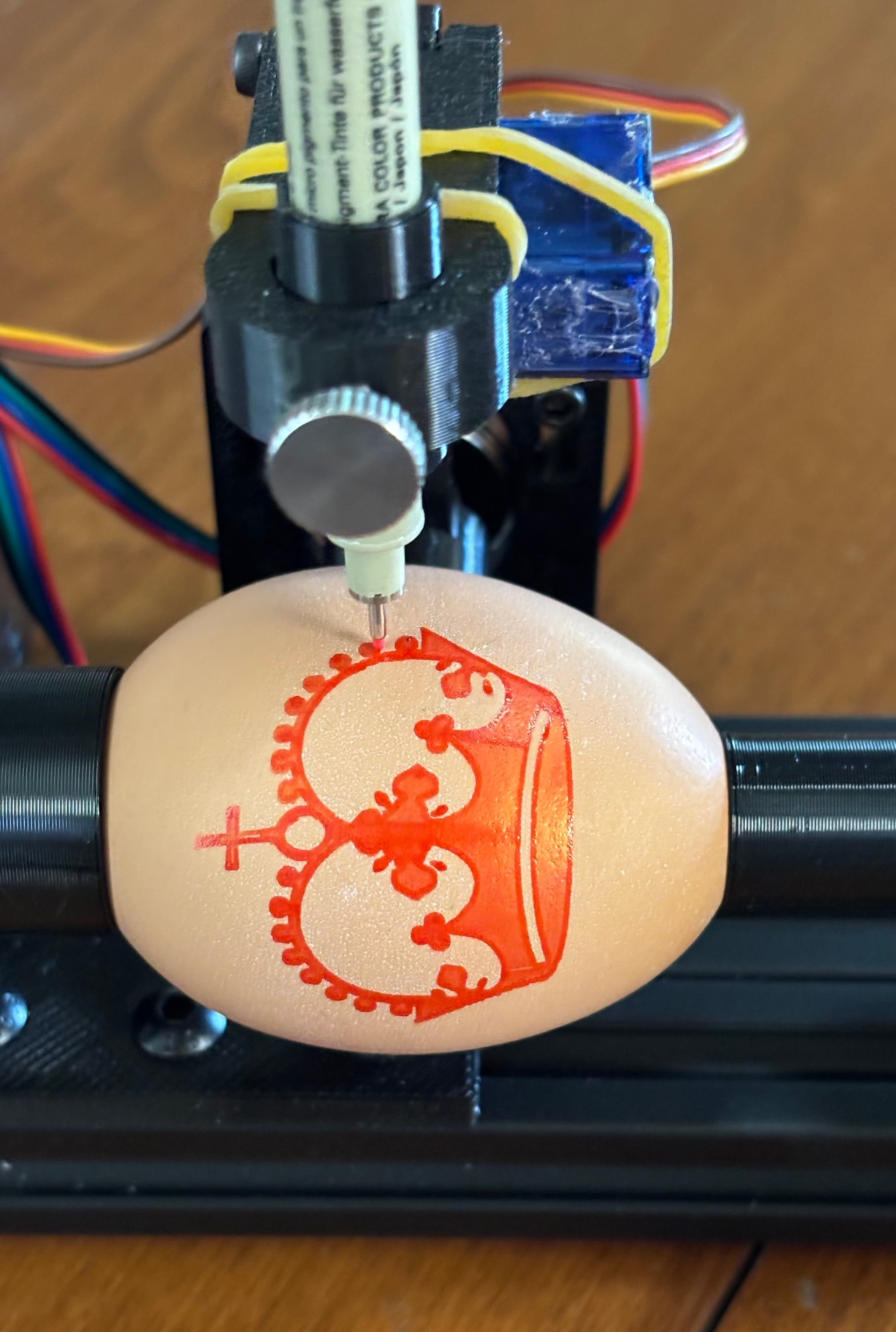

Today I did the V1 Crown. It turned out pretty good I think. I did a Pocket (filled) version and a Profile (line) version in MillMage.
