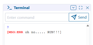

Any way to get the color back into the terminal output, in V3? Kinda makes it easier to read. Not a deal breaker by any means.

Nice. I looked at it briefly. I was looking at just coloring the whole line.
I think you removed the colon after INFO/ERR.
nah, just playing and hand typing stuff… I didn’t have any real examples to play with
I was going to also, but I looked at the WebUI2 code and this looked like the way it was done before

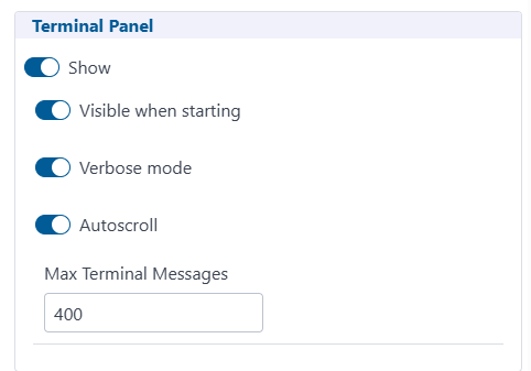

Also maybe a setting so you only keep the last x messages in the terminal and roll them off the top, so it doesn’t just eat RAM for an entire job…

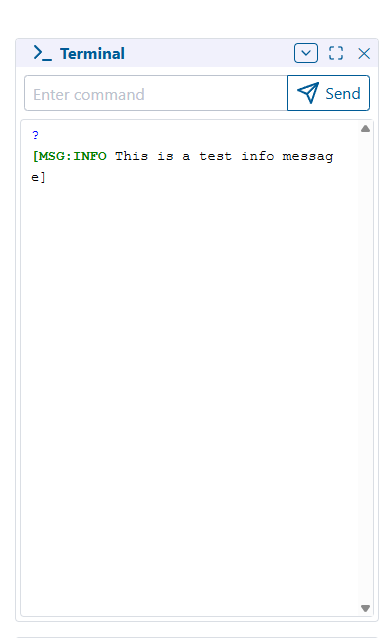

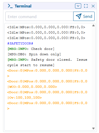

  • restored color scheme in Terminal from WebUI 2
  • implemented cached rendering so it doesn’t re-render the entire message stack on every update
  • added Max Terminal Messages setting for control. default is 400
If someone wants to give it a test, you can pick up the build artifact here: index.html.gz.zip (see next message)
You’ll need to unzip the .zip to get access to the .gz file to put on the ESP32
I only have the ability to run it in the simulator right now, but if a few people can put it through its paces, I’ll make it official
I have only a disconnected ESP32 to test with right now, but seems ok
Sorry, I made some changes to the formatting, so there is a new version here: index.html.gz.zip
