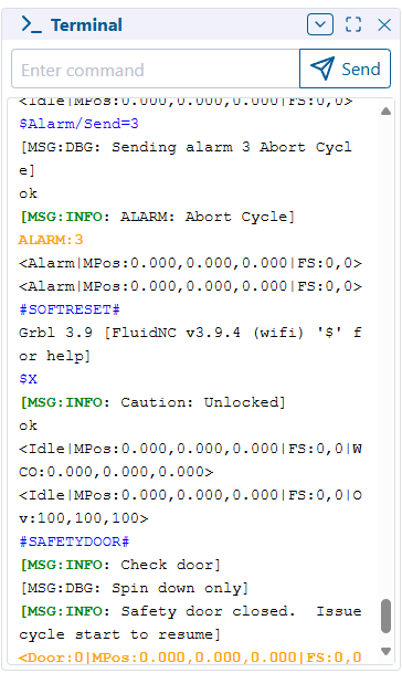

Not sure what all is supposed to have a color but the colors that are there seem to work ok.
The colors I think are fine. I’m mostly wanting to make sure the auto scrolling still works as expected, and that is doesn’t slow to a crawl when it fills up, making sure the setting works correctly, etc.
I have mine set to max 10,000 messages right now and I’m waiting for it to fill up so I can see how it goes
Essentially, the colors are as follows.
[MSG:INFO → Green
[MSG:WARN → Orange
[MSG:ERR → Red

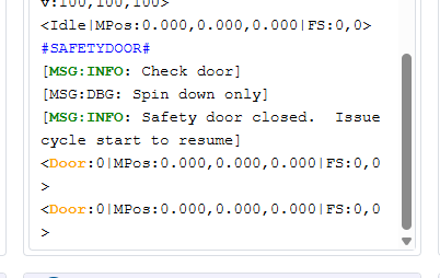

If it starts with Alarm:, Hold: or Door:, it gets an orange highlight
I didn’t notice a difference. I did test the max messages setting it to 10 and worked fine.
Some of it is subtle, like not including the opening ‘[’ in the highlight.
I also made it not highlight the entire line, so “Door” should be the only thing highlighted
I’ll need to make another update. They aren’t consistent with their colons…
but it’s fine as it is just for performance and function testing

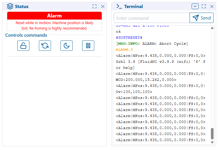

I set it to 10,000 and put $SS in a gcode file 1000 times. Once it hits the limit, it slows down a lot. Might need to do something like when it hits the limit, trim it to 75% so it’s not trimming for every new command.
terminal-test.gcode (4.9 KB)
ok, maybe this was the real slow down that was previously complained about for long running jobs…
I’ll go have a look
Ok… this should be better
index.html.gz.zip
I changed it to a more efficient method to trim the array, as well as batching it and cutting it down only after growing 20% larger than the setting.
so at default, it will hover between 400-480 messages max
Freaking sweet! Color and a stability gain, maybe even a smidgen of performance. Awesome thank you (he types with a fake blood stained face neck and hands).
Yep, that’s better. You can see it slow down a little at 10,000 messages but not too bad. At 1,000 messages, I didn’t really notice a slow down.

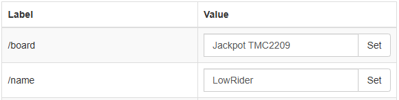

The only other WebUI thing I would like to figure out is the page title. It always shows as “undefined”. For a split second, it shows “ESP3D(Connecting)”. WebUI v2 shows “fluidnc” which I believe is coming from the Hostname (I can access it via fluidnc.local):
If I had a choice, I personally think the name in the config.yaml is what I’d prefer to show.
How freaking cool! What a find.
Seems reasonable and easily editable for the user.
Oh. I know the fix for the undefined thing.
I forgot about it. It’s just a typo somewhere

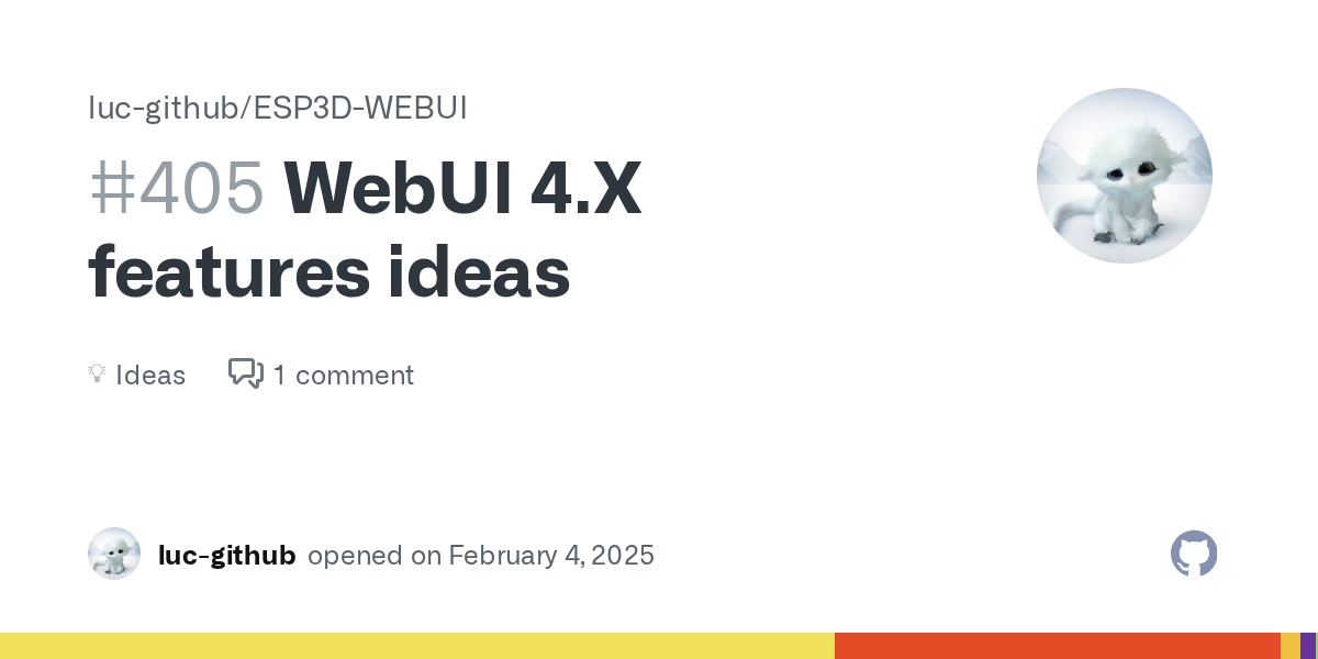

Since Luc seems to consider V3 “done” and is looking to V4 now, I think I’m ok deviating more from his code and just going our own way to make it better to use
Whoa, there is a V4??
Are you kidding me. I just came here to say I just updated the recommended files to 3.9.9 and webuiV3…
Not yet…
He just seems to be planning it
and there hasn’t been any useful activity on 3 for a while… so I assume he’s not making any more major changes
