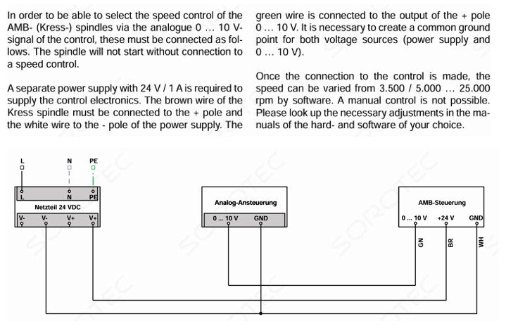

Thanks for the reply! I don’t use a separate VFD — my spindle is an AMB 1050 FME-P DI, which has a built-in speed controller. According to the official documentation (see attached image), this model is specifically designed to be controlled via a 0–10 V analog signal.
The + and – terminals of the 24 V power supply of the spindel speed controll are connected to the V1 Engineering board, so the control logic and the spindle controller share a common power and ground reference

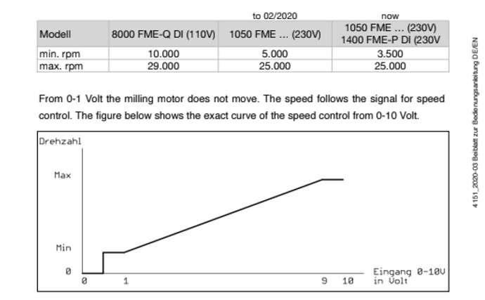

Looking at the examples, I’m guessing the speed map needs to be adjusted. You’ll notice the example speed map goes from 0 to 24000 and 6000 is still mapped to 0.
Thanks a lot for the hint — that makes sense!
I’ll try adjusting the speed map accordingly. I won’t be able to test it until tomorrow, but as soon as I get to the machine, I’ll give it a go and report back.
Really appreciate the support!
Based on this PDF I found, I think you want:
speed_map: 0=0.000% 3500=10.000% 25000=90.000% 25000=100.000%
Or something like that. I don’t have a spindle so I’m not sure.

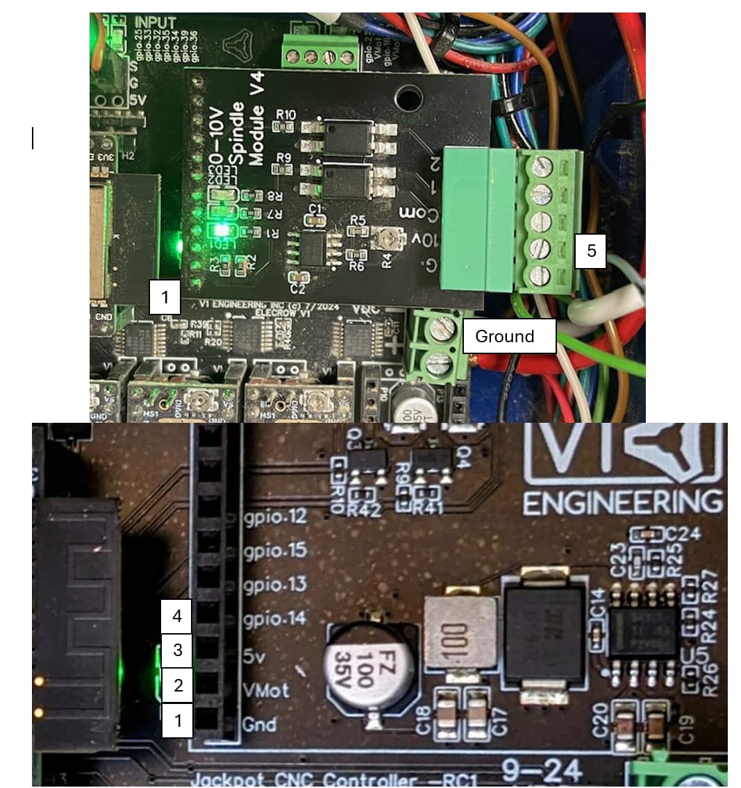

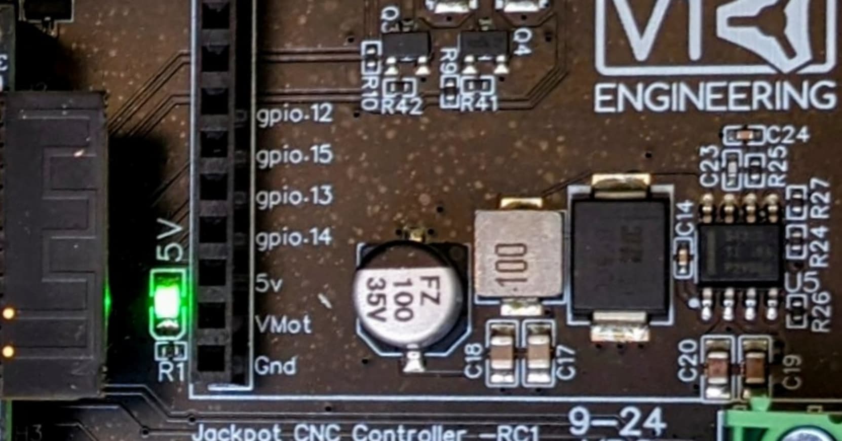

Thanks for the detailed instructions — I followed them today.
I connected the ground lead of my multimeter to the common GND point, where all grounds (V1 board, spindle controller, and 0–10 V module) are tied together. Then I measured the following voltages:
  • AMB +24V to GND: 24 V
  • AMB 0–10 V (number 5 in pic) to GND: 7.5 V
  • gpio.14 (number 4 in pic) to GND: 3 V
  • Jackpot VMOT (number 2 in pic) to GND: 24 V
  • Jackpot 5V (number 3 in pic) to GND: 5V
The strange part: these voltages did not change at all when I sent G-code commands in FluidNC to vary the spindle speed (e.g., M3 S10000, M3 S25000, M3 S0). I also noticed that I cannot turn off the spindle using M5 or M3 S0, so it just keeps running at a constant speed.
Could this indicate that PWM isn’t being sent correctly from the FluidNC output pin? Or that the 0–10 V converter isn’t reacting to it?

That’s not the reference point we need for your measurments, it very specifically needs to be the AMB GND pin, the DMM (-) lead for this set of tests must physically be plugged into the AMB, not anywhere in the Jackpot.
The reason for this is to rule out various possible problems. Your AMB GND wire should be tied to the analog common of the 0-10V module, not VMOT (-).
That’s the pin below the “5” in your picture. Yes, in theory that pin should end up tied back to VMOT return through your module, but since your system isn’t working this is one of the data points we need. I’d move the return wire for the AMB to the module before repeating any tests.
We need to establish what your spindle “Sees” from the system, so the measurements need to be made with the DMM (-) connected to the spindle GND (At the AMB)

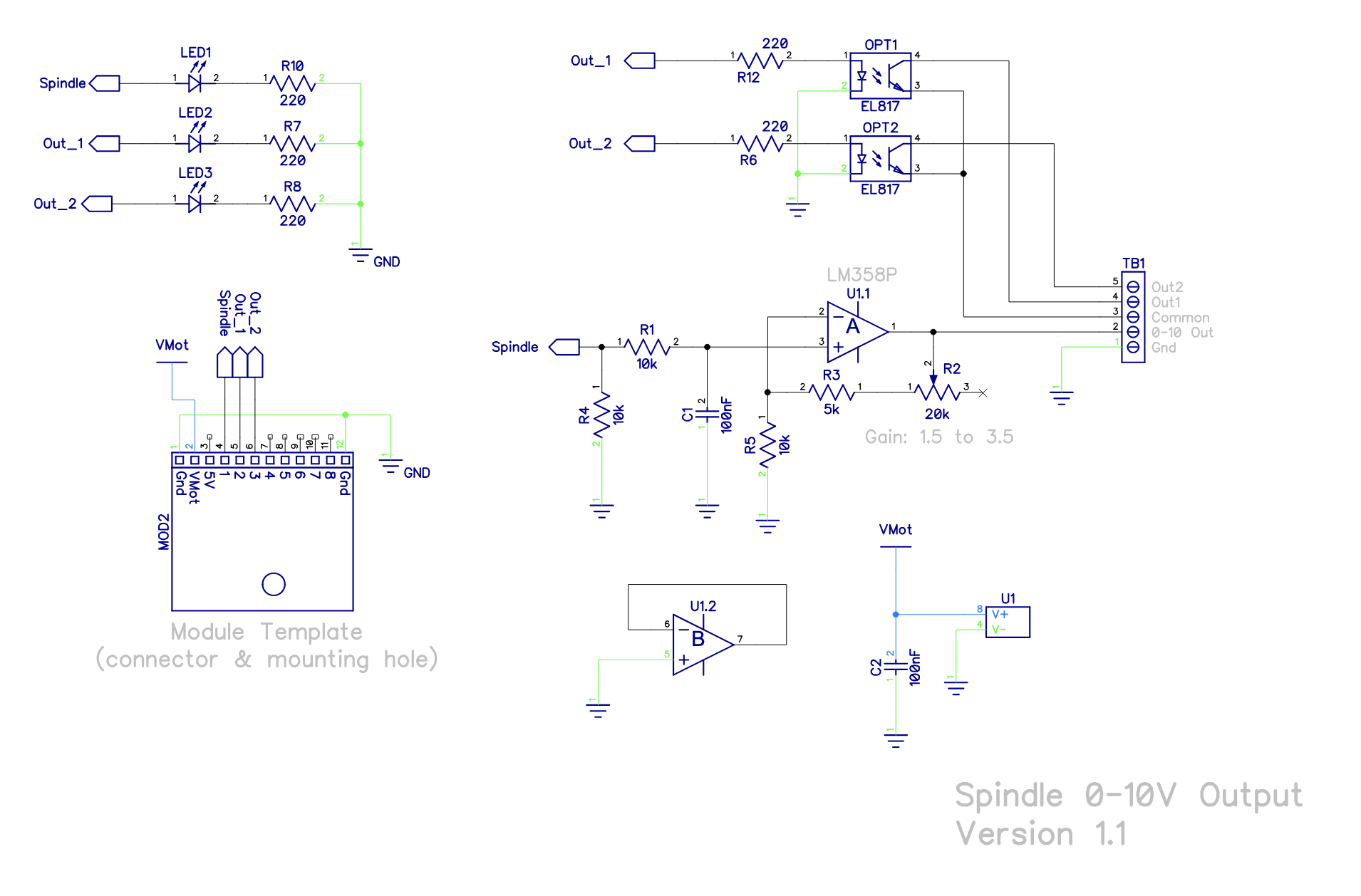

There’s a pot on the analog board which adjusts gain from U1, and this may need adjustment if we get your system to respond to commanding- but don’t touch the pot until we solve the voltage being fixed at 7.5V.
If you connect your DMM return to the AMB GND and still measure 7.5V at the 0-10V output terminal of the module, then we also want to check the GPIO 14 voltage on the jackpot. If GPIO 14 isn’t changing as you command different speeds in FluidNC, then the spindle board can’t work.
Your spindle won’t use the digital common, out1 or out2 (which you correctly did not wire to)

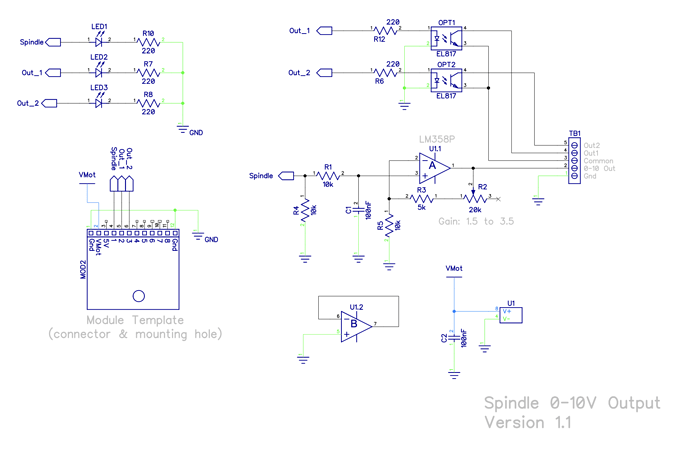

For reference, the schematic for the module and the pinout for the green connector is shown below:
CNC I/O Module VFD Description
Grn ACM Analog Common
0-10V VI signal voltage input
Com DCM Digital common
Out1 FOR Forward Direction Signal
Out2 REV Reverse Direction Signal (Optional)

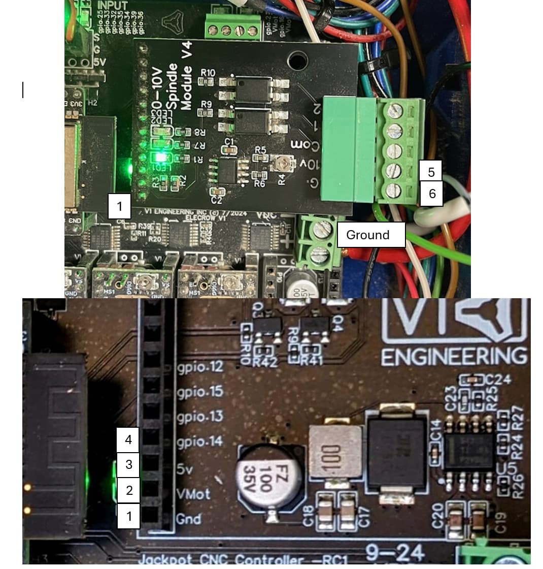

I re-ran the measurements today with the spindels GND conected to the 0-10V spindle modul (see image number 6), as you instructed. I also moved the AMB GND return wire to the analog common (ACM) terminal of the 0–10 V module.
Here are the new measurements (see img. number):
1: 0V
2: 24V
3: 5V
4: 3V
5: 7,5V
The big issue: None of the voltages change when I send different G-code commands like M3 S10000, M3 S25000, or M5. The analog output stays stuck at 7.5 V, and the GPIO input on the module (connected to gpio.14) doesn’t change either.
At this point, I’m starting to suspect that gpio.14 isn’t producing PWM correctly. Do you think it makes sense to test the GPIO pin directly with a scope or LED?
