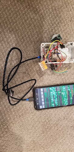

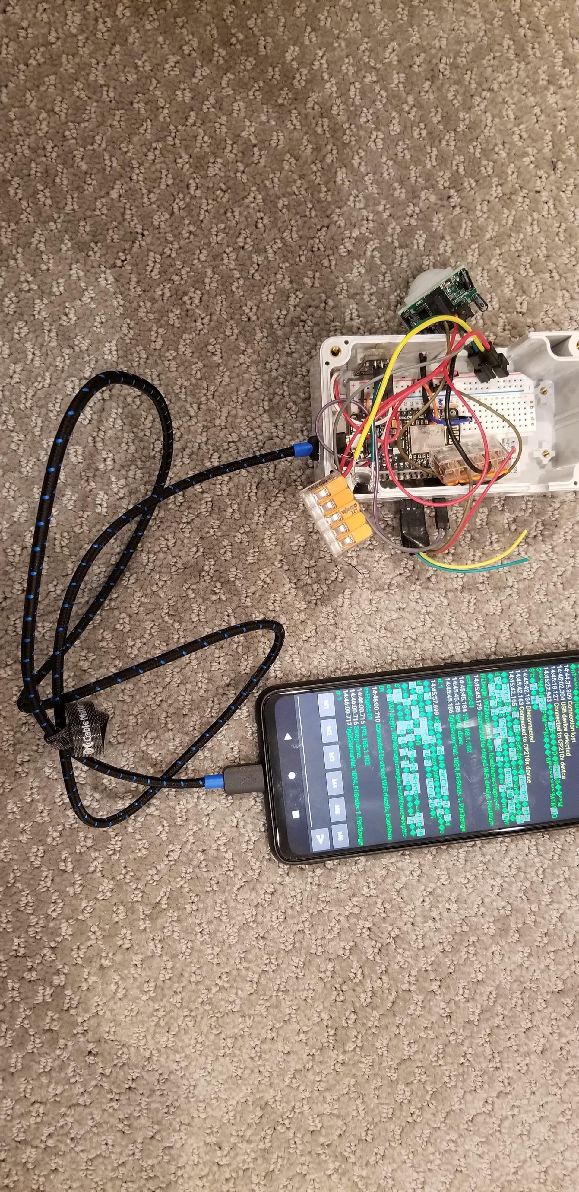

Bought USB C to micro USB cable, able to connect and power ESP8266 and comm from Android phone (an old backup phone) via some rando Serial Com Monitor app. Chrome 120 on my android doesn’t seem to have Web Serial enabled/supported, maybe there’s a dev switch, am searching for pure/partial browser based options. But worse case a basic android app on phone could be USB connected directly to an ESP…
Ok, i am in.

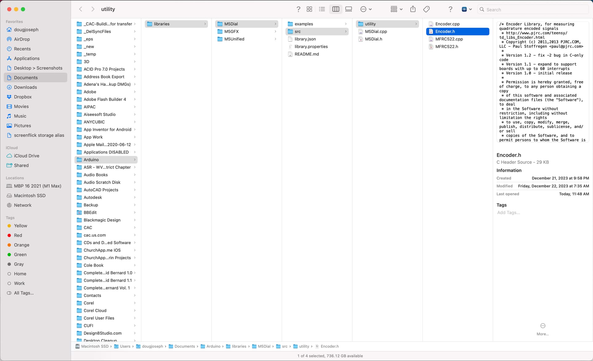

Thanks for posting all of this Doug. I have my dial sitting here on the desk with the interface after a successful build. But I cannot for the life of me locate the encoder.h file that requires modification. Any specifics on how you got it to show up?? I don’t have the specific folder listed on the wiki. Any tips?
Have you downloaded any of the ongoing build branches from the Github repo? These would be for “PendantsForFluidNC” — and folder structure to the encoder.h file is: M5Dial_Scenes > src
However, I have never had to edit any encoder.h file to get a working unit. What editing are you looking to do?
I’m trying to do this step:
I did download the entire Scenes repo. I also found the necessary GrblParser.h and I get a successful build. But then I ran into this paragraph, and the only encoder.h file I see doesn’t have the define statements in it. Also, the folder structure given on the wiki for this step doesn’t reflect the structure in VSCode, platformIO or on my drive.

Do you happen to have a link to the latest repo? Maybe I should start there. (Is the change still needed for this repo?) One of the gripes I have with so many places on the internet is the lack of dates. It would be great to know the last update on stuff that is still changing rapidly. At least on a forum like this the posts are dated.
Ah, I had forgotten about that fix. The screen shot below reveals the location of where I found one that met the description and could be edited. Although, the encoder.h I had found and edited for that fix, was not located in a .pio of the current build, and I had located it by manually searching my hard drive, and I honestly don’t know if it was the right one, and don’t know if it had any effect. Notice at the bottom of the screen shot, the path to the folder is shown, as well as the GUI interface revealing it.

Thanks Doug. This helped immensely. I’ve been able to make the change. Like you, I’m not completely sure this will be reflected when I build the PlatformIO project, but at least I’ve made the bug fix.

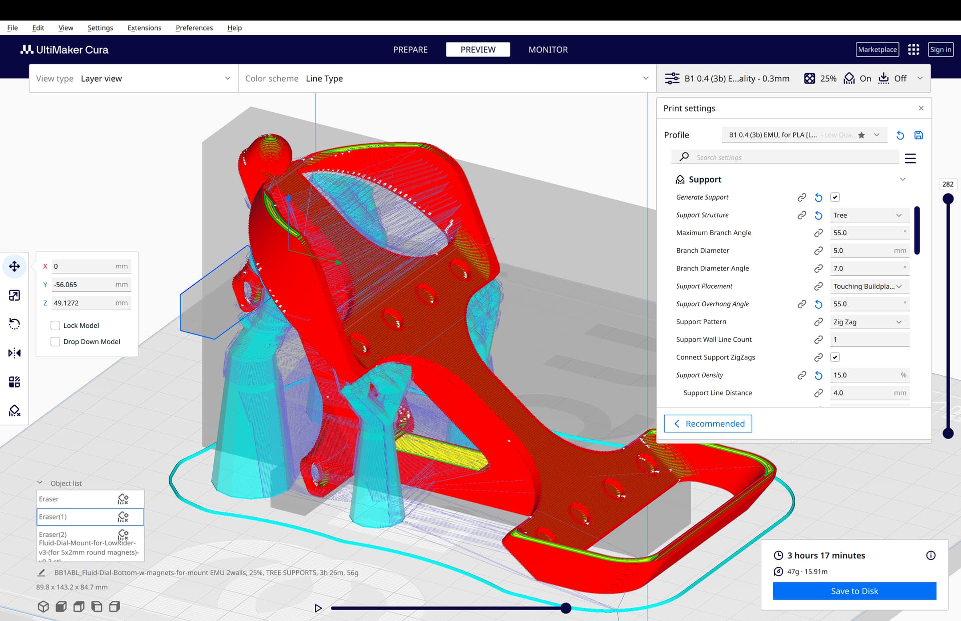

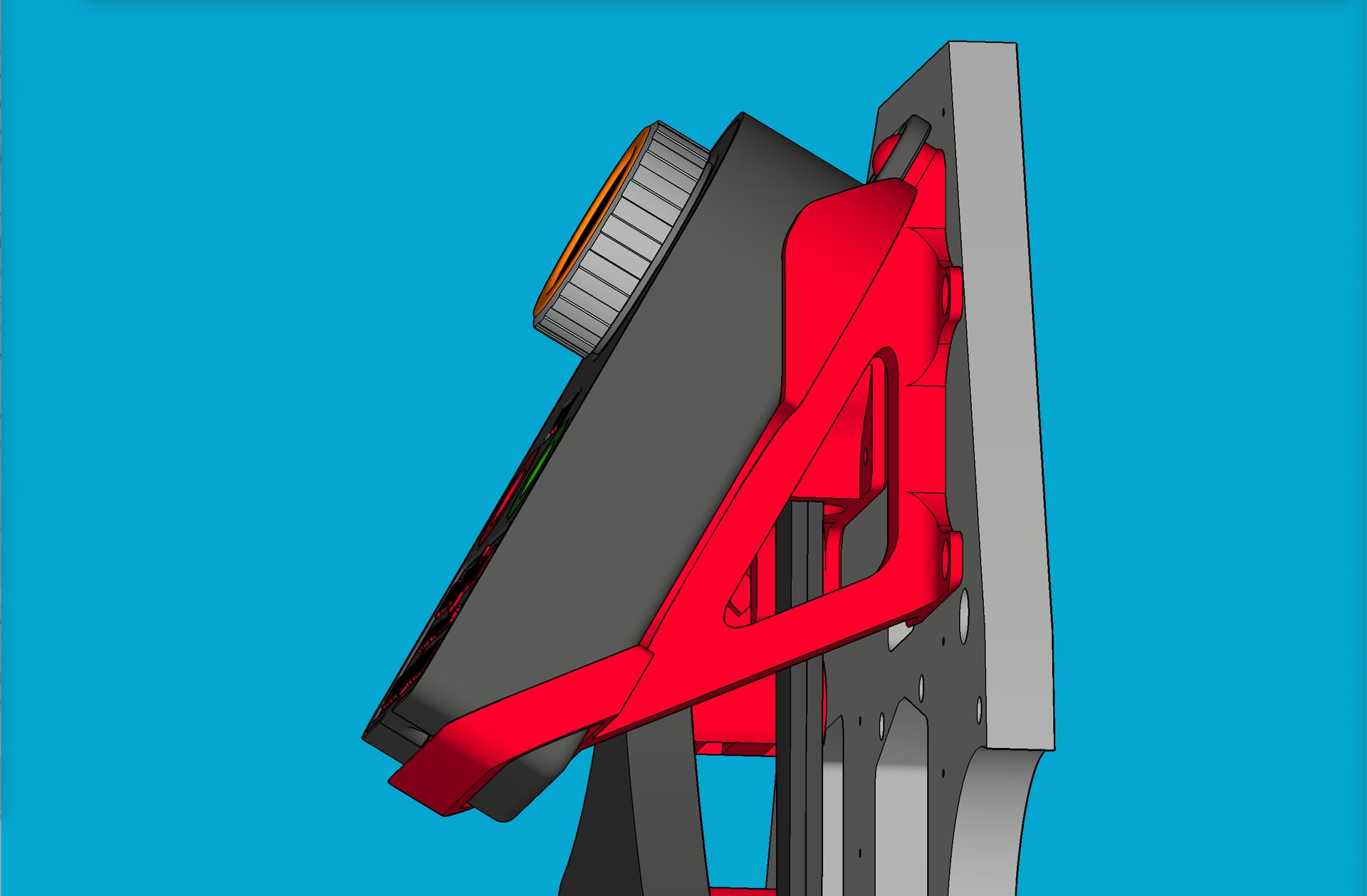

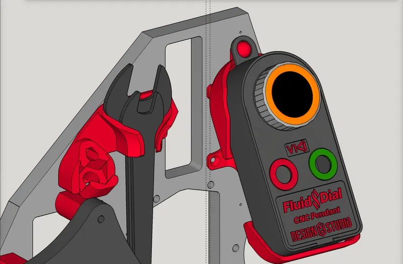

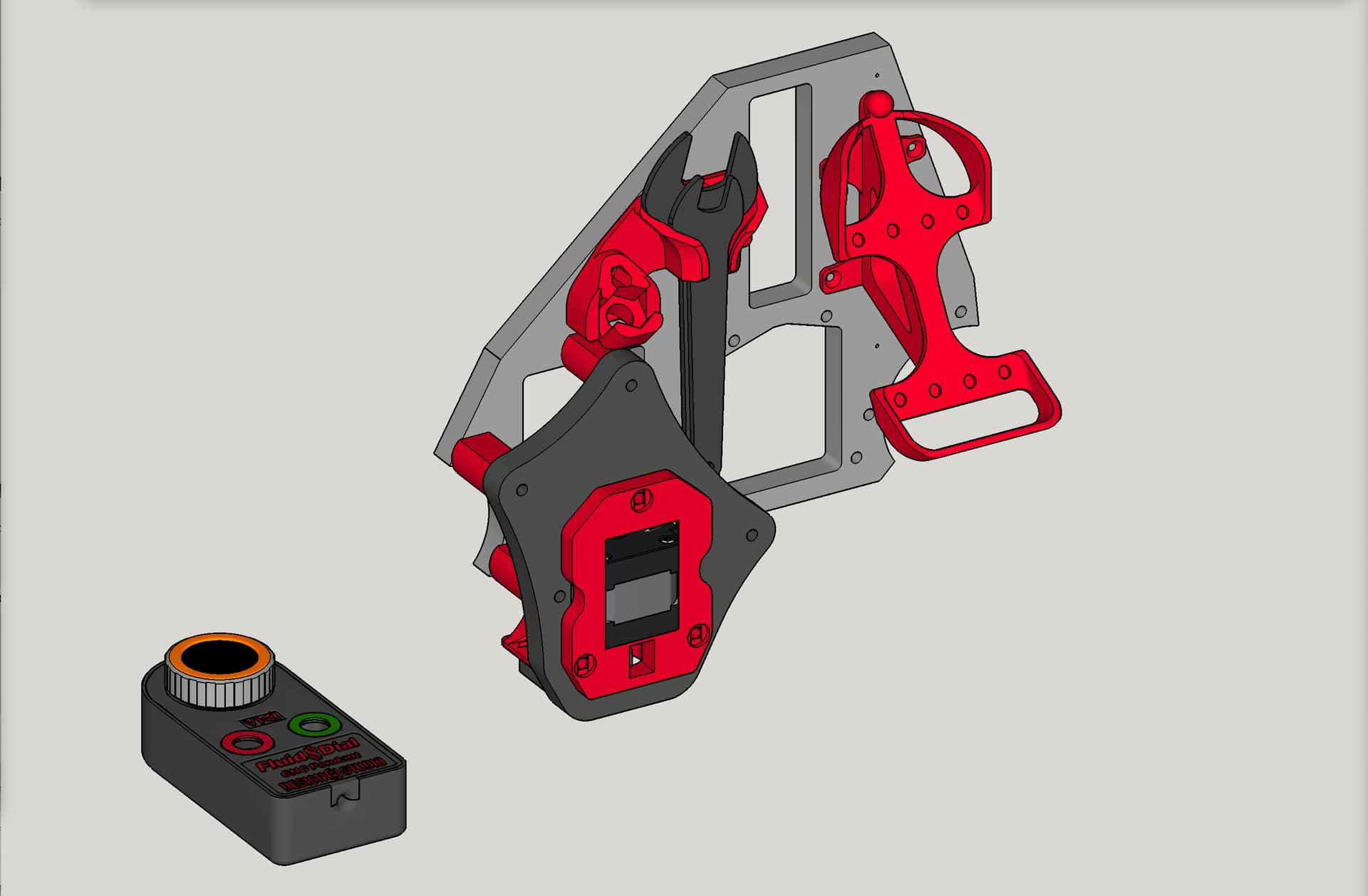

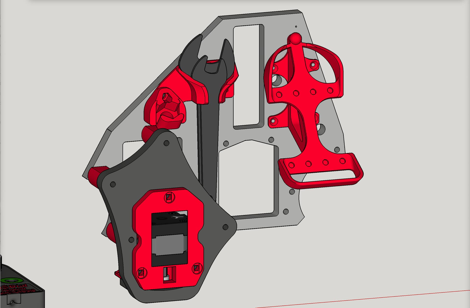

So, the FluidNC dev team is continuing their work apace, and meanwhile I have designed a cradle for holding the FluidNC Dial pendant on the YZ plate of a LowRider v3. It’s made to not just cradle it but to also hold onto it by use of 8 sets of tiny round magnets (2mm thick x 5 mm diameter). This means I also needed to remix the case bottom again, to add space for 8 magnets to be glued onto the lower face of it. I’ve printed the new case bottom and the new cradle. This is about the 3rd iteration of the design. Stay tuned for either pics or video!
Here’s the download link: Cradle for FluidNC Dial Pendant on YZ plate of LowRider v3 CNC (v1.4) by Doug Joseph (design8studio) | Download free STL model | Printables.com

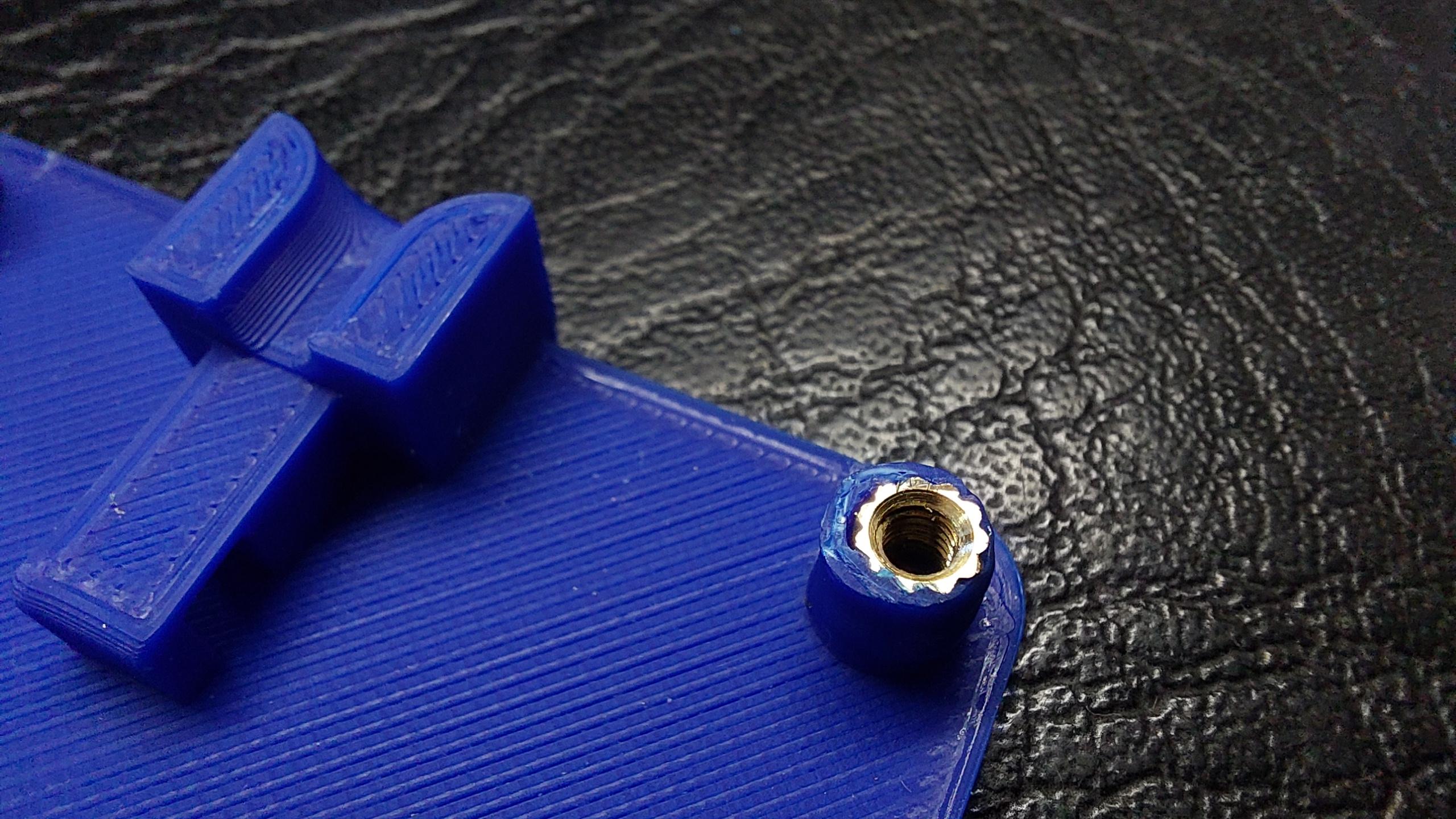

High Doug,
thanx for the new pendant STL files. I would suggest to increase the diamter of the front plate stand-offs when using threaded inserts. Otherwise its a little flimpsy.
Also i would prefer a standard m3 screw lenght of 20mm.
I’m a little confused. I am not using threaded inserts, and I don’t remember suggesting them. Did something that I said the above imply that I was using them? Certainly, it would be doable to remix to try to accommodate them, but as it is, I’m just using screws biting into the PLA plastic … with the screws just creating their own threads.
It’s also possible to use inserts in a design not originally indending them, but you have to use enough parameters when slicing to leave plastic, and then drill out the hole to a size appropriate for the insert being used. There are a huge number of different ODs for the brass thermal inserts, so it takes understanding what size opening must be present.
@MakerJim Certainly in many cases that can work. In this case, I noticed that the original design (from which I remixed) has the screws located quite close to the edge of the body, and not a lot of spare thickness around the screw holes. The tight placement means that unless a remix has moved the screw holes to allow room for more plastic, the standoffs just don’t have the bandwidth to avoid a collision when trying thicken them, and are barely thick enough as is, or even not thick enough.

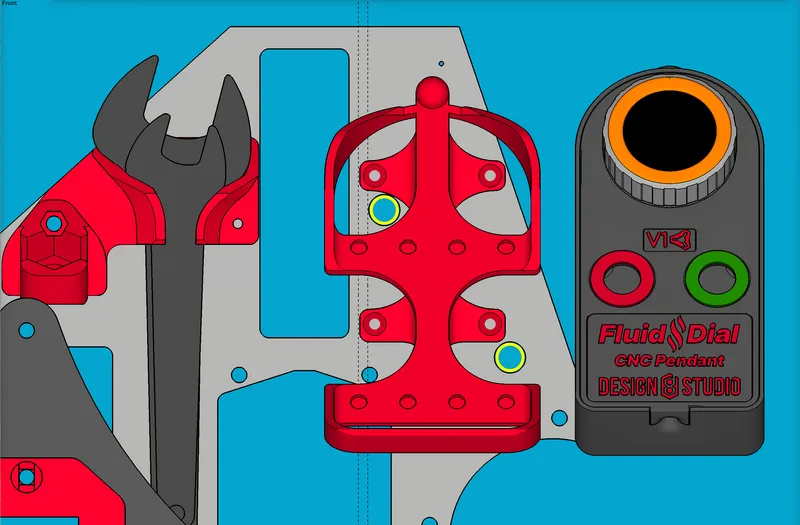

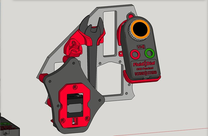

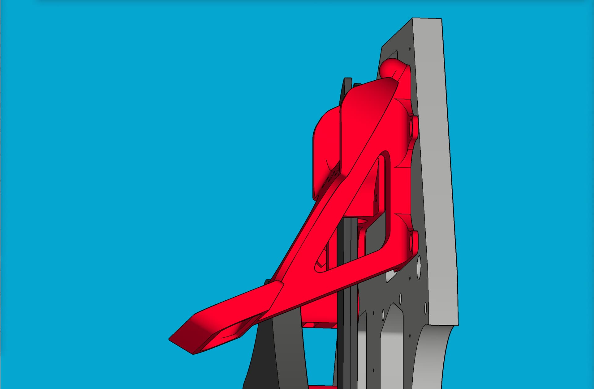

Regarding the placement for installing the cradle, see the following notes that were added to the Printables listings:

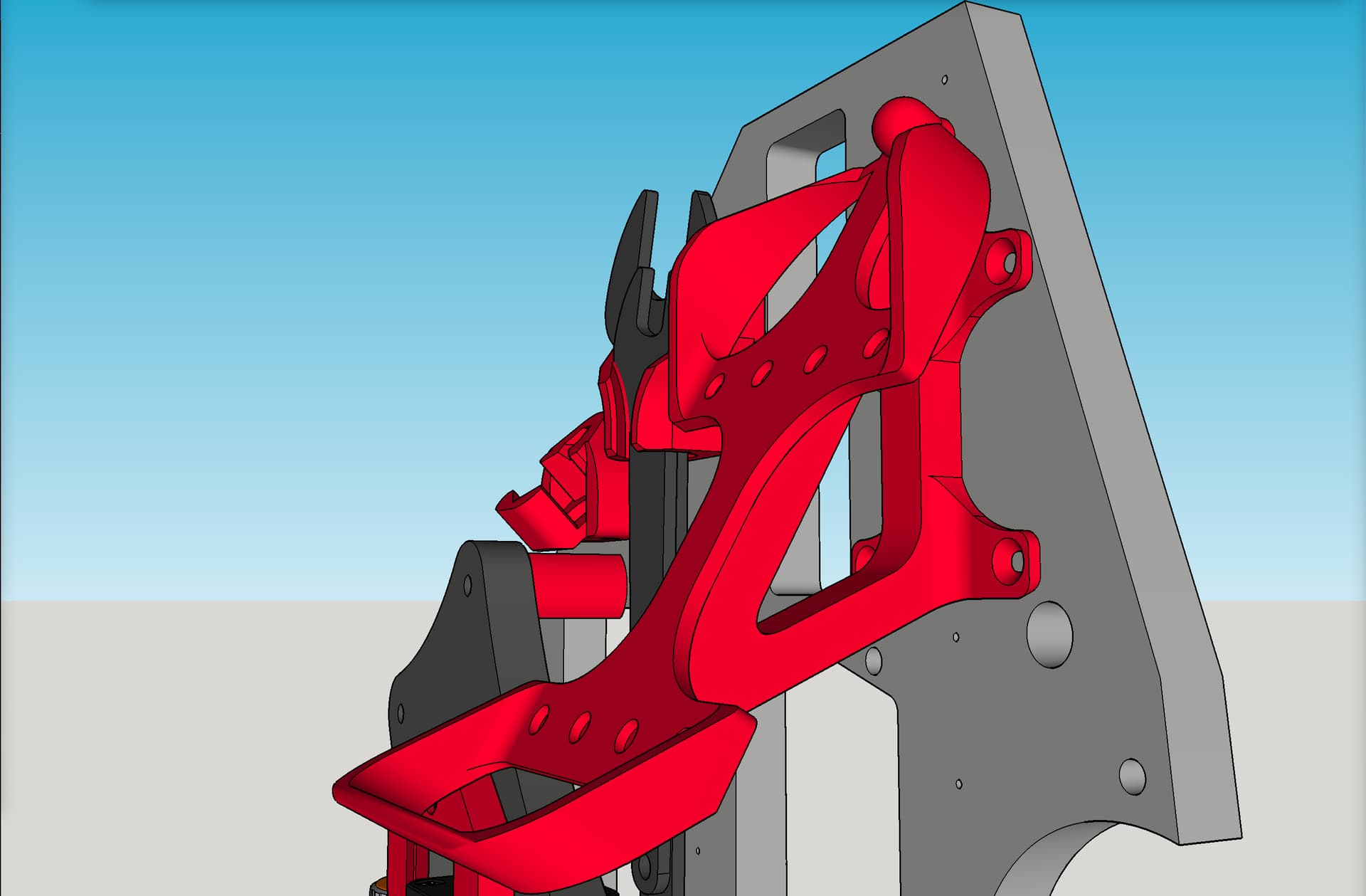

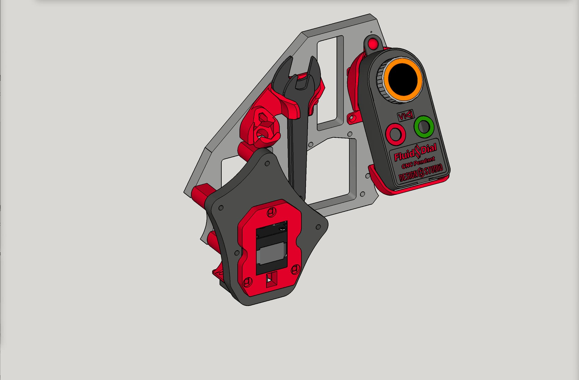

Placement on YZ plate:
There are two keys to good placement.

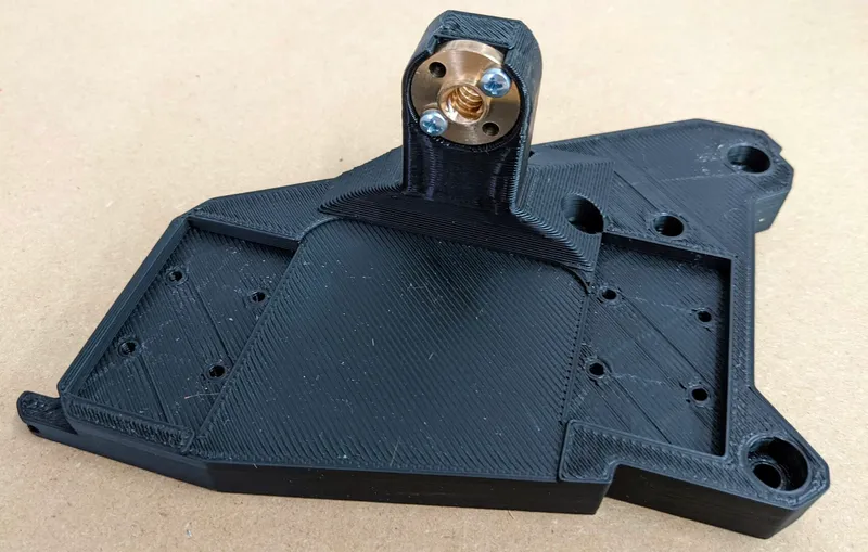

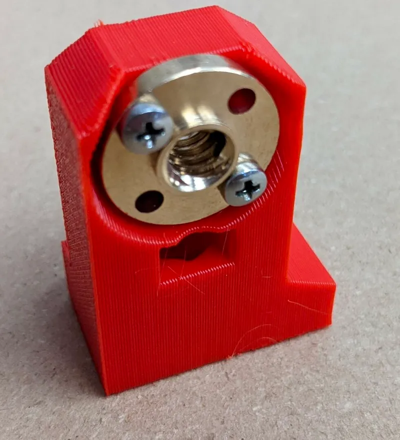

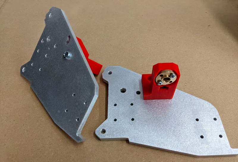

The first key is to avoid any chance of collision between the new cradle and your existing XZ lead screw stub. The two versions of the stub can be seen in the images below:
Assuming your LowRider is already assembled and functional, it’s advisable to raise your gantry’s Z height so that the stub is positioned so that you can see exactly how to place your new cradle to be far enough away from it.
Because I pre-drilled for, and installed, the first-generation prototype of the cradle, which had no side walls like the current generation, that older version could be positioned very close to the stub. When I later installed the current design with side walls, using the same pre-drilled holes, I had a collision issue, and had to carve out a small portion of my cradle. Because of that, I can only guess at exactly how far away (from the opening for the stub in the YZ plate) you need to install the cradle. My guess is between 1/8" and ¼" away should be enough. In the illustration below (from my 3D modeling in SketchUp), there are two vertical guidelines. One guideline is 1/8" from the opening, and the other guideline is ¼" from the opening. The cradle is installed with its edge somewhere between the two guidelines.

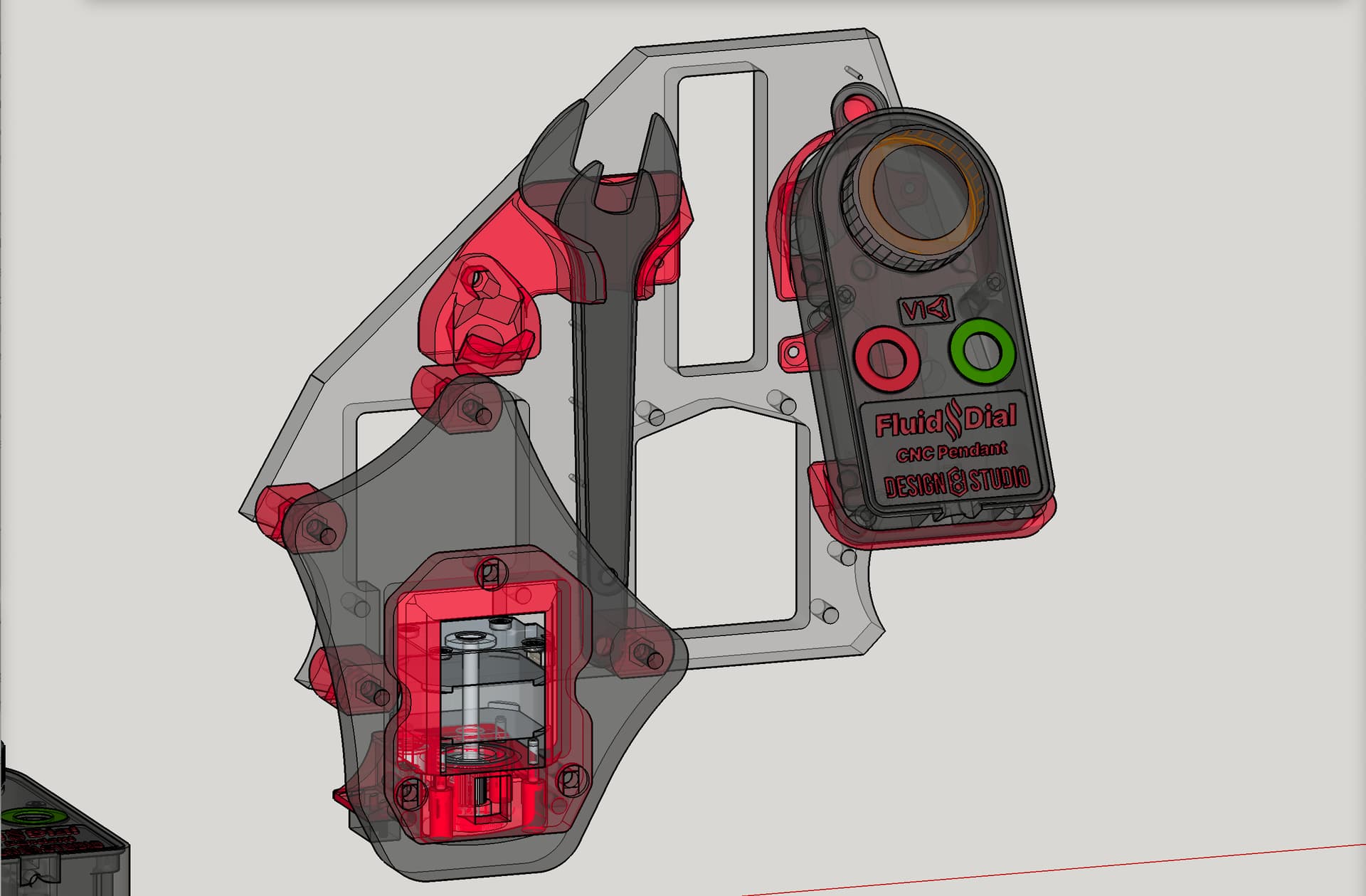

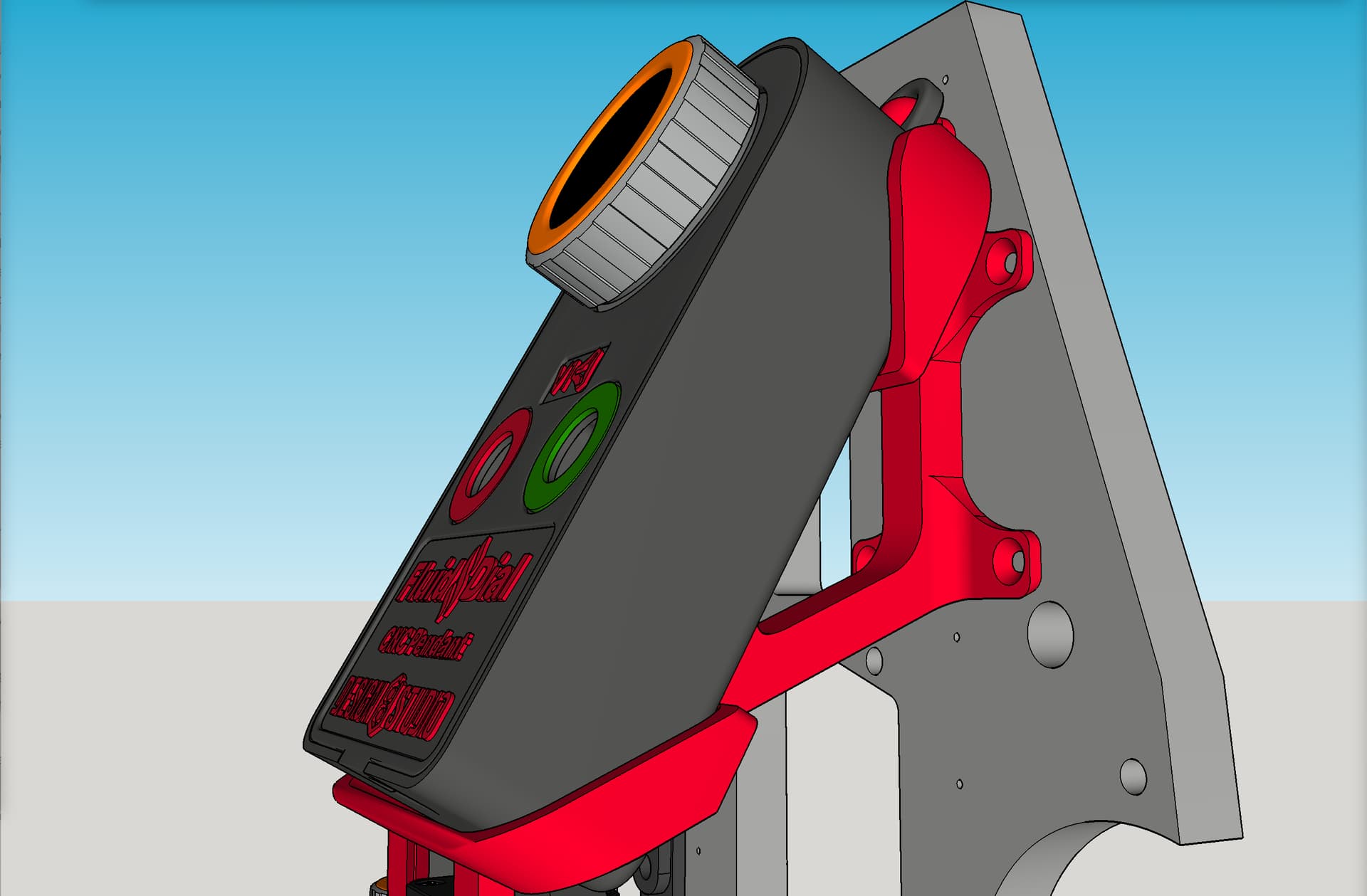

The second key to good placement is to make sure that you still have access to the two large holes in the YZ plate that allow access to the screws holding the gantry beam to the XZ plates.
In the illustration below (from my 3D modeling in SketchUp), you can see the two large holes highlighted in yellow. Notice that the cradle can be installed so that tool access to those holes is still allowable. Also, here again is another view of those two vertical guidelines. One guideline is 1/8" from the opening, and the other guideline is ¼" from the opening. The cradle is installed with its edge somewhere between the two guidelines.
