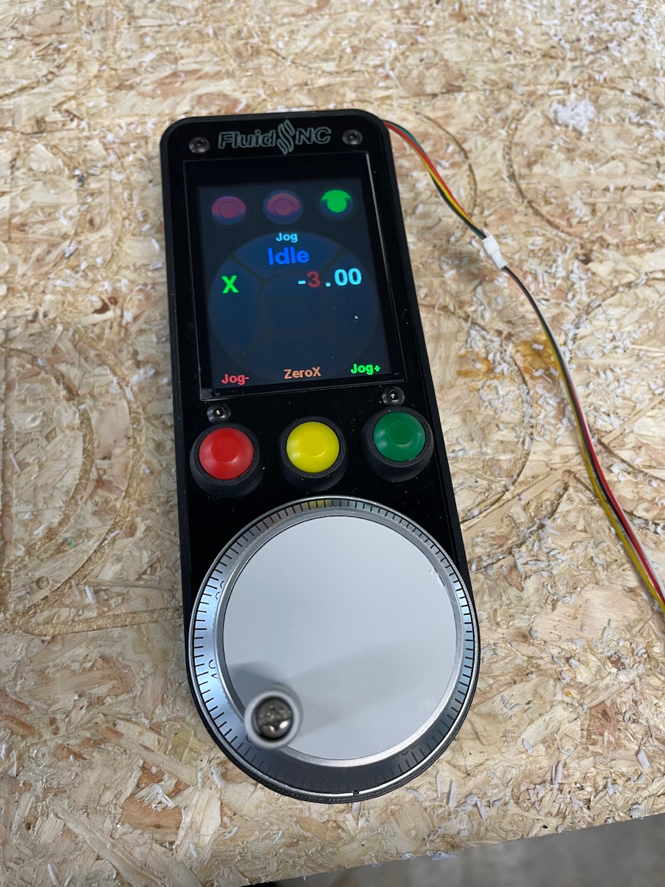

Fluid Dial (Fluid NC dial pendant by Bart Dring, using M5 Stack's M5 Dial)
You will like the CYD version. I would suggest the Capacitive screen.
I already had a resistive screen but bought a capacitive. I already had the buttons, just waiting on the encoder…

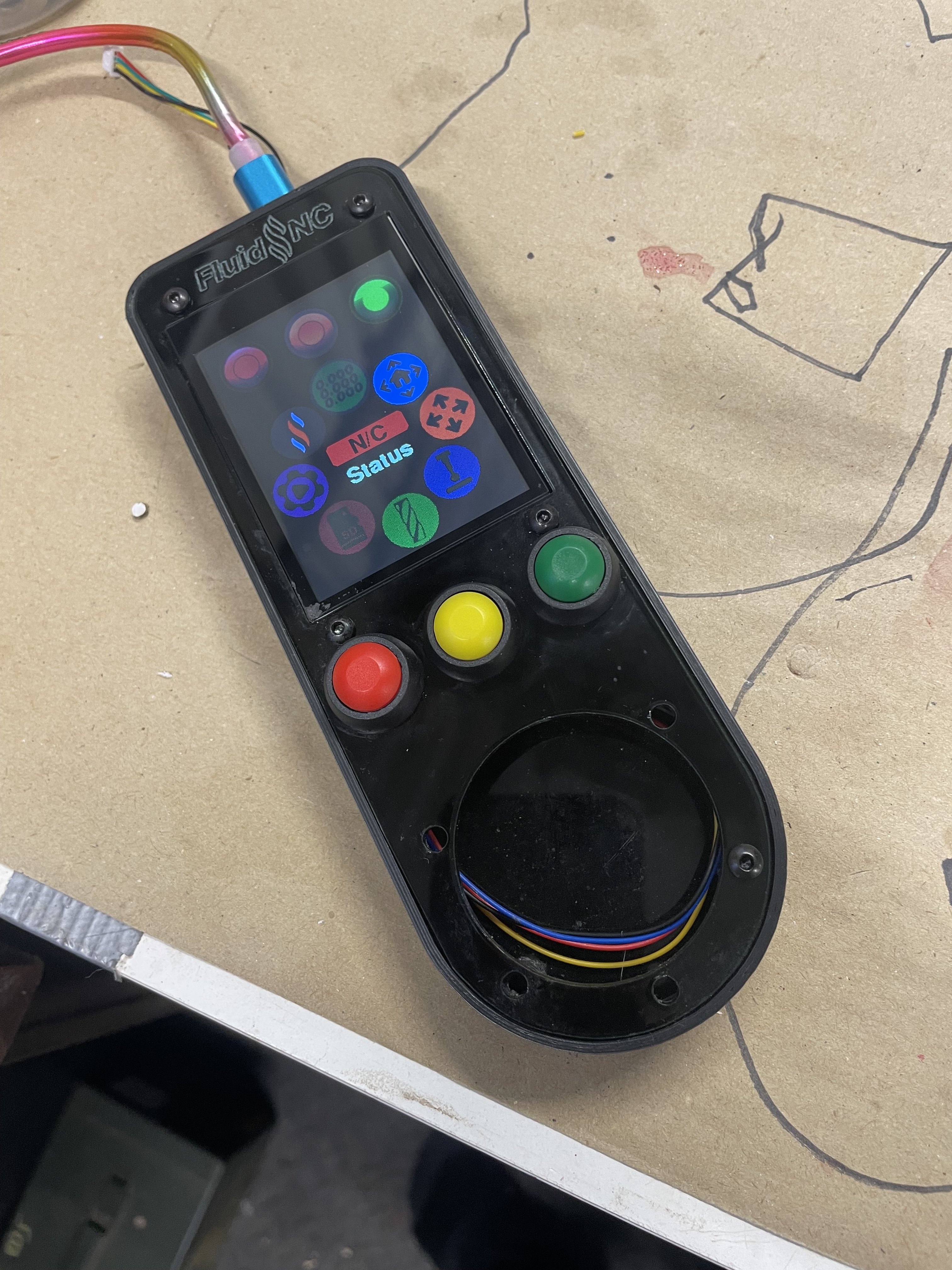

Laser cut front and back with 3d printed middle. It’s amazing to have the ability to do this stuff at home.

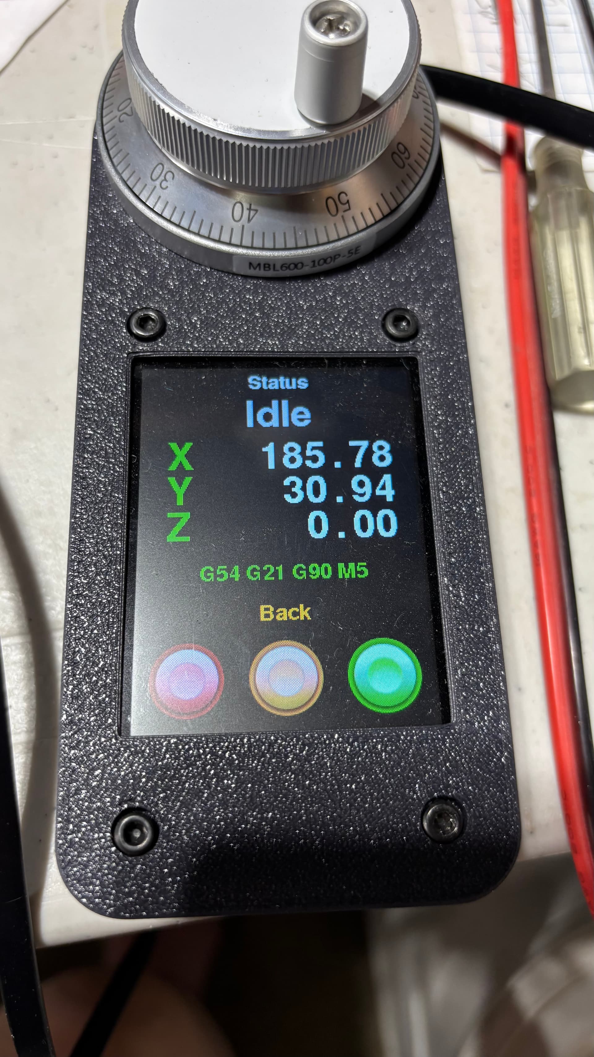

I had an m5Dial and I like this much better, this thing is great.
The wiring, the screen, the jog wheel, i prefer them all.
On jogging I can leave it on single units and scroll really quickly but with good feedback.
The only thing more I would want is to access the onboard SDCard and run files from it.

I really like mine too. The Jog Wheel is great compared to the M5Dial. Mitch did a great job getting it all working.
Yeah, only because it’s more accessible than where the jackpot is mounted.
I really appreciate the software is available on the web installer too. I’ll play with it for a bit and see if I need a lockout switch.

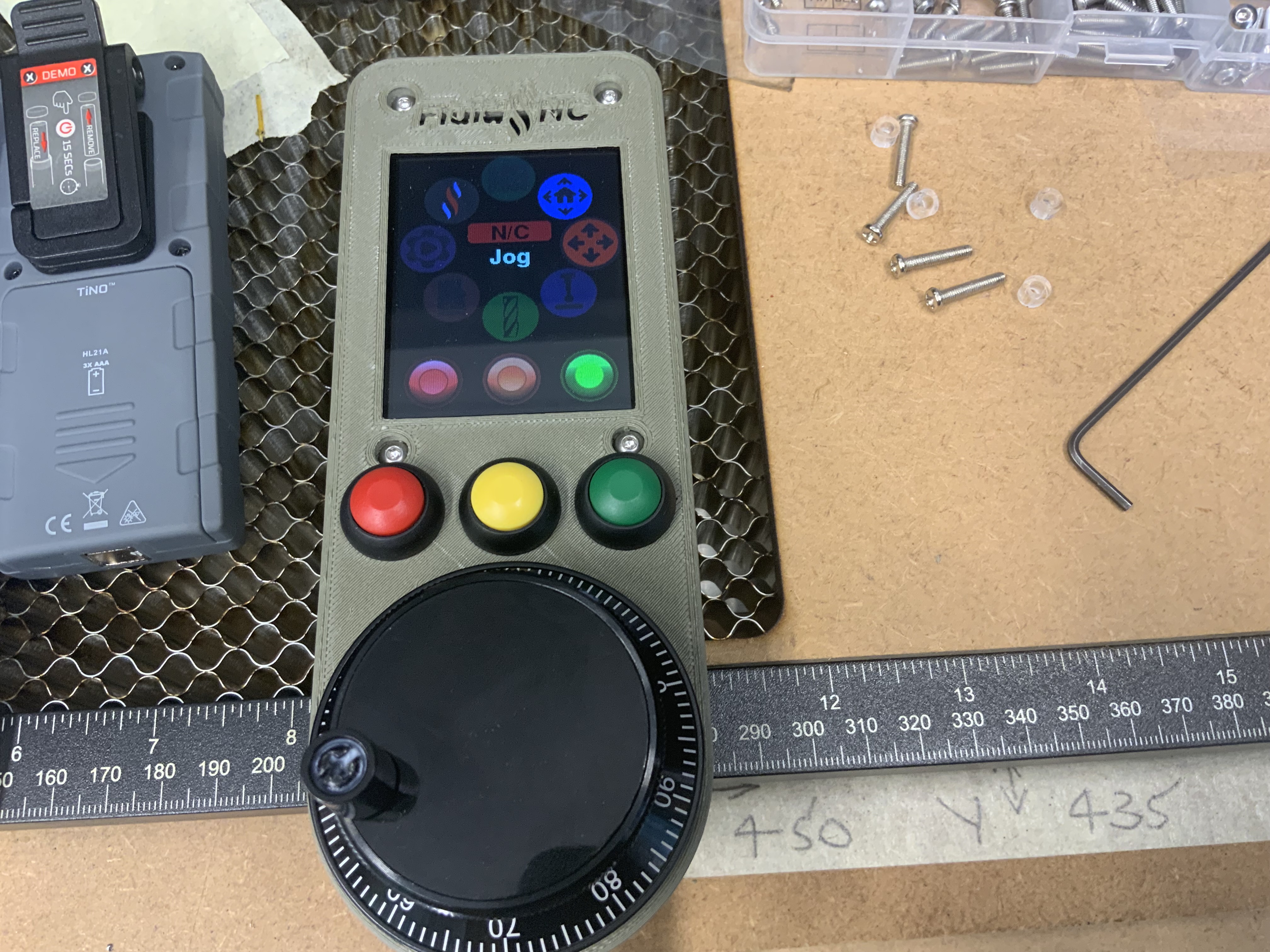

Mines a tiny bit different to standard because I laser cut the top and bottom and made the 3D printed middle about half as thick but I foubd it much easier to put together than the other type.
I see someone made 5 to sell on tindie and Mitch was okay with it so I may make a couple to offset the cost of my own.

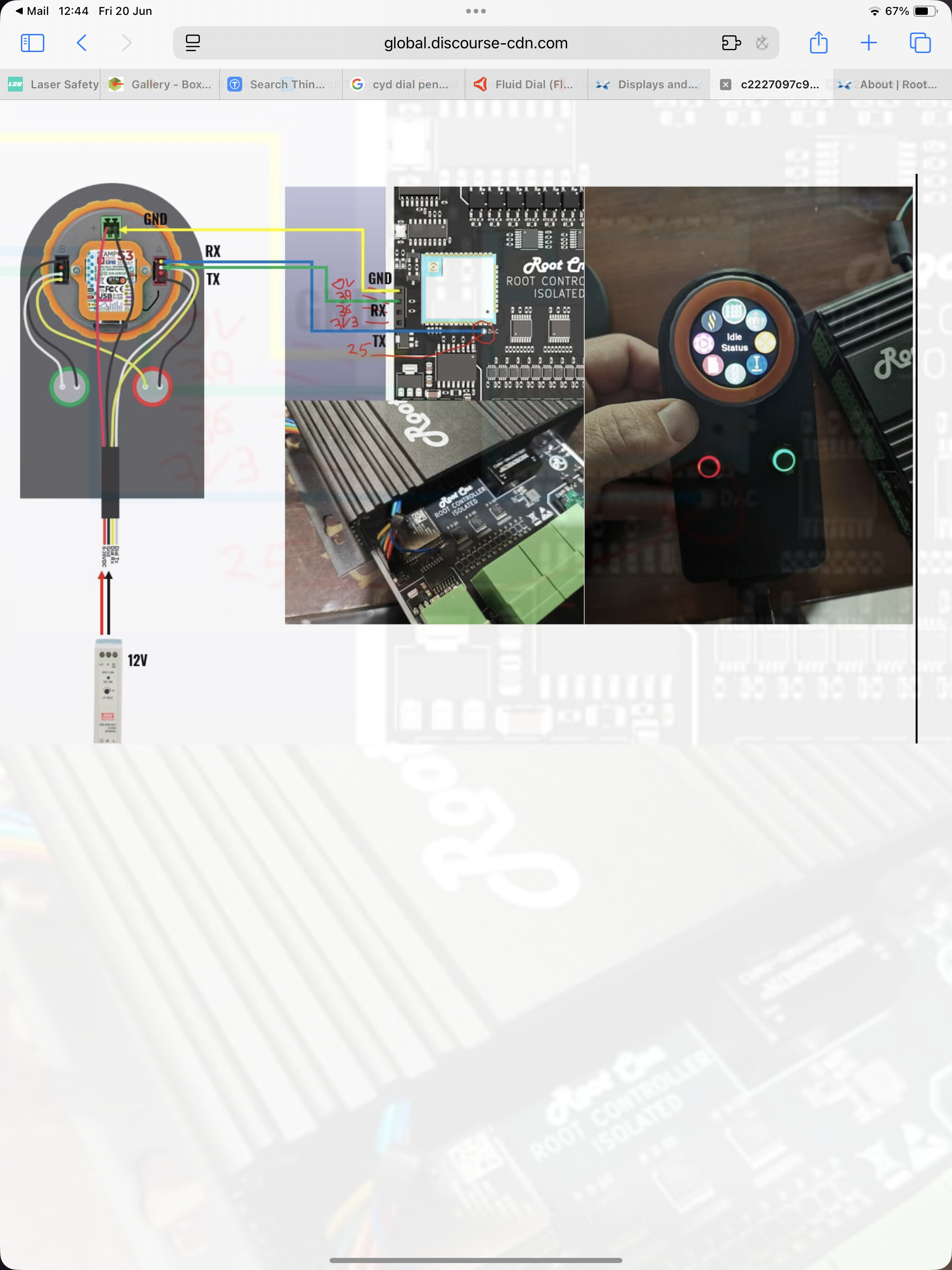

I’m using a a root controller and it works great for cnc spindle and laser cutting
Have to make some internal connections
It’s going to be fun as it’s beyond my knowledge of how it all works

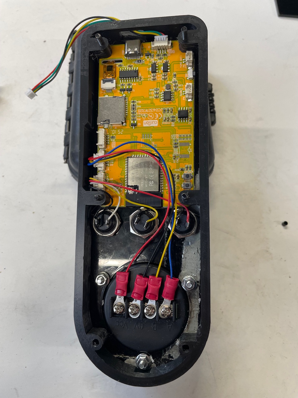

So all built and firmware load seems to work fine
Written a new YAML file and that seems ok

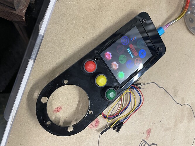

But I have the N/C message in the centre of the screen
Any ideas or suggestions from anyone
Check your RX and TX wiring.
It has to be
RX ——— TX
TX ——— RX
And your config.yaml correct for the GPIo pins you’re connecting to.
It’s the CYD wiring diagram you want, not the M5dial - and there are also 2 different versions of CYD, resistive or capacitive, so check that as well.
