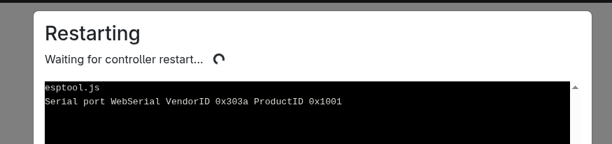

Anyone installed using Linux? I am trying to run the webinstaller via Chromium and it gets stuck at “Getting MCU Type”
I had this same thing happen on windows a few days ago. Had to install with VScode.
I did about 6 months ago. Chromium on Ubuntu 24.04. Make sure your user account is in the dialout group.
Recent web installers have had various kinds of breakage on all platforms.
I added my account is added to the dialout group, same outcome. I also tried with my wife mac but I get the same result.
Now I can connect to the device but I get stuck here:
This happens both on my Linux device and my wife mac. On my Linux device I tried to set the baud rate of the controller to the two proposed at installation time but the result is the same.
I also tried to press the button behind the dial at different moment of for a different length of time but it is not affecting the process.
Webinstaller for the fluiddial has been down for several days. You will have to upload it with VScode.
Do you know if it is possible to use esptool? I think this is what the webinstaller is using.
No I am not sure. I know there are instructions for VScode on the wiki. That is the only way I have done it, well that and the web installer but that isn’t working right now.
