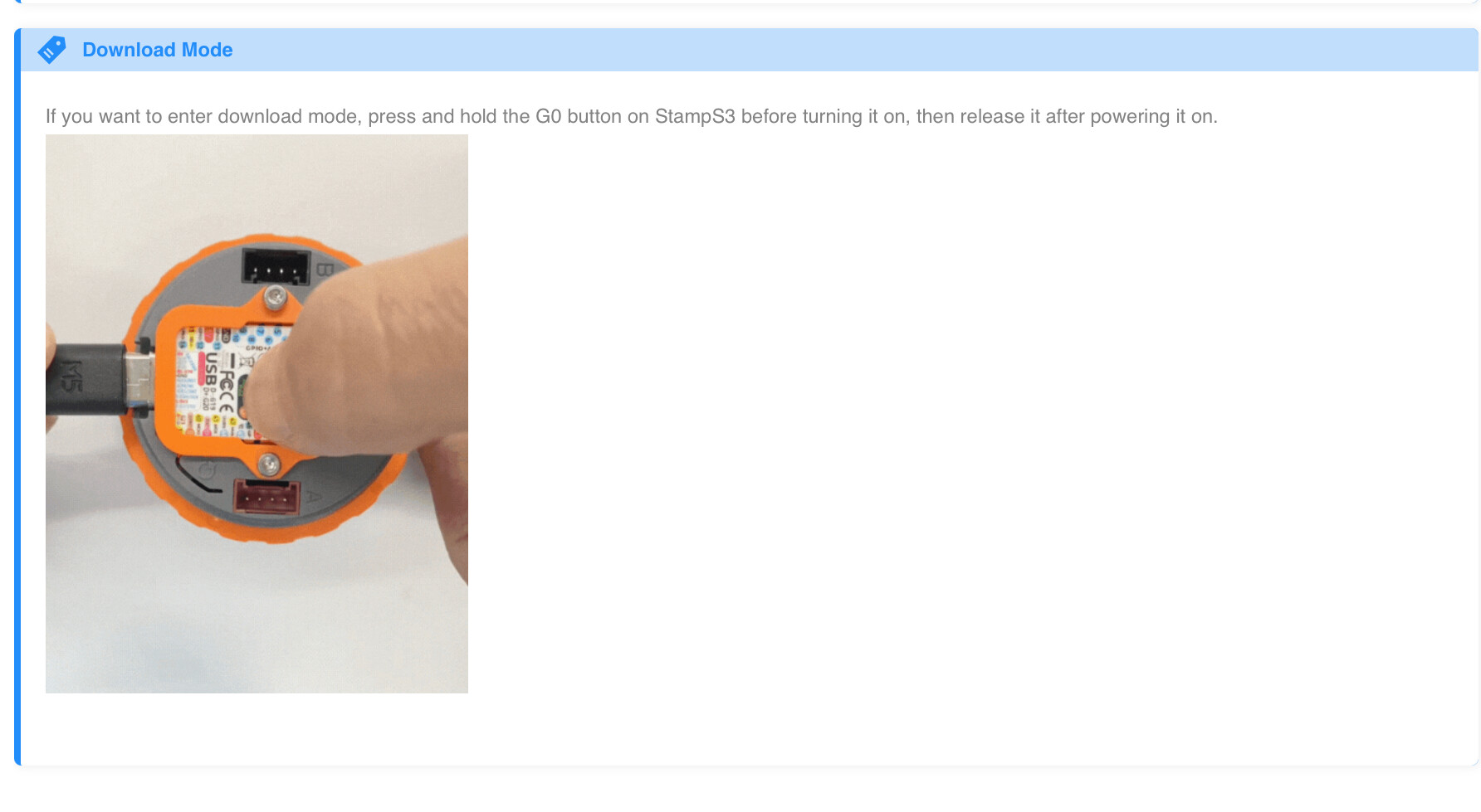

Taken from https://docs.m5stack.com/en/core/M5Dial
That doesn’t appear to be making much of a difference.
I uninstalled the device, restarted my computer and reinstalled the CP210x drivers.
Now the yellow triangle is gone, and under the Ports heading I see the Silicon Lamds CP210x…COM4.
When I plug in the dial without holding the button on the back, it continues to come to life, when I hold the button and plug it in, nothing happens in the device manager window.
I found it easier to remove the frame and card in the back so I could see the button and feel the click of it being pressed.

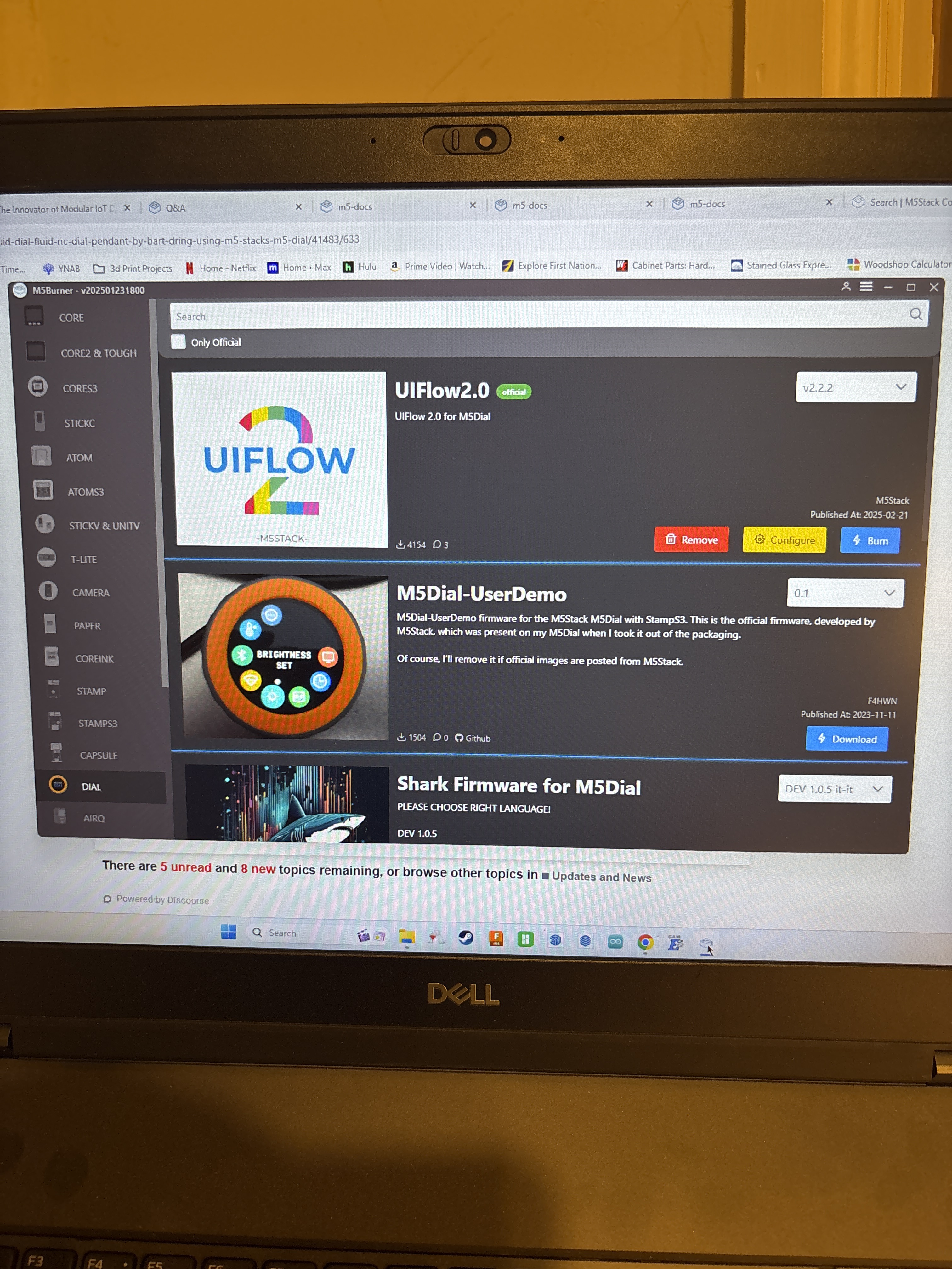

I went down a rabbit hole on the M5 website, and came across this guide to re-flashing the device:
I downloaded the M5 Burner files with the application, but when I try to log in, it comes up with an error (even though my credentials work for the forum)

The M5 application that I was trying to gain access to has some sort of port configuration utility, and I thought it might be an avenue to diagnose the problem.
I struggled with mine, (but it was a while ago) and with an S3 Stamp recently. For mine to work I did need to hold the button. I also needed to specifically use a USB 2.0 port and an old USB cable (that I tested for data) on an older PC. (This was a pain because I ended up having to install the whole Visual Studio Code setup on an ancient machine.) But at one point (once it was recognized) I did need to use a web installer to erase it before I could get Visual Studio Code to upload to it. I think I used the WLED installer to perform the erase, then just didn’t do any of the rest of the install.
