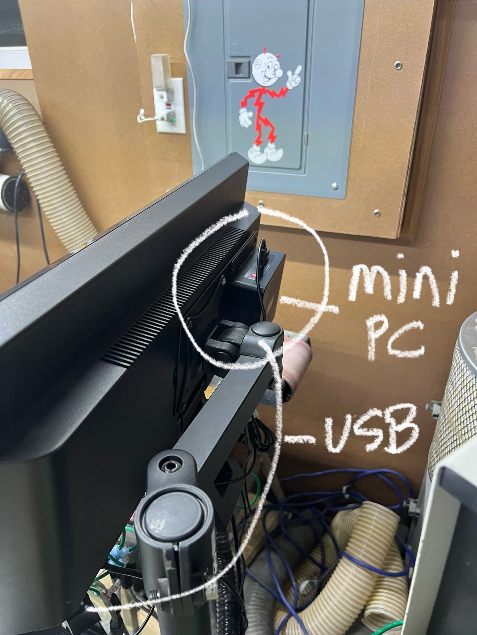

My setup might be a bit different than others: See attached.
I have a touch screen monitor connected to a mini PC running windows 11 attached to the back of the monitor:
The USB cable is only about 18 inches long going directly from the PC to the Jackpot via a high quality USB cable with a USBC to microUSB converter inside the controlbox connected to the ESP board.
I’m just not a fan of wirelessly sending data to something controlling a spinning router bit.
I’ve already experienced the FLuidnc wifi glitch and disconnect and then reconnect.
I’ve just never used the SD card route but can imagine that is even better than USB and wifi.
I may give that a go sometime.
I may give the webUI another chance for a small job like cutting out something simple just to confirm it’s working.
