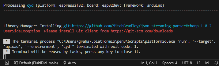

I am trying to setup the screen for my pendant. In Visual studio I opened the folder & let PlatformIO do its thing. Then went to cyd, general, upload & I keep getting this error message
I tried installing Git on my laptop but that didn’t help.
Any advice?

That looks like a platformio/vs studio issue not specifically related to the fluid dial firmware. Have you installed the git client from the link in the error, rebooted and logged in to GitHub at least once before trying again?
