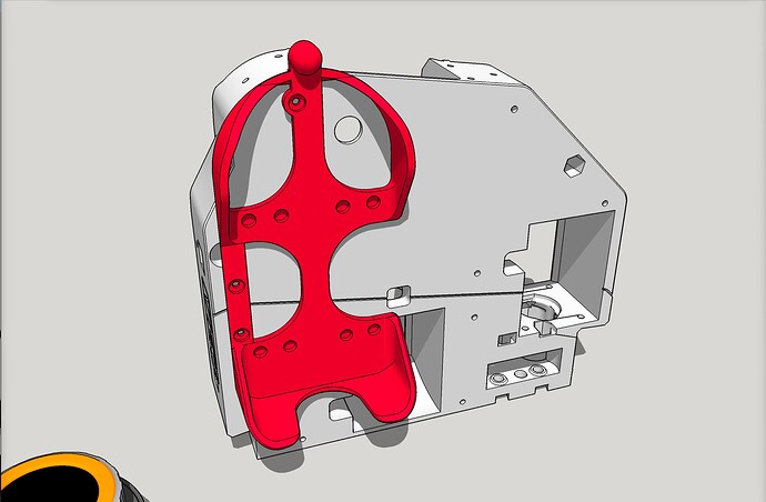

In the Printables listing for the cradle, I gave a link to what magnets I used. I think I also gave a link in the Printables listing for the case for the pendant.
So glad you got it working!!
LOL I forgot to print the cradle, so I never saw that listing. Thanks again
here’s a link to cradle for it for LR4. I also had an earlier cradle for LR3.

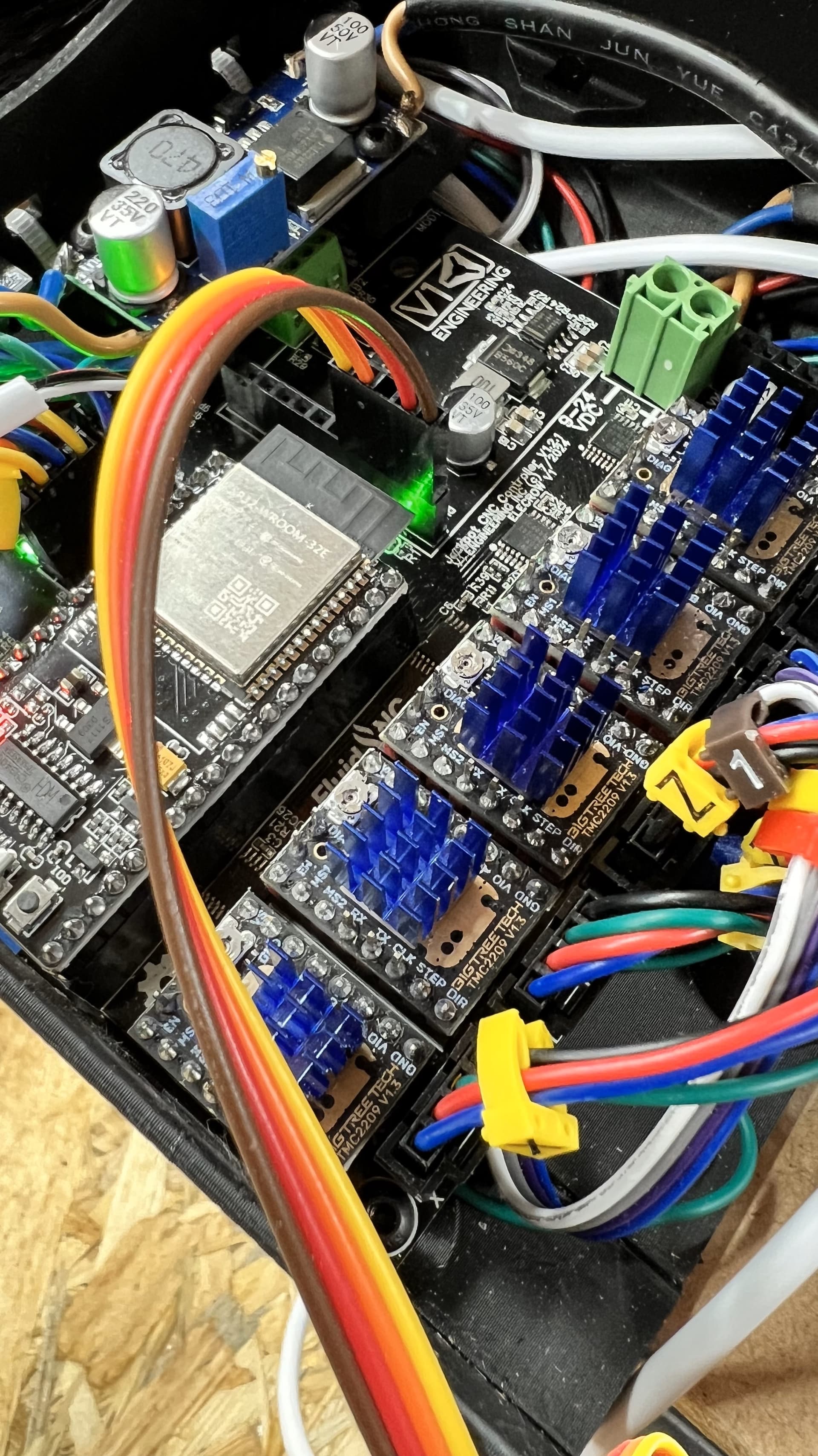

I am struggling getting my M5 Dial pendant to talk to my Jackpot controller. My controller is working (all movement works from browser interface). I have checked my connection to the board (and checked continuity of connections). I have modified my Jackpot config.yaml code as suggested, using GPIO 14 and 13, but on powering on I get N/C instead of Idle.
Do I need to change anything in the FluidDial fimware prior to uploading? Are there any diagnostics/logs that I can check?
Do I need to modify the UART1 section of the FluidDial firmware to change the baud rate as per the wiki page -
FluidNC Config Example
You can use any 2 pins on the ESP32 that are UART capable (most are)
The default baud rate is 1000000. It can be changed in platformio.ini in this statement
-DFNC_BAUD=1000000
The config file Tx and Rx are with respect to the FluidNC. Be sure to connect the FluidNC Tx to the pendant’s Rx and the FluidNC Rx to the pendant’s Tx.

Those are the wrong settings for a Jackpot board using the default wiring (Or a Bart version of the RJ12 adapter set.)
For a jackpot board the config.yaml should have this in it:
uart2:
  txd_pin: gpio.14
  rxd_pin: gpio.13
  rts_pin: NO_PIN
  cts_pin: NO_PIN
  baud: 1000000
  mode: 8N1
uart_channel2:
  uart_num: 2
  report_interval_ms: 75
Those are the correct settings for the way the Jackpot board expansion connecter is laid out.
The reference to GPIO.26 & .4 were just a quote from the wiki. The text below was a copy of my config.yaml, which I had changed as per Doug’s instructions at the start of this topic, but I hadn’t included the section for uart_channel2:
This has now sorted it. Many thanks Jim

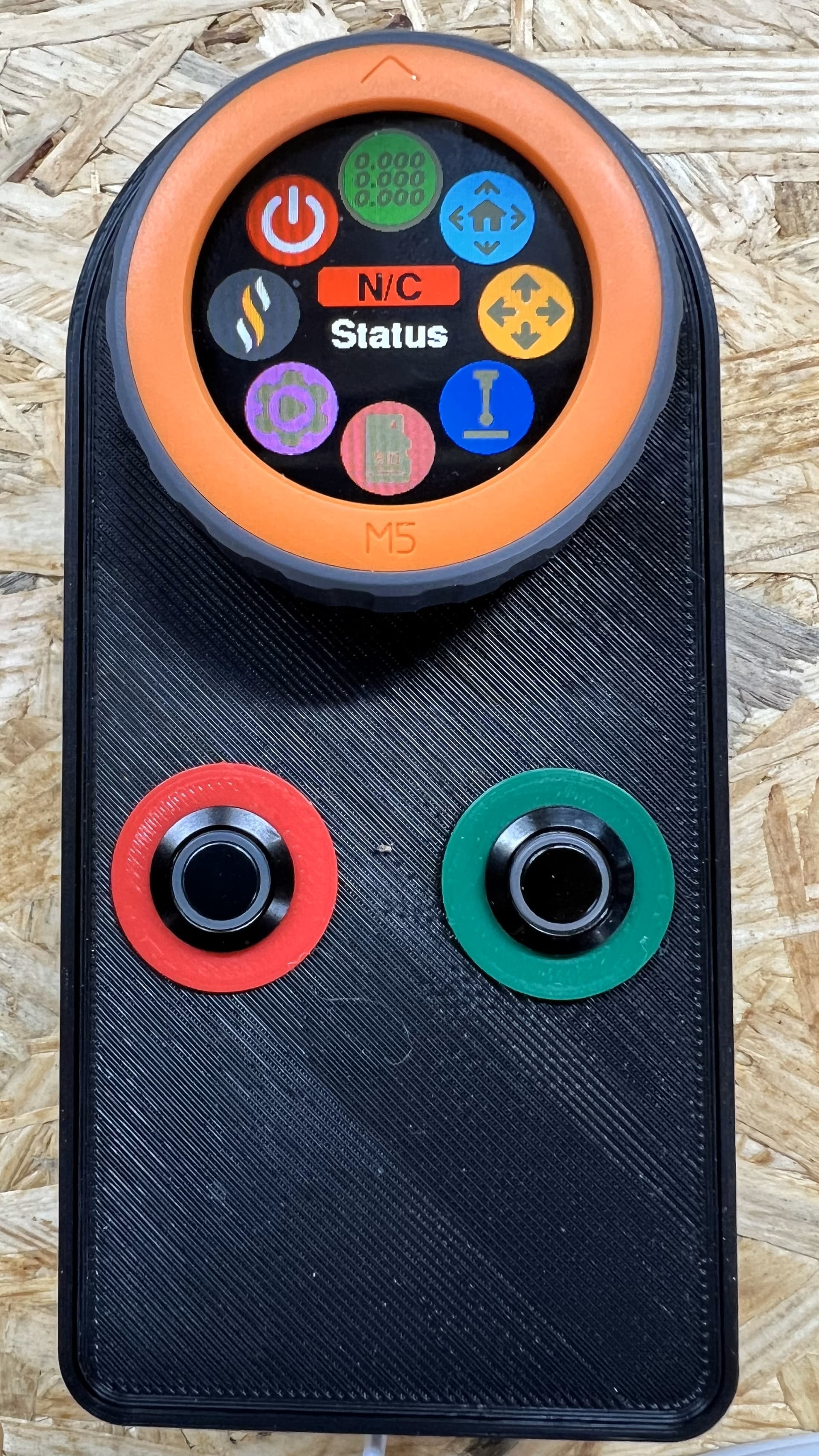

I am not able to get my fluid dial working it shows NC and
I’ve wired it according to Doug’s instructions and configured the .yaml file as per Maker Jim’s information:
here is the error message I get when booting FluidNC:
[MSG:INFO: FluidNC v3.9.1 GitHub - bdring/FluidNC: The next generation of motion control firmware]
[MSG:ERR: Ignored key uart2]
[MSG:INFO: Machine MPCNC]
[MSG:INFO: UART1 Tx:gpio.14 Rx:gpio.13 RTS:NO_PIN Baud:1000000]
[MSG:ERR: UartChannel: missing uart2]
Then there is an error in your config.yaml - indents and formatting are critical in yaml even an extra space will cause an error.
Post your yaml here (in a code block) and let’s see if there’s anything obvious.
Yes Indeed syntax matters I corrected it and got past the errors when booting FluidNC…but the pendant still still shows NC not connected: :frowning:
here is what the about on the dial says
here is the verbose txt when starting fluidNC there are no errors and I see that the UART 2 channel was created:

FluidNC Dial is still NC not connected:
I’ve just gone through the same pain, which turned out to be incorrect UART2 setting in config.yaml. Yours seems to look ok. Make sure you have the wiring of the Tx and Rx crossed between the Jackpot and the Pendant i.e. Tx - Jackpot to Rx - Pendant, Rx - Jackpot to Tx - Pendant.
