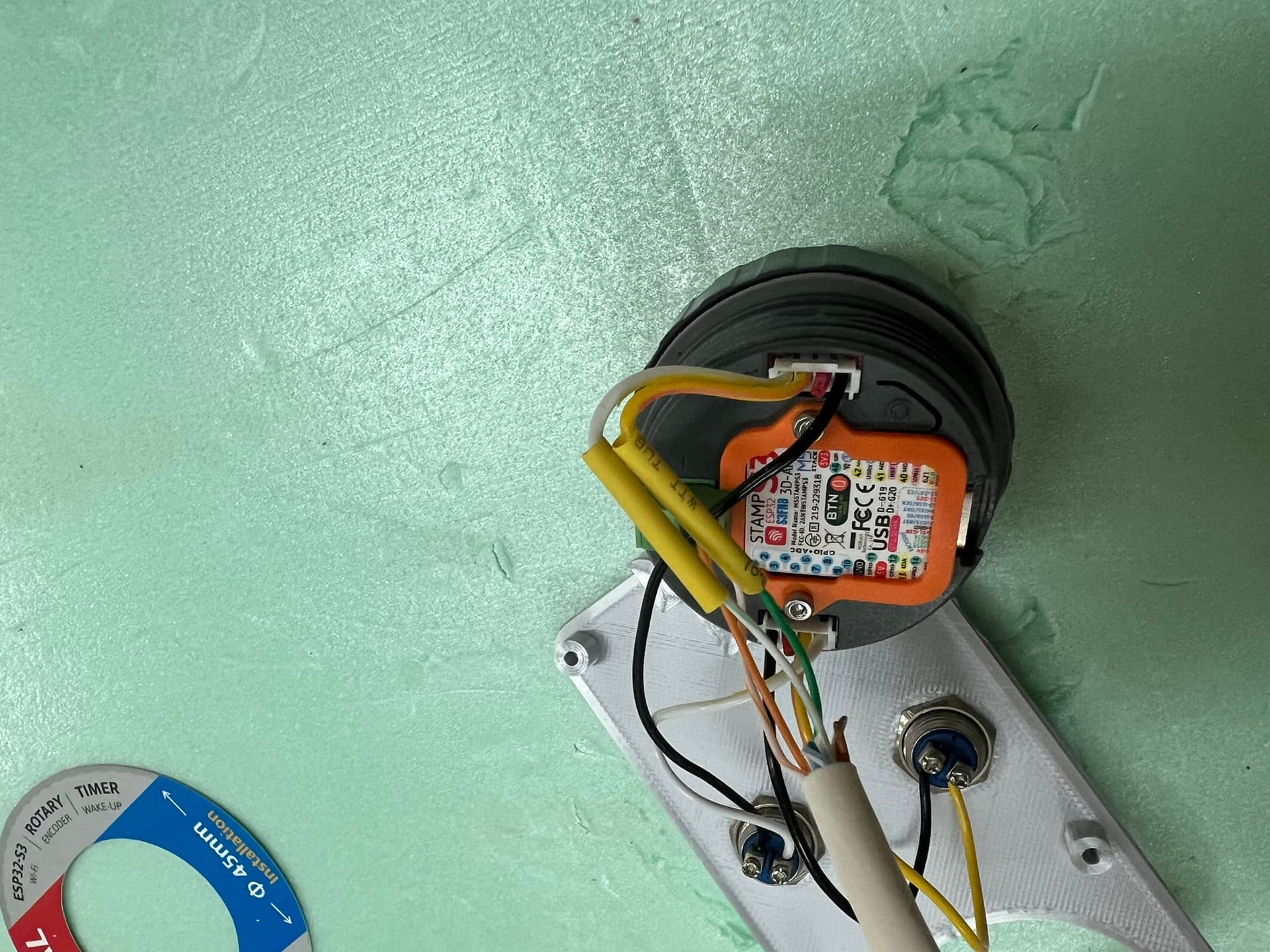

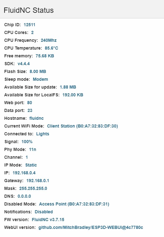

Ok, got the new fluid dial in. Flashed correct build to it. Still showing N/C Status.
See my files attached and photos. Needing help to get dial working with Fluid NC Controller.

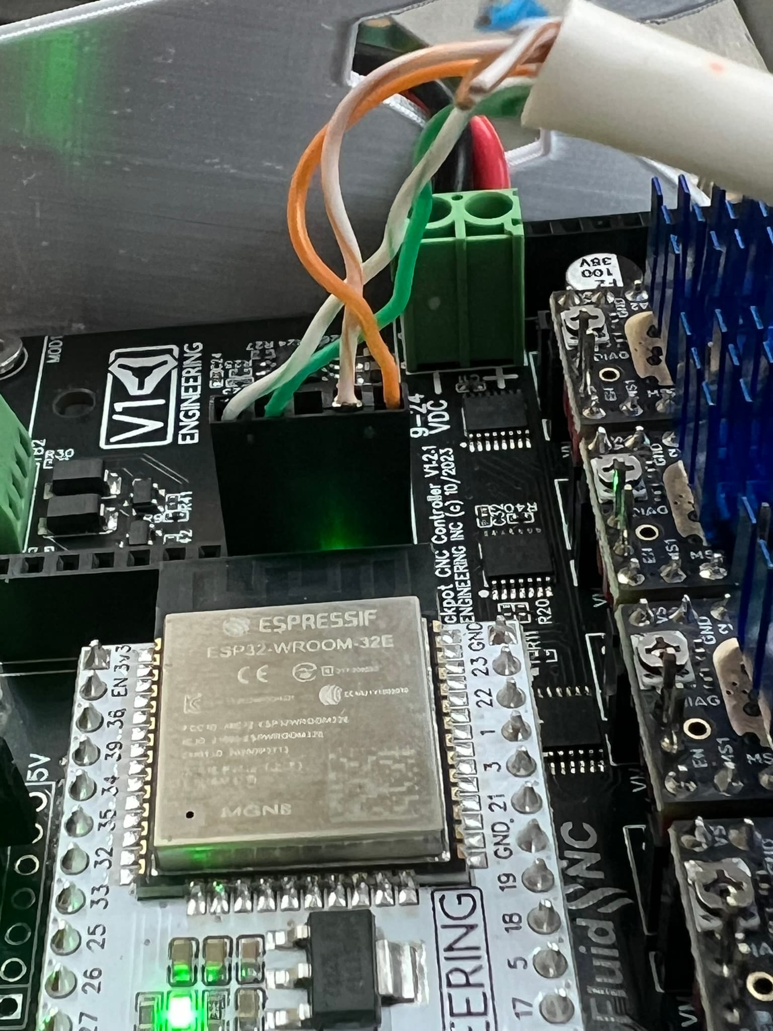

It looks like you have
TX ↔ TX
RX<->RX
Which would be the wrong way round
swapped and still the same

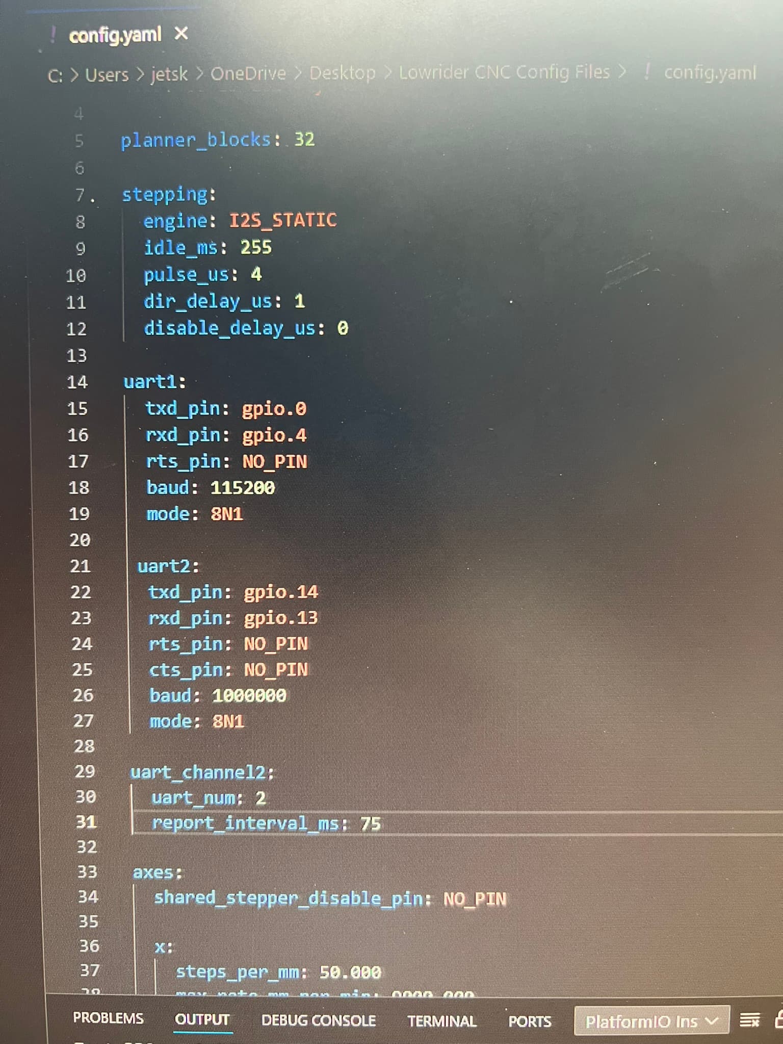

Checked my config and I have the baud rate as 115200 not 1,000,000 as you have - so are you sure that’s right?
Does your config.yaml look like this:
uart2:
  txd_pin: gpio.14
  rxd_pin: gpio.13
  rts_pin: NO_PIN
  cts_pin: NO_PIN
  baud: 1000000
  mode: 8N1
uart_channel2:
  uart_num: 2
  report_interval_ms: 75
That’s what is working for me… see above.
Fair enough, I’m not on the very latest firmware so it must have changed
VS Screenshot config
Check the continuity of all your wires and terminals then. DuPont into pcb headers isn’t the most positive connection sometimes.
all prope end to end
Your uart2: text is indented one space too far to the right. Line 21
Good spot
