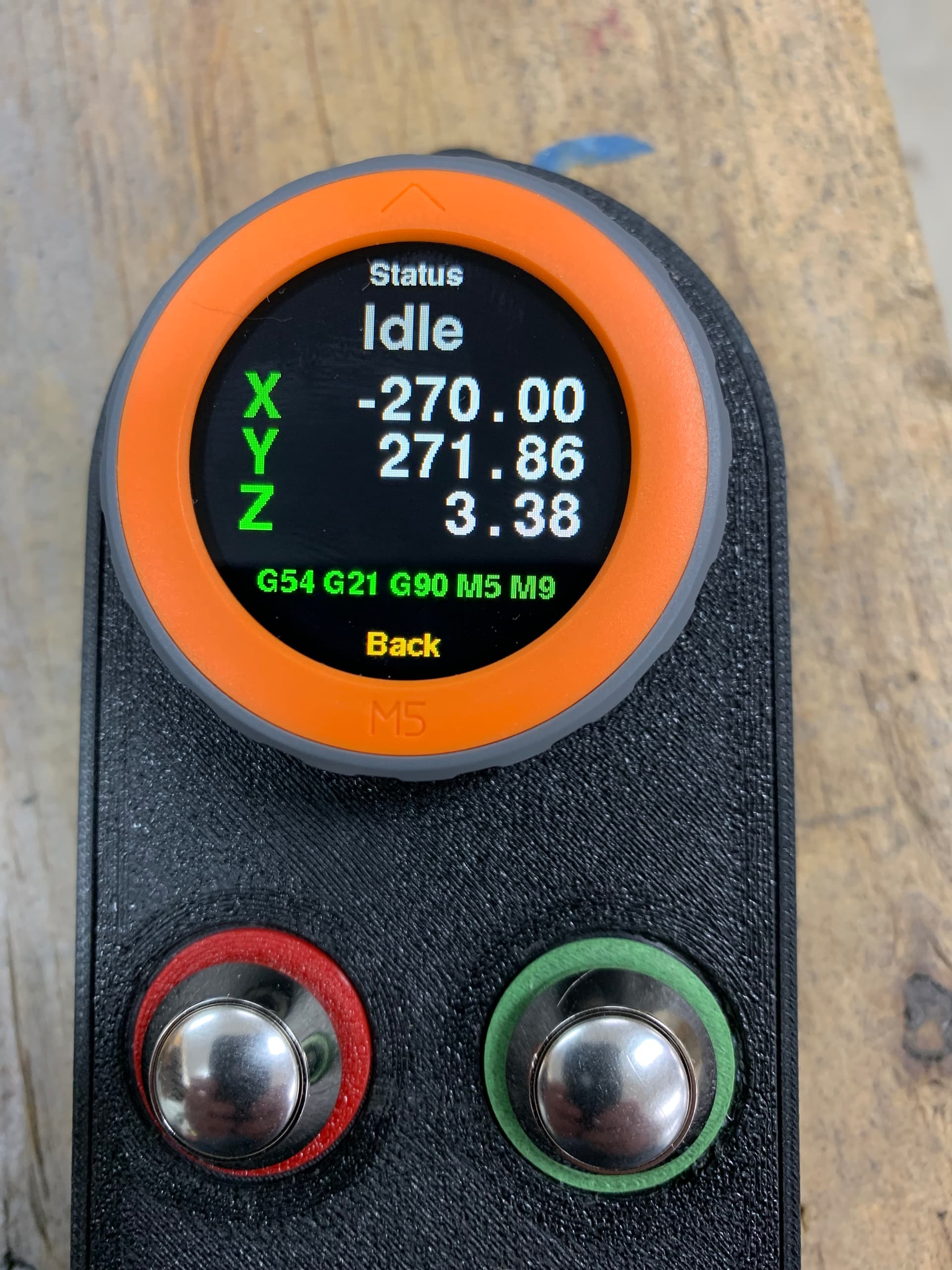

Does your dial have these icons?
@Bemster
Yes, @Britt is correct. You need to build and upload the file system. That is a separate icon/ separate menu choice in VS Code. It is documented in the wiki and also in this thread higher up.
Click the Platformio icon on the left. Then under the Project Tasks open m5dial and General. You should see ‘Build Filesystem Image’ and ‘Upload Filesystem Image’. After you do both you should see the icons.
Having not used Platformio before I used the upper right build option. After looking at Doug’s screen shot for 15 minutes I finally click on the Alien head. Now my screen looked the same as Doug’s and it start to be clearer. I uploaded “Upload Filesystem Image” and now it works as expected. Thanks Britt for your last message but I did not read it until afterwards. Thanks for everyone fast feedback.

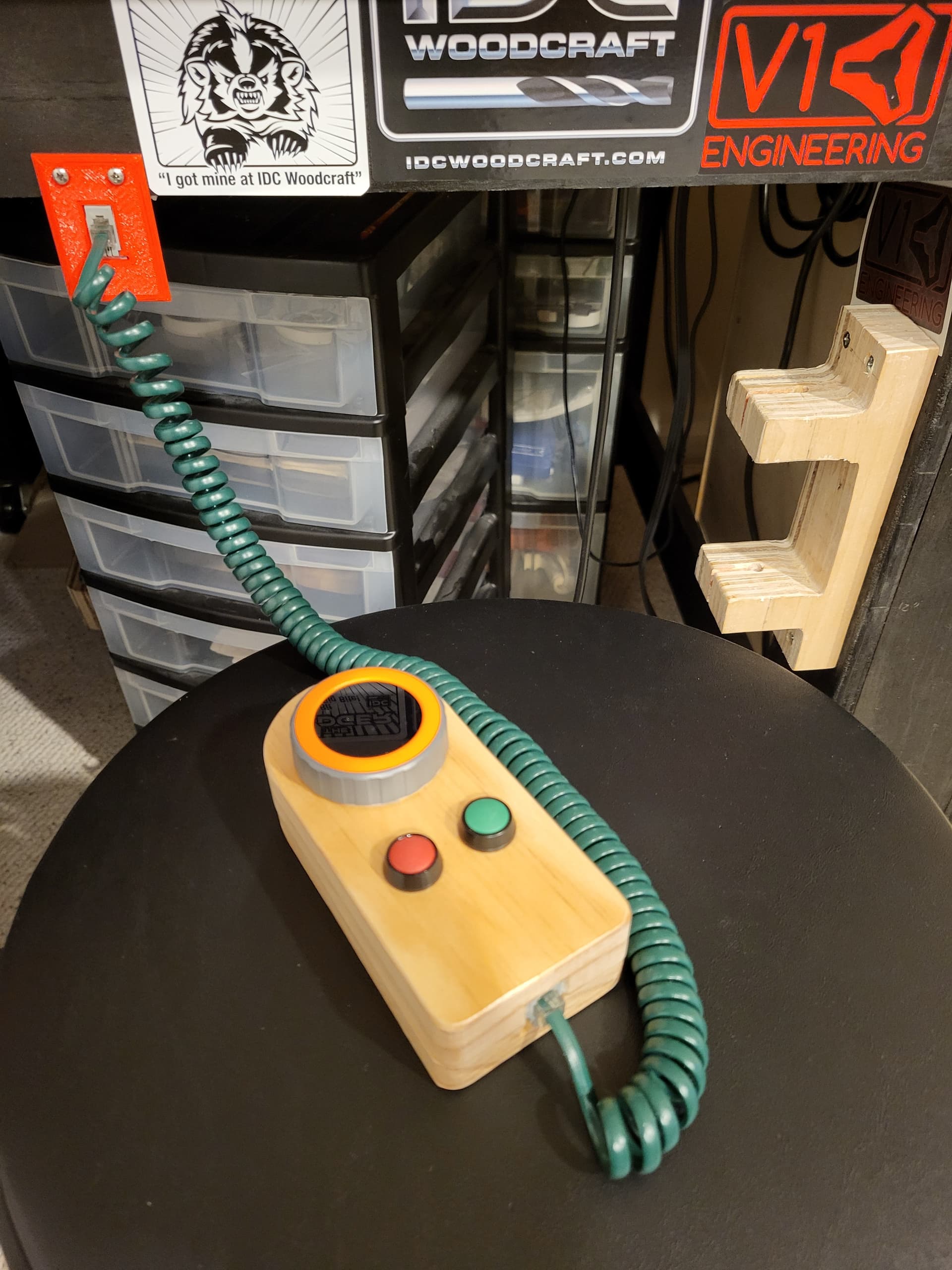

Thanks for your dxf file. Instead of screws i used magnets to hold the top/bottom sides and i cut a slot for the coiled phone cord. Next is to get the FW installed and test it out.
it looks good. :grinning:
That looks really great!
